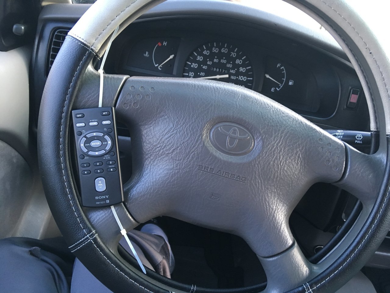

    Custom steering wheel mounted radio controls.

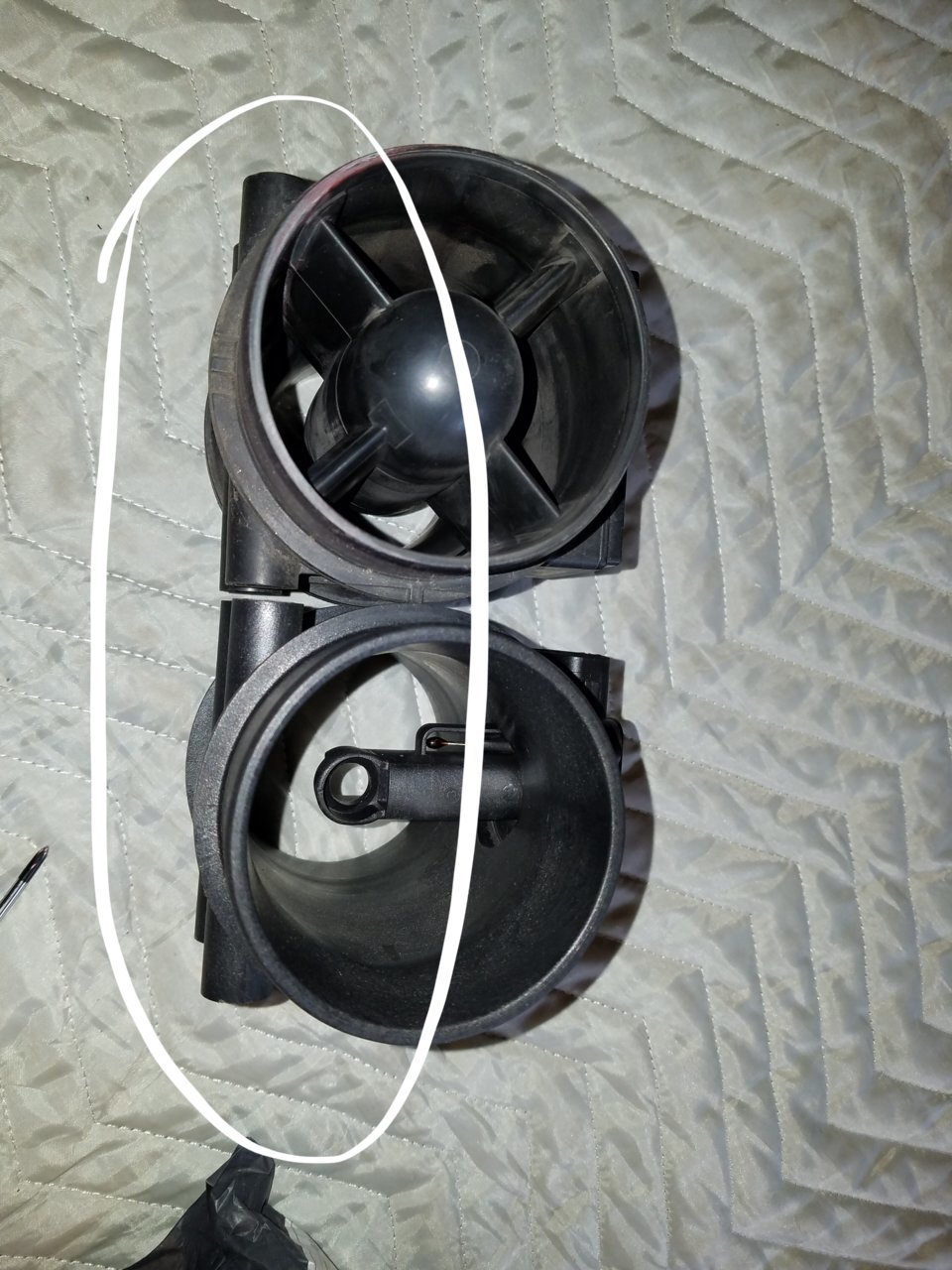

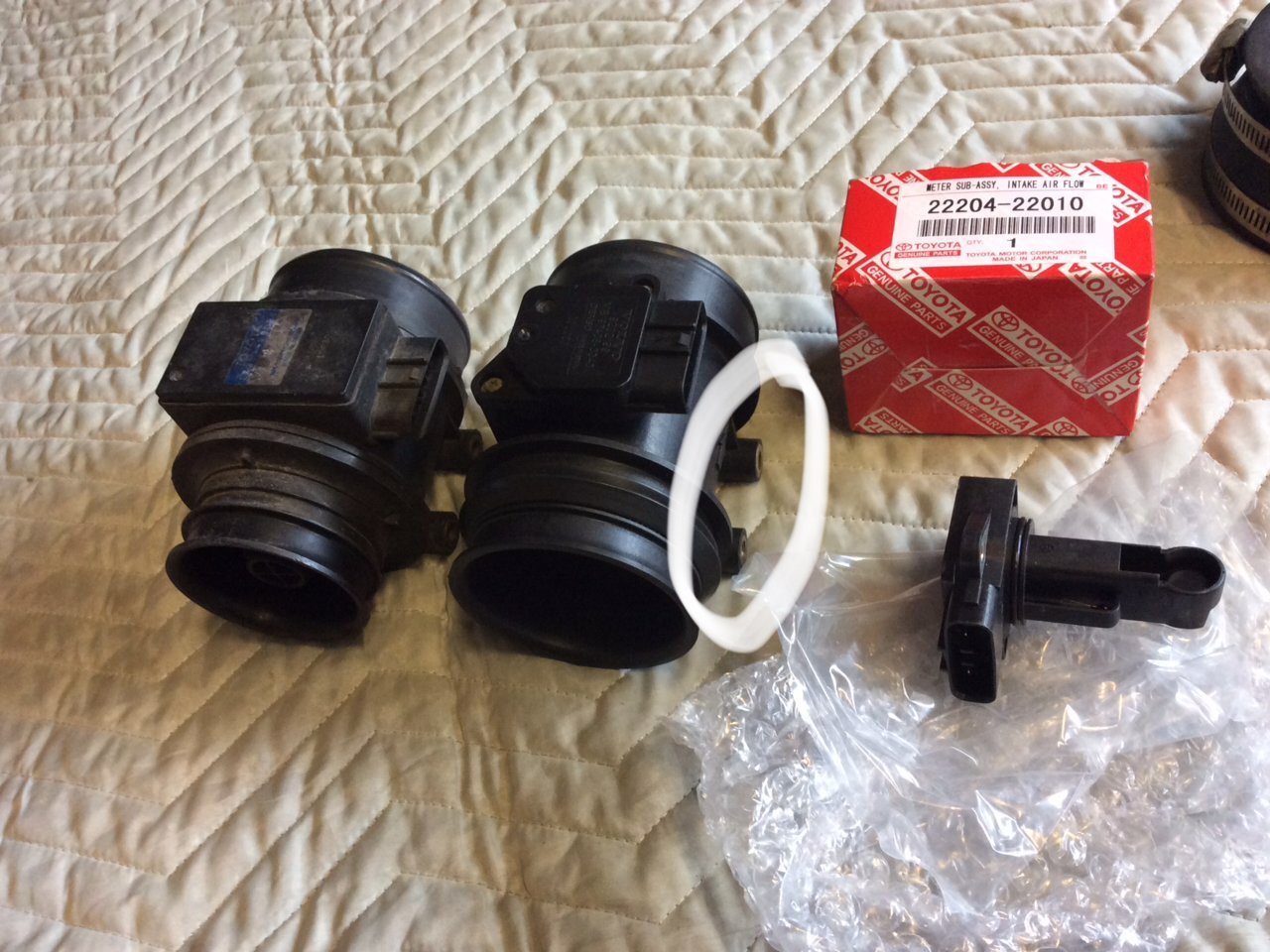

    VOLVO MAF MOD AND DESNO SENSOR MOD
    Just did this mod and is for the 1996-1998 v6 MAF motors for 50.00
    I’m putting this out there because I just found out about it and wish I had known about it years ago.
    Essentially it’s about replacing the restrictive MAF with an unrestricted MAF tube from a 2001 s60 volvo and being able to replace the MAF sensor with a 2001 tacoma DESNO sensor.
    Gained 2-3 miles per gallon with it, more pep and works perfectly

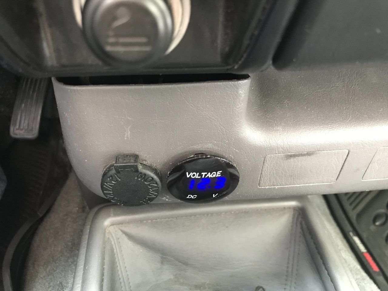

    Pulled one of the outlets out and put this in its place, because i got a usb port when i put a new radio in so I didn’t see the point of 3 spots to charge stuff. im using the wires that were already there. So its only on when the key is turned. Had to bore out the hole some for it to fit.

    got one of those for mine as well only mine has two usb ports in it which is nice see'n how as i use the usb in the radio for music.

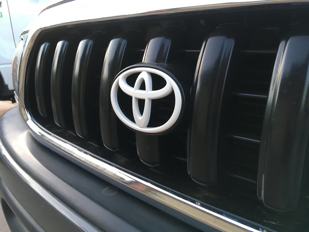

    Painted my toyota logo white

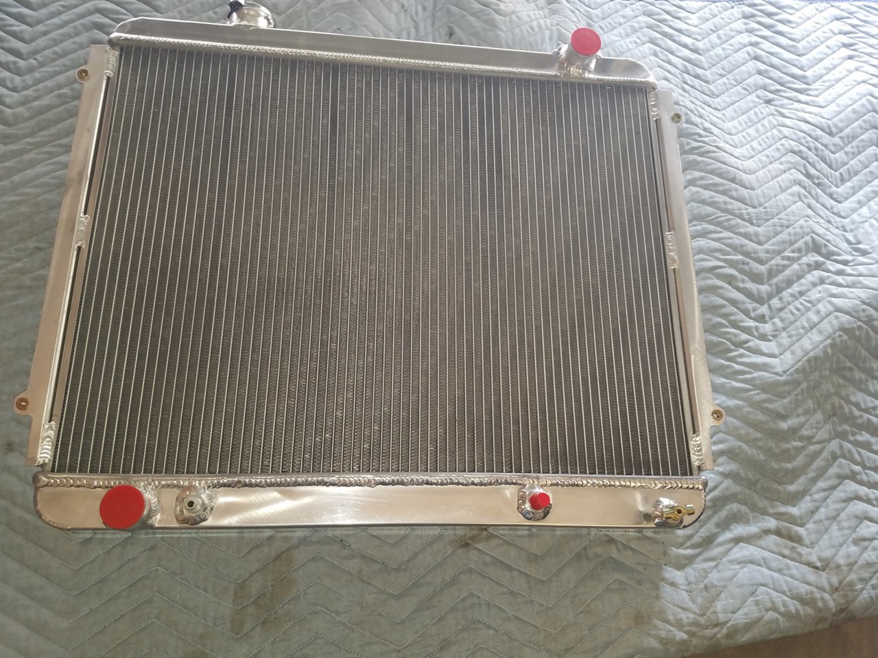

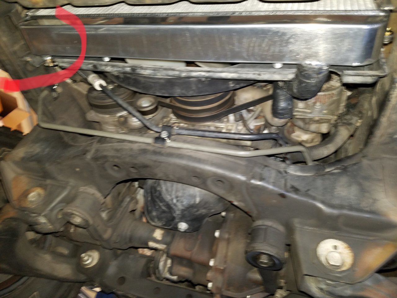

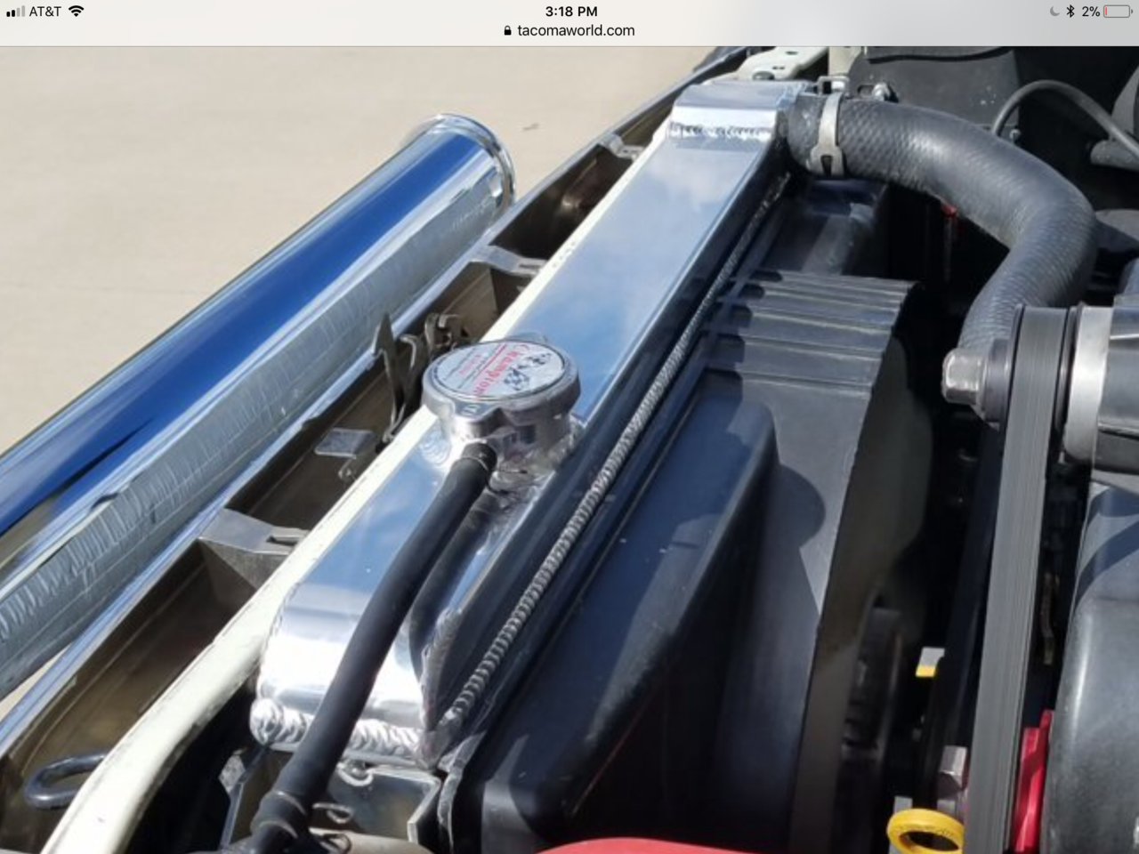

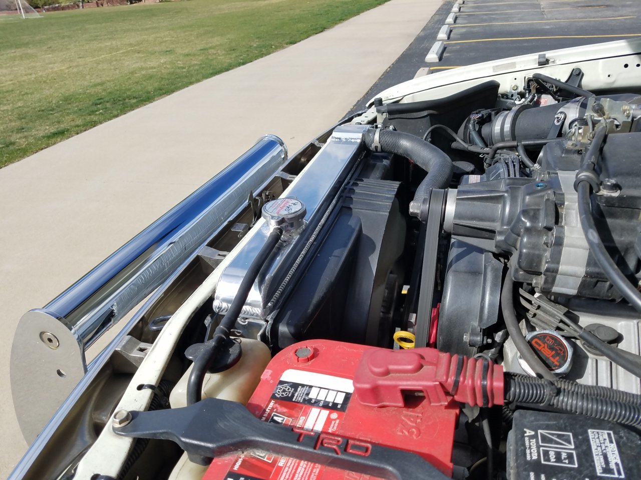

    Got my new Aluminum 3” thick compared to the stock 0.75 Radiator installed today.
    All aluminum, no plastic tanks like the stock ones, :)
    Has 3 cores Compared to stocks 1 core.
    Metal petcock, not plastic
    Copper petcock valve, not plastic
    Brass bolt sleeves for attacking radiator
    Tig welded
    Heavy duty radiator cap too
    Radiator now sits in between the frame rails and not below it.
    Quality is over the top on this one!!!!!
    When you see them side by side you will se what a piece of junk the OEM radiator is.
    Come on summer :)
    AND IT LOOKS BEAUTIFUL TOO

    Hot dam.. who makes that? how much?
