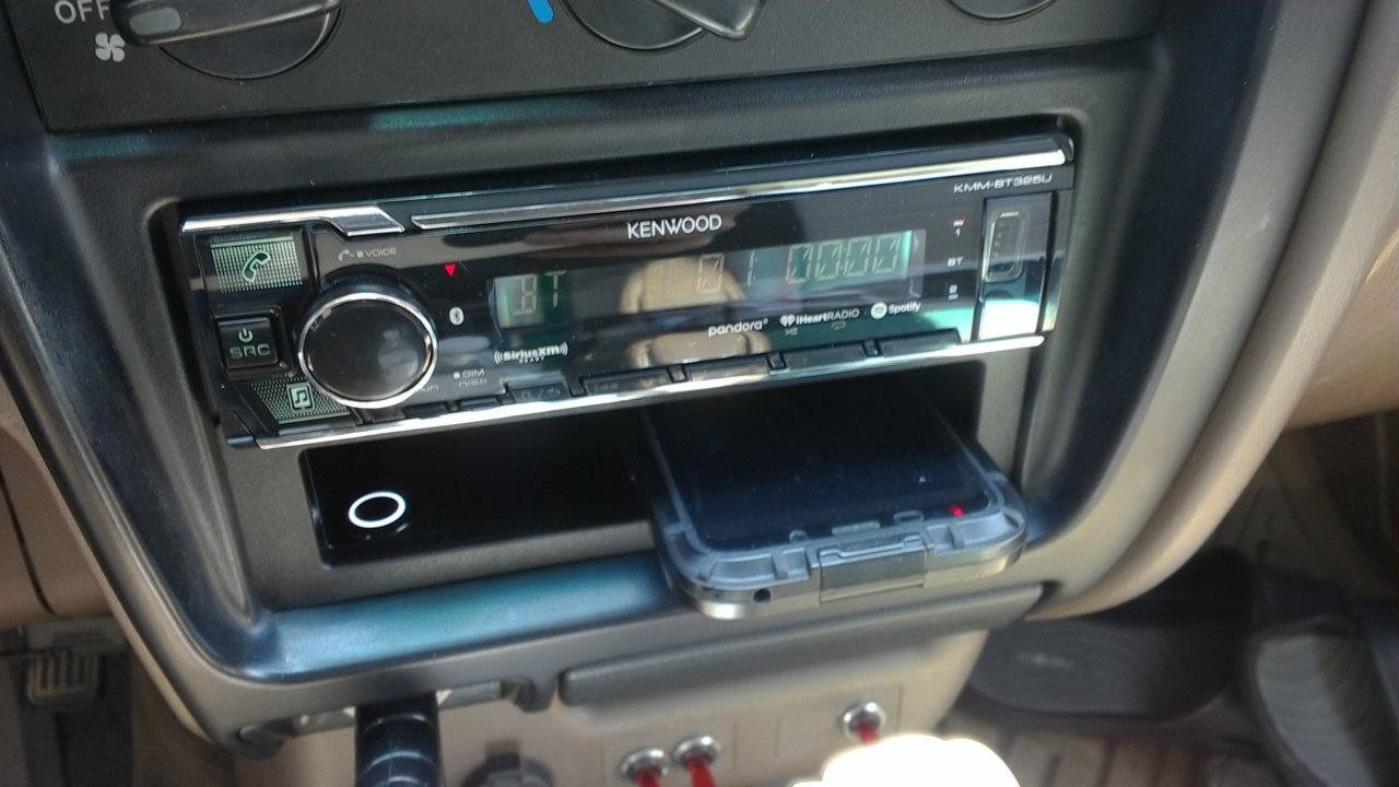

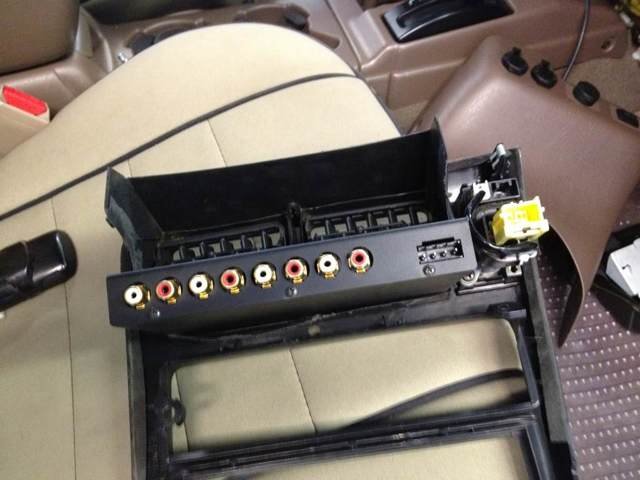

    Added wireless charging while updating my head unit. On/Off with a momentary pushbutton and fails to Off with loss of power (When I shut off the truck).WIN_20190707_14_04_31_Pro.jpg

    Couldn't remember where I got this idea until I looked back far enough in this thread. Thanks for the inspiration, sir!

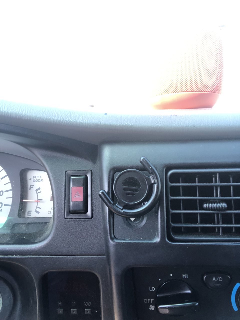

    Here's mine. Standard popsocket mount. Simple & effective.

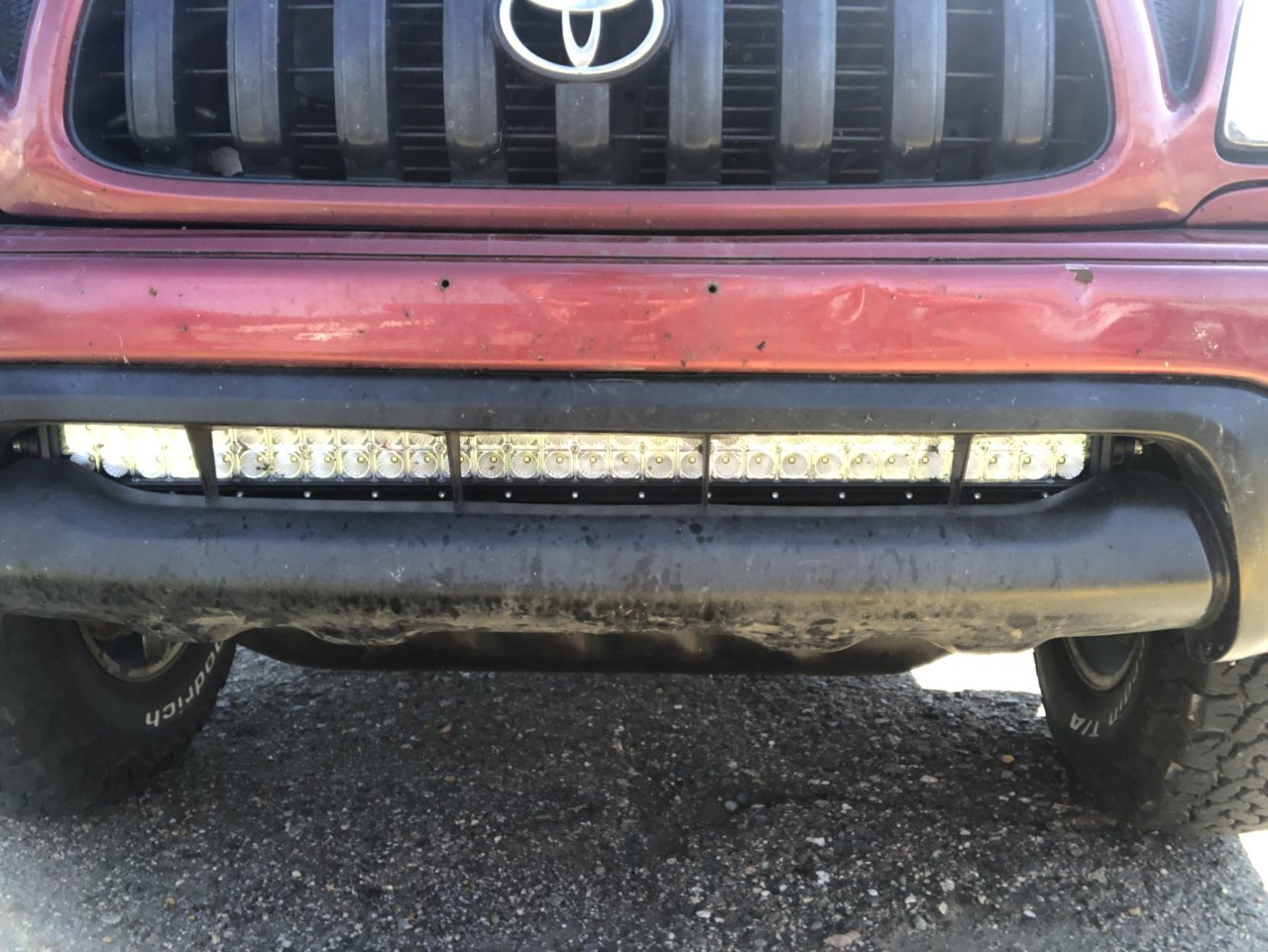

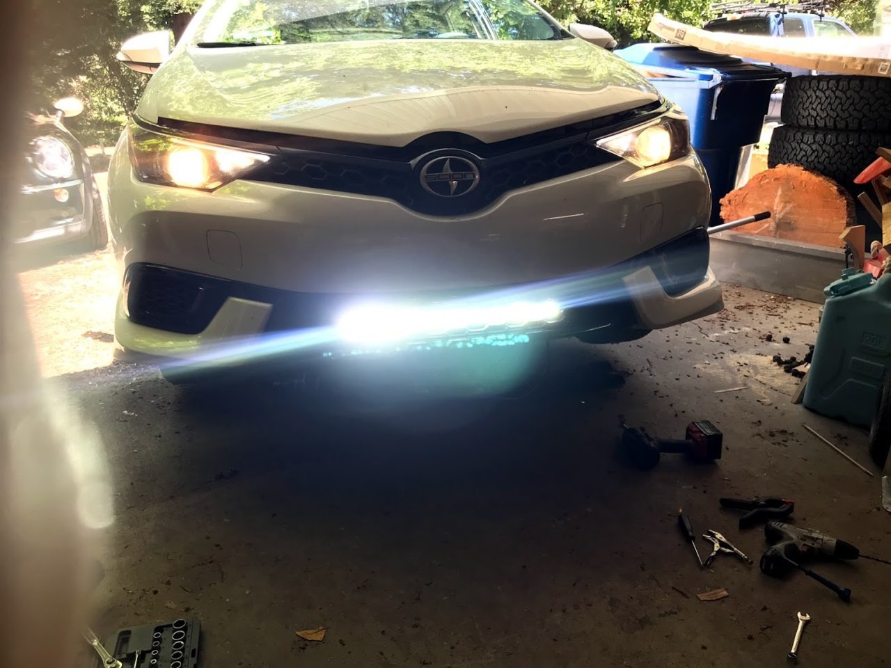

    I did something similar on my Scion. I live on a super twisty road with no street lights and I leave for work at 4:45AM. The head lights on this car suck. The high beams converge about 100 feet in front of the car. There is zero light around corners. the head lights are only udjustable up and down, not side to side.
    The lightbar fixed that.

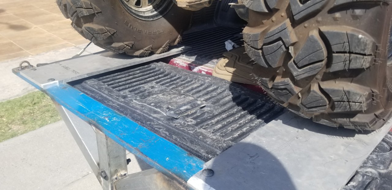

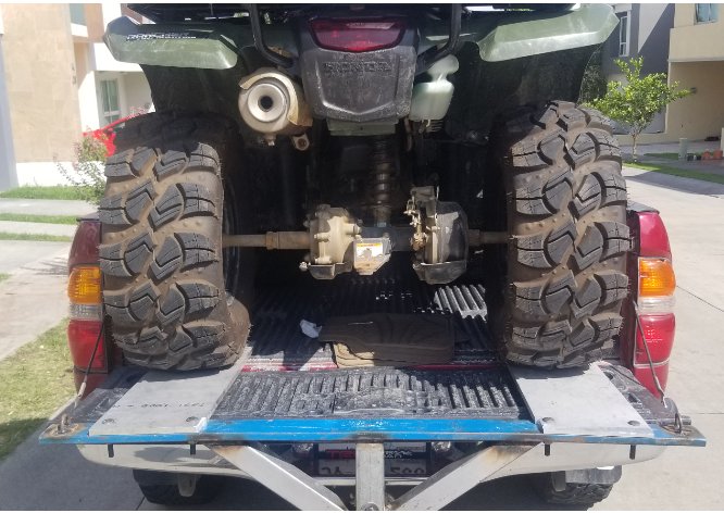

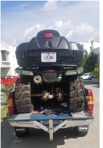

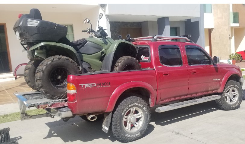

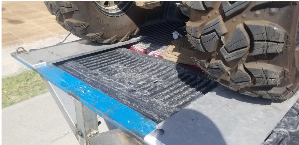

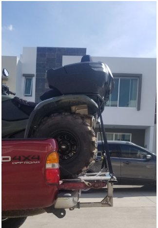

    New safe tailgate homemade for my rancher 2013 420cc

    NICE!

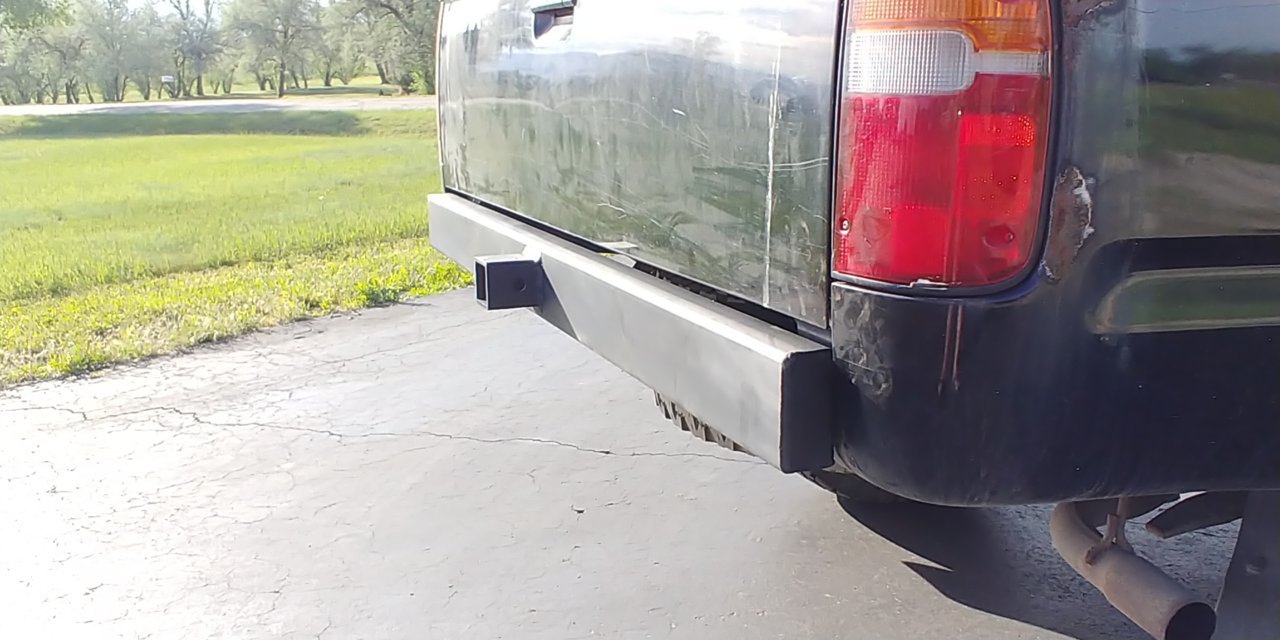

    0621191343.jpg Put in Blue Sea Dual USB and a 12 Volt locking outlet. I put them in the factory locations in replacement of the original 12v plugs.0602191803c.jpg and my own personal take on a "high" clearance rear bumper to get a hitch to carry my bike rack when Burt is on mountain bike duty.

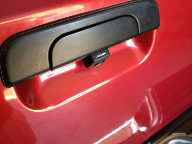

    Genius! I've been trying to figure out where under the tailgate to install mine. I was thinking too low. Ty ty :cheers:

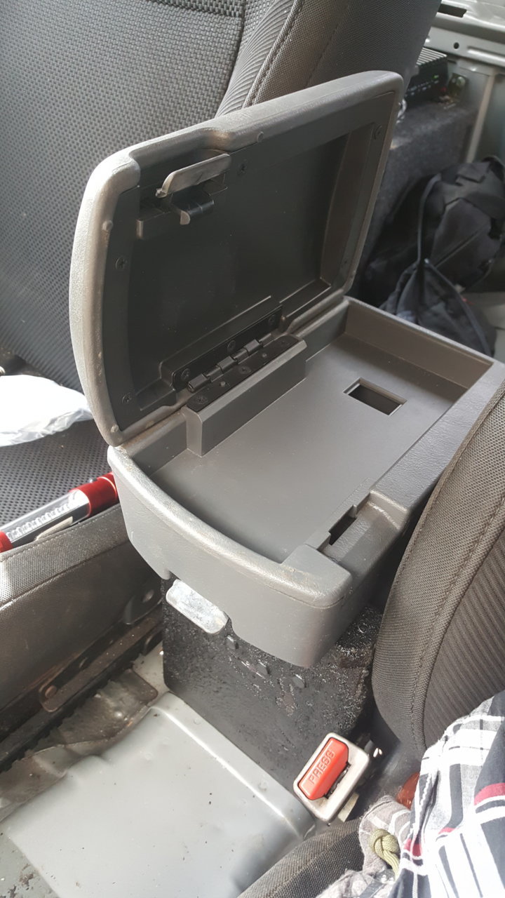

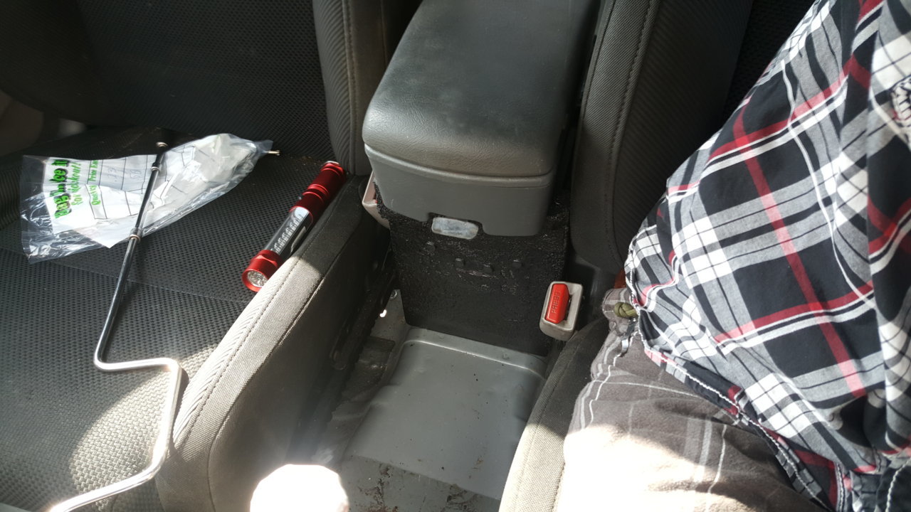

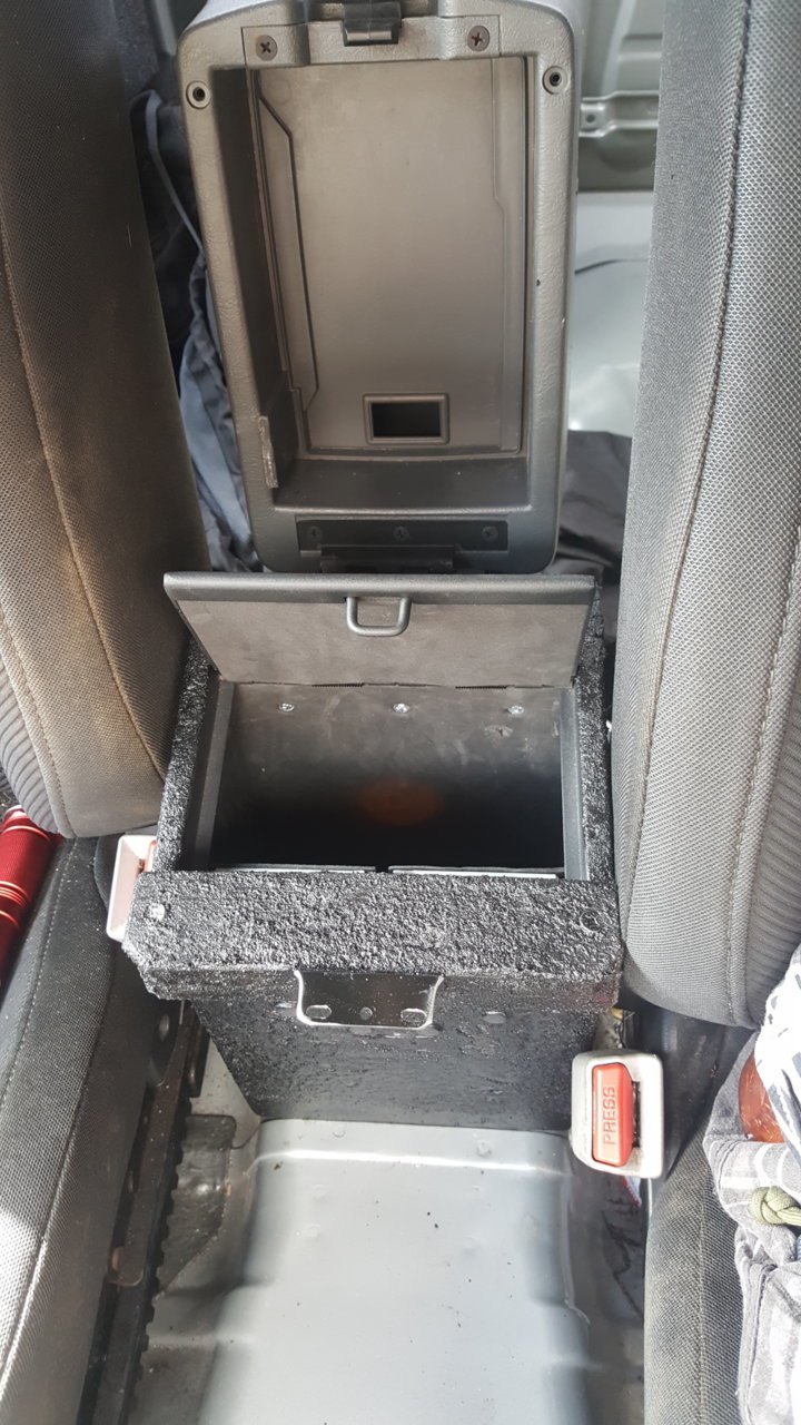

    Custom center console safe. Painted in herculiner and bolted to body, center console from a Nissan pathfinder and fully functional!

    What seats are those?? Those bolsters look super comfy!

    WRX seats, out of my buddys 04 Subi

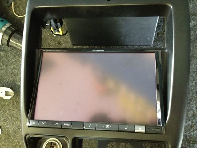

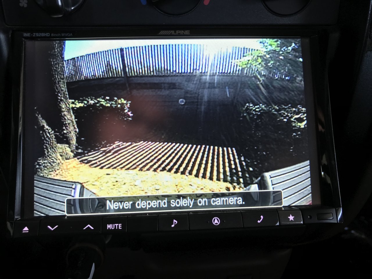

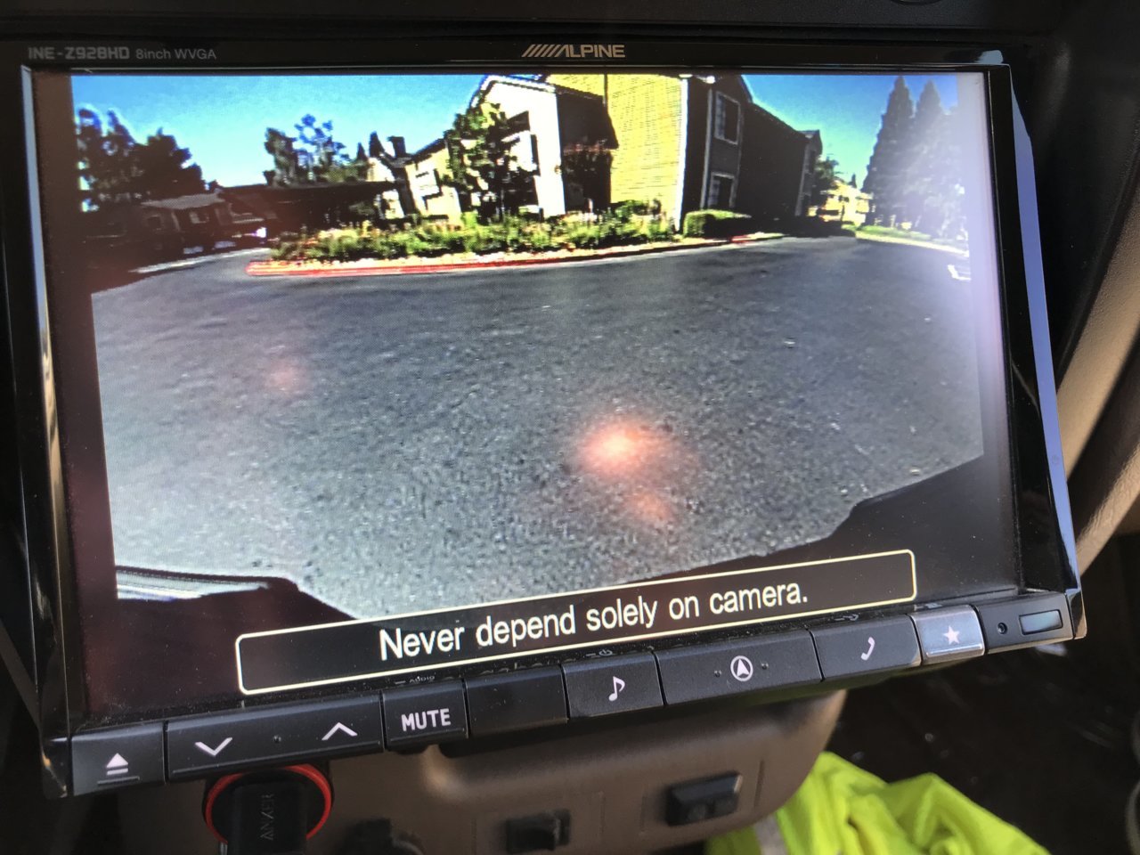

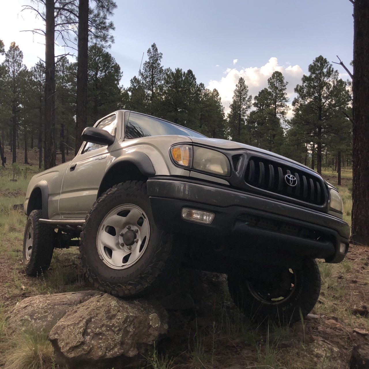

    A lift, some wheels, some tires, some performance, some cosmetic and then audio.

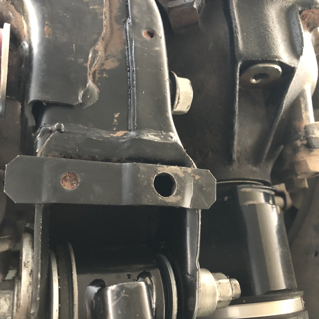

    A common problem with first gen 4x4s is the factory skid nut plate. Its super wimpy and the welded nut usually strips out. Often people drill the nut out (as in the first pic) and run a nut and bolt, which is what I planned on doing. After some thought, I decided to go the bomber route and grind out the stock nut plate completely and make by own burly nut plate (second pic). The nut welded to the top of my plate is a 7/16" 20! The reason I went so big is that I have a custom 3-piece skid that weighs 100-lbs and my truck isn't lifted much so I tend to drag it. That's my unique mod.

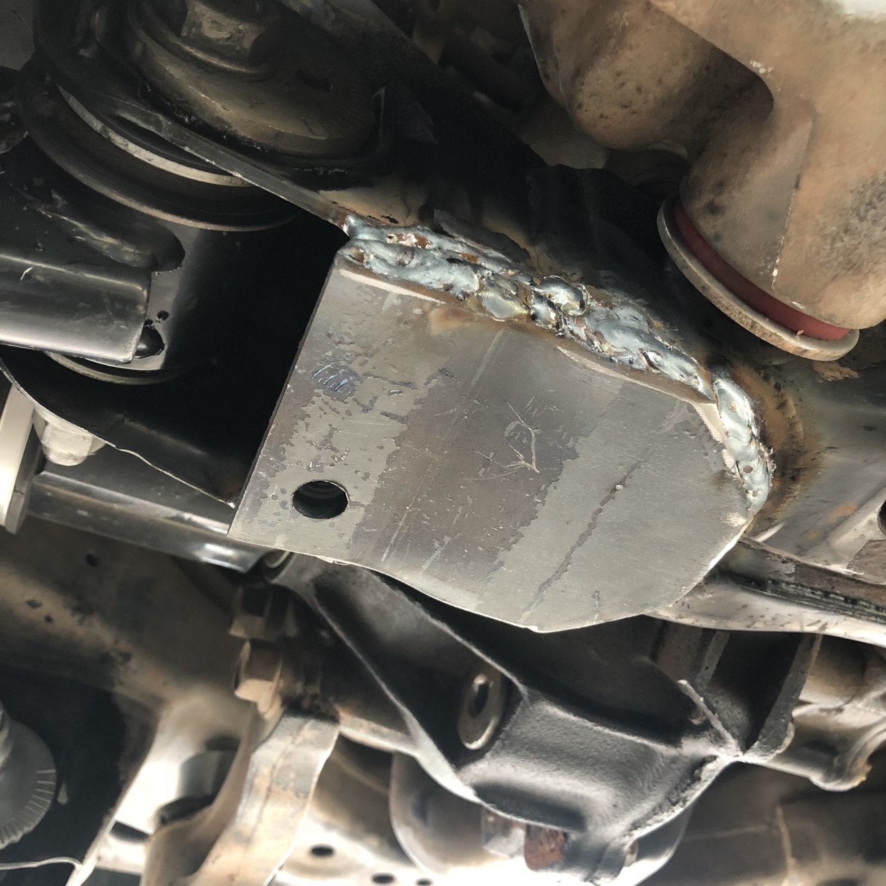

    Drop bracket lift and booger welds
    I did something similar after my straps ripped off in Moab. Very happy with the new versions.
    3/16" bent into place and welded on.
