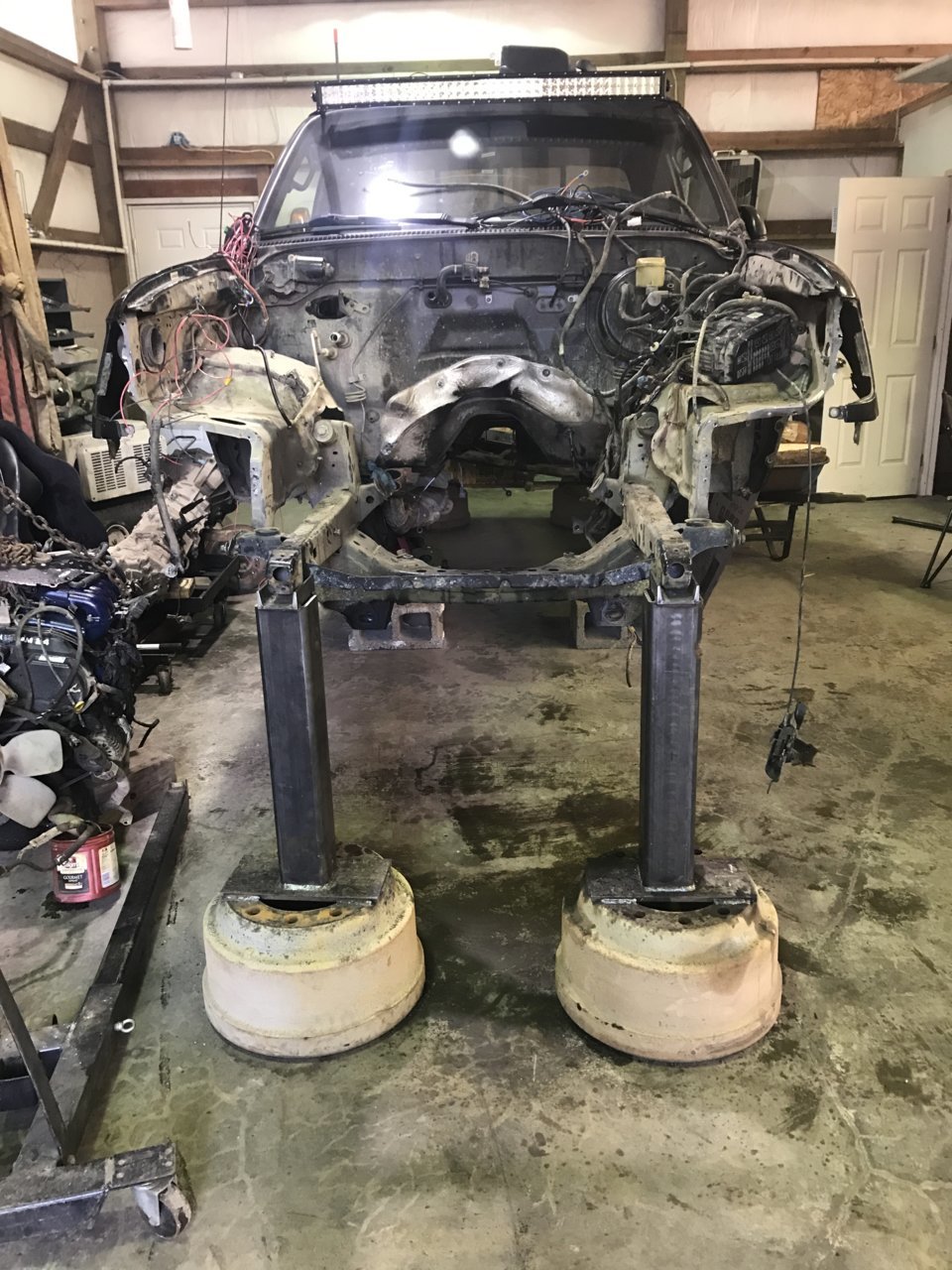

    My unique mod... Toyota drivetrain and powertrain delete... 51E38721-0973-4087-94D6-D69F2CF834BB.jpg

    Gas companies hate him, see how to save 100% in fuel costs!

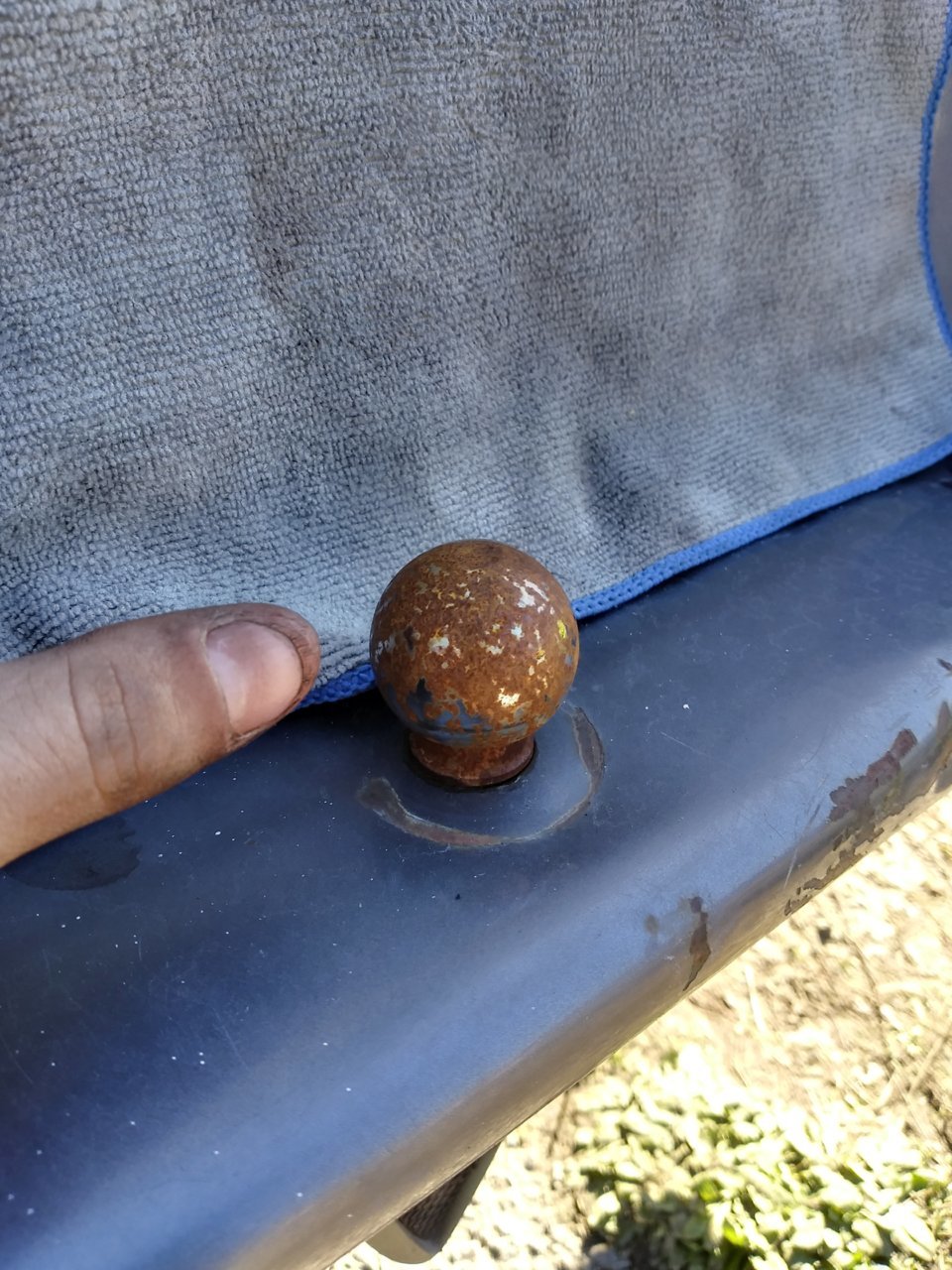

    Exaust and cutout
    I put an 3rd gen ball joint as my tow ball #minitowball #minitaco
    Perks to working in a shop lol

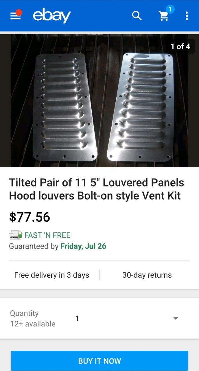

    Where are the louvers from? Looks great!

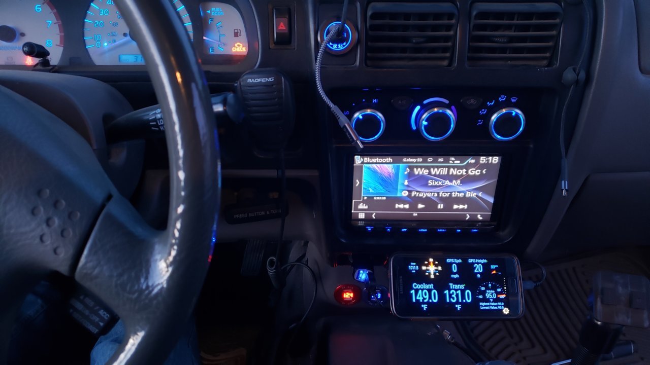

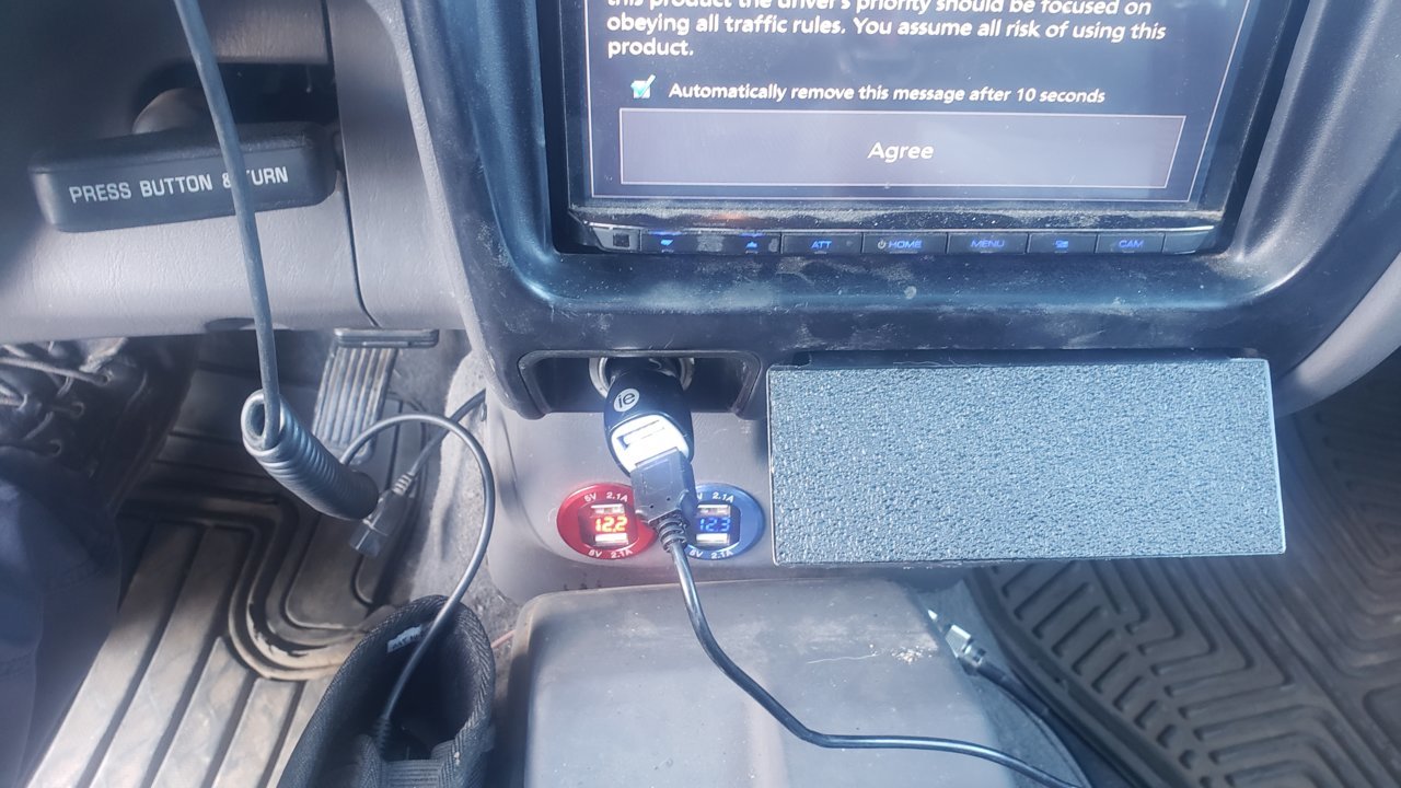

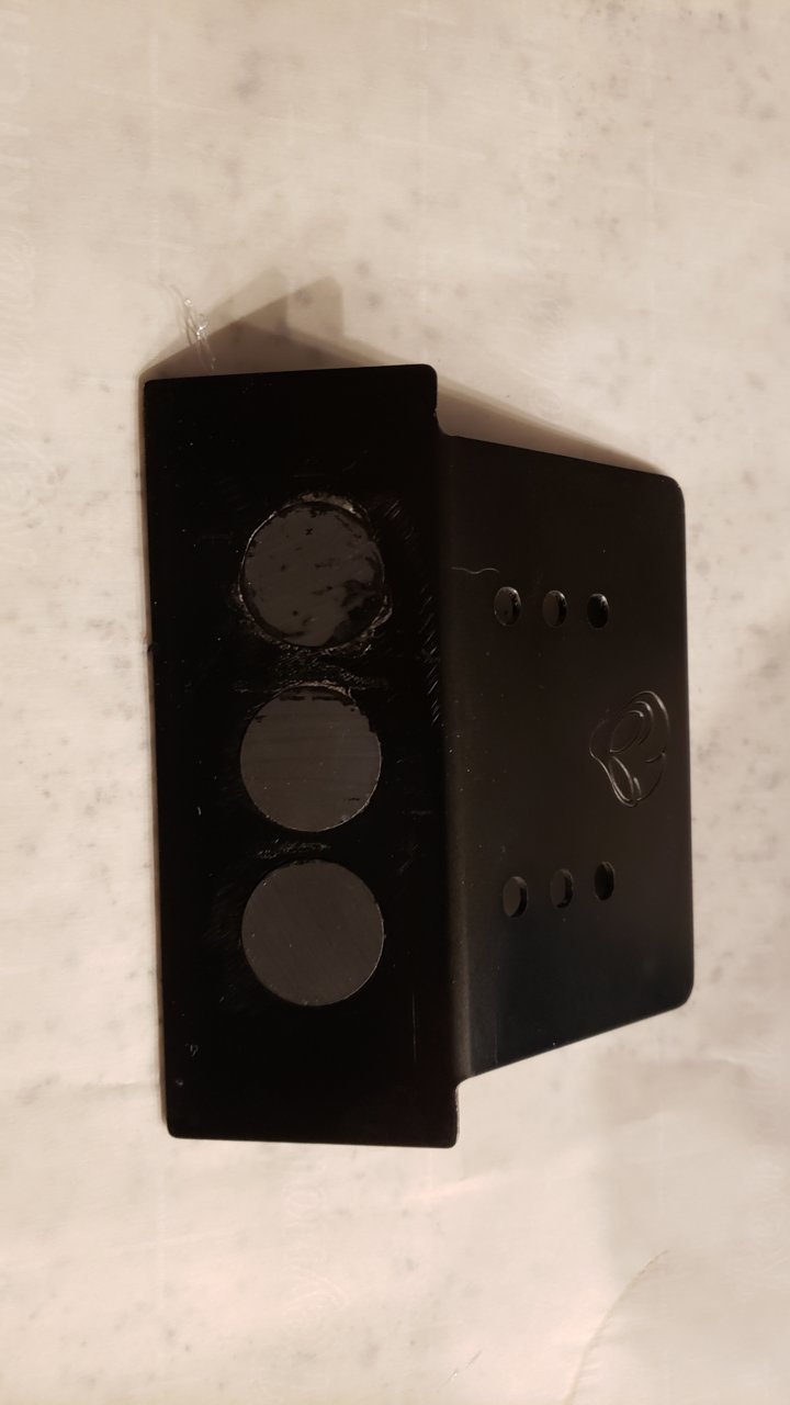

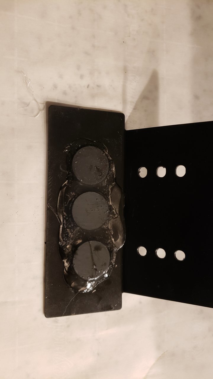

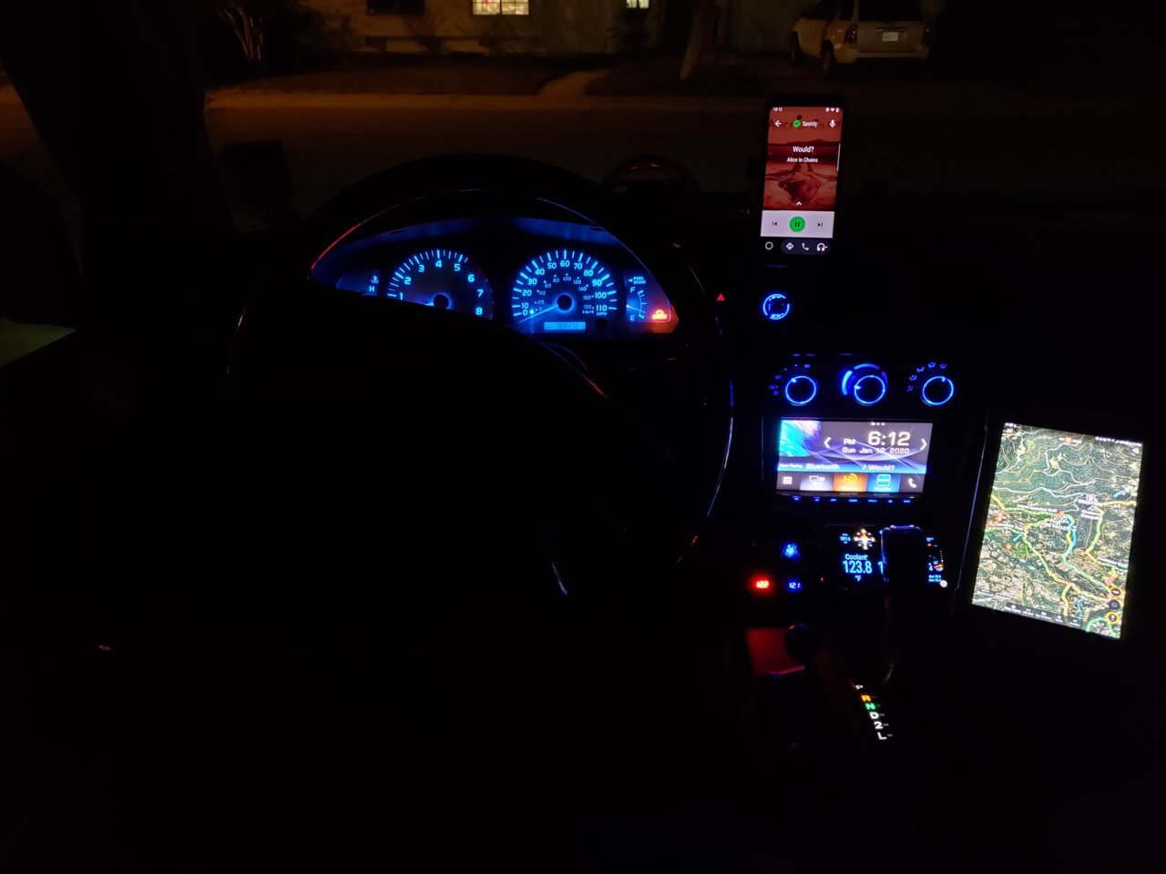

    Had a mounting bracket, from Paranoid Fab, I wasn't sure what I wanted to do with. When I ordered it, I asked them to not cut out the holes for the switches (to give me more options)
    I had some magnets laying around (everyone loves playin with magnets). They were 1 inch round... so I drilled 1 inch holes in the bracket.
    And mounted the magnets with some automotive goop (good stuff)

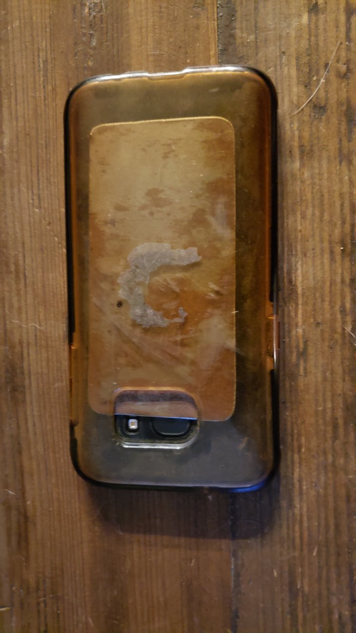

    Then I cut me a piece of sheet metal and put it in the phone case of an old phone I had layin around.
    Mounted the bracket in place of the ash tray... (now where the hell am I supposed to keep my pack of smokes?)
    Then, via a bluetooth OBDii reader and the Torque App I can monitor my temps and other stuff.
