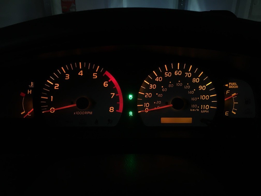

    Maybe I'll get hit with the double post, but I added indicator lights to my clusters to tell me if my backup light or front off road lights are on.
    I'm not sure how unique this mod is... haha.

    Definitely unique!
    especially the penis light :D

    Well it is the backup light indicator.... perhaps an FU to the person tailgating me. It was all part of the plan of course.... [​IMG]

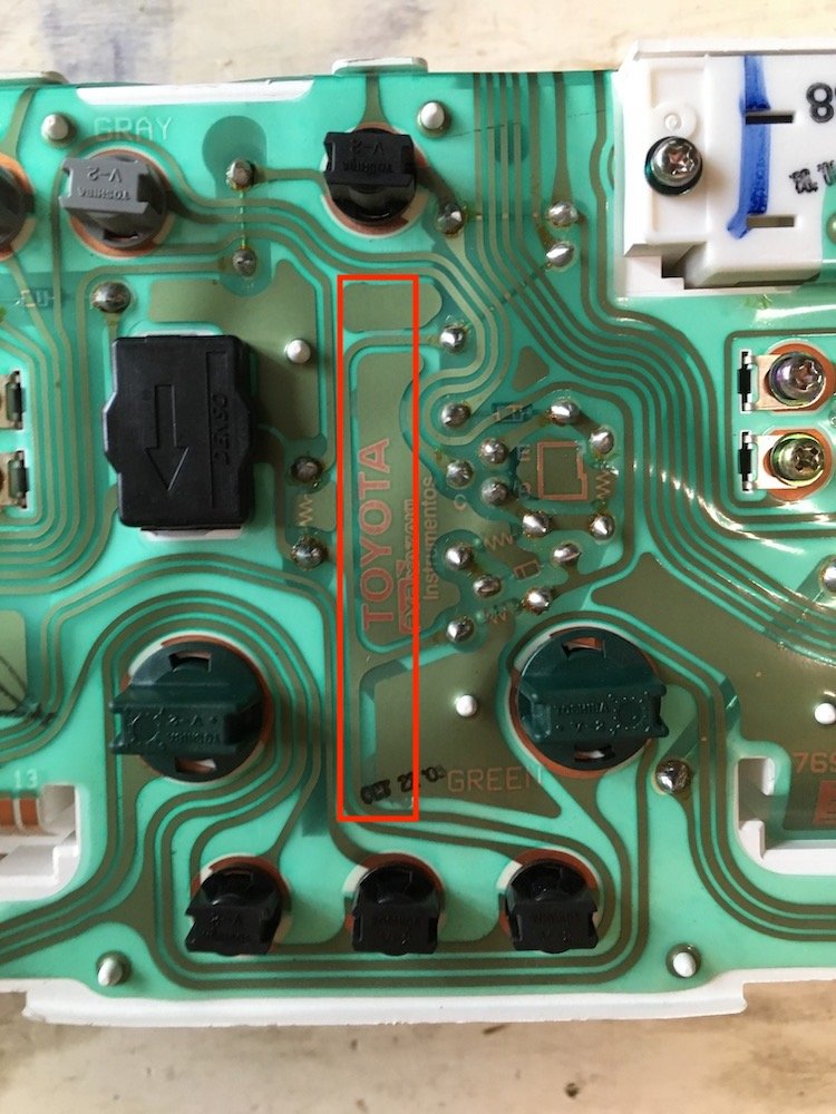

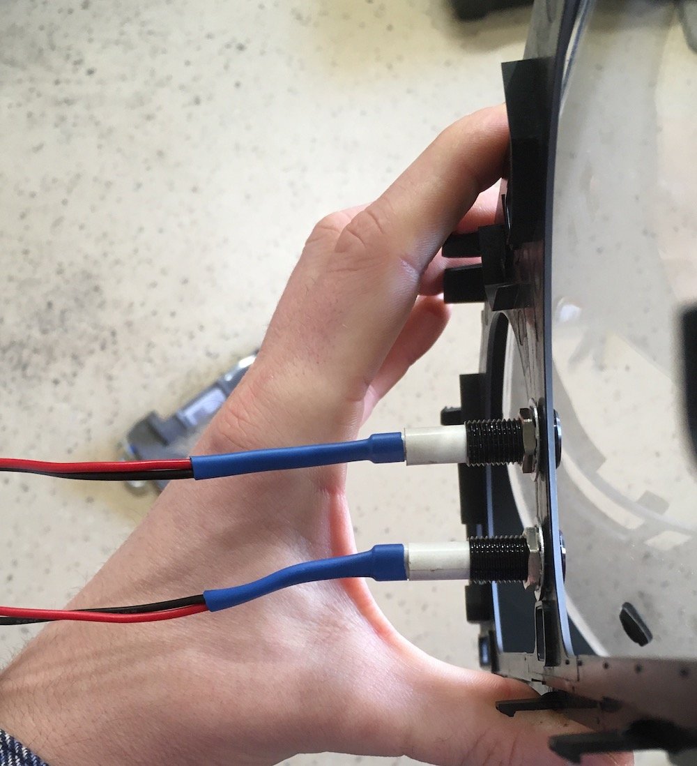

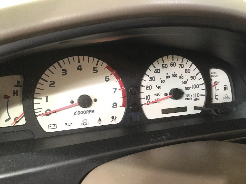

    If you could find lights small enough, you could potentially add them yourself. One of the issues I ran into with those indicators is they were a bit too large and long. In the cluster, there are boxes for additional lights. I bet Toyota uses the same casing for different vehicles and adds lights, gauges, etc. as needed. If you could find the lights to fit here you could do it. Of course, finding a cluster with them already in it would prob be easier. This is what it looks like to give you an idea:
    IMG_0703.jpgCover and Cluster. As you can see there are 6 wedge type bulb cut outs in the center of the cluster for potentially a P, R, N, D, 2, 1 scheme. I used the 4th and 6th position to place in some indicator lights. Mine lights were too big to fit right next to each other so I had to leave a space in between.
    Back side of cluster, you can see the wedge cut outs in the center
    This is how I mounted the lights. I cut small holes to in the circuit board (making sure not to break any circuit paths) to allow the wires to pass thru and provide a little clearance for the bulb stems.
    Hope that clears some stuff up.
