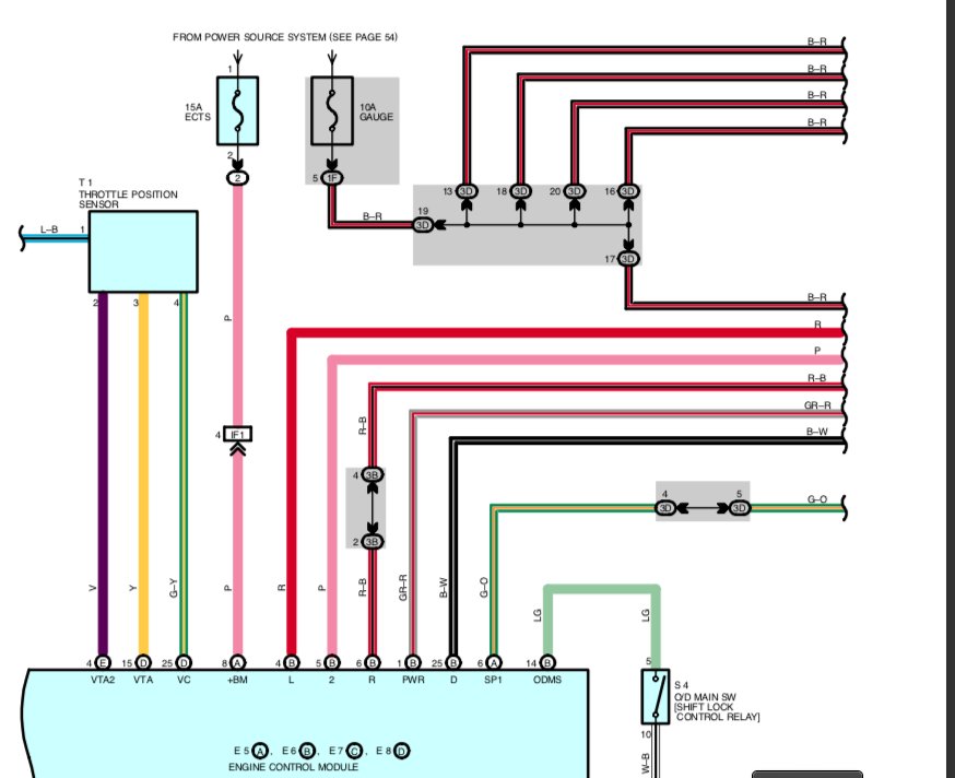

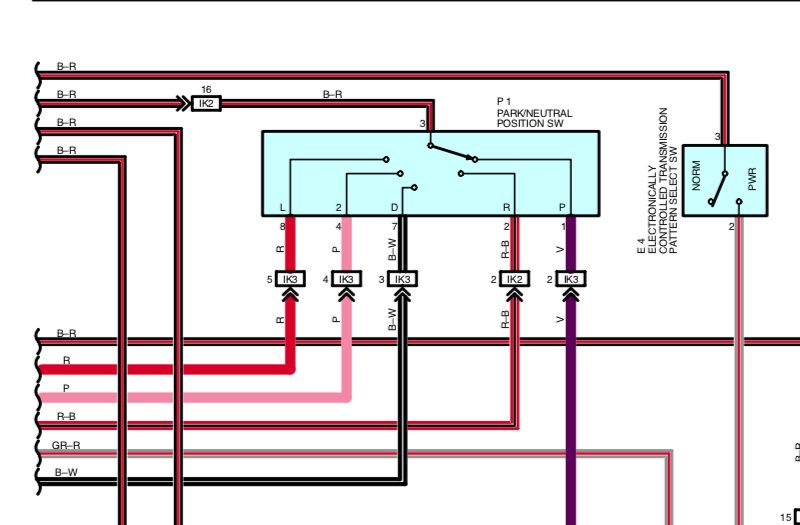

    This might help. This is from a '03 Wiring manual. To me it looks like the shifter receives 12V from the circuit with the "GAUGE" fuse. Then the shifter outputs 12V to the respective shift positions inputs on the Engine Control Module (P R D 2 L), each fed by it's own wire. Perhaps those lines could be tapped for the power side of an LED?

    the EWD for the trucks that had the cluster lights should point you in the right direction. typically they go through a junction block that you can add more wires too to get the signal where you want it

    Yes I have the one for a 99. If you look at the attached diagram everything with a *3 is for column shift. There is a resistor pictured between the P and D indicators within the combination meter. I'm not sure why that is, maybe to make one brighter than the other?
    the ECT wire signal also comes from the A/T indicator switch, so those wires could already be near the console shifter.
    Everything seems to be at IK3, which is under the right kick panel. I just don't know if they get any closer to the combination meter or not.

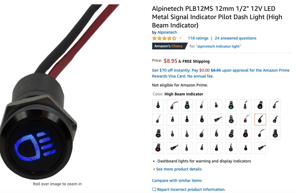

    That's awesome. I didn't know you could make those lenses just from a printer and transparency film. I wonder if any I have any unused lights in the cluster already. I'm not sure if you seen a previous post of mine that has more details on how I did it, see the quote below. I feel lame quoting myself... lol. Since my indicators are for aftermarket lights, I just wired the LED indicators to switched power side of the lights, so they come on only when the lights are powered. The lights themselves are similar to these ones, but I bought them on alibaba express since they had more options.Screen Shot 2020-05-25 at 3.56.50 PM.jpg

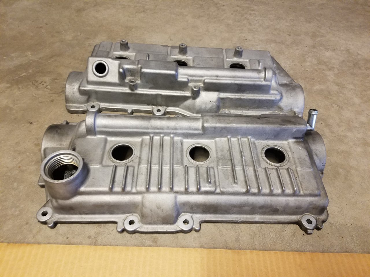

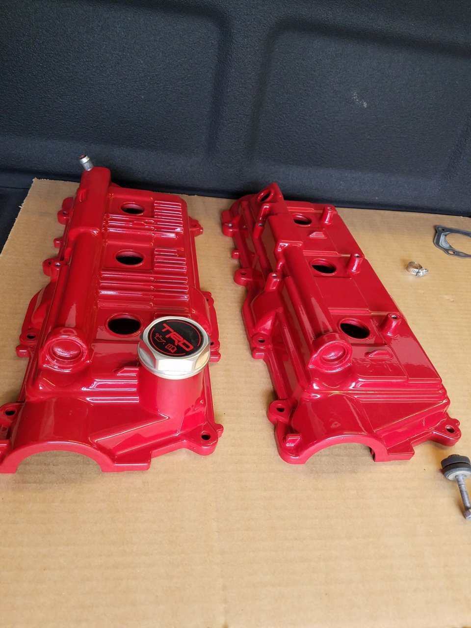

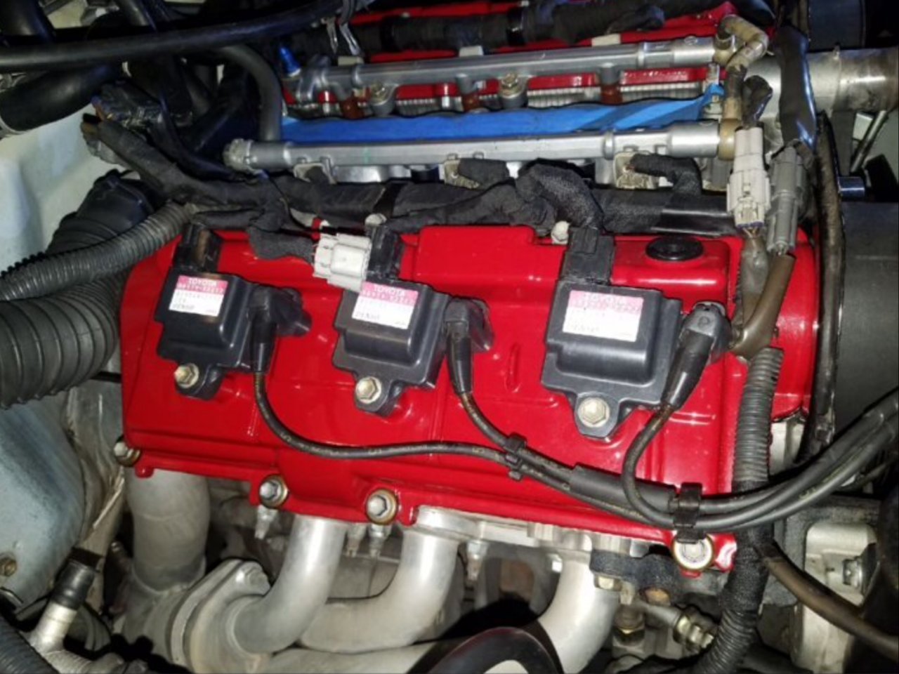

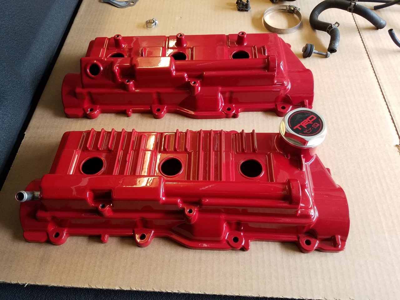

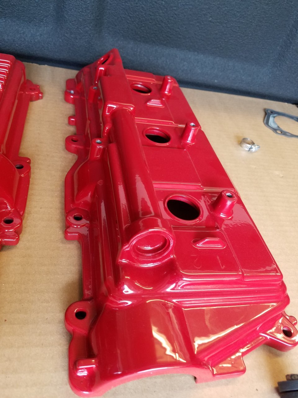

    This has been done by a few others,
    Had them professionally painted for 100.00
    A nice upgrade

    That will brighten up the engine bay :D

    that's not powdercoat is it?

    Yes it was done as Powder Coating, which is done electrostatically
