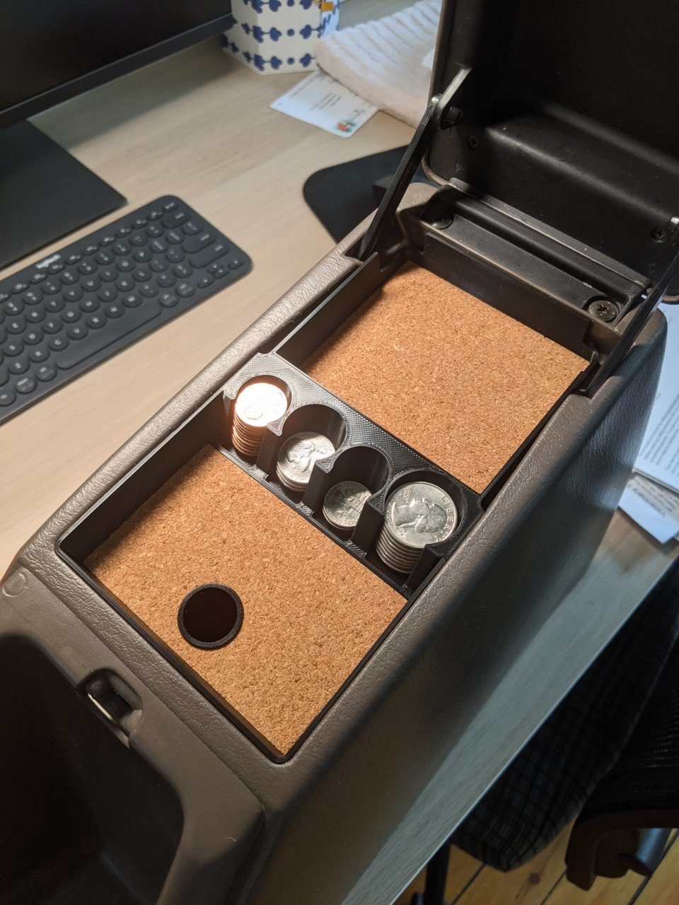

    Hi all -- new to TW but wanted to share :)
    As a relatively new owner of a first-gen Tacoma (1997, woot!) I came to realize that there isn't much of a grassroots 3D modeling/printing presence for our trucks. I personally was looking for a center console organizer, globe box organizer, etc, but couldn't find any companies making them.
    So I set out to design and print them myself! It has been a blast and I'm still working out the details so I'll post updated images of the prototypes as they develop!

    Thanks team!
    Also made this coin organizer that slots into the ashtray bracket, though maybe I should make a cover to hide all the coins from passerby? :p

    Agreed, but he is new. Welcome to Tacoma World!
    Most of us on this page are running out of mods and looking for non-plug and play ideas to share. mostly custom fabrications.
    please forgive us...We are bored

    every time you hit a speed bump :p

    100%. I like to think that the things I make are mostly for... people with an acute sense of humor.

    is there any other way to go through life? Keep at it man! What printer are you using? I’ve been thinking of dabbling in it.

    Again, 100%.
    I use a few but for these Taco objects I've been printing on an Ender 3 V2 with PLA filament. The printer has quite a bit of mods on it (parts I've ironically made for it on the printer itself) but it's a trusty machine. For some more custom/curved objects that I want to look injection-molded I go with the Formlabs 2 resin printer. It's just really messy and the upkeep is strenuous at times :)

    I'd recommend ABS or ASA for interior parts and ASA for exterior stuff (UV resistant). Good chance of PLA getting soft or warping on a hot summer day.

    Sorry -- I misspoke. I actually use PETG on my parts but prototype on PLA until I get the fit right :) I've stayed away from ASA because of the fumes, but in my experience with it it turns out really, really nice (and as you said good for exterior)
