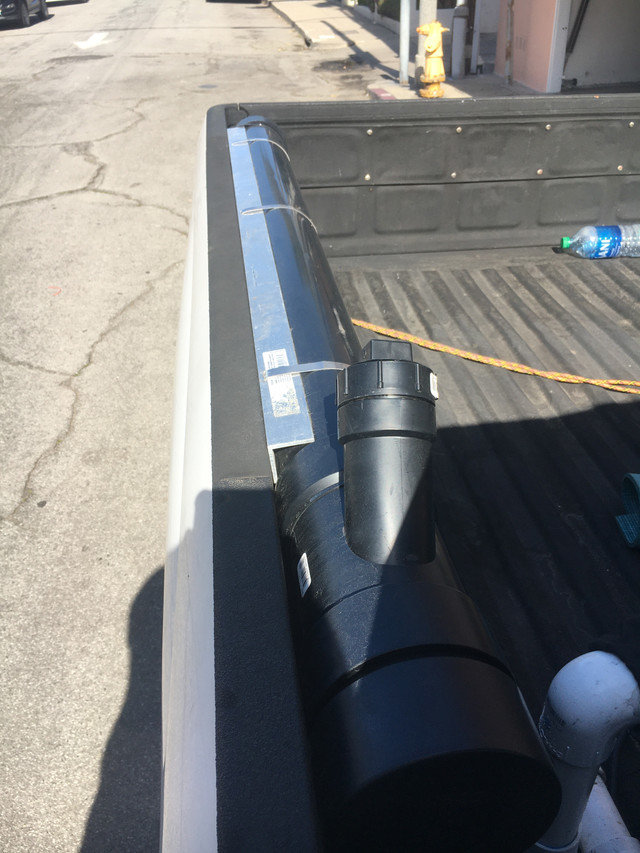

    I installed a powered, heated shower in my 99. Electric pump recirculates water through an under hood heat exchanger, thermostat in glove box ensures I don’t overheat the water, and now I have a 110f shower for winter surfing and camping. V3.0 will have more capacity and a tank under an upcoming camper shell bed setup.

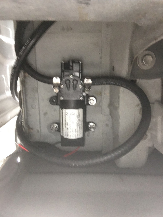

    I mounted the pump down beneath the front right side of the bed, just drilled through and mounted it upside down to the bottom of the bed. Water exits the front of the reservoir tube and runs to the pump, then gets sent through the heat exchanger and enters back at the rear of the tube so the temp gets mixed up well. When you close the lever valve on the bottom back of the reservoir tube, that circulation stops and you get 30psi of water out of the quick connect fitting in the bed. It will shoot 10-15’ out of a normal garden hose
    4-FAD845-F-25-B5-4132-8349-8-ABC5-FB667-_1bf6eeacbfb0ab47a482728efbe8435e752b3b10.jpg
    traced the plumbing for the heat exchanger up the right side of the frame into the engine bay. Cut into the heater core lines and plumbed the hot side of the heat exchanger with shutoff valves in case anything starts leaking.

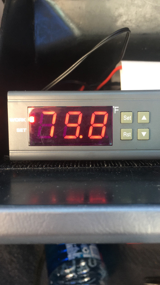

    12v thermostat for aquariums mounted in the glove box stops the circulation when the temp gets to the preset. The probe is mounted on the incoming fresh water line just before the heat exchanger.
