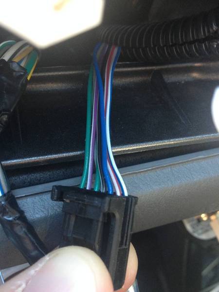

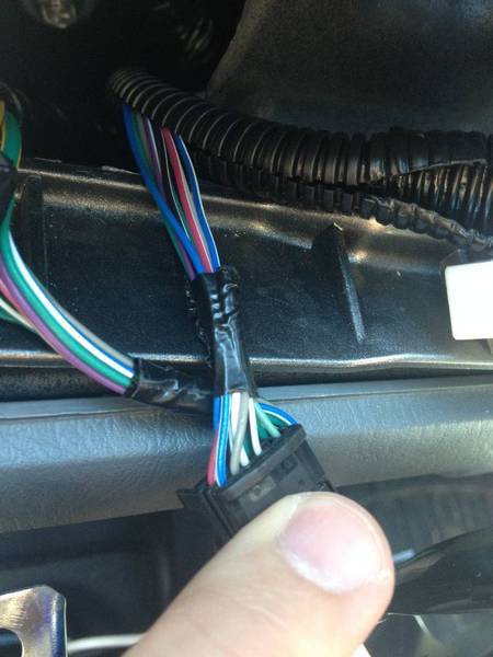

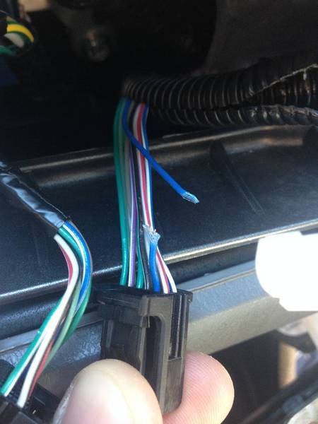

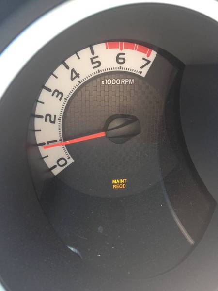

    So I decided to knock out the TPMS disappearing sensor light mod today. First off the DIY that was posted isn't completely describing exactly what needs to be done.
    First get a putty knife plastic or metal doesn't really matter ( I used a metal one). Slip it under the left side of the A/C controls and pry and that corner will pop out. Then use your hands to pry the right side off then the top right corner and left corner. I then disconnected the harnesses (2). Ok here is the part that I didn't know when reading the other thread. He took off the entire front portion that the A/C vents are in, after taking out the radio. I unscrewed the 4 screws to the radio and just pulled it out far enough to sit it near the passenger seat. I then pull on the right side of the A/C panel/vents and unpoped it from the dash a bit and never could get the left side done, so I just left it like that. You will see the blue sensor box once the A/C controls are out put the harness to it needs to be disconnected which is not to hard using a flat head screw driver to push in the clip and push down. I don't recommend trying to get it with your hand as its at the bottom and you don't have much room to put your hand in there. Once you pop it out then cut the correct wires and use the wire clamp thingy to put it back together. I ended up once everything was complete having my wife use her smaller hands to plug it back in as I couldn't get my hands in there far enough to line it up and push the harness back in. Took me about an hour total. Here are some pics of what it all looks like.
    No TPMS light on any more!!!! Woooohooooooo
