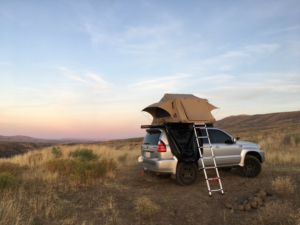

    Looking forward to seeing another built GX with KDSS. Though it restricts your travel, the ride and handling it provides is awesome. With just under 3" of lift my GX still corners like stock.
    Jonathan's GX is pretty cool. Hopefully those 37s aren't going to bite him in the ass.
