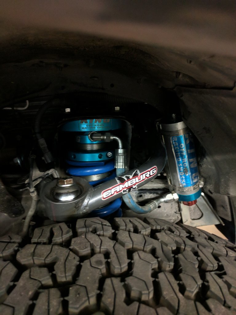

    I know. I haven't forgotten about it. Had class all day and then spent the evening with my parents and girlfriend. I'll get some soon! Want to get out tomorrow and find somewhere to test the flex too. Apparently it has a lot! Pablo told me the UCAs hit the coils at full droop. My only thinking is that had to be with the KDSS swaybar disconnected. But I guess I'll find out.

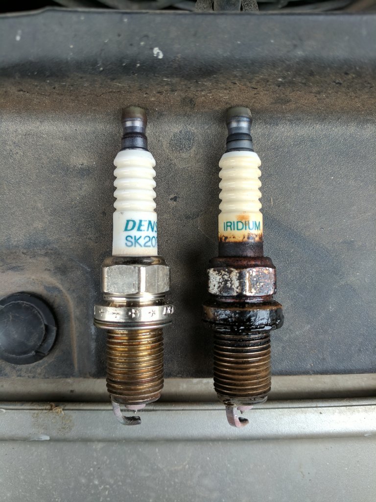

    Two of the plugs I pulled out. The two middle plugs on the passenger side looked like the one on the right in the picture. The other six all looked like the one pictures on the left. First thought was valve cover gasket. But I noticed those two plugs were quite a bit looser than the other ones. So I'm hoping that's the cause for the oil. I'll pull them and check them after my trip next weekend and go from there.

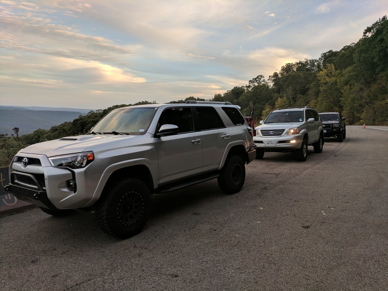

    Got her loaded up for an "expedition" this weekend. Heading out tomorrow for the Ozark National Forest and Buffalo National River. Time to use it for what I bought it for.

    Stopped for a quick leg stretch on the Pig Trail just north of Cass, AR.
