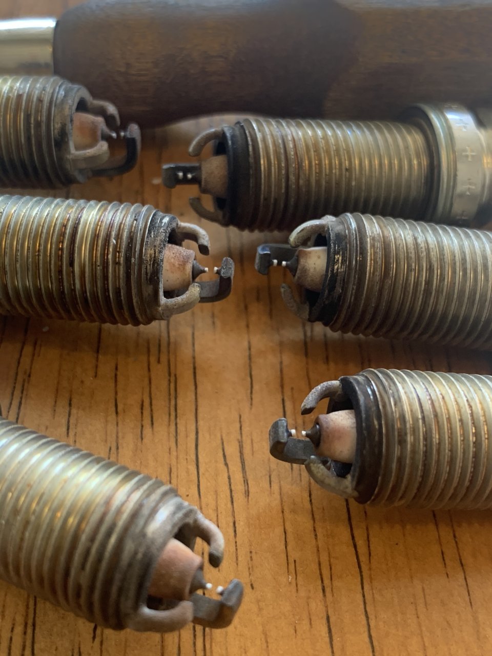

    It appears to be quite common, I read it here on this forum too. I guess you could mess up the sparkplug coil from blow-by. How's is that possible on the assembly line to not have them torqued just right?
    Is there a way to tell if you have loose spark plugs without removing cover and taking coils out...maybe a poor idle or jitter of sorts ?...BTW, the vehicle on YouTube channel Toyota Maintenance was a 17 Tacoma.

    From the folks that have posted loose plugs, esp @Hank Heel , who had a really bad one, they had no performance issues:
    https://www.tacomaworld.com/threads/psa-check-your-spark-plugs.673098/
    My guess is that it is due to the long, spiral leak path. Even at idle, the amount of leakage is on the order of ring blow by. It is an accumulative thing.
    Because of the reports, I checked mine and all were good except for the uneasy feel of the long, dry threads. I used antiseize and the low end of the torque range.
    There is a chance that it might not have been the factory? Someone posted that plugs can back out from detonation. That is pretty speculative though.

    It's not quite common at all. But, I have disdain for long spark plug intervals because of stuff like that this.
    I would discourage someone with limited experience to retroque them simply because they could be loose.
    Also if its a 16 or 17 just change the damn plugs while you're in there.
    Usually blowby on plugs or oil causes misfires or coil pack failures, both can trigger a warning light.

    I am only at 35k. LoL! The plugs looked great, as did those for others that I saw. One person was at 90k and found the right side plugs loose when doing the scheduled maint. Just some coloring on the insulator and coil pack. @Hank Heel was the extreme case so far.
    To trigger a CEL, it has to hit a threshold. That small loss on each ignition will be small comparatively.
    Also IMVHO, if folks have enough mechanical skill to deal with the left side plugs, I wouldn't worry about them checking their own. As these are long reach plugs, there are a lot more threads than typical. I would always recommend a torque wrench though. I'm a bolt snapper without one, so I just know better and use it religiously.

    I only torque now, I used to torque by hand but the 4.0 V6 spark plugs on tacoma used to break with the slightest over torque on me, 2-3 times. So I started to torque every plug and haven't looked back.
    The drivers side is the challenge, and I know of many DIY'ers that bugger up the 10mm threads on the coils or the brackets.

    13ft lbs for these specific plugs. A dab of anti seize on each plug would go a long way as well.
