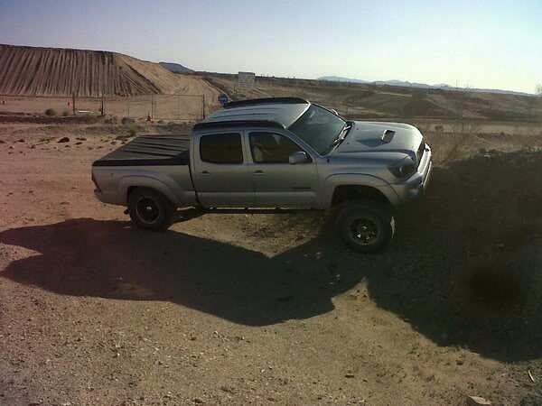

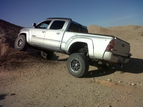

    Some flex pics with the Allpro standard pack. brake lines still have slack and shocks are not getting overextended.
    I'm hitting bumps before shocks and the rear tire fits nicely into the wheel well.
    Im planning on going with extended brake lines but added a spacer to the rear for the mean time.
    also bought some cheap lights and wired them as reverse lights. I linked them to the trailer harness so they come on automatically when i shift into reverse.
    Just splice into the yellow wire.

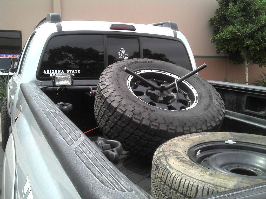

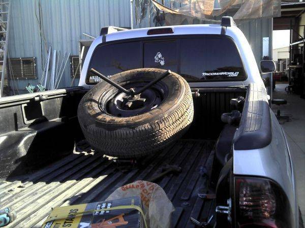

    Got a tire carrier for the bed.
    Bought a full size spare as well.

    Nice David, what carrier is that?

    I believe it was made by Bovad, a fabricator in Phoenix.
    I like the design because it has the ablility to to swing to a 90* angle if i need more room in the bed. I just need to buy another bed bar and add the mounting points for the tire carrier. so keep an eye out in Cali if one turns up.
