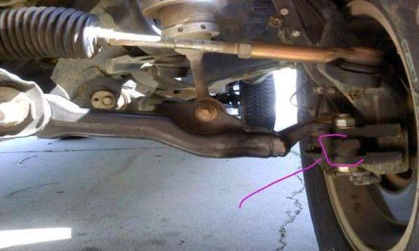

    This bolt
    is less than a 2mm gap and spins freely. It is seized and I spent an hour trying to either tighten it or removing it. I am going to end up cutting it off or welding a wrench to remove it since its starting to strip.

    when does yours clunk? i have a super annoying clunk when turning at low speeds....almost sounds like a bj shifting into place or something...anyways it really bugs me and it seems like most guys with spindles have this

    and yours is coming from that bolt? its hard to tell what bolt that is....is it holding the bj into the adaptor?
    i always thought mine was the tie rod ends or something

    It's one of the two bolts that hold the spindle to the BJ adaptor. I got it torqued into spec on Saturday but it didnt fix the clunk sound while turning.
    I first thought it was a siezed LCA bolt because i have a bent alignment tab, but they stay in place when the suspension cycles. It may be our tie rods since they have to be installed upside down with the spindles.

    i dont think thats the issue with mine...mine are double shear...i too have a bent tab and seized bolt...LOL
    my tie rods look fucked though

    XXXX made a thread about removing seized cam bolts and showed how the mounting sleeve got wore out. Since the clunk comes only while in motion, not just by turning while parked, I think it has to do with the cam bolts rather than tie rods for me
