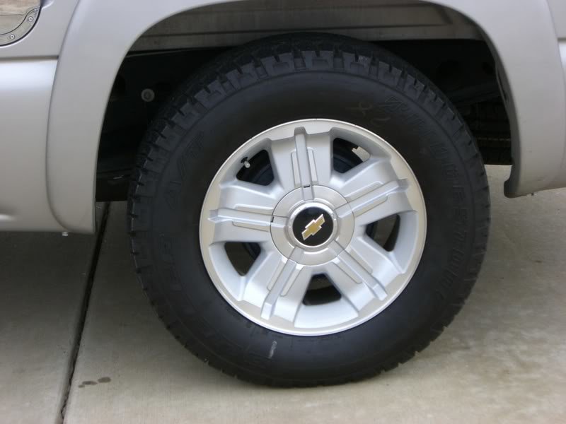

    Here's the deal. I'm looking to put some new wheels on my 2008 Prerunner and have found some 2008 Chevy Z71 wheels on Craigslist for cheap. I know the lug pattern is the same (6 x 5.5), but not sure about backspacing and all that jazz. I want to powdercoat the Z71 wheels black (cuz i think that looks sick on an all white Taco), really like the a different look, and would like the bigger tires also. Looks like they will fit by using the tire calculator. Has anyone done this or know if the wheels will fit?
    Thanks,
    Garrett

    Are the Chevy wheels Hubcentric?

    Make sure the hub bore (hole in the middle) is big enough. Chevy and Toyota share the same 6-lug bolt pattern (6x5.5), but I think the Chevys have smaller center hubs.

    Here's what I'm talking about...........see the difference.
    Toyota:
    Chevy:

    ^that's what I was talking about.

    The chevy definitely has a smaller center bore, maybe around 76mm...Tacoma's are 106mm. I just ordered wheels and learned a lot in my research.

    toyota wheels fit on chevys, chevy wheels dont fit on toyotas.
