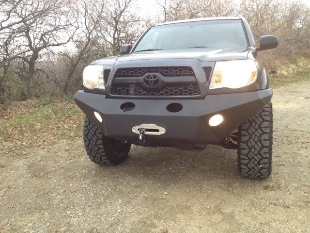

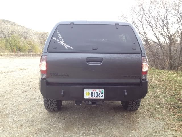

    Bumpers and sliders are done by Fat Bob's Garage. All of them are 1 offs for now although I'm guessing they'll start doing them soon. The rear bumper was something I requested. I needed the factory hitch location for my bike rack to work and still be able to open the tailgate without removing it. I'm very happy with how it turned out. The sliders I've had on for 8 months now. They've worked great off road but also saved my side door from my wife in a parking garage...

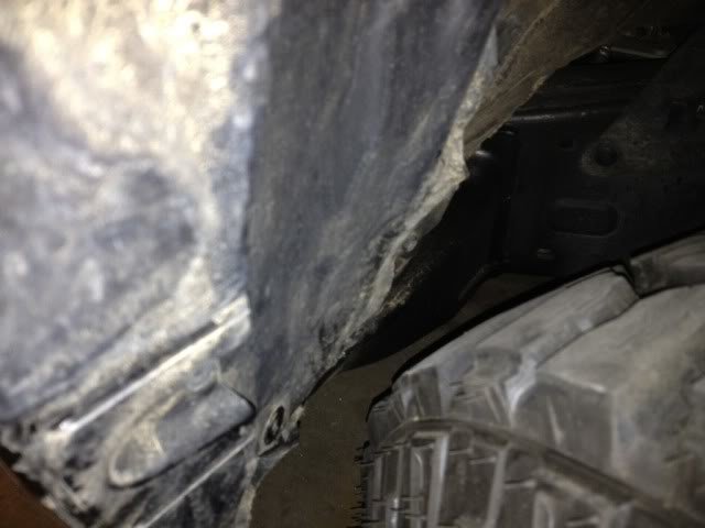

    It looks like I'm in need of a cab mount chop. That or new narrower wheels. It rubs bad right now. The Enduros that I have are 9" wide and have a -6mm offset. Something like the Procomp 7089's are 8" wide and have a 0mm offset. I believe that would fix it but it's obviously a much more expensive undertaking for something that might fix it. Any suggestions or help would be appreciated.

    So I think I have the rubbing gone. I had the cab mount chopped and pounded the pinch weld back as well as going at it with a dremel and a heat gun. Thanks to all the info on this forum. It made doing it a lot easier.

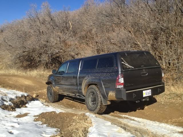

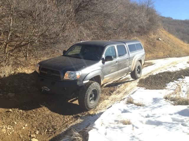

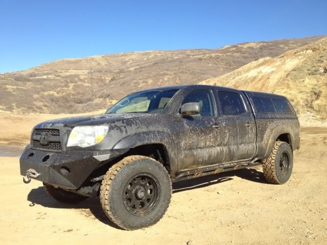

    This morning my four year old told me she wanted to drive in some mud today so we went looking for some. Had a good time. I'm pretty happy with the performance of the new tires so far. I got to try them out in dirt, mud, snow and ice. Here's a couple pics I snapped.
