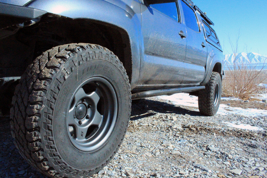

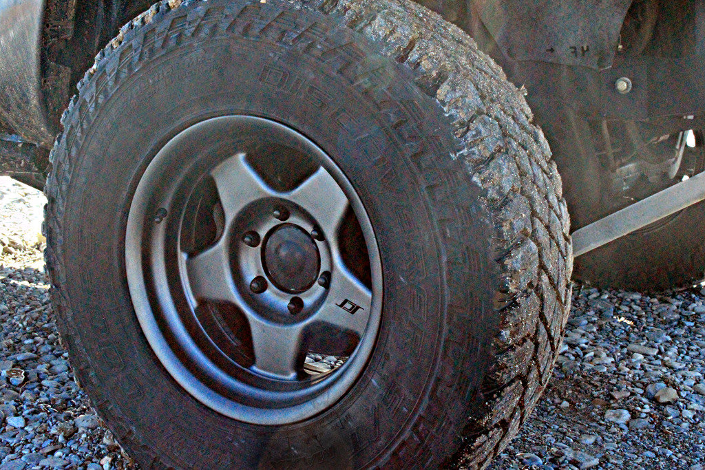

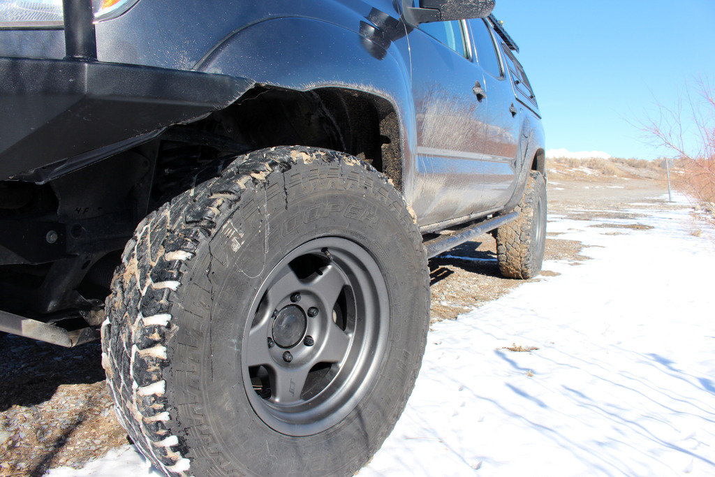

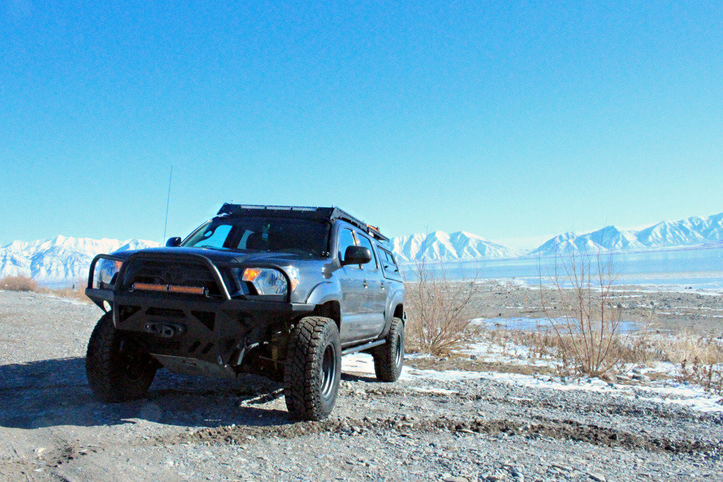

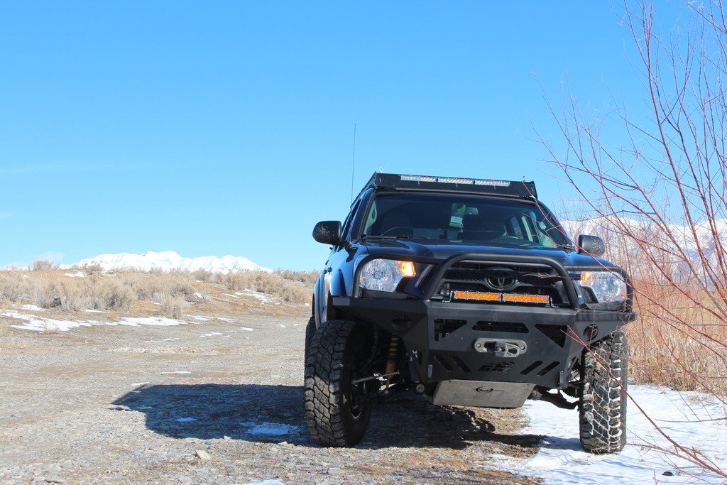

    Here are the wheels!! Ended up doing some tinkering trimming to get the rubbing to go away. Main problem was the alignment. Got looking and for some reason the techs set the passenger side with about 2* less caster than the driver. They had the driver side LR Adjustment star in the +2 setting and the passenger side in the 0 or stock setting. Something I should have checked before I left there but didn't. I did an adjustment in the driveway today and left everything as is but increased the caster. No rubbing now. I did however trim the plastic on the inside of the fender flares and do the CMC before I found that stuff out. Needless to say I have plenty of clearance now to stuff those things at any angle. Absolutely love the feel of the wider stance and definitely can feel a difference on the highway.

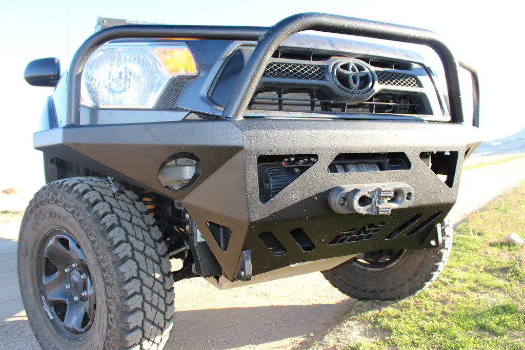

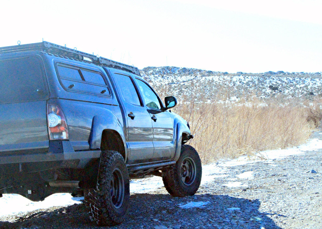

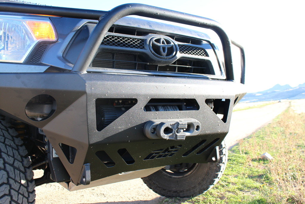

    Also, I realized I never updated this thread when I got my front bumper powdercoated and did some remodeling so here are some throwback photos. The fairlead I got from TJM was worn down and the zinc plating was starting to flake off and rust underneath causing some issues for the synthetic line. So I ended up getting a factor 55 fairlead with the extra large radius lip to help with the high angle pulls. Haven't used it yet but it is slick. Also got the fatlink pro to replace my old Pro link. Nothing wrong with the prolink but I like being able to stick a hook or larger clevis through the fatlink pro if needed.
    And a rack photo with some buffalo in the background.
