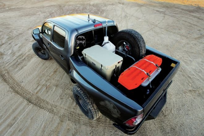

    Putting these pictures here for later. I am working on my bed space setup right now and where to put my spare tire is a big concern. I have it under the truck now but there are a few issues. 1) It contacts the rear differential under full compression. 2) It is rubbing on one of the leaf spring hangers. 3) It is really close to the exhaust on the other side. 4) I just ordered a SCS F5 to mount the full size spare on because the steel wheel I had the spare on wont fit on the truck anymore due to spindle gussets and I don't want the F5 under the truck getting beat up.
    Total Chaos has quite a bit of stuff fit into their bed and a tire carrier like this would work well. I am even considering notching the rear part of my bedslide so the tire can sit in the back corner of the bed as low as possible that the bedslide will still move around it.
