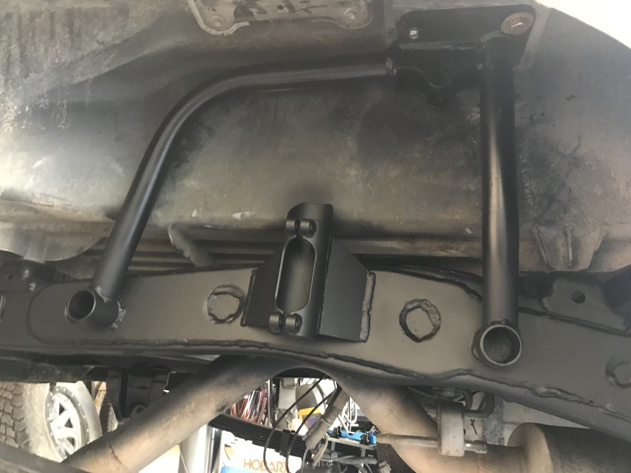

    This build has been pretty stagnant for awhile. With the sale of PRINSU to CBI though I have slowly been getting some more time to work on my own projects. The first thing was to rework the rear suspension. I finally got everything in last night. Haven't had a chance to drive it yet but here are some pictures of the mounts all in and painted.
    Custom under the bed shock hoops. Frame reinforcement plates. Air bump cans, etc. The hoops are 1.5" DOM, with 1/4" plate mounts. They bolt through the bed shelves and have a 1.75" DOM crossmember that ties the two hoops together. In the picture I have some tabs welded to the cross hoop that bolts into the front bed channel. Still deciding on whether or not I will be keeping it.
    Pictures of the shocks and bumps stops are coming tonight. But right now I have 14" x 2.5" King smoothies in there with 6" up travel and 8" down travel . I am using the all pro expo extreme leafs which don't cycle the full 14" but I was able to get them to cycle 12" in the garage with the jack.
    Bump stops are Fox 2.0 x 3" travel. Should be a good setup for my uses. Taking it out this weekend to do some hunting and should be able to put it through its paces.
