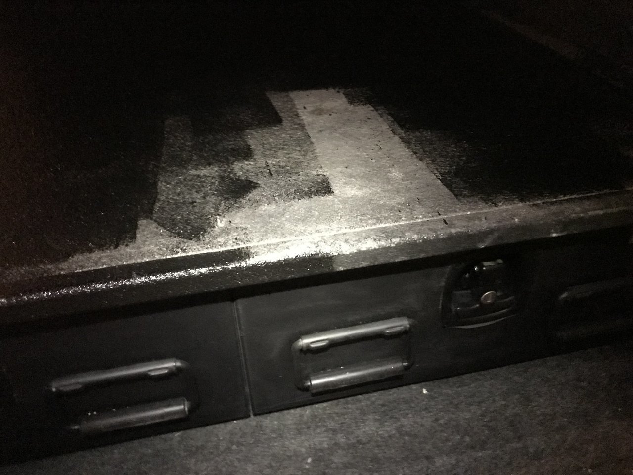

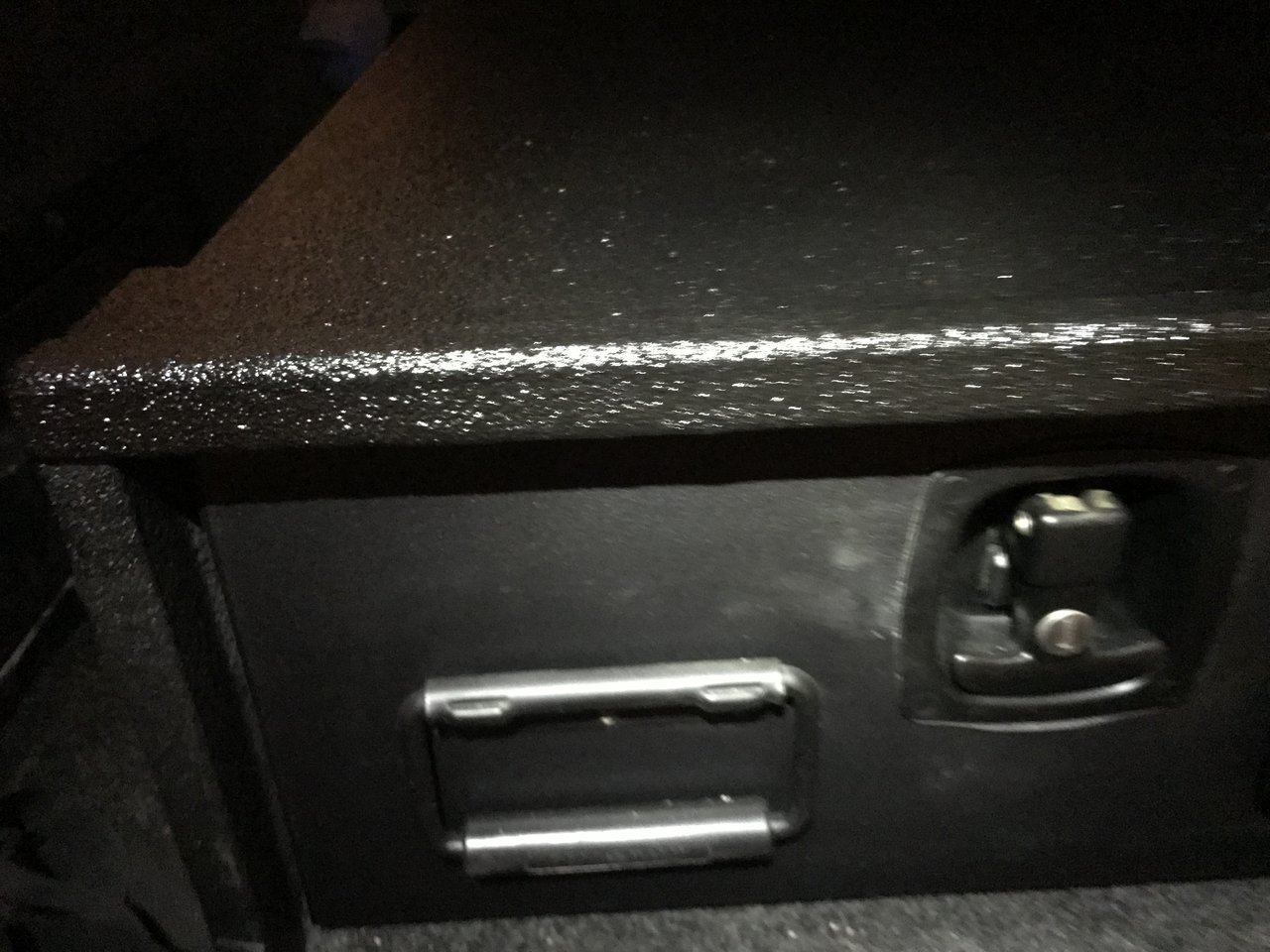

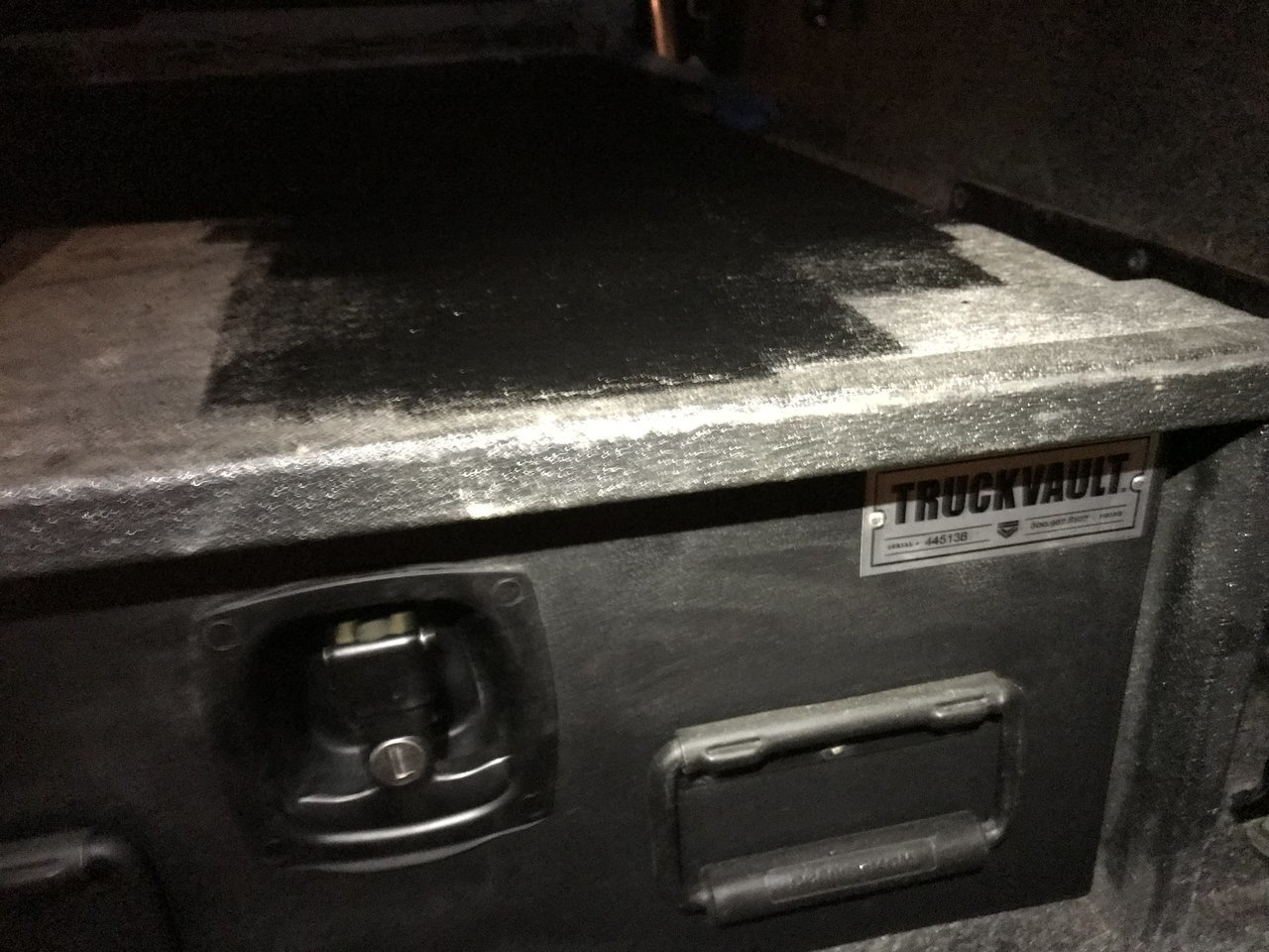

    Small update, my truck vault was pretty beat up on top from being uncovered all summer and having my sons quad on top of it every time we took it will us on trips, so I redid the coating on the top last night. Original surface was line-x which held up pretty well considering the use it took. I cleaned and scuffed up the surface and did an overcoat of rustoleum truck bed liner.
    Despite the poor quality of the photos (due to the lack of light in my garage, you can see how much of a difference it made.
