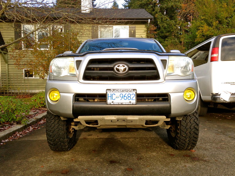

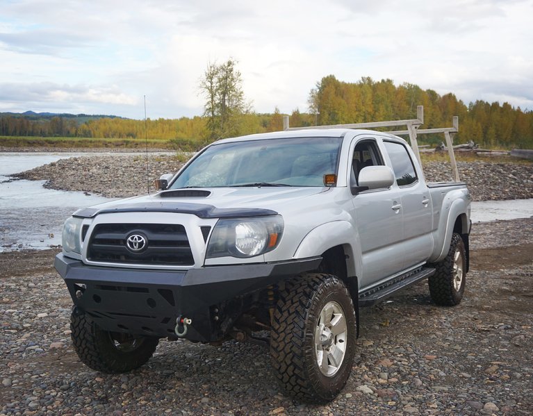

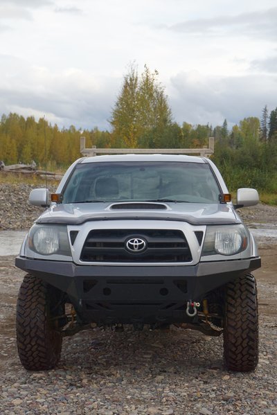

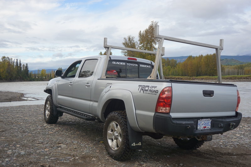

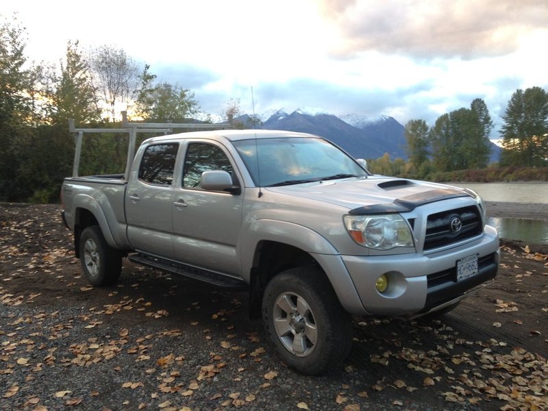

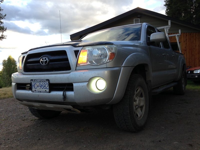

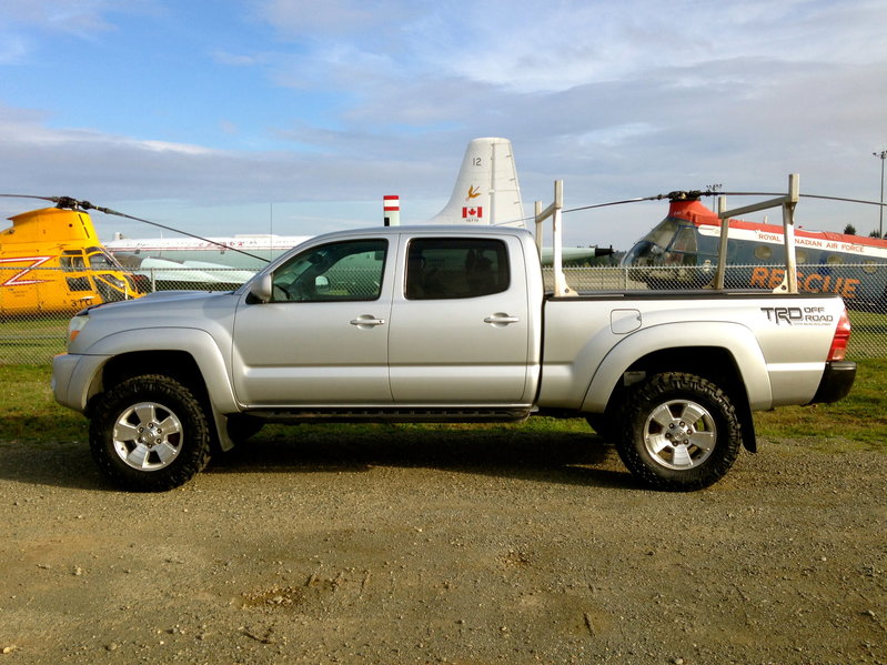

    2005 Tacoma DblCab TRD Sport

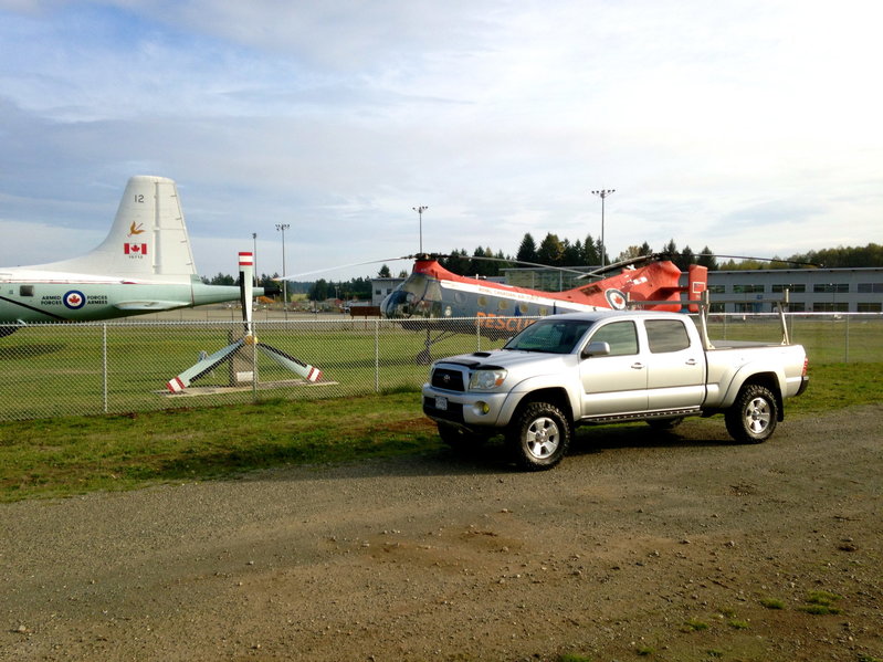

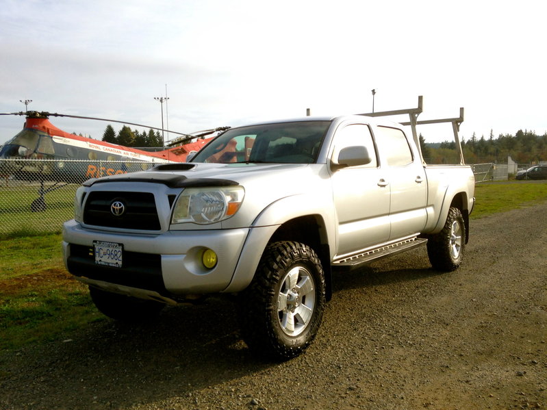

    How it is today
    This is going to be a slow build up. Toyota replaced my frame under the safety recall Aug 2015 and then i decided i was going to keep this truck and now have a brand new frame to build up from. So there will be lots to come but here are the things i have already done.
    2005 Tacoma TRD Sport Dbl Cab
    V6
    Armour:
    - custom aluminum front bumper weighs in at 45lbs. (Lots of CBI influence)
    - skids and sliders to come soon...
    Lighting:
    - lightforce 240 blitz
    - Amazon ditch lights on home made brackets
    - bed lighting
    - under hood lights
    - interior, licence plate, side marker led’s swapped
    Suspension:
    - OME with 885
    - Light Racing UCA’s

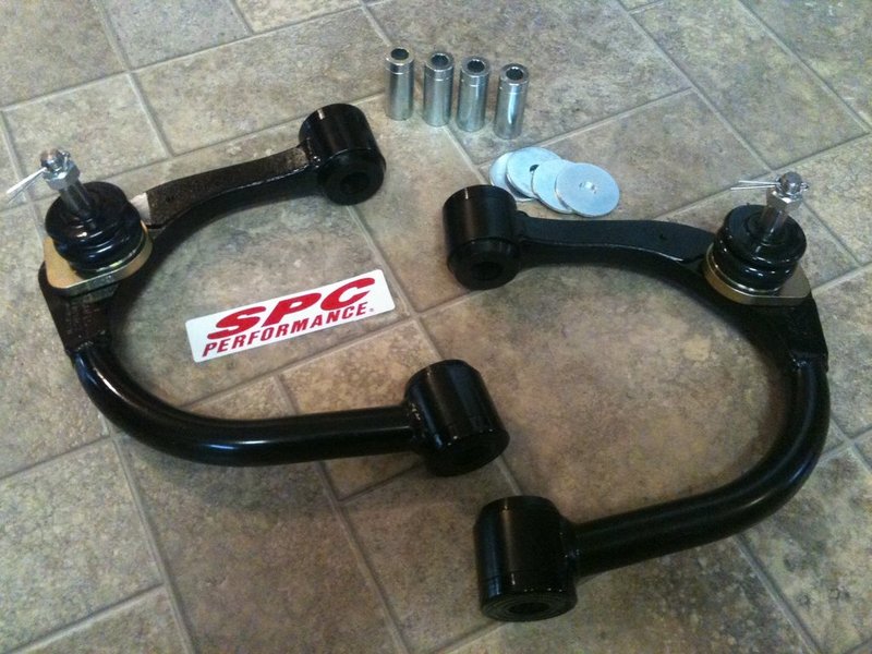

    - Firestone airbags (removing soon and replacing with u bolt flip with bumpstops)
    -sway bar removed
    Interior:
    - TRD seat covers
    - AUX into stock stereo adapter
    -Center console lid quickfist flashlight mount
    - behind rear seat (passenger) quickfist axe mount
    Engine:
    -JBA long tube headers
    Keeping engine as stock as possible for longevity
    Misc:
    -ECGS bushing
    -bed rack
    -Tauneu cover (roll up)
    -ARB RTT
    Tires:
    255/75R17
    Nitto Trail Grappler M/T
    Stock sport rims (summer)
    265/75/R16
    Duratracs
    Pro comp steelies (winter)

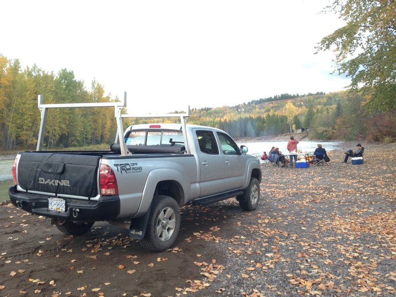

    The day i bought it Sept 2013

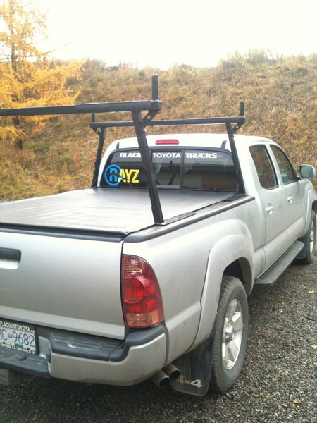

    First thing i did was take the tauneu cover off and get a rack and roll up taunau cover.

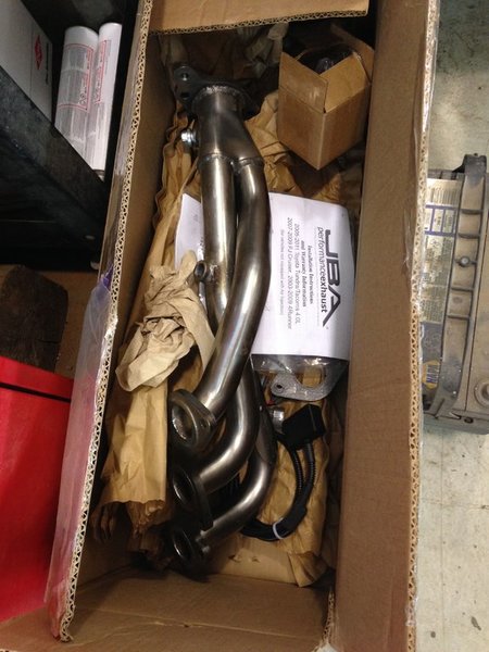

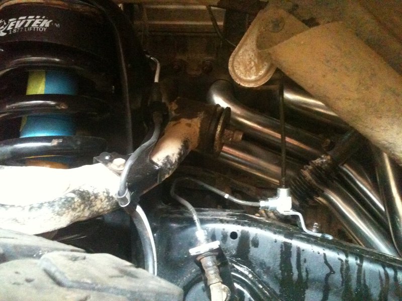

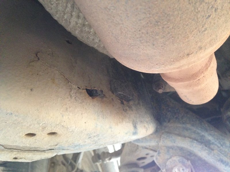

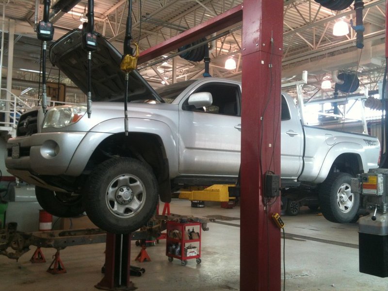

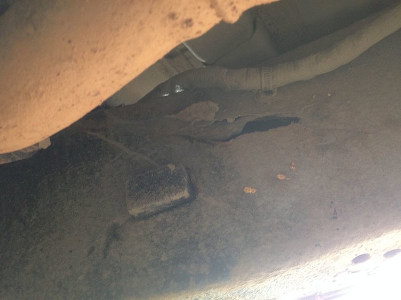

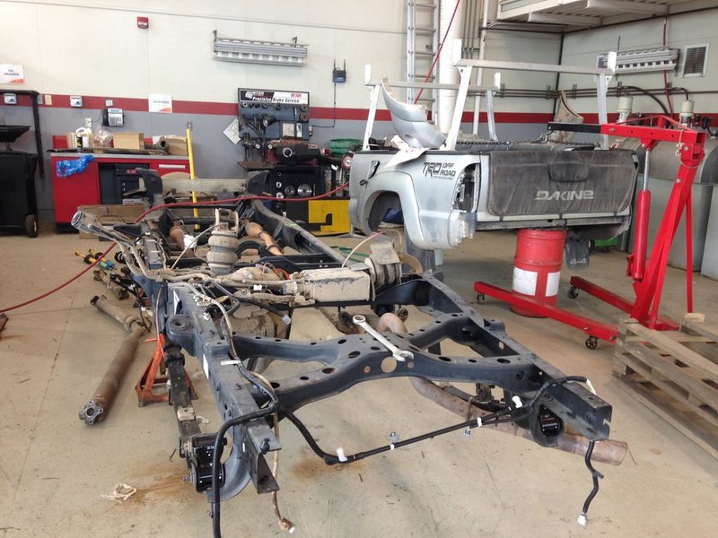

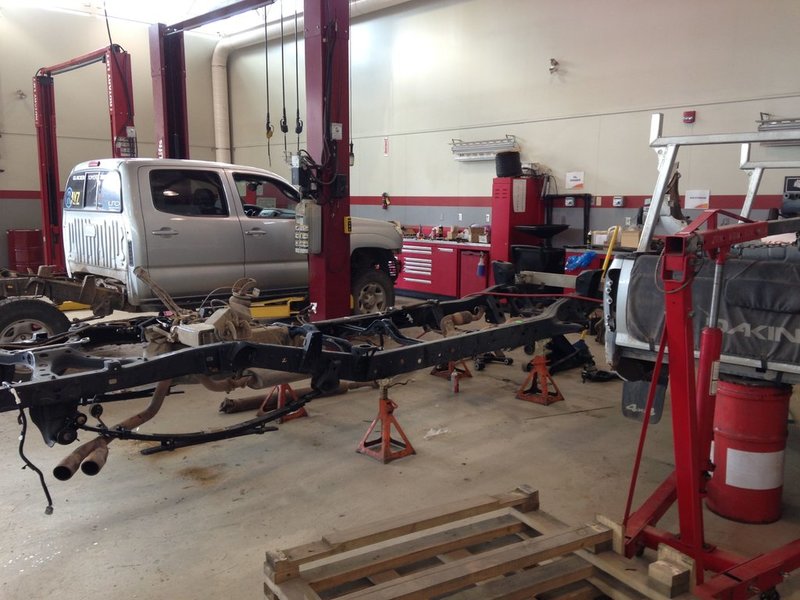

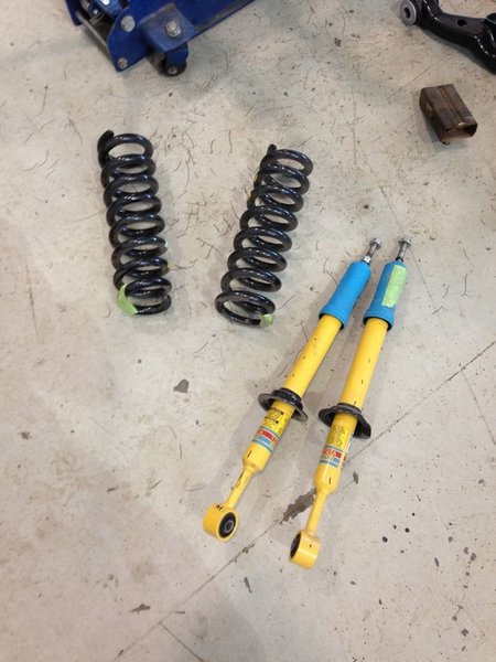

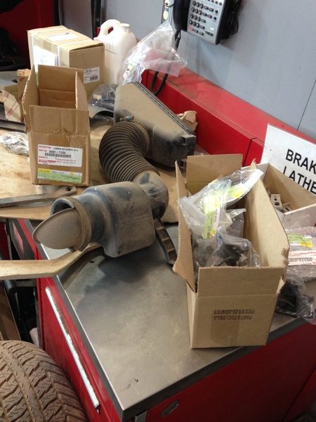

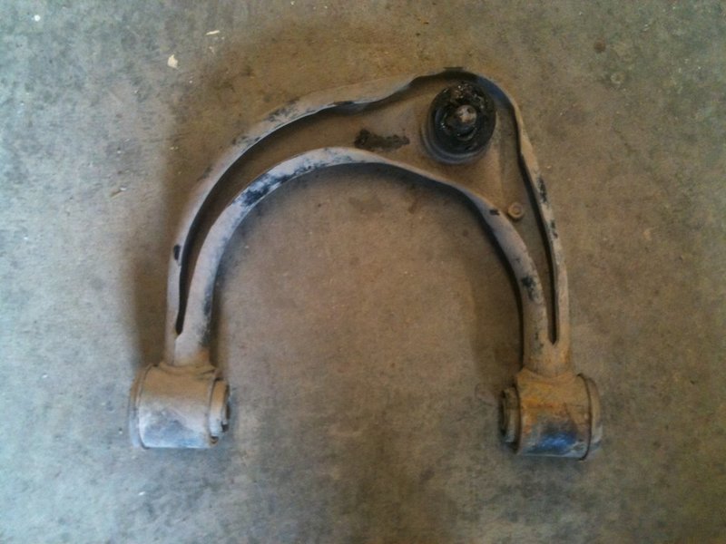

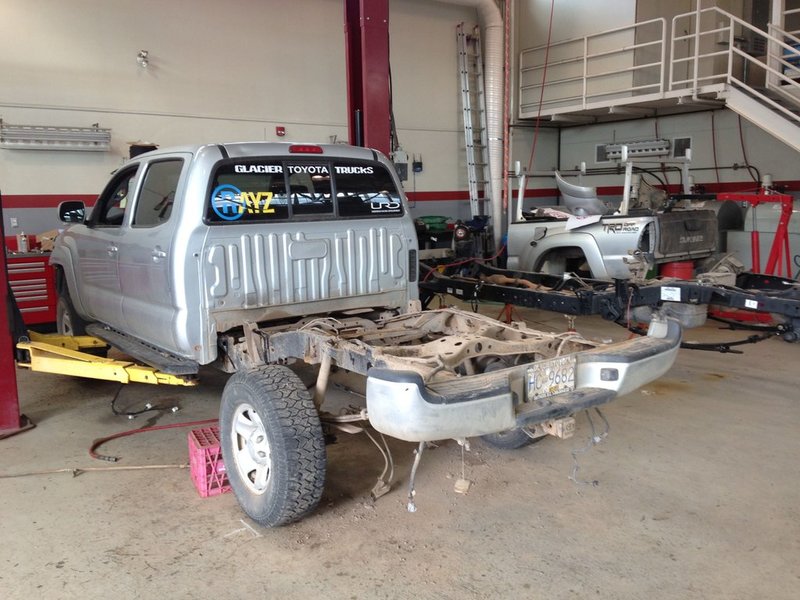

    I drove it like this for a couple years tell toyota decided to do a frame recall for me. I had lots of rust rate where my upper CAT's were rate beside the frame. Took a punch and hammer rate threw the frame on both sides.
    So this means lots of new parts
    -frame
    -leaf springs
    -front struts
    -coil springs

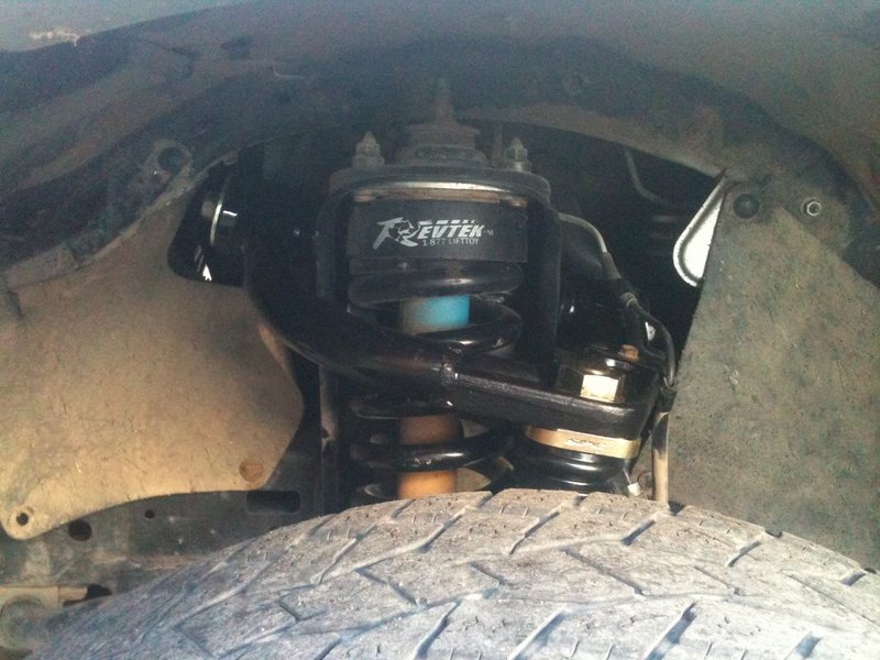

    -Revtech spacer lift
    -LCA's
    -Brake lines
    -JBA headers
    -lots of bolts/ gaskets-
    -and probably some more
    all put back together

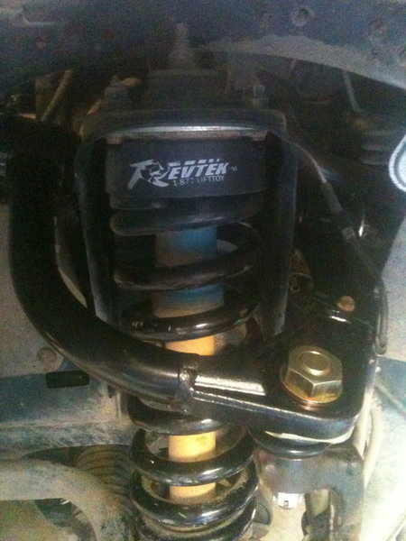

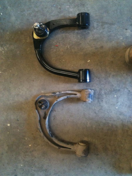

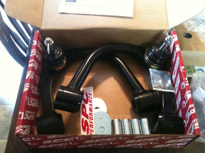

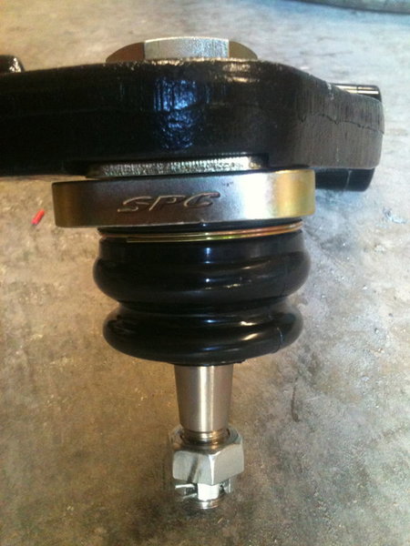

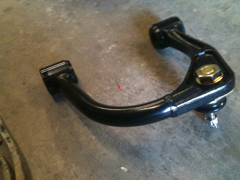

    I got the truck back and as soon as i drove it it pulled me all over the road, was quite unhappy. Than did my homework and found out that with a lift over 2" i can not get to proper alignment specs. Wish they would have told me that! At this point i was regretting my choice on suspension but i just carried on and ordered Spc UCA's (which I also regret and now want TC) I May get new suspension one day, something proper and awesome but this will work for now.

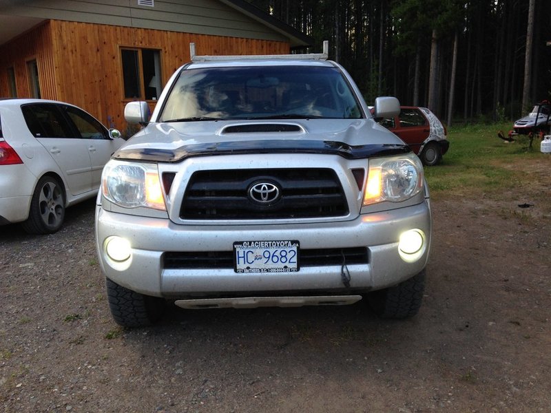

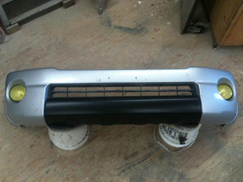

    somewhere around here i did the foglight anytime mod

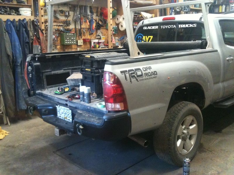

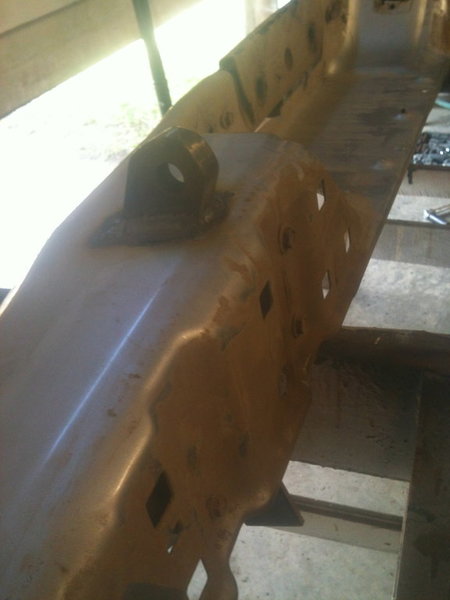

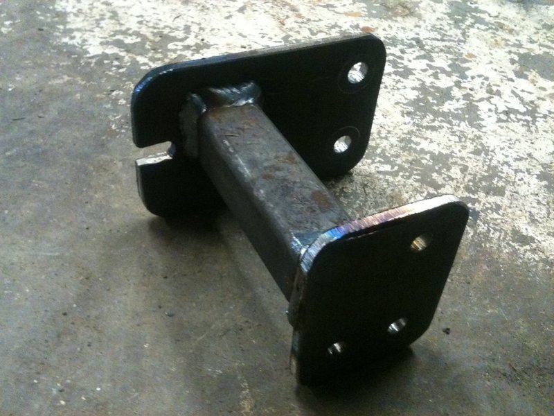

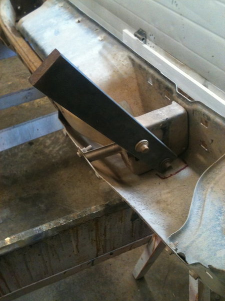

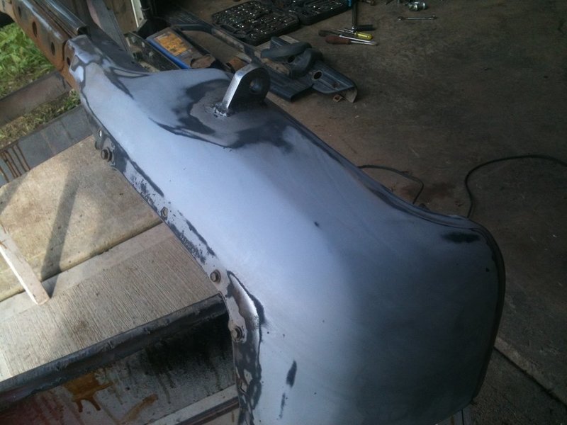

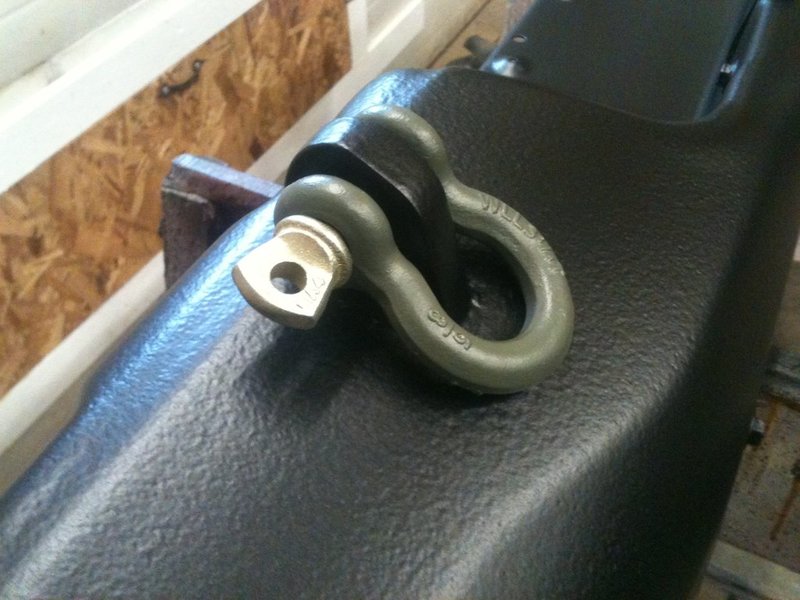

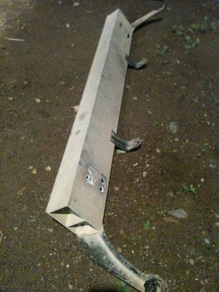

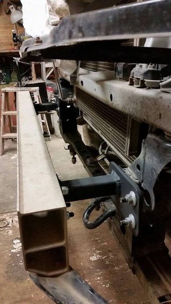

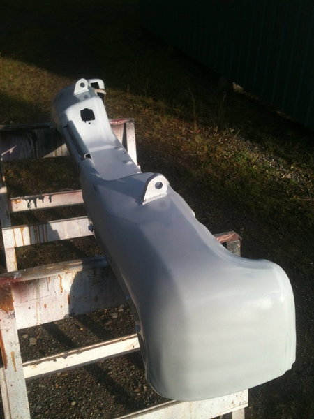

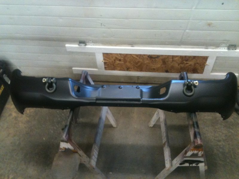

    Stock Rear Bumper Rebuild:
    So i had some rust forming on the underside of my rear bumper. I decided to hold off for now on building a plate bumper and just re use the stock bumper and add some toe points.

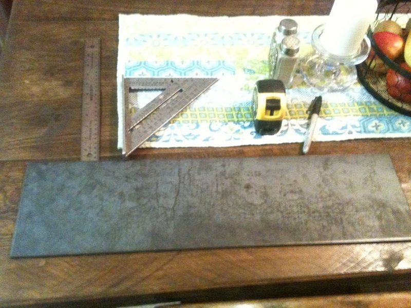

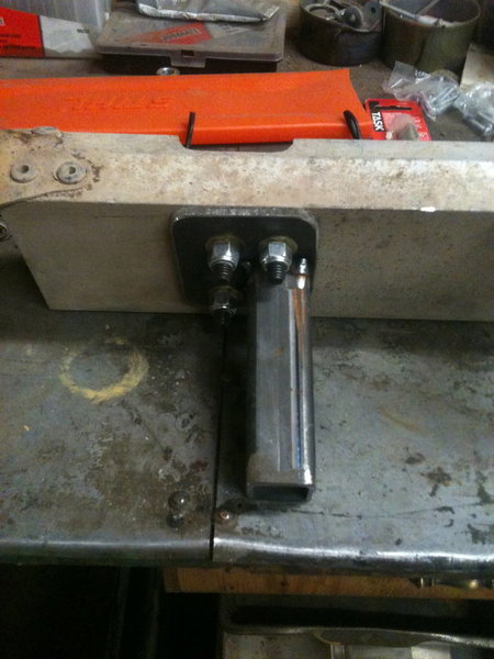

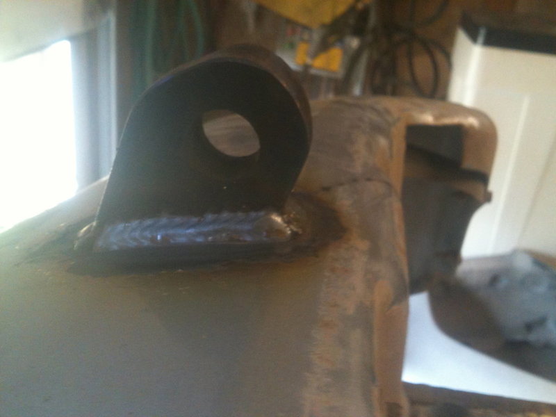

    i used 3/4 x 2'' Steel for my toe points. They are about 8" long and they pump threw the bumper and bolt to the same bracket that holds the bumper and hitch. I just had to buy bolts 3/4 longer.
    getting primed

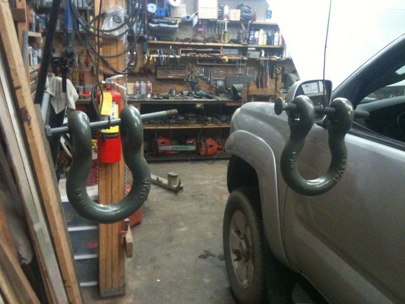

    rock guard
    better plastidip the D shackles army green
    finished bumper and installed

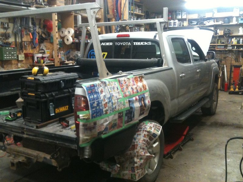

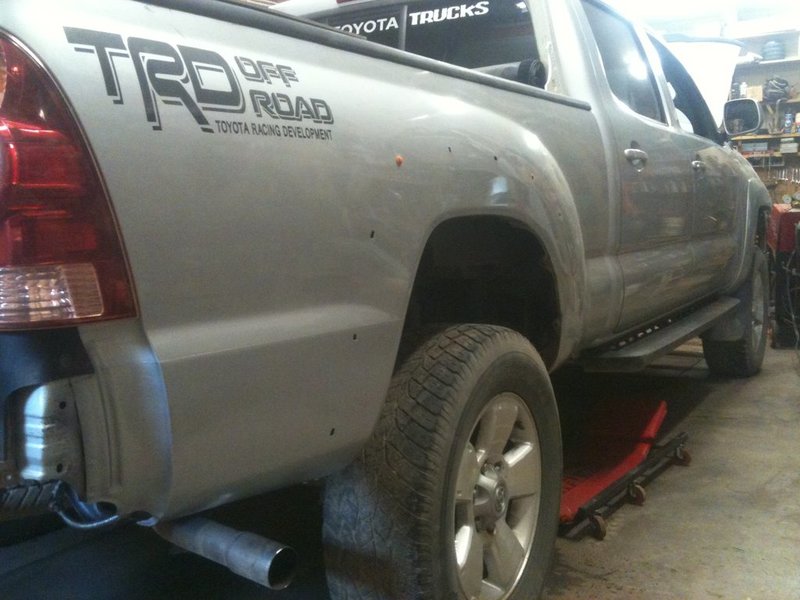

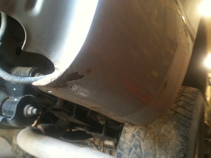

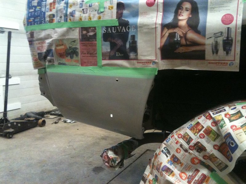

    Rear Bed sides lower rust fix:

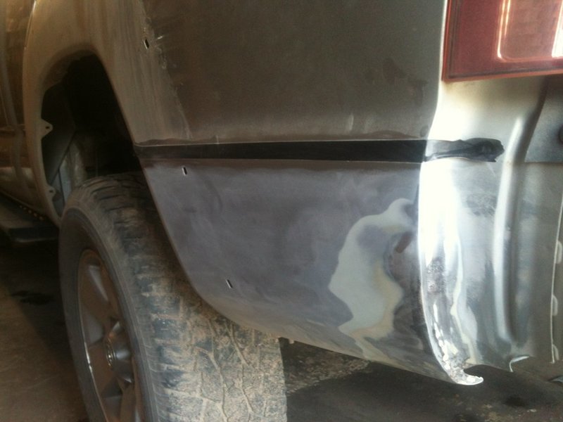

    As I had my bumper off i decided this is a good time to fix the rust on my lower rear bed sides. Steps i took were Grind off paint and rust, Clean well with lacquer thinner, Rust fighting primer, rock guard, colour match paint, clear coat.
    IMG_0172.jpg IMG_0171.jpg IMG_0177.jpg IMG_0178.jpg IMG_0182.jpg IMG_0183.jpg IMG_0195.jpg IMG_0197.jpg

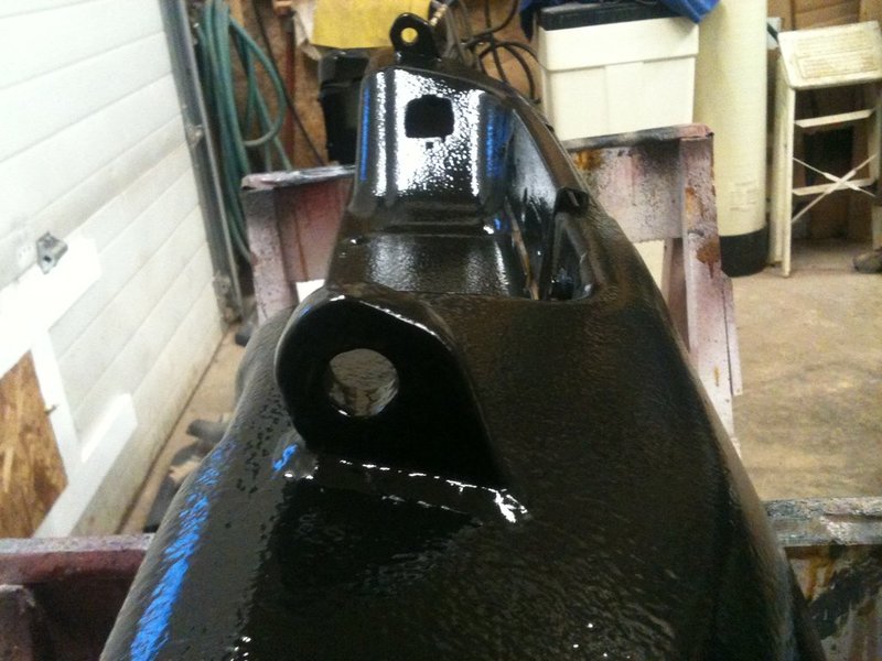

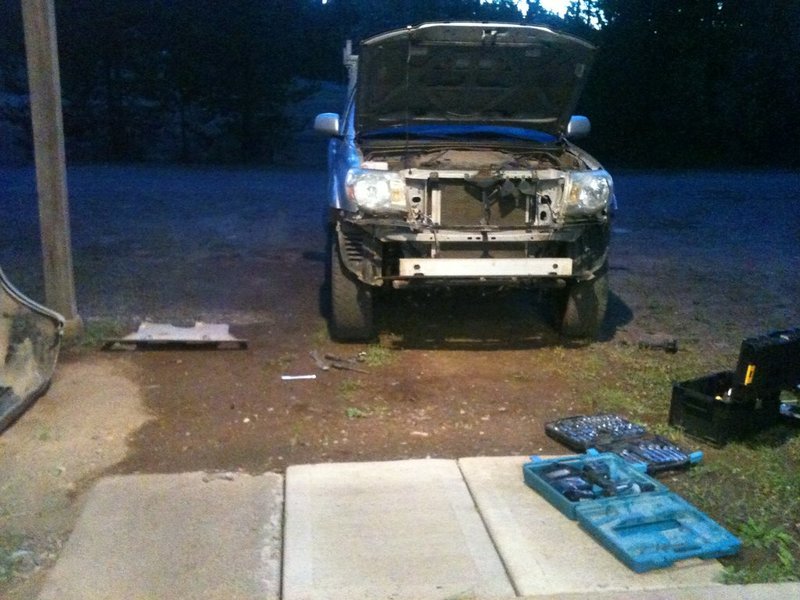

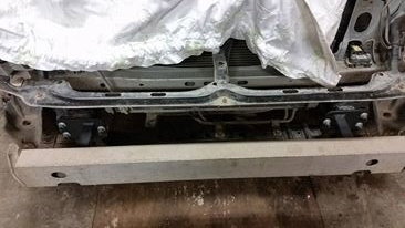

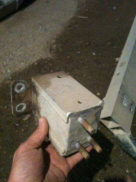

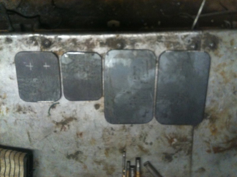

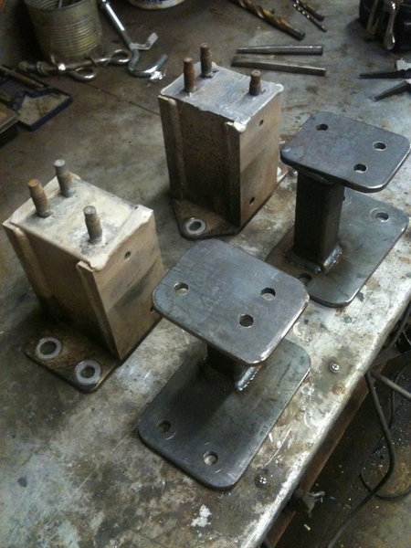

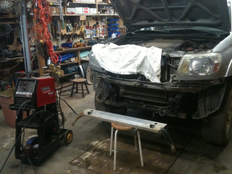

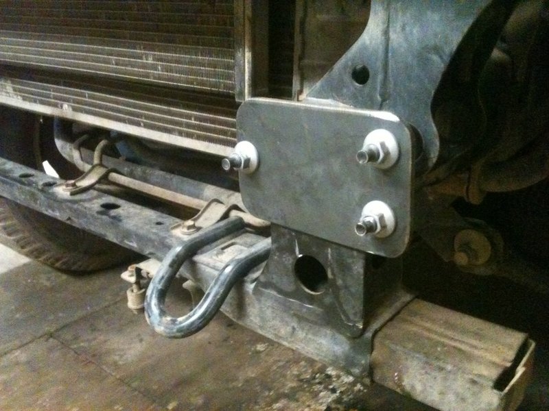

    Front Bumper Squash Blocks Build (fix creaking over small bumps/curbs)
    The crimps on the front bumper squash block studs were loose and when i went over curbs my frame would flex enough to have some movement and make a really lout creek/tick type sound that got amplified by the aluminum cross member. Terrible sound, i thought my truck was falling apart. So i came up with this fix. I made new blocks from steel. I know they are not crash tested, but i am not too worried because everyone who puts on aftermarket bumpers takes these squash blocks out anyways.
    IMG_0106.jpg IMG_0108.jpg IMG_0109.jpg IMG_0144.jpg IMG_0190.jpg IMG_0191.jpg IMG_0192.jpg IMG_0193.jpg IMG_0194.jpg IMG_0196.jpg IMG_0214.jpg IMG_0215.jpg
    also well i had the bumper off i decided to plastidip the lower valance.

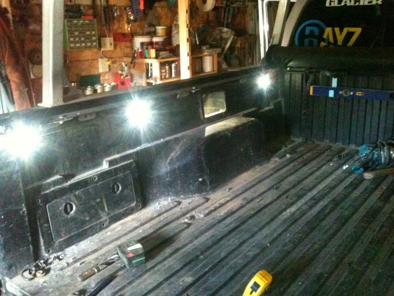

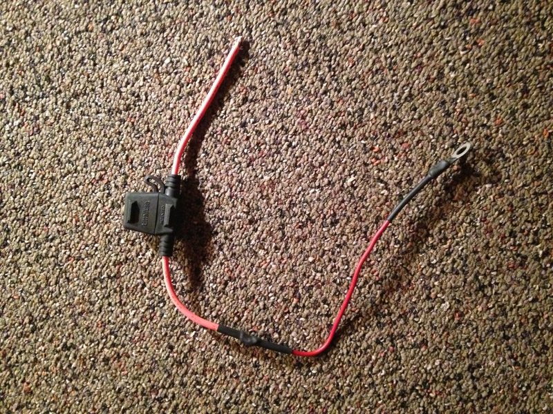

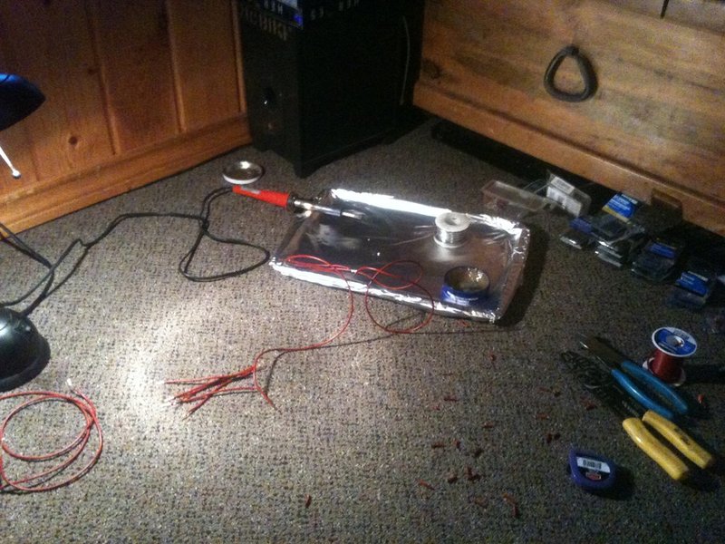

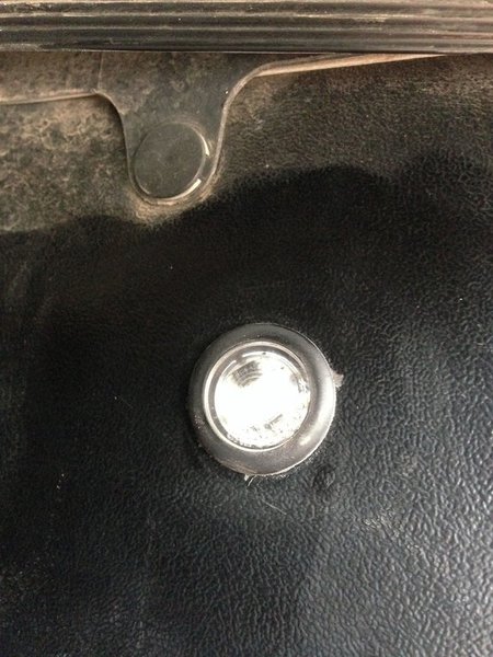

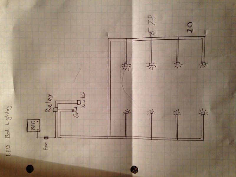

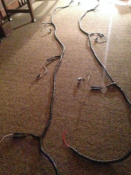

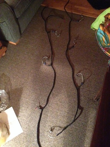

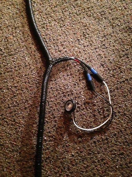

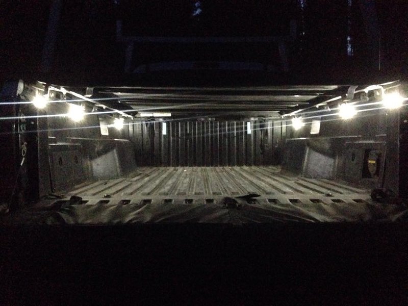

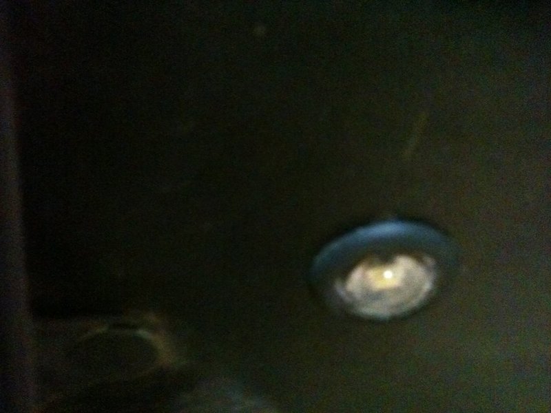

    Bed Lighting Install:
    This is my favourite mod so far!I found these 3/4" flush mount round LED's. They are actually clear marker lights. I took my time with these and did it right. I made the wiring harnesses just in my living room watching TV with the fam. It is all solder'ed together. I put 4 lights along each side spaced evenly and yes i agree the one's in the cubby's are the coolest.
    IMG_0150.jpg IMG_2740.jpg IMG_2741.jpg IMG_2742.jpg IMG_2743.jpg IMG_2744.jpg IMG_0200.jpg IMG_2829.jpg IMG_2830.jpg IMG_0226.jpg IMG_0227.jpg

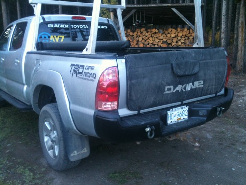

    Nice build! How's that tonnea cover work with your dakine tailgate pad? I was just going to roll mine up come Mountain bike/ shuttle season
  18. Nov 4, 2015 at 6:51 PM
    #18
    zach101
    zach101 [OP] Mr.Ph1lip
    Oct 5, 2015
    #165925
    76
    Zach
    It's a nice tight fit! Although, I can not close the tonneau cover with the tail gate up. I half to close the tonneau cover first than close the tail gate. It took a little bit of adjusting to make it all work together with my rack as well. But all is tight and 97% waterproof. I would trust it to keep my valuables dry. If I remember correctly I had to make sure I had about a 3/8 to 1/2" gap between the tonneau cover and the tail gate before the tail gate pad went on. Hope this helps.
