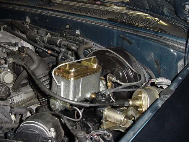

    Truck got so close today! Drove out of the shop under its own power today, they also got the alignment done. Only issue is that with the Tundra discs up front and the explorer discs out back it's maxing out the stock Tacoma master cylinder. They're going to look at upgrading to a newer Tundra master cylinder help push the brakes.

    Put a 2lb residual valve on the rear brake line and ditch the LSPV if you haven't.
    https://www.summitracing.com/parts/wil-260-13783/overview/
    I have a full floater Diamond using D44 hubs and large single piston calipers and had the same symtoms as you at first but got a ton better with the 2lb valve. I would try that before replacing the master cylinder.

    Yea, they swapped in a 2lb and even gave the 10lb a shot. It helped but not enough. Also LSPV is gone. Eventually want to fully delete ABS. Swap in another battery or something in the freed up space.

    Ditch the ABS now before you do anything else. It is just one more thing to catch and air bubble and mask the root cause of bad pedal pressure.
    I just swapped tundra's on the front of mine and can get decent pedal throw out of it. I haven't driven it yet but hope to get it running soon.

    I got to drive my truck with the Tundra fronts and D44 metric calipers in the rears. Truck off the pedal gets hard at 80% of travel, Truck running it never gets hard before running out of throw. I have a 2lb residual valve on the rear circuit with an manual adjuster and with it all the way out still lock the rears way before the fronts. I have another 2lb valve on the way to add to the fronts to see if that makes up for the smaller MC bore.
    Also bigger isn't always better with MC bores. I've done a ton of testing with race cars and different sized bores and a 1/16 (.0625) size difference makes a huge difference in braking performance.
    Plus you have the newer booster with only 2 bolts and that adapter won't work.

    Yea, I'll let the shop decide what to do next. There are a variety of combos that people run. T100 booster w/GM Master seems to be like a winner in a lot of cases.

    It might just be air in the front circuit still. But I air bled then pedal pumped. Still shit brakes so I swapped MC (Tacoma, same) I had and same shit. I will put some miles on it and see if they improve or maybe another round of manual bleeding. FYI I don't have ABS, never had it in either trucks.

    So brake master cylinder got swapped out, deleted the ABS, brake proportioning valve added, bled the system several times and now she stops with no problem! :thumbsup:

    What master cylinder did they put in?
