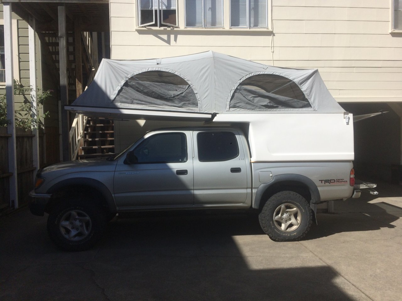

    Can't get over how much cleaner the truck looks now! Now it will be even harder to figure out what to do with the paint.
    New parts are starting to flow in! Picked up the new SLO Rain Fly with the Flip-Pac, its never been used and the Flip-Pac was only used twice :eek:
    I'll probably use it more than that in the next month!
    Upgraded the cap seal with a more heavy duty style, should hopefully keep everything secure and water tight on and off road.
    Have a water fill port and lights on order, also looking at L-Track for inside and outside the camper and adding mounts for my sand ladders.
    Also looking at awnings and debating of a 270 awning would work on the Flip-Pac, haven't seen any examples yet.
    At any rate it will be hard to drill into the camper in such mint condition :sawzall:
    Truck is also having the swing-outs modified, adding propane tank mounts, locking pins, and a bike rack.
    Air tank will also likely be tucked under the cab for air tools, tires, water toys ect.
