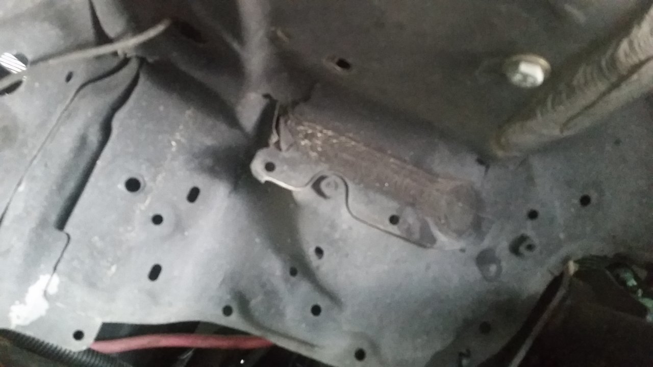

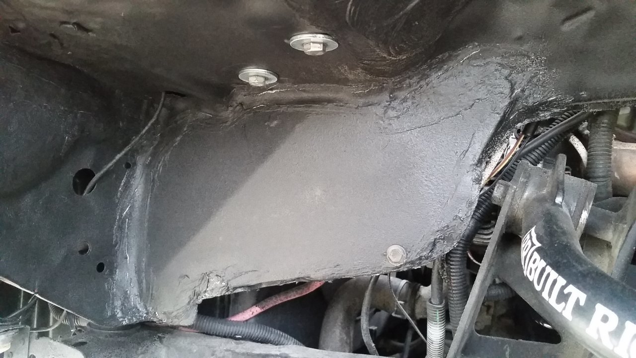

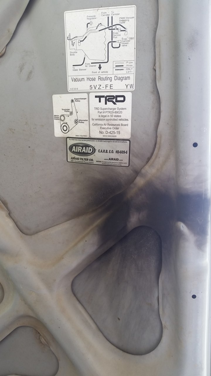

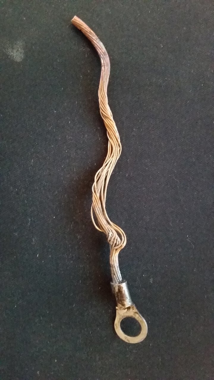

    Death Valley carnage - Well this litter bugger caused me a great fright in the middle of nowhere, when my batteries shifted due to the battery mount giving way the positive terminal contacted the metal tray causing a short, luckily this ground wire was low gauge broke the short.. note everything is fused. This was directly at the terminal.
    Shop fixed/beefed up the mount, should be good for now. May eventually relocate. 20200309_173644.jpg

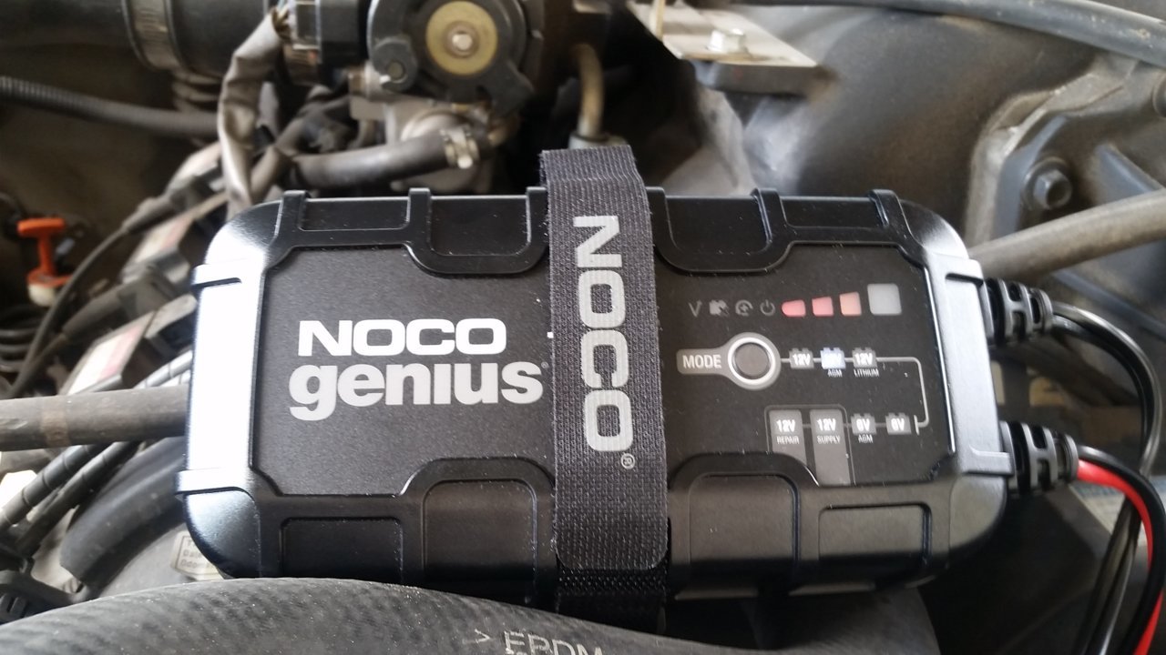

    While staying at home, the truck is parked. So I bust out this little guy every so often to keep everything topped off! 20200421_163156.jpg 20200421_163234.jpg

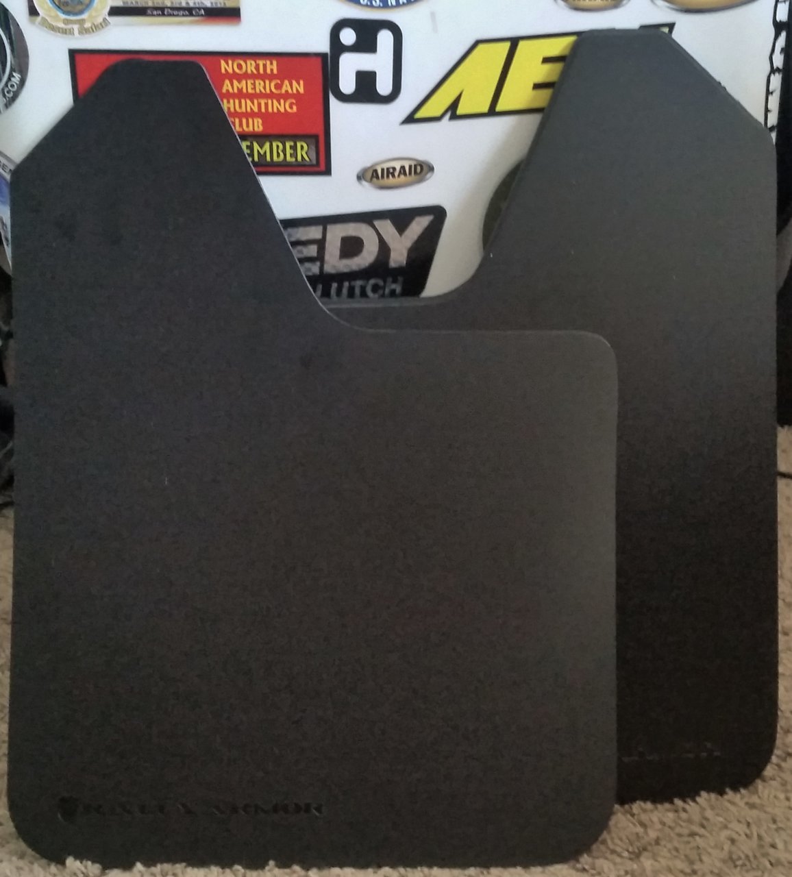

    Rally flappy flaps... hope to help with some of the sand blasting on my powder coats and fiberglass. Debating if I want install a the front set.

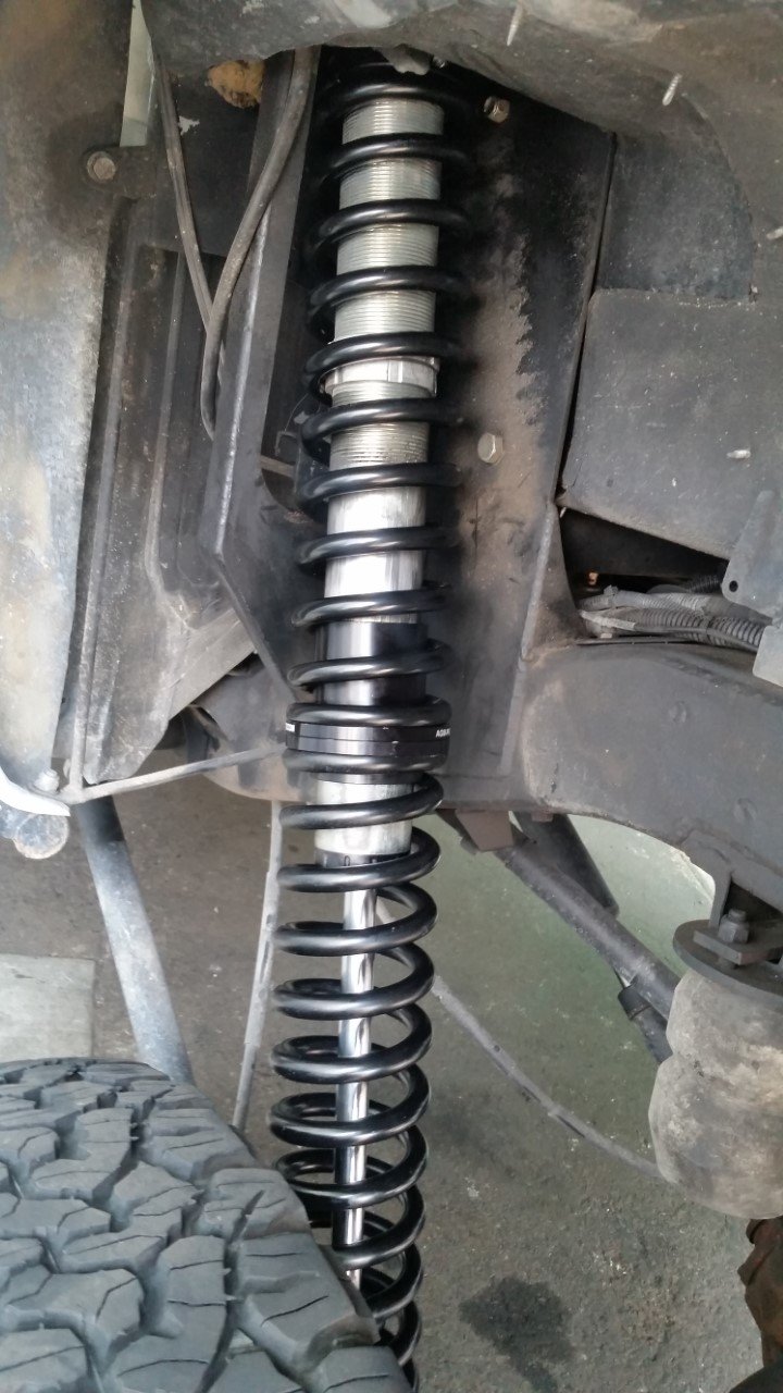

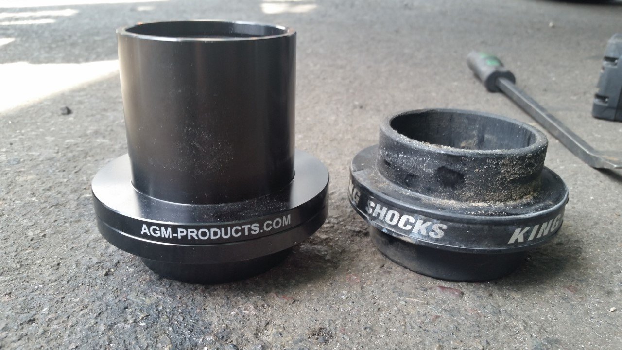

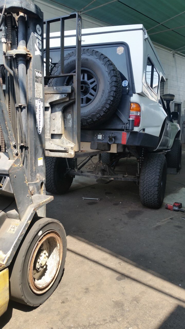

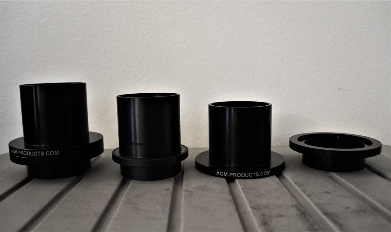

    After a few outings I realized the truck needed a slight bump in spring rate, so a quick trip to the Truck Shop and they got them swapped in quick along with my AGM sliders. I was back on the road shortly after!
    This is not something I can do at home anymore with my bottle jack!! :rofl:
    Truck now sits level, even with a good amount of gear, so far so good!
    Uppers:
    16" 350lb
    was
    14" 300lb
    Lower:
    18" 400lb
