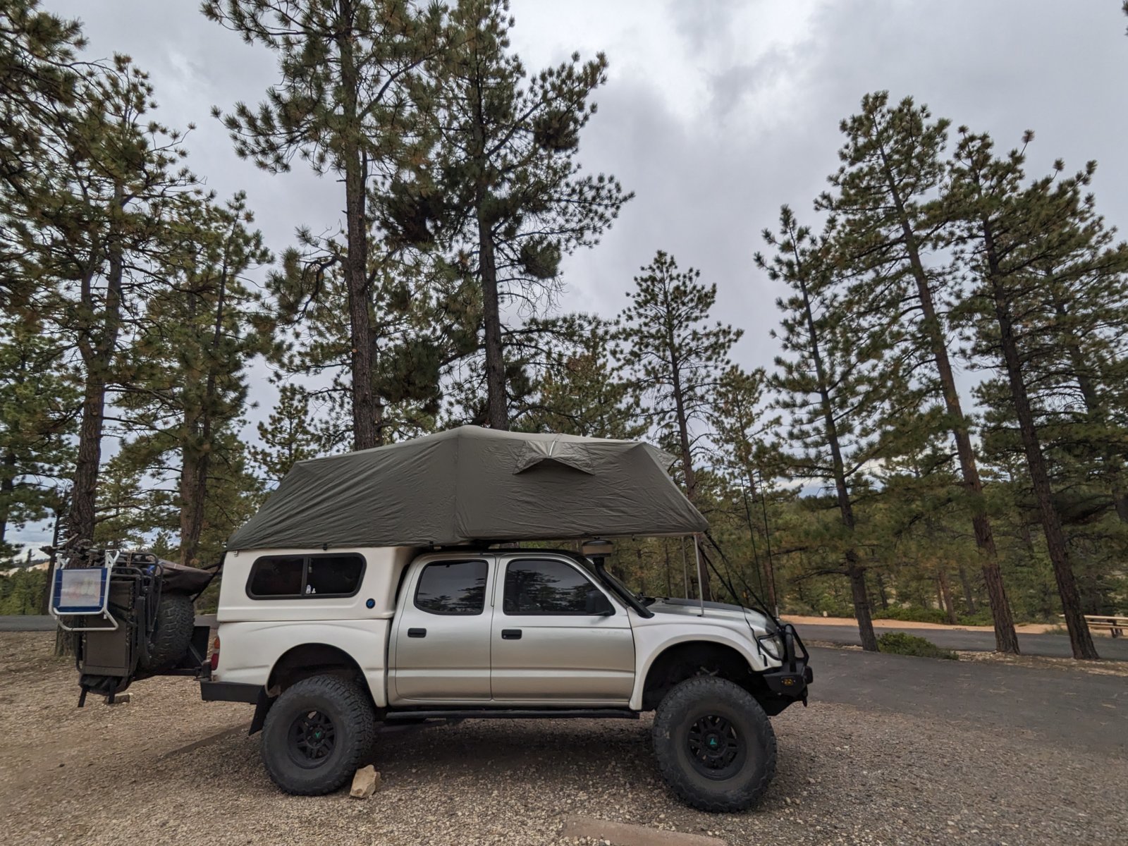

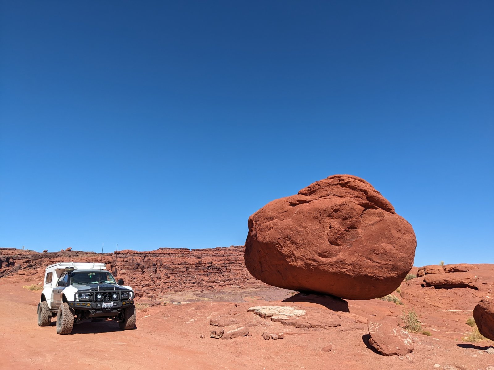

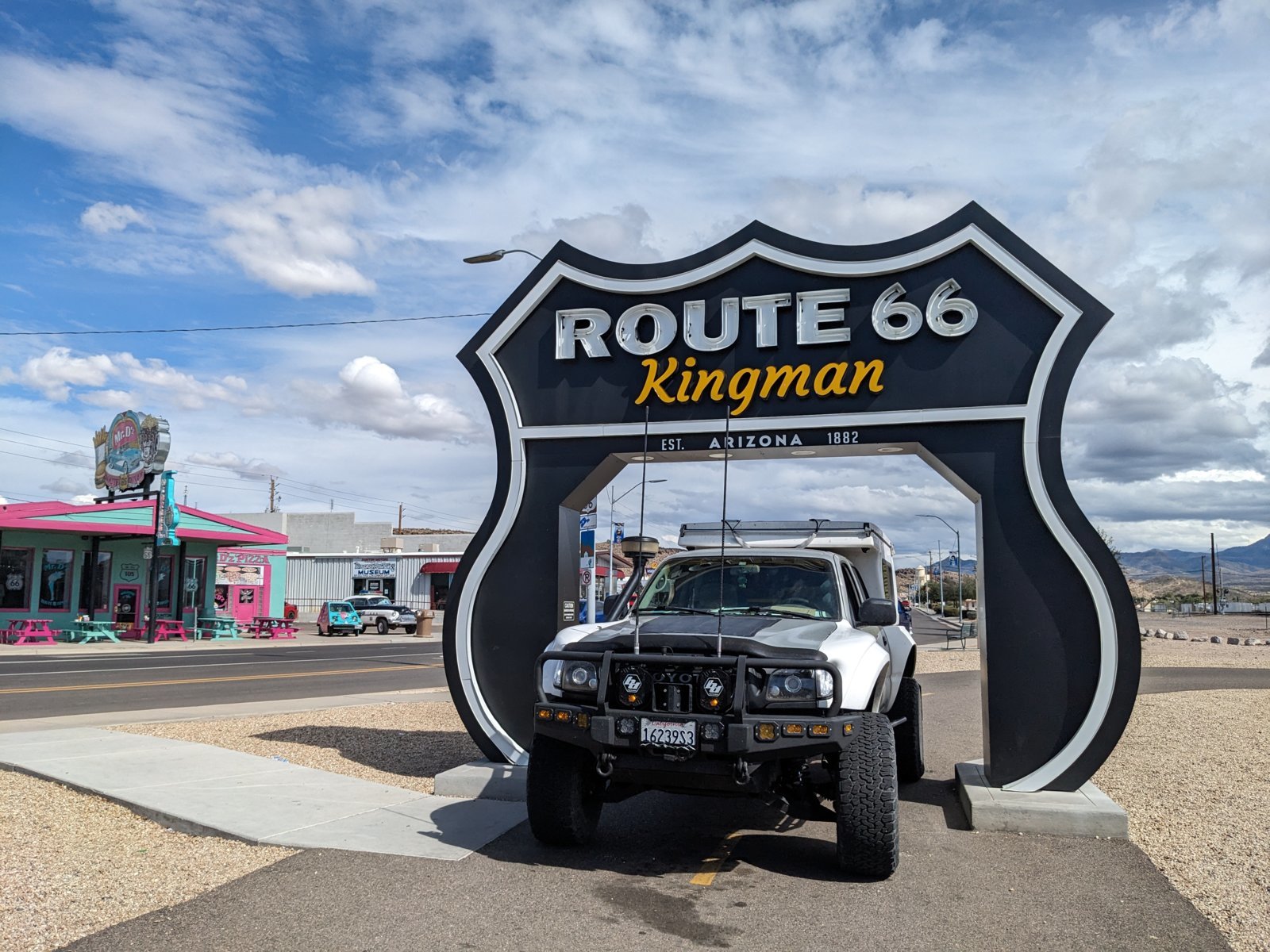

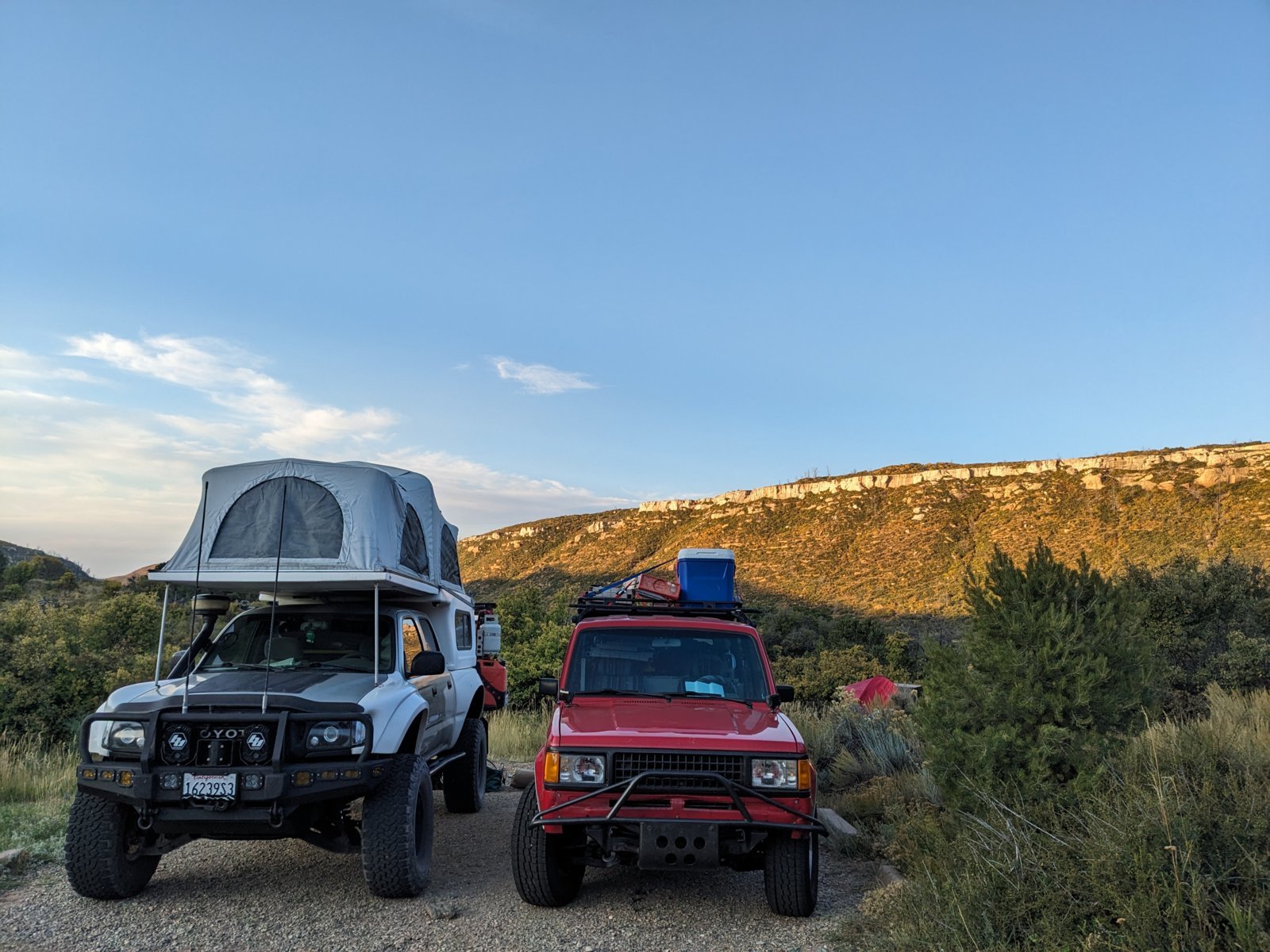

    Here's looking back to 2023 and looking ahead to 2024 for more adventures! IMG-20230925-WA0007.jpg PXL_20230930_210919937.MP.jpg PXL_20231001_163352995.MP.jpg PXL_20231002_154518169.MP.jpg PXL_20231002_210033130.MP.jpg PXL_20231002_220341809.jpg PXL_20231002_221827653.jpg PXL_20231002_235132126.MP.jpg PXL_20231002_193659968.MP.jpg PXL_20231003_162849421.jpg PXL_20231003_193335328.MP.jpg PXL_20230928_133606759.MP.jpg PXL_20230927_184511096.MP.jpg

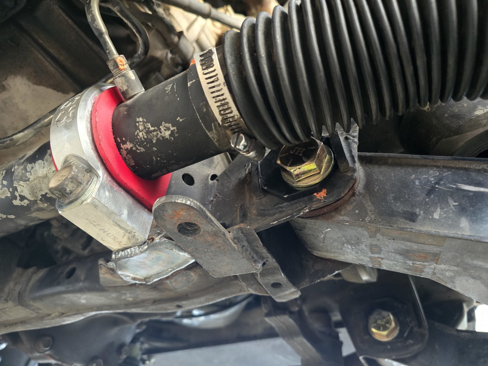

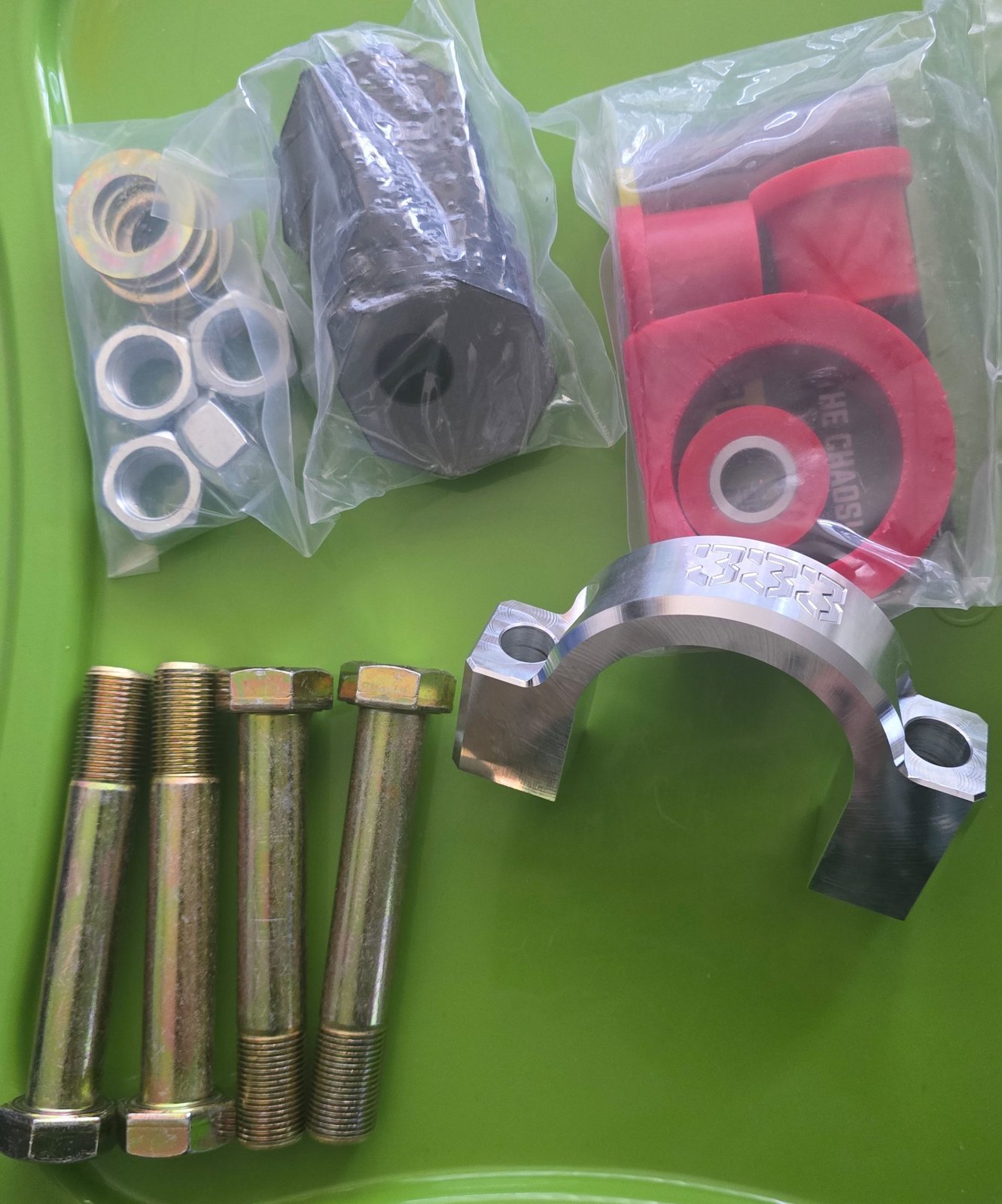

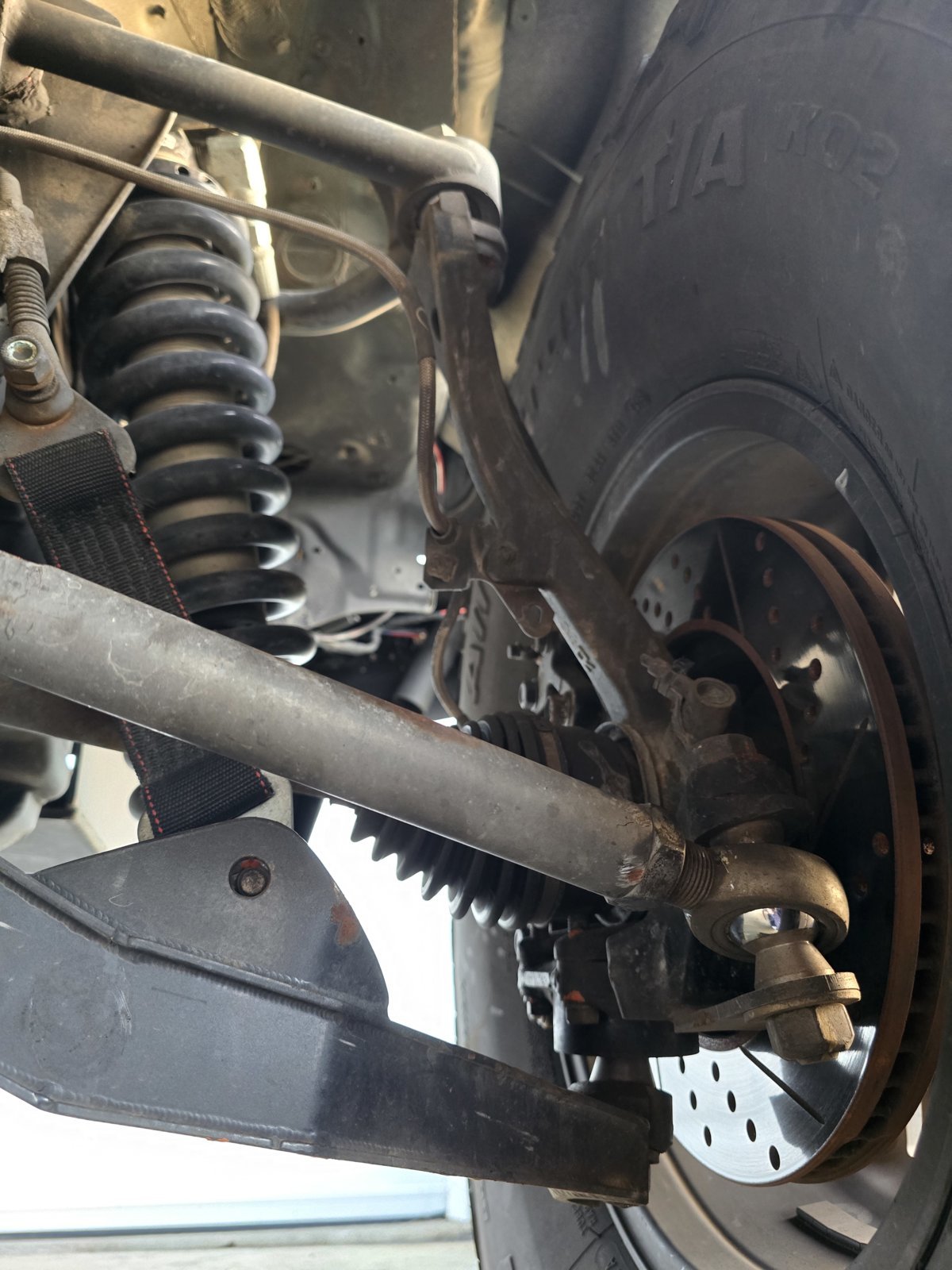

    Continuing to improve the truck at a snails pace!
    Dopped the truck of at the shop for some quick maintance and upgrades.
    333 Fabrications HD Billet Rack Clamp
    Total Chaos Steering Rack Polly Bushing
    KPO Off Road Toyota Alignment Cams/Bolts
    The octagons are great but a little trimming, super snug with the cam tab gussets that were done years ago.
    Front end feels solid, with upper and lower uni-balls, heim steering, kings, double shear gussets, and tundra brakes ect.
    Now it's time to get out and enjoy!

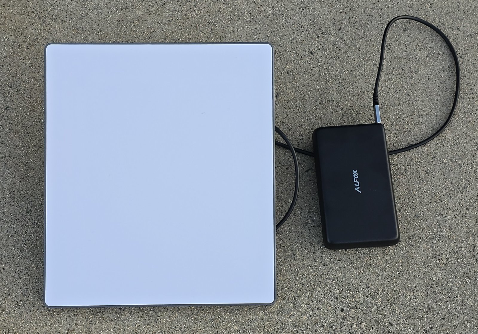

    Been wanting Starlink for a while, but the space and power requirements were a challenge.
    As soon as Starlink mini was announced it was an instant buy for me. Now to decide if it's worth hard mounting or just keep it 100% mobile. PXL_20230928_140016713.MP.jpg 452409904_10164096442779676_243188651001237125_n.jpg 452452145_10164096442809676_628733085963560304_n.jpg 452466061_10164096442819676_9066540066661635093_n.jpg 452550552_10164096442814676_6062869487755008732_n.jpg 452556653_10164096442774676_2933753561271372112_n.jpg

    Yeah nice to see the aftermarket is already kicking off, will be interesting to see what they come up with. Already ordered a USB-C to DC cable to see how it does off power banks.
    Haven't tested service yet, not sure I want to start the billing just yet, but it did power directly off my Eco Flow River 2's 12v barrel plug. Not having to use the inverter saves a ton of power. May try to work a full day off it + laptop to gauge power usage. Also want to see if direct via ethernet or WiFi has any power difference.
    Likely won't hard mount until they fully allow in motion use but may mess around with the pole mount they included.

    USB to DC5521 cable finally arrived for the Starlink Mini, now I can run off USB power banks. Official cable should be out in due time.
    Not too shabby, decent speed. Ranges from 50-120Mbps
    Already seen several example on why this would be extremely helpful to have in the back country or even on a major highway...

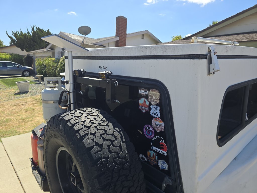

    Messing around with a temp Starlink mount on the truck, should work great for camp, not sure I'd trust the stock pipe mount for cruising down a washboard road.
    Also not a fan of the angle, will likely flat mount in the same location to line up flush with the camper.
