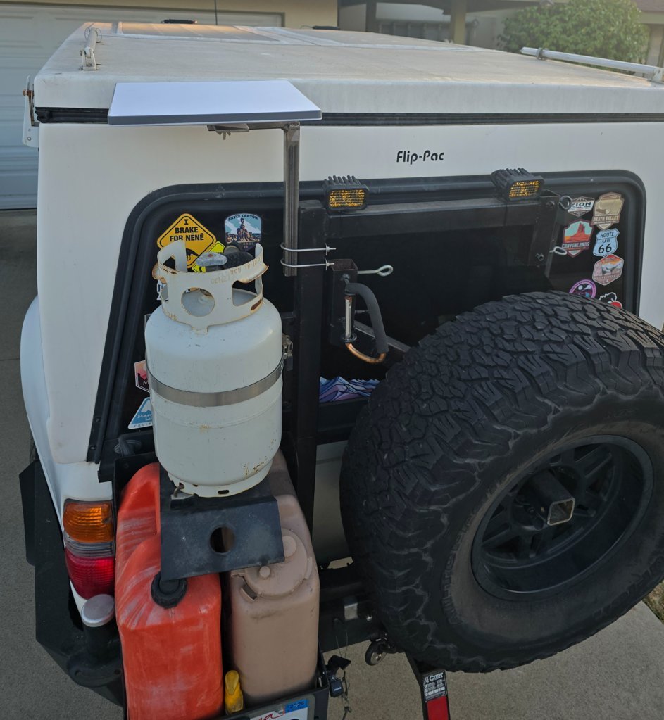

    I don’t know much about Starlink other than the equipment is slightly rare - I’ve never finger poked one myself - and expensive. This leads me to ask if this is an “at camp” install and stored safely inside while traveling?

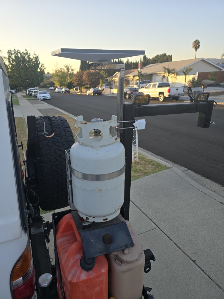

    Yeah around town I'll keep it locked out at home, out on a trip I'll toss it on the mount.
    In my area druggies will take anything not bolted down or locked, and even then.
    Spent the day throwing together another mount.
    Now the Starlink is now flat and flush with the camper line and bolted down. Will likely weld the bract in place depending.
    Should be good for in motion use.
    Could provide connection for everyone at camp or on the road if you splurge for the unlimited.
    Best spot I can think of for my rig with how the Flip-Pac operates.

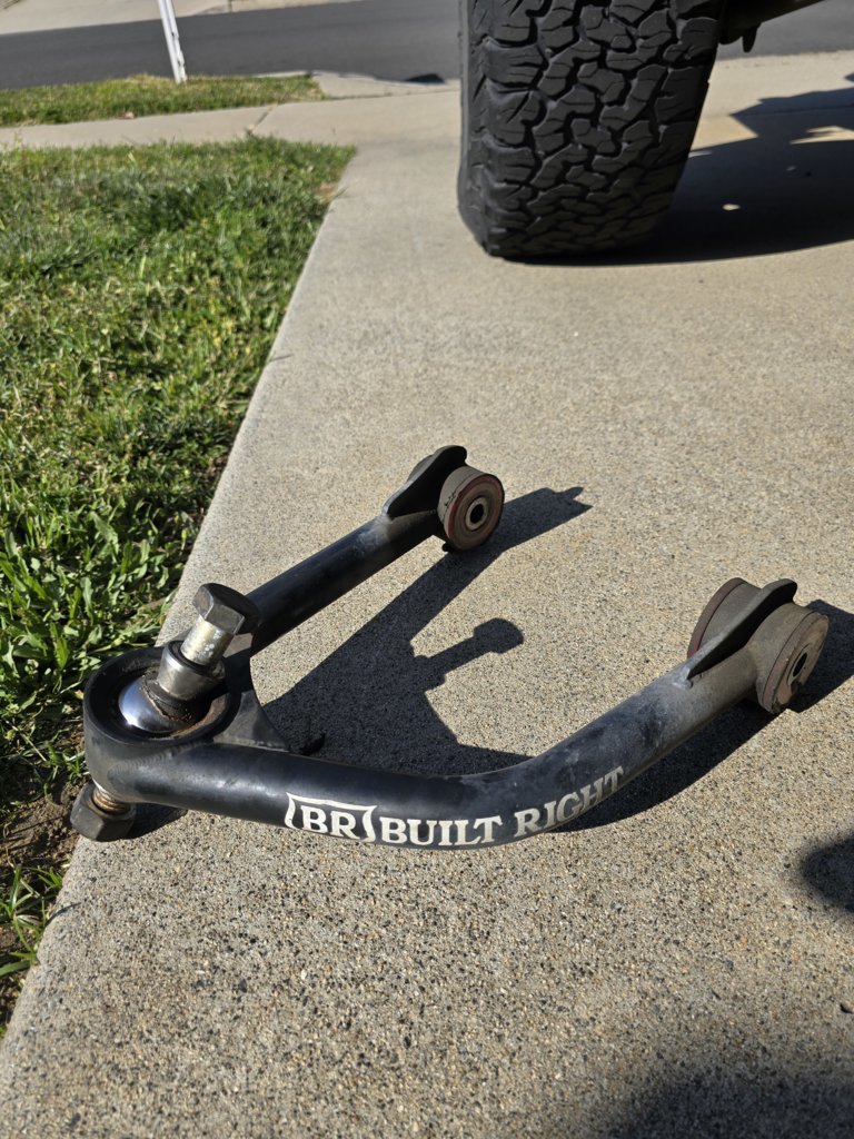

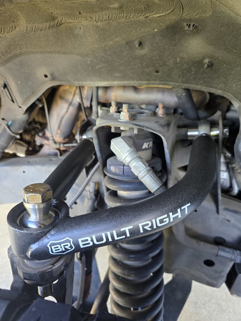

    Small update, after running my current Built Right long travel arms for 13 years, I decided to give them a refresh.
    Built Right made me an updated set of Heim upper control arms to throw on the truck with all new hardware.
    The original poly bushings and uniballs are still in great shape after all this time. It will be nice to have them as a spare set if needed.
    But having more points of adjustability for alignment is great. Now ready for a new set of tires!
