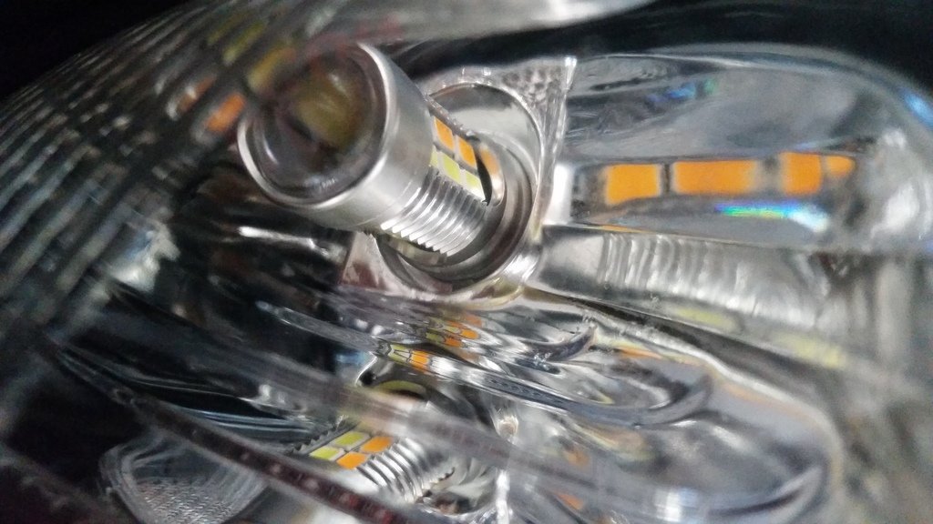

    https://www.amazon.com/dp/B00YDNAS2...lid=1NZT1KJ34QEKO&coliid=I342ZRE7CQQ95N&psc=1
    Will this socket and these switchbacks work together? One power wire from running lights, one power wire form turn signals and one ground correct? Want to get everything from this one bulb...

    Those bulbs might be too long but I don't know. But looks like what you need.

    Yea I was thinking they might be as well. I still have my stock corners sitting around so I might go measure how deep of a bulb they can support.

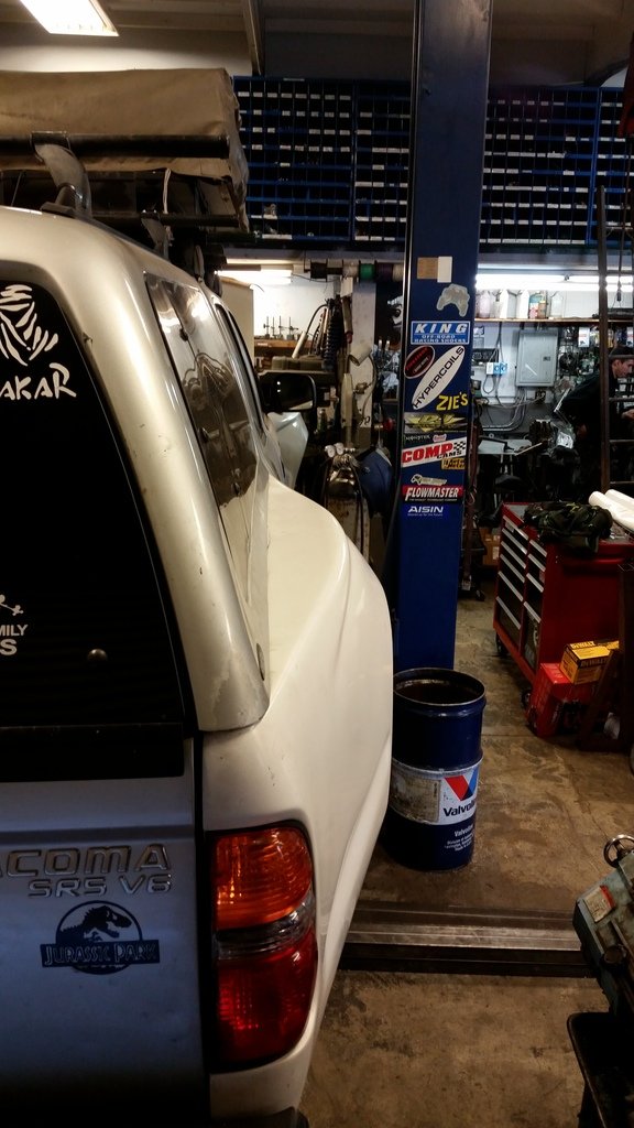

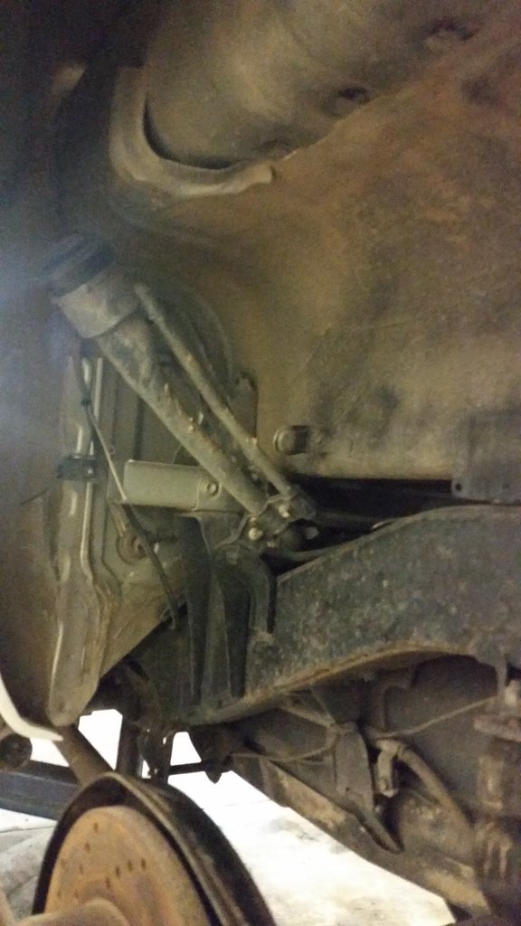

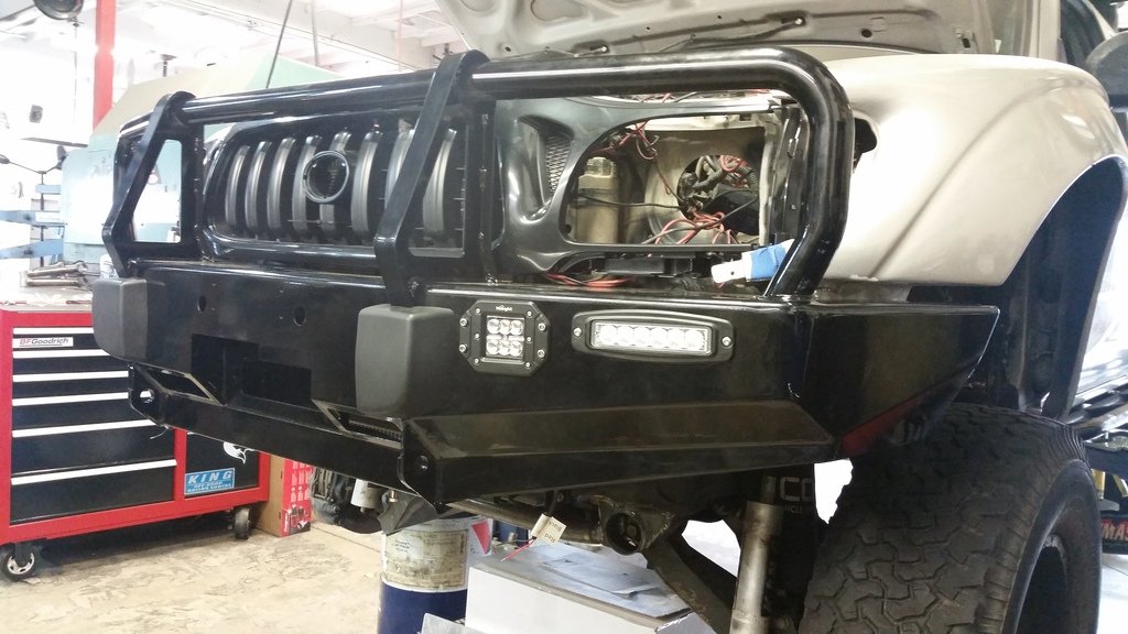

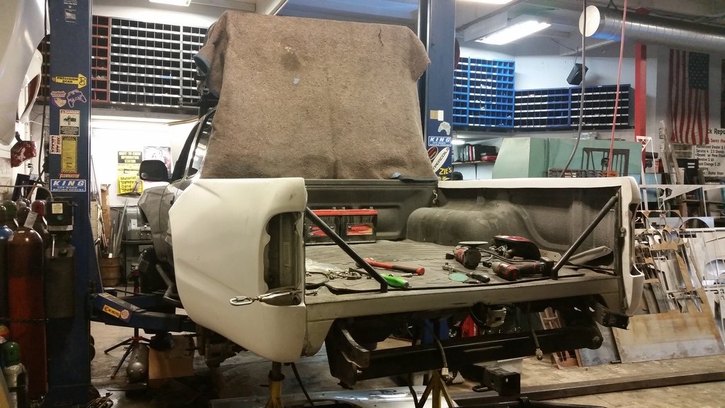

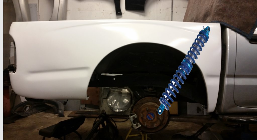

    On to updates!!! I actually have some this time!

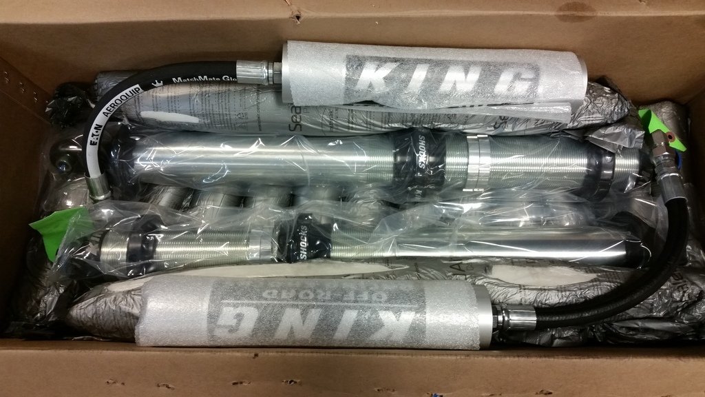

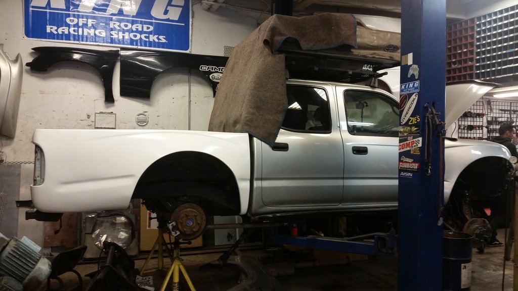

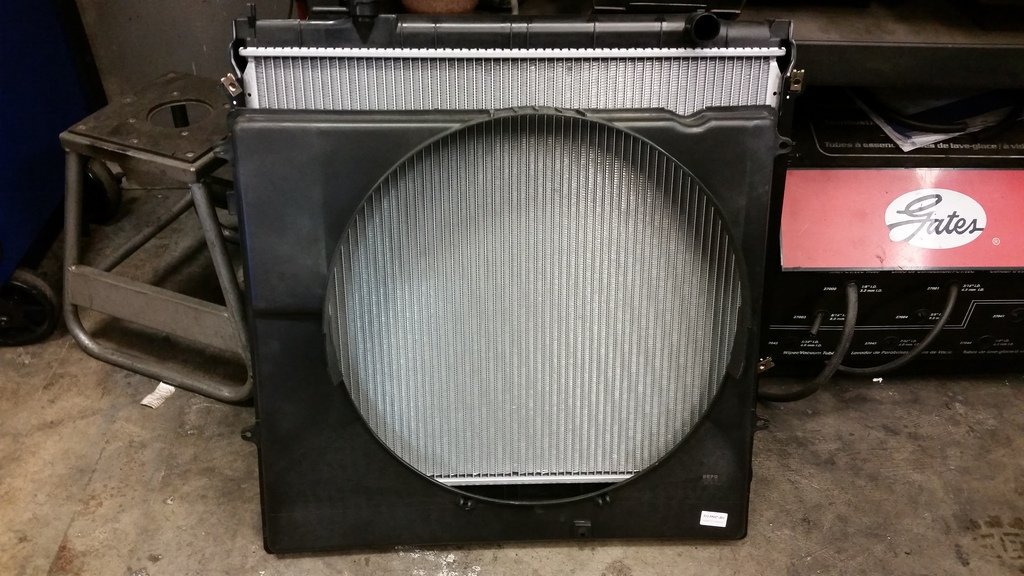

    Trucks finally coming together, shocks have been completed by King, bumper is done, bedsides are getting mounted, and the new radiator has arrived!
    Real trucks have curves!!
    Plenty of room for shocks and 35" now :)

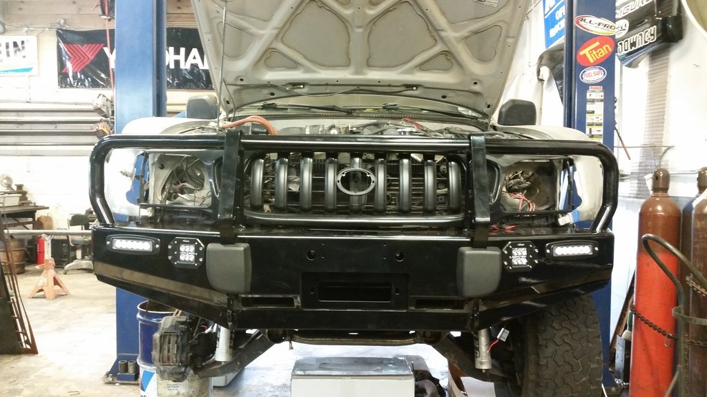

    Bumper is done and off to powder coat. general light alignment. Well protected here.
    Long travel needs more love
    Shock location, strapped at +/-20"

    What do you guys have planned for supporting the camper shell on top of the glass bedsides ? I'm still wavering back and forth on glass...camper shell fit and not wanting to buy new bumpers tho :/

    They are doing some internal bracing for the bedsides to support the weight of the camper/tent. Yea cutting up a brand new ARB is painful, but that's why this truck is one of a kind. Planning on a rear high clearance plate bumper to protect the back end.
    Thanks! Can wait to see everything painted and installed back on the truck! Going to be awesome!

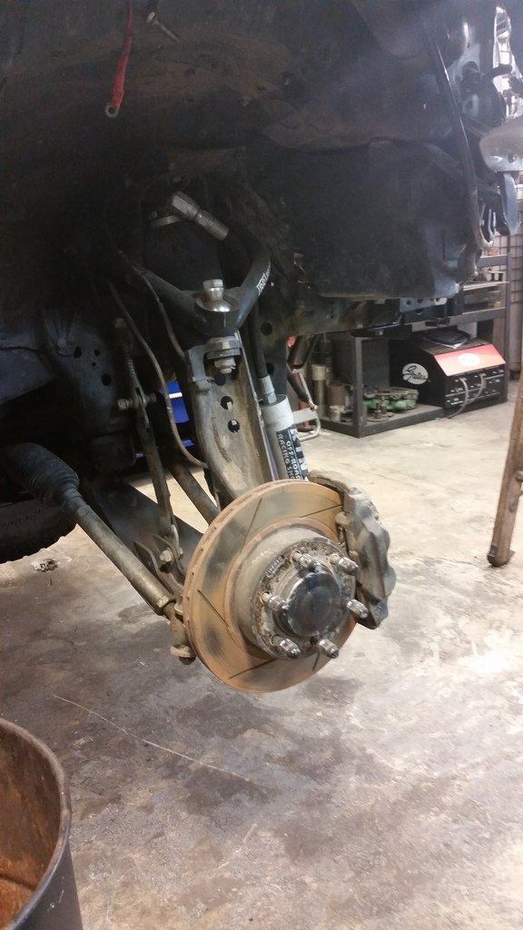

    Taco front end is getting some love, front diff is getting rebuilt with new all new seals, 4.88s gears and an ARB locker.
    Custom gusseting/armor on the LCA mounts and skid plates. Similar to the setup here.

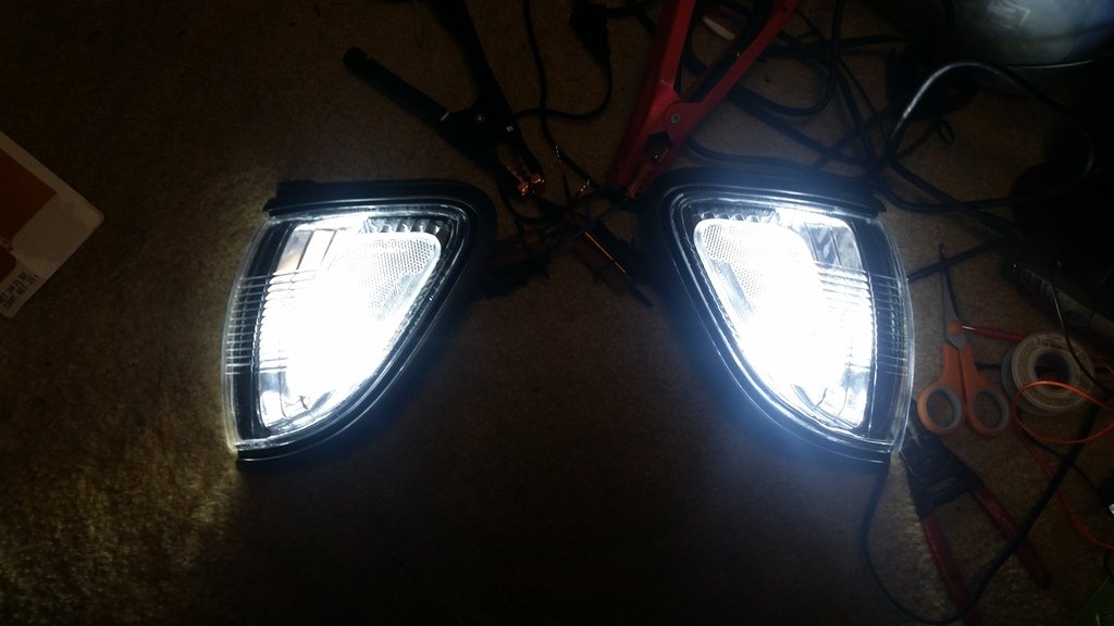

    Also switchback leds showed up. Should hopefully be able to squeeze these into the clear corner lights, if not I'll fall back on dual filament amber bulbs.

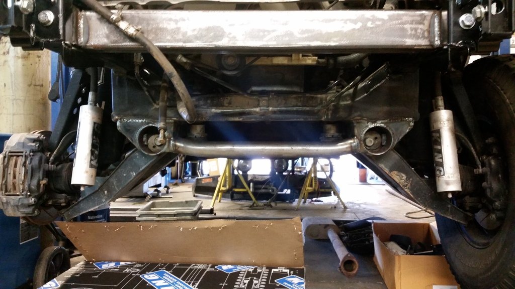

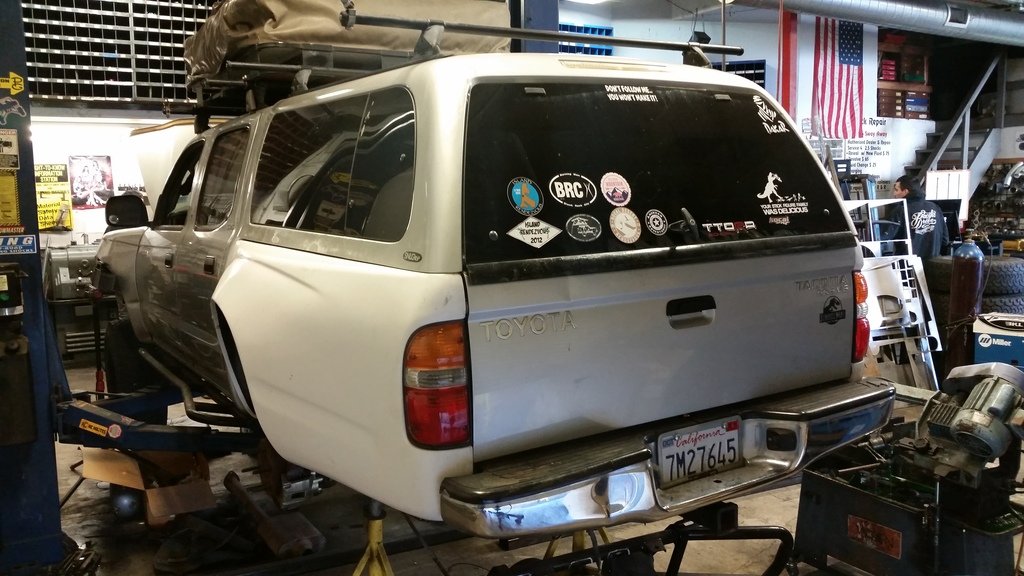

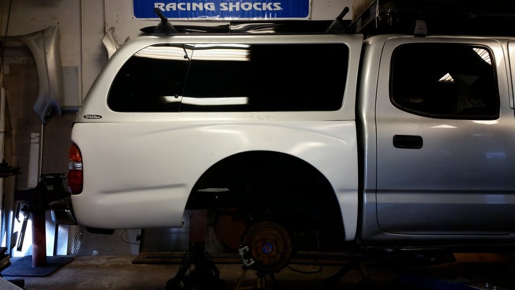

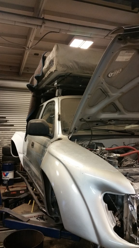

    So I've just hit 30! The first thing I decided to do was go check on the rig. Making some good progress! This is going to be the newest 1st Gen Taco on the road!

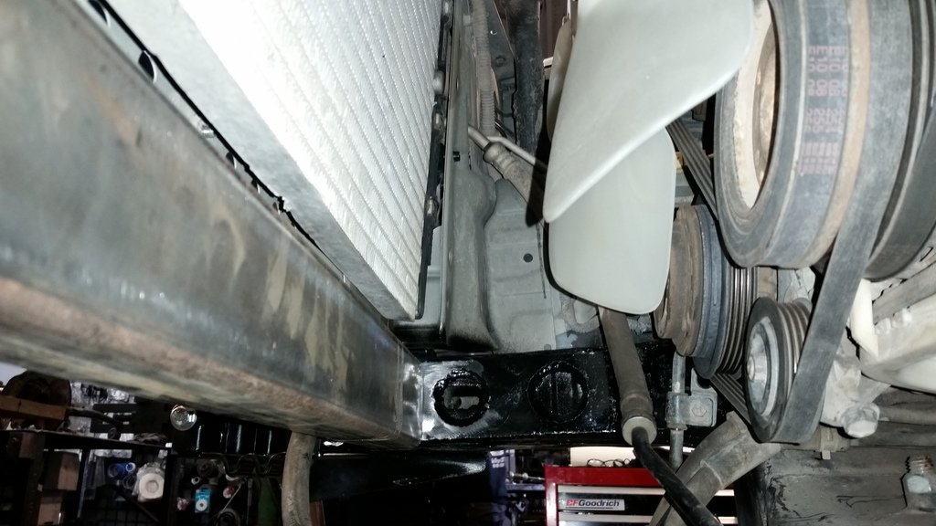

    Custom black out kings are finally done and they are beautiful! Front end work is going into full gear! Some major bracing, gusseting, and armor being done/made.
    New radiator and shroud are ready to go, was able to also able to swap out the horrid chrome grill for a black one. Shell is mounted and looks great! Think the bedsides will give me another camping shelf! haha May line-x the top for some grip.
    Frame horn gussets/frame plates!

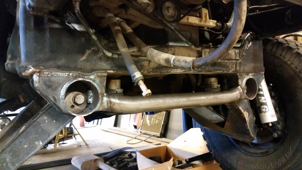

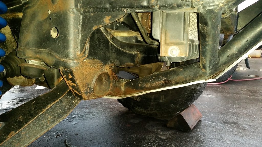

    Cross-member and lower control arm armor/gussets! All to be tied into the skid plate. Just getting started.

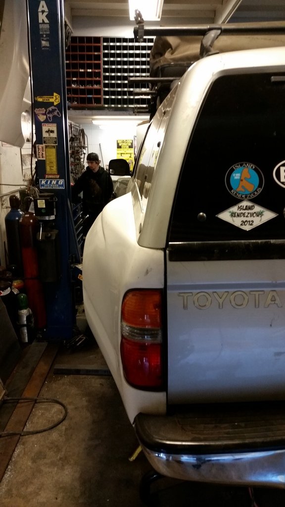

    Camper shell mounted on new bedsides!
    New radiator/shroud!

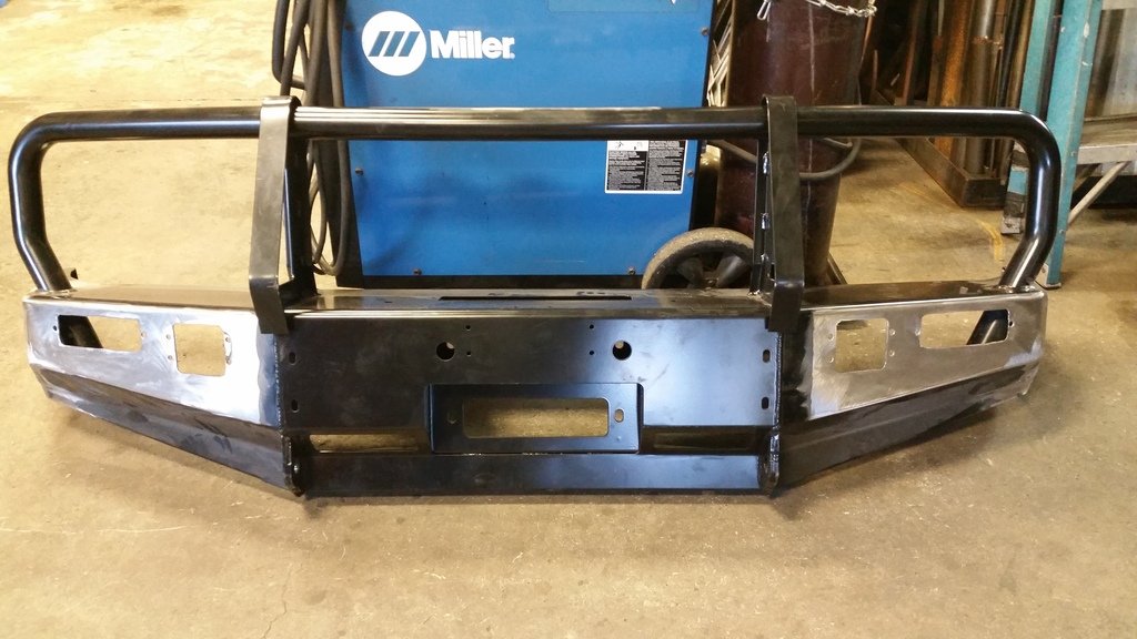

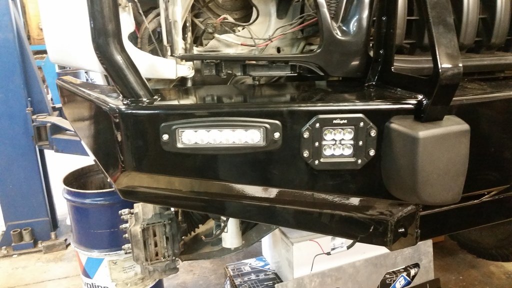

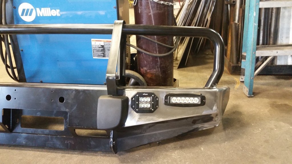

    Bumper is back from powder coating. Think V2 came out great. LED pods are mounted up. Should be able to complete the Skid plate and finish up the front end soon. Just have to do the locker and re-gear.

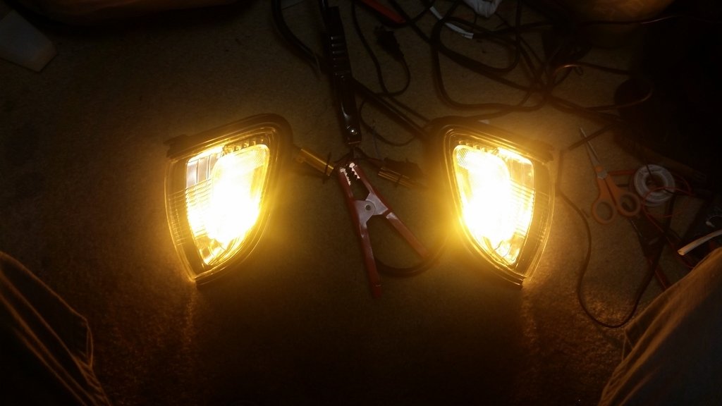

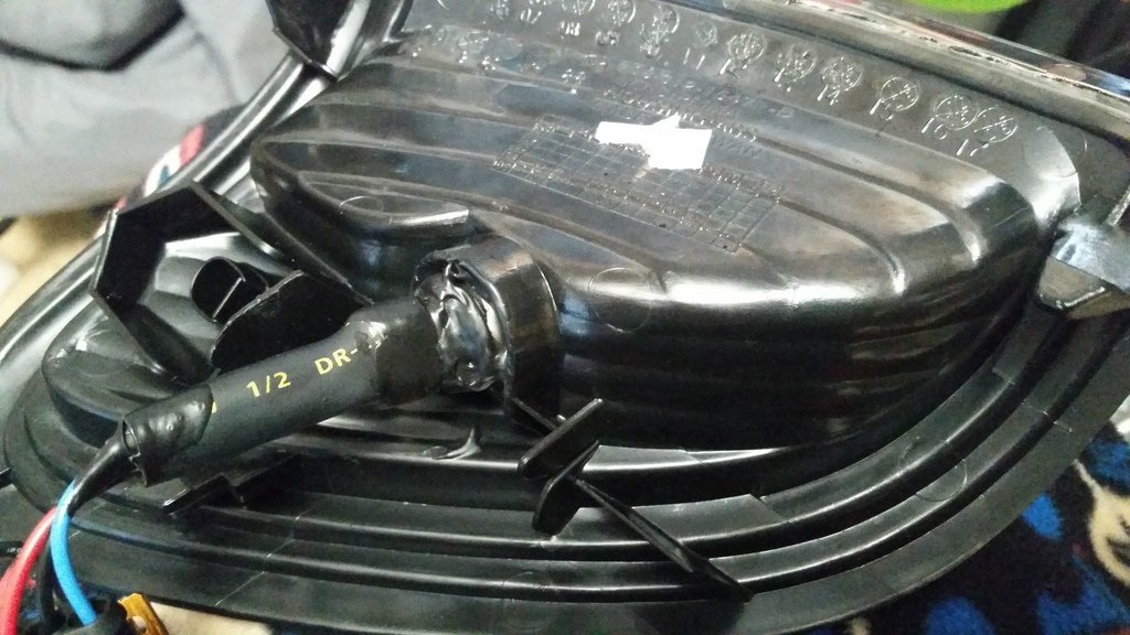

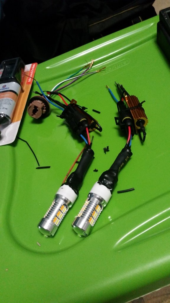

    Just finished my turn signal relocation, they are now where they should have been to begin with!
    So the LED were actually too long so I ditched the socket completely and just soldered and mounted the switchback LED bulb instead. Turned out really clean! Just have to mount them now. Did not have to drill a ton of holes either.

    That setup looks great. Mine I always feel is a little lacking as separate bulbs.
