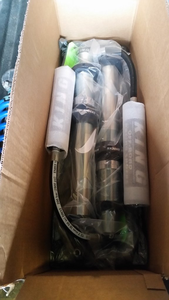

  4. Apr 21, 2017 at 8:37 AM
    #184
    FlapJack935
    FlapJack935 i member
    Nov 25, 2013
    #117294
    3,151
    Jack
    Abq New Mexico
    Wannabe Trophy Truck
    Sick Gnar Trophy Truck Tacoma and King Ranch Raptor Killer
    put them turdy 5s on and show some pics of fit. i really wanna dee that rear glass with 35s at full stuff

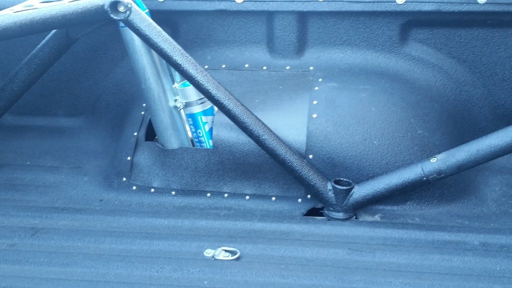

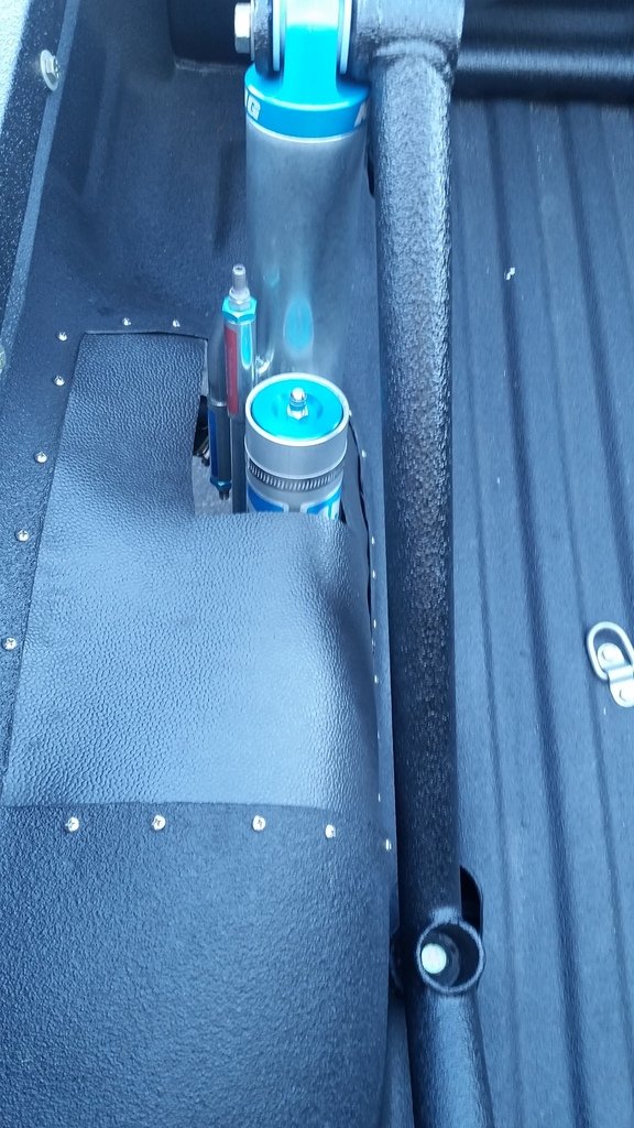

    So..... yea.... apparently they can't get the current setup to work. So everything is getting cut off any going back to a standard 4-link.
    Gas tank situation is still TBD but the truck will handle better and it will pull more travel. Just wont have all the fuel capacity I wanted. But who knows, a custom fuel cell may be in my future.
    Also adding a 1" body lift, will replace all my worn out bushings and just solidify everything a little, will also help with clearance all around.
    Also will be covering up most of the wheel well like this.

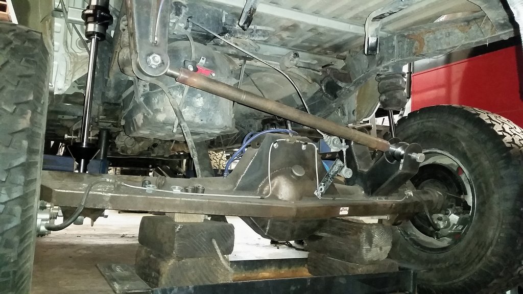

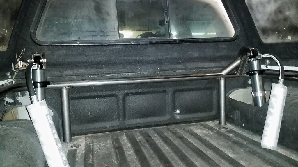

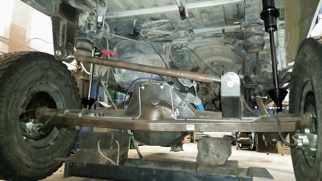

    Well, here are the last shots of it in the current config..
    Apparently the axle shifts too much with this setup, with the with the axle with, tire size and frame the shocks hit the frame. :boom:
    It took a fucking year and a half to figure that out...
    Luckily the axle still has the upper link mounts in place, so they'll just need to chop off the new stuff that they put on. May even be able to go back to the 18"s
