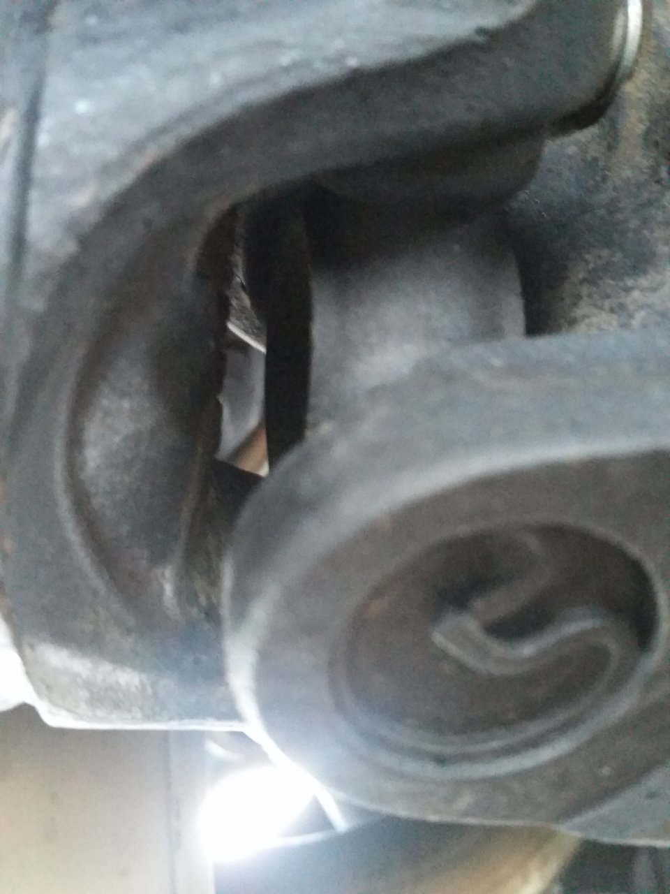

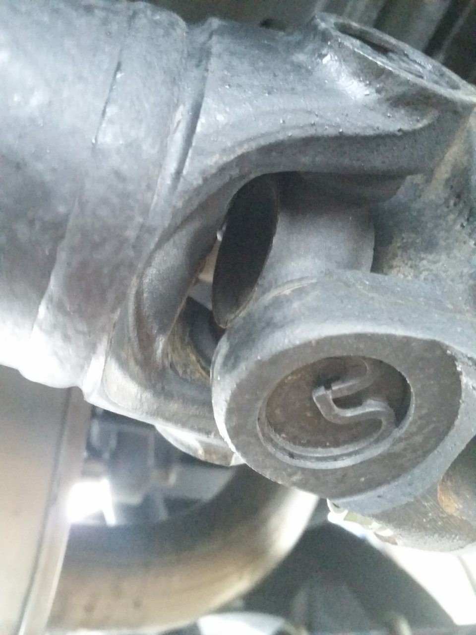

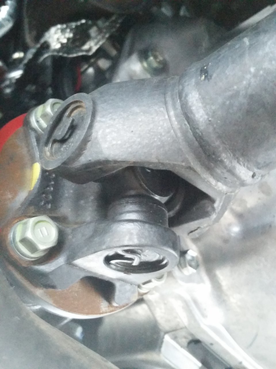

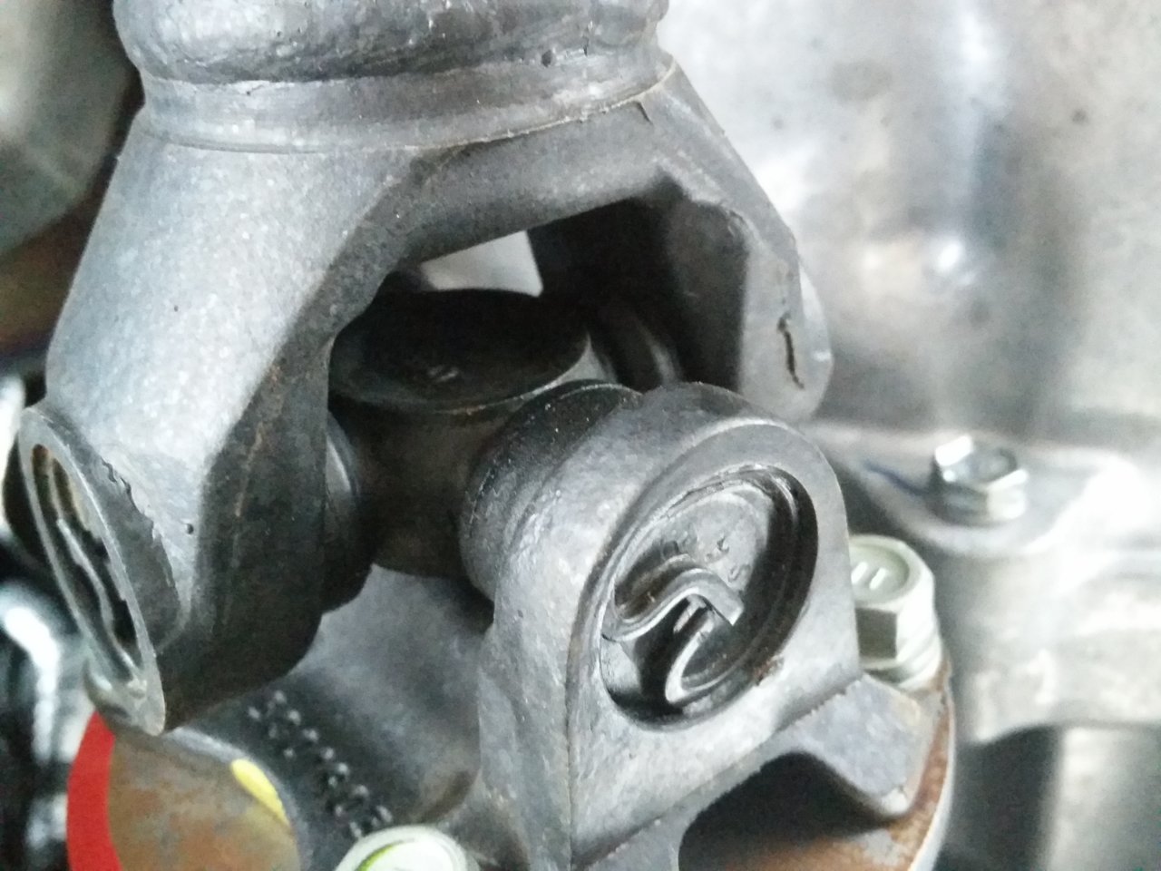

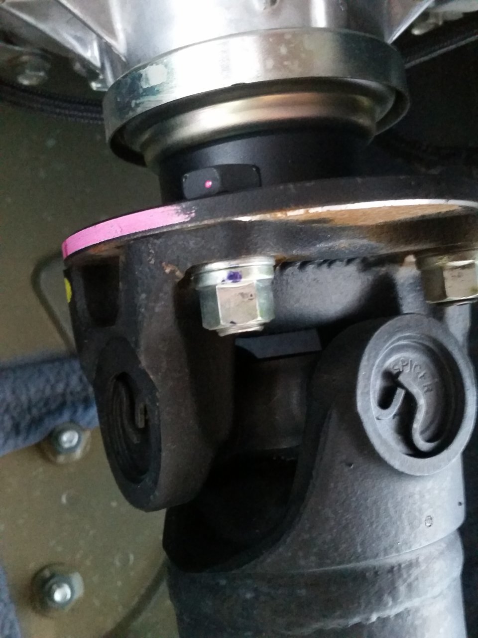

    I went to grease the driveshaft on my 2021 SR5 V6 4WD but it looks like the 2021 models do not have any zerk points. I have seen a lot of varying responses on the zerk fittings for 3rd gens, but I thought most people have said that 2018+ should still have two grease points. Am I just not seeing them or do the newer models just not have any. If there are no grease points is this gonna be some deal where they make you replace the whole drive shaft when U joints go bad. Thanks y'all 20220102_143250.jpg 20220102_143247.jpg 20220102_143049.jpg 20220102_143411.jpg 20220102_143432.jpg

    My 2017 only has them on the front driveshaft.

    I went out and got a lock n lube grease gun, got all set to grease my driveshafts (which is specified in the manual btw) and couldn't find a single one on my 20

    If the U-joints go bad you just change then out like any other, pop the clips off and press them out, not a big deal nor expensive.
    Under reasonable conditions the sealed ones should easily last 100,000+ miles. The front axle shaft (behind the wheel) U-joints on my old XJ Cherokee are the originals with over 200k.

    No Zerks on my 21’ Trail as well. It would just be a universal joint replacement not the whole shaft. And yes I’m pissed!

    My 2023 has zero grease points I was crawling under there looking high and low. I'm very disappointed after buying a new grease gun

    My ‘22 has zero zerks at the moment (OEM)…that will increase by 6 once the JBA UCA’s are installed.

    My 2018 TRD OR built in June of 2018 has exactly one grease fitting at the front of the front drive shaft and none anywhere else, so that's the one I grease.
