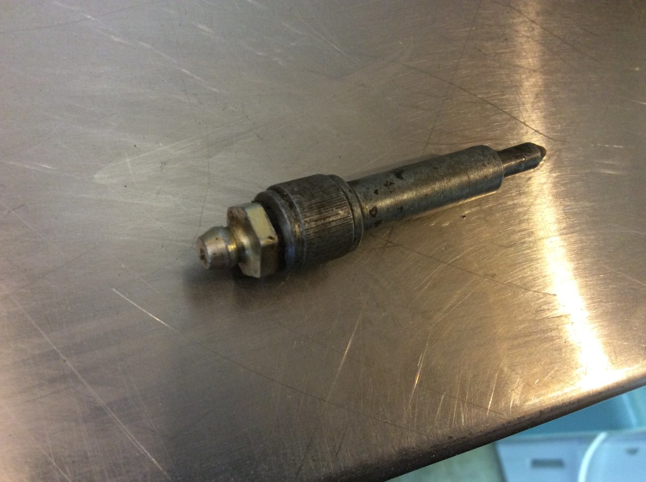

    I have a zerk on my old Jeep that I absolutely can’t get the gun on it. This adapter works great!

    It does work great! And it's relatively cheap.

    ^^This. They’re cheap (got mine for Less than $10 bucks) work well, and instead of screwing/unscrewing to your grease gun hose you can put a Zerk on the threaded end for speed and less mess.....
