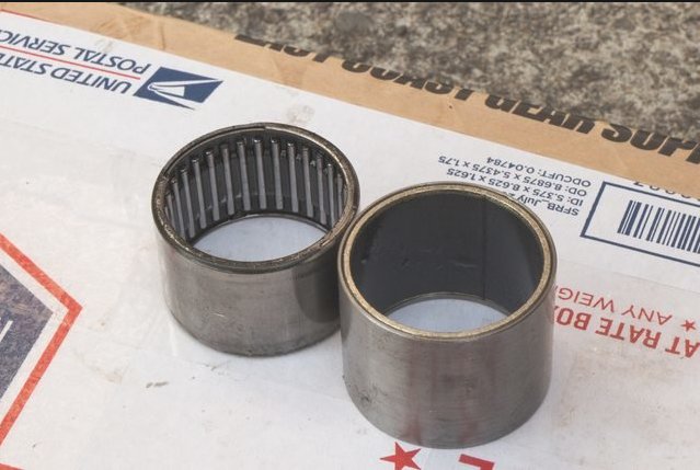

    But what is a "needle" and what does it do? And I thought I saw something about replacing the "needle" with an ECMG?

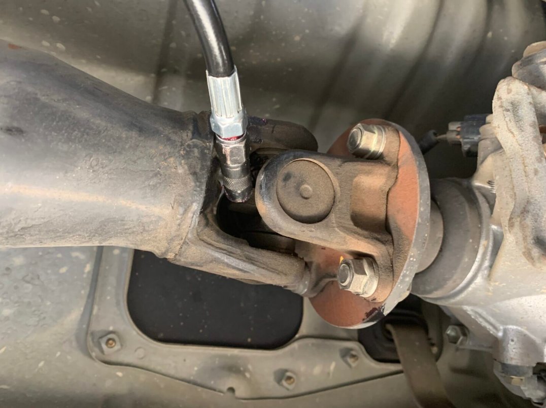

    And what is the "zerk" access required for "needles"? And will my RCI transmission skid and cat shields interfere with it?

    A needle is a type of roller used in a bearing.
    The needle bearing is in the front drivers side different.
    It’s the bearing the CV rides inside of in the differential.
    You don’t usually have to replace the bearing unless you get vibrations.
    This usually happens after you lift the truck. And it doesn’t alway happen.
    The zerk is the fitting that you use to grease the propeller shaft.
    The propeller shaft is also known as a driveshaft.

    Regarding "what is a needle?": There are needle bearings in the front differential. The CV axles going from the wheel bearing to the front differential rest on these needle bearings (shown below on left). East Coast Gear Supply (ECGS) is a company that manufactures a solid bushing to replace the weak needle bearing and is a common point of failure when you lift the front end more than 2" (shown below on right).

    To add on to this comment, zerk fittings are where you connect your grease gun. Regarding the propeller shaft aka the drive shaft, you are greasing the needle bearings inside the universal joints (commonly shortened to U joints). Sometimes the zerk fitting is hard to reach as shown in the image below, but it's not all that difficult after you've done it a few times.
    2023-04-10 01_20_13-How to Grease the Driveshaft (RWD)_ 1st Gen Toyota Tacoma - The Track Ahead.jpg
    Re: "And will my RCI transmission skid and cat shields interfere with it?" On the rear shaft, probably not. On the front shaft, yes you will need to drop the skids in order to properly grease the driveshaft that turns the front wheels in 4WD mode.
