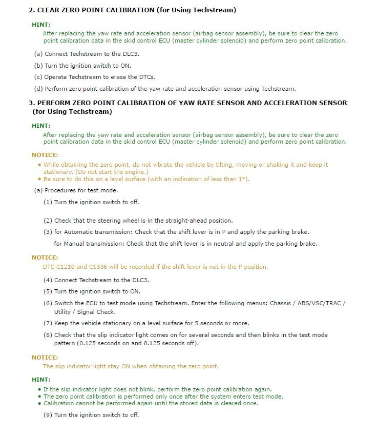

    It's a function. Connect, navigate to the ABS ECU, hit Utility, then Reset Yaw Sensor (or something like that). From there, the instructions will say to park on a level surface, have the ignition On (or engine running / can't remember) with the wheel centered, and then hit the reset button.

    Good one. I'll edit my post to note Utility instead of Active Test.

    If you have a CEL / warning light, then there is no question, the dealer will know the exact issue.
    Yes. We all have the exact same software as the dealer. What we do not have are the targets for the radar and camera calibrations. I didn't have luck making one. Of course, it could have been the setup that didn't work. Much longer story there.

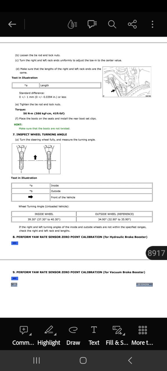

    Had you ever had an alignment after your lift?
    I believe the calibration is a matter of course after alignment; especially if it's as bad as a lift would make it.
