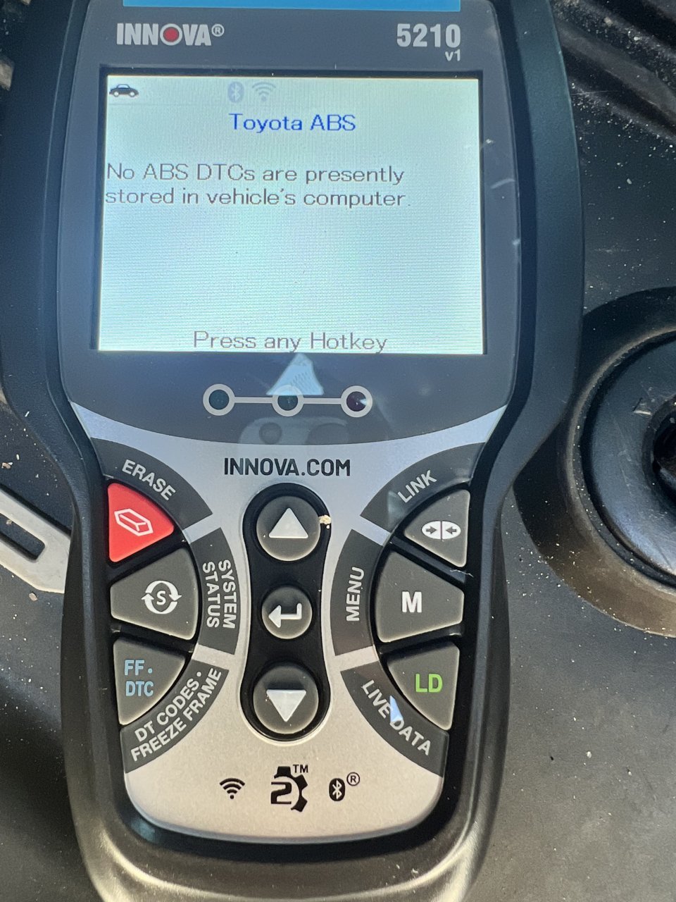

    Ncpi007
    Ncpi007 Well-Known Member
    Dec 15, 2019
    #313354
    455
    Charlotte, NC
    2018 Tacoma TRD Off-Road
    I love Tacoma World. I replaced my steering rack & pinion and got lots of blinking lights. I ordered the INNOVA 5210 from Amazon for $89 and it worked. Amazon had it to me next day. FYI - I tried the paper clip method like 10 times, it did not work. Saved me a trip to the stealership. Thank you all that contribute.
