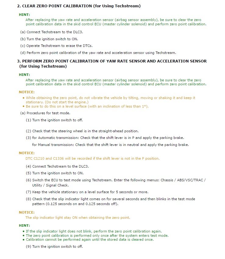

    Zero point is typically done via Techstream, the DLC pins were an alternative way to do it without Techstream.

    Go to any reputable local alignment shop and ask them to do a steering angle reset. Or better yet, your local family mechanic might do it for lunch money.
