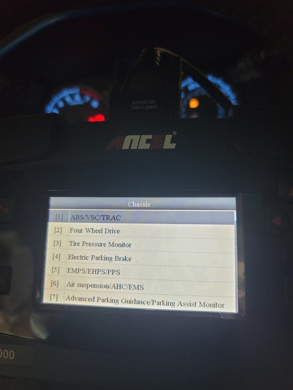

    I had the same issue with the shop that did my alignment. So when my VCS and pre-collision malfunction codes turned up on my dashboard, the shop said that as long as my truck is aligned with their computer. They have done their job. As far as fault codes comes up, not their problem and to see my dealership to reset it or calibrate it with their special tool. What was this special tool?? Knowing that the stealership would charge me an arm and a leg, I decided to do some TW forum reading, youtube troubleshooting and whatever else is out there. I've been reading up and had the same problems with the VCS and "pre-collision system malfunction codes, see your dealer" codes. I went to several auto shops who quoted me $140 p/h for diagnose and then to calibrate to zero for the VCS and for the collision sensor to do a "special tool" to be calibrated. estimate $700- $1k! Out of all the 5 shops I went to Only one shop who was able to do a free scan with his professional obd2 scanner tool. But wasn't able to read the fault code due to his scanner was not up to date with newer models 2019 and up.
    I was running out of options and since I have a 2019 and not be able to do the paperclip reset like the older models, I finally decided to get the right scanner for the job, product down below. This was a lifesaver and will save me $$ in the long run. Probably paid for itself already and then some.
    And since I maintain my vehicles mostly. And since I've been hitting the trails more often, I'm pretty sure this messages will probably come up again. As long you update the scanner via usb to computer and if it's all aligned I could just clear the codes again. Hope this helps!
    Btw, I'm not an affiliate or any sponsor. Just a regular guy who wants these codes to clear up, barring no major real problems to my truck. I've tried several other obd2 scanner with no luck but this one cleared it. Just my 2 cents and hoping to help others with this fix..

    Did this fix the issue for you

    Yes. Problem solved. Fault codes did not come back and none ever since.

    I bought scanner and cleared the code. Turned out the lift made it throw a steering alignment code that through off the TSS. All good now. Thanks again!

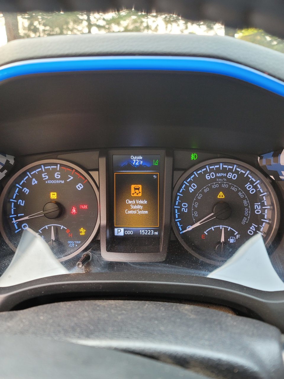

    My VSC and pre collision are going nuts. Took my 18 Sport to a local shop for an alignment and they’re telling me I need a yaw sensor replaced and reprogrammed at the expense of $1700. My dash still looks like a Christmas tree and the alert center is killing me with all the messages flashing. I stumbled across this thread and now I definitely feel like they were trying to find a sucker. I see since this thread is older that some of the scanners mention are in production any longer. What have yall been using?
