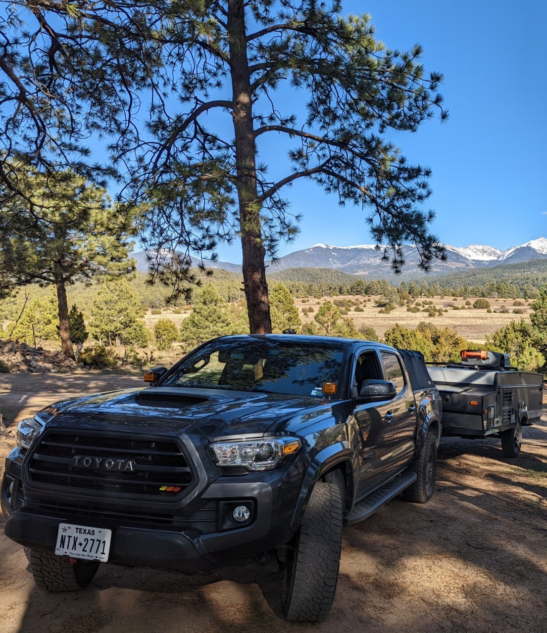

    Rock Lobster
    Rock Lobster Thread Derailer
    Dec 14, 2018
    #275833
    13,436
    Dee Eff Dub
    I drive a Miata.
    I've pulled trailers at altitude, (the picture is just cresting 9,000 feet, but it's spent the night above the tree line once or twice) and I've experienced the same at even higher altitude (gotta love those 10-12k fire roads).
    I know the feeling. That "is it gonna make it, or are we about to stall out with no way to reverse down" kinda feeling.
    But then again, it's never stalled or stranded me either. It won't go fast, but it'll go. That's good enough for me. Just kick it into low and let it go.
    I don't even have 4L. :anonymous:

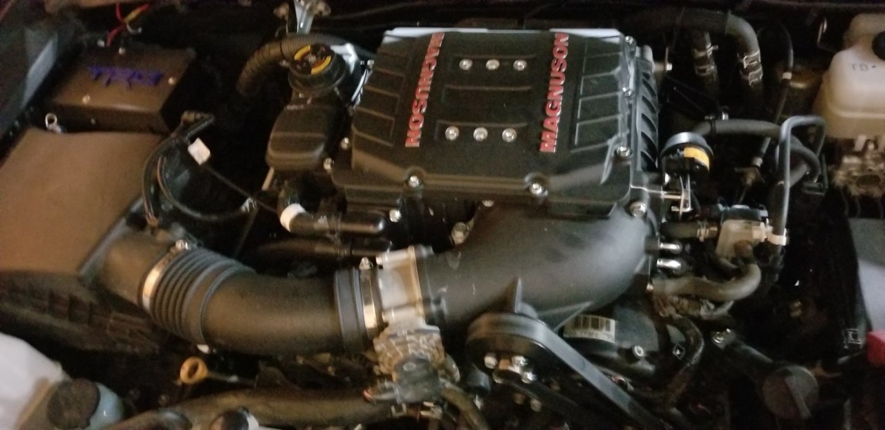

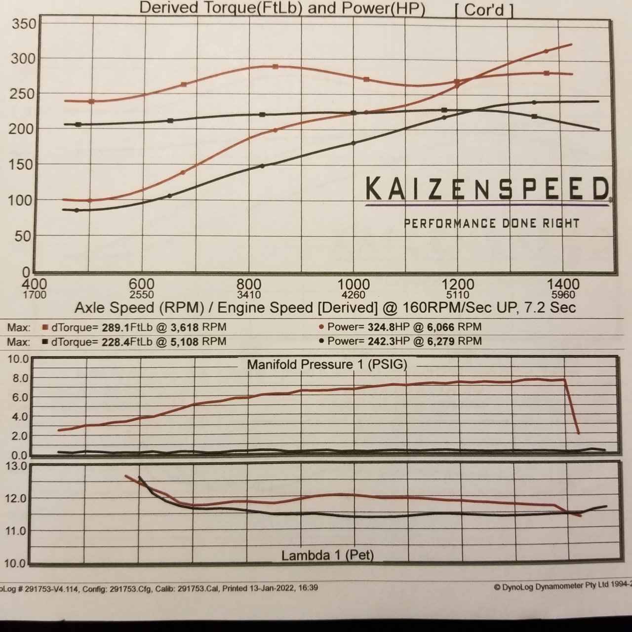

    Metalhead514
    Metalhead514 Darth Taco
    Jun 1, 2016
    #188494
    529
    Nate
    Washington State
    '16 TRD Off Road
    MBRP catback, Magnuson TVS 1900 Supercharger, Injen Evolution intake, Race Louvers RST hood vent, Avid front and rear guards and side steps, Cali raised front/ rear LED's, TRD Pro Skid plate, custom aux fuse box, Bak Flip tonneau.
    Magnuson has a fix for that.

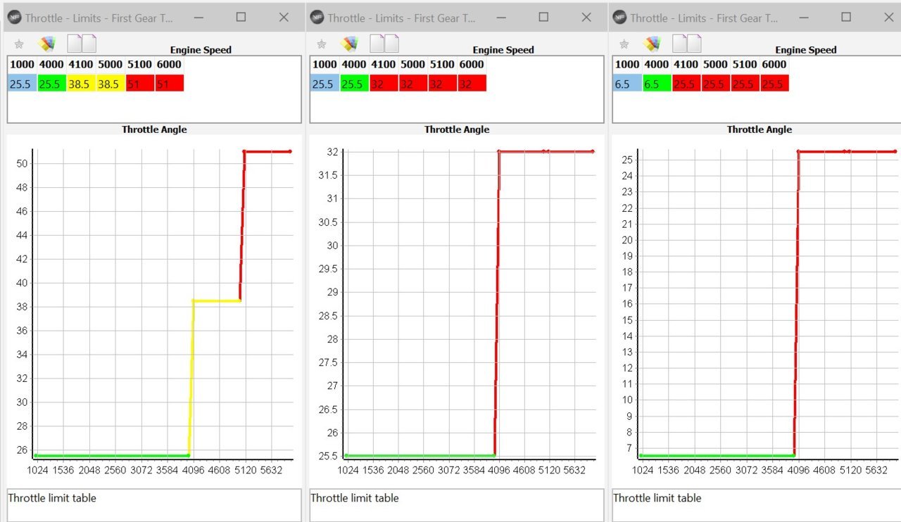

  12. May 29, 2022 at 8:34 AM
    #32
    BortisYeltzen
    BortisYeltzen Well-Known Member
    Dec 17, 2016
    #205105
    1,257
    Barrett
    Salt Lake City, UT
    2017 MGM TRD Off-road DCLB
    OTT Tuned, Bilstein TRD Pro lift, ECGS bushing, Heated Clazzio's, RCI SKID TRILOGY, BAMF sliders, ARE V-Series shell, RokBlokz flaps, more to come
    Were you in 1st gear? 4Hi or 4Lo?
    Toyota limits 1st gear throttle on the stock tunes. 4Hi limited to 32%, 4Lo limited to 6% up to a certain RPM and then 25%. So putting your foot to the floor doesn’t do anything in these situations. These limits can be changed with aftermarket ECU calibrations, but at the risk of your CV’s and front diff. Toyota limits throttle for a reason.
    Edited to add image showing throttle limits on stock ECU calibration. 2Hi limited to 51%, 4Hi 32%, 4Lo 6% up to 4K rpm, then 25%. The truck has more power than Toyota wants you to have in many situations.
