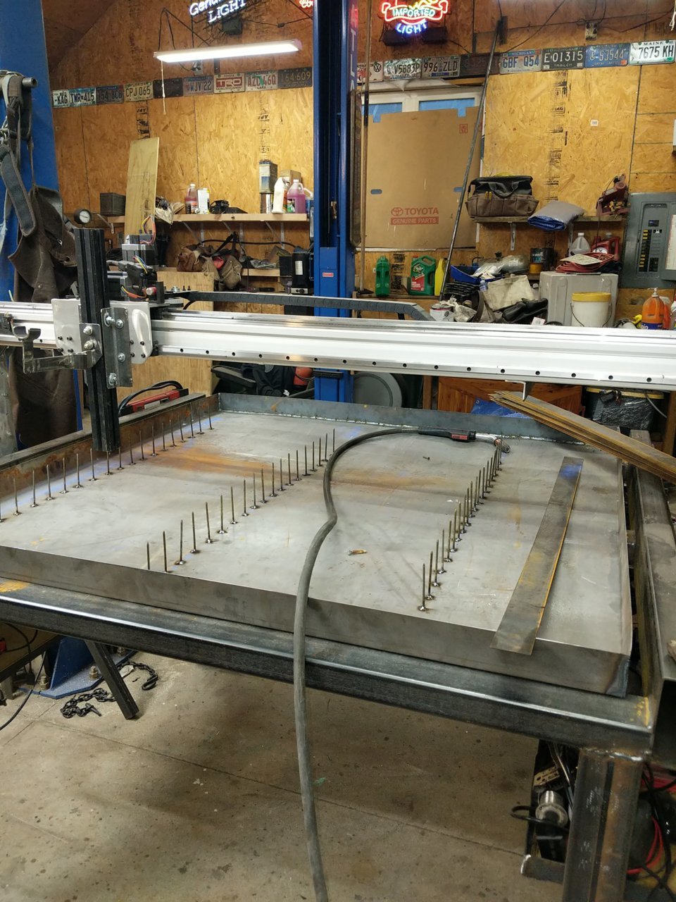

  5. Mar 28, 2021 at 3:37 PM
    #265
    koditten
    koditten [OP] Well-Known Member
    Sep 8, 2013
    #112077
    18,417
    Kirk
    Central Michigan
    04 trd x-cab 4 x 4 3.4l
    Reserected from the dead.

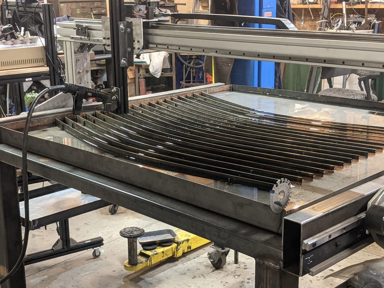

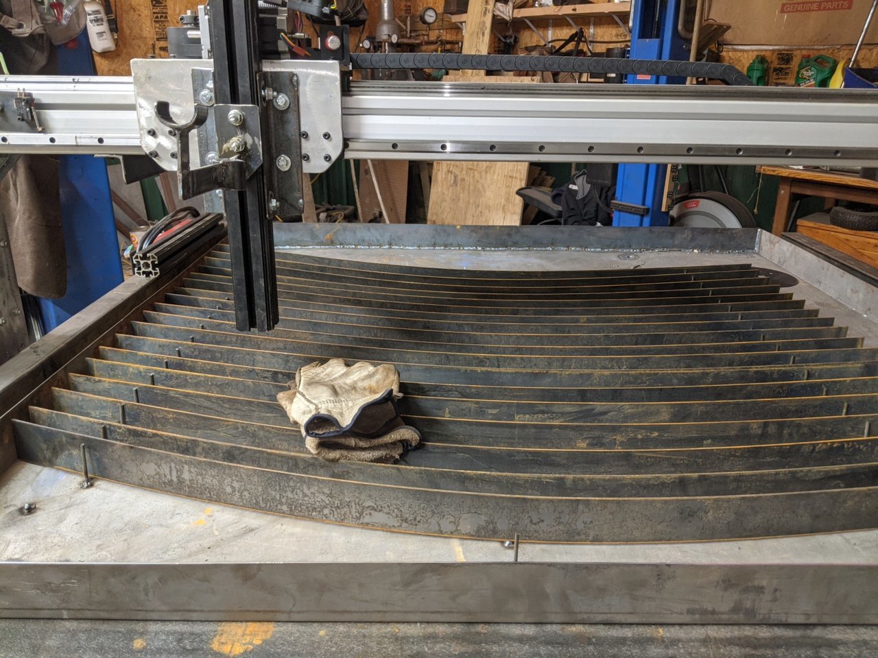

    Making a cnc plasma table.
    I've been moving those 16 penny nails for years! Figured they would make great supports for the slats.
  6. Mar 28, 2021 at 4:24 PM
    #266
    koditten
    Sep 8, 2013
    #112077
    18,417
    Kirk
    Central Michigan

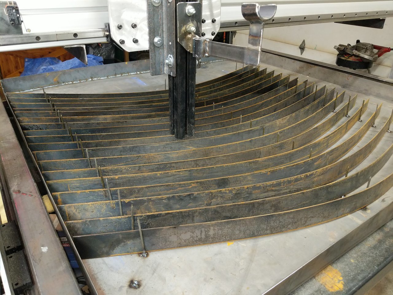

    Nails trimmed. Slats in place.
    Will need to leak test tomorrow.
    Soapy water and compressed air will help with that.PXL_20210328_231303037.jpg

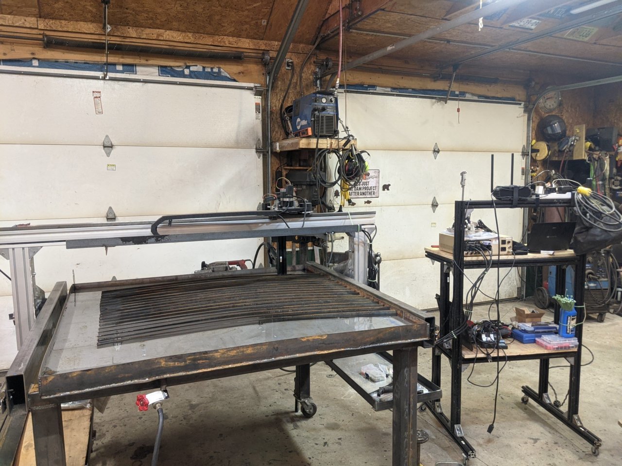

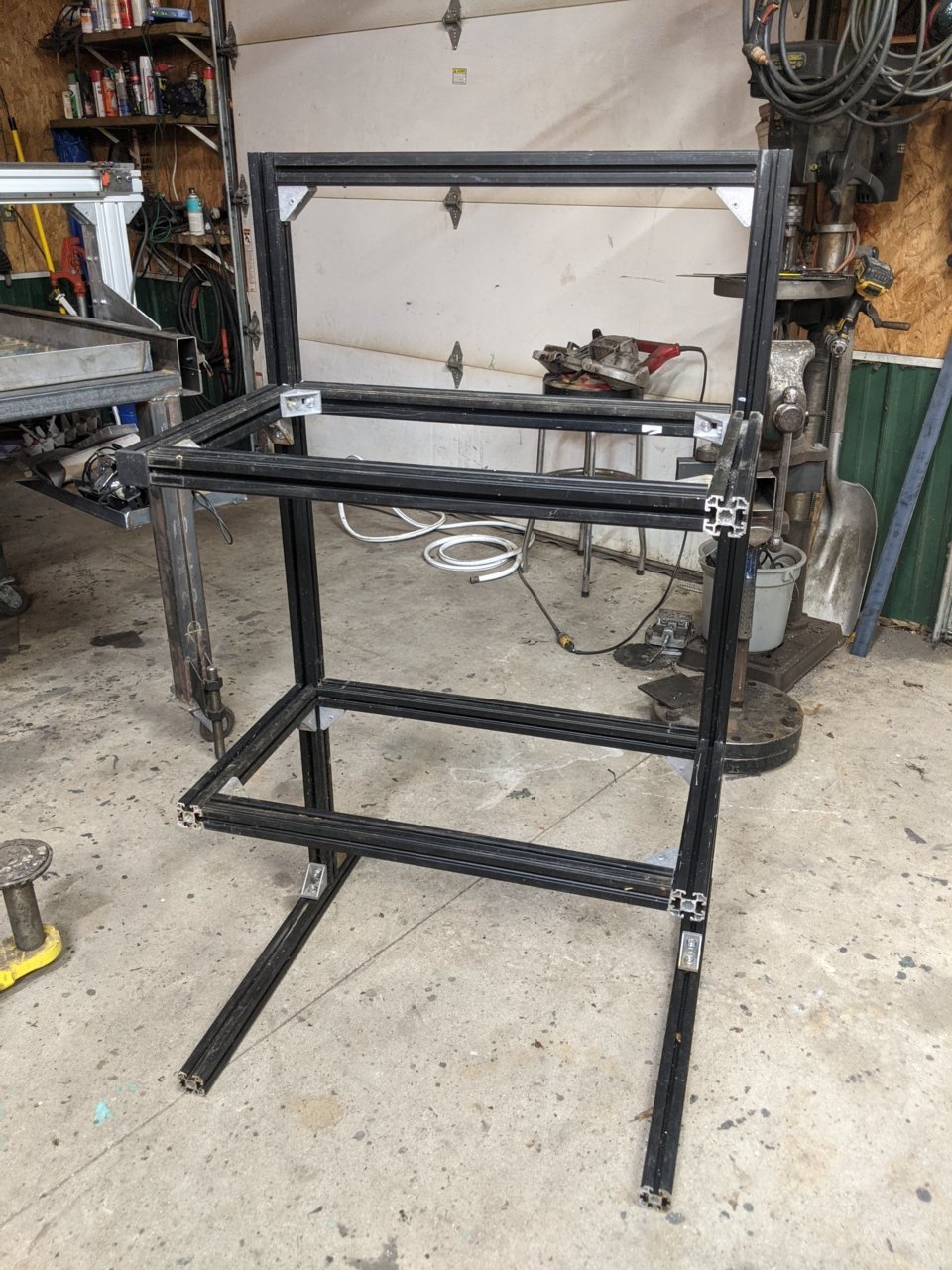

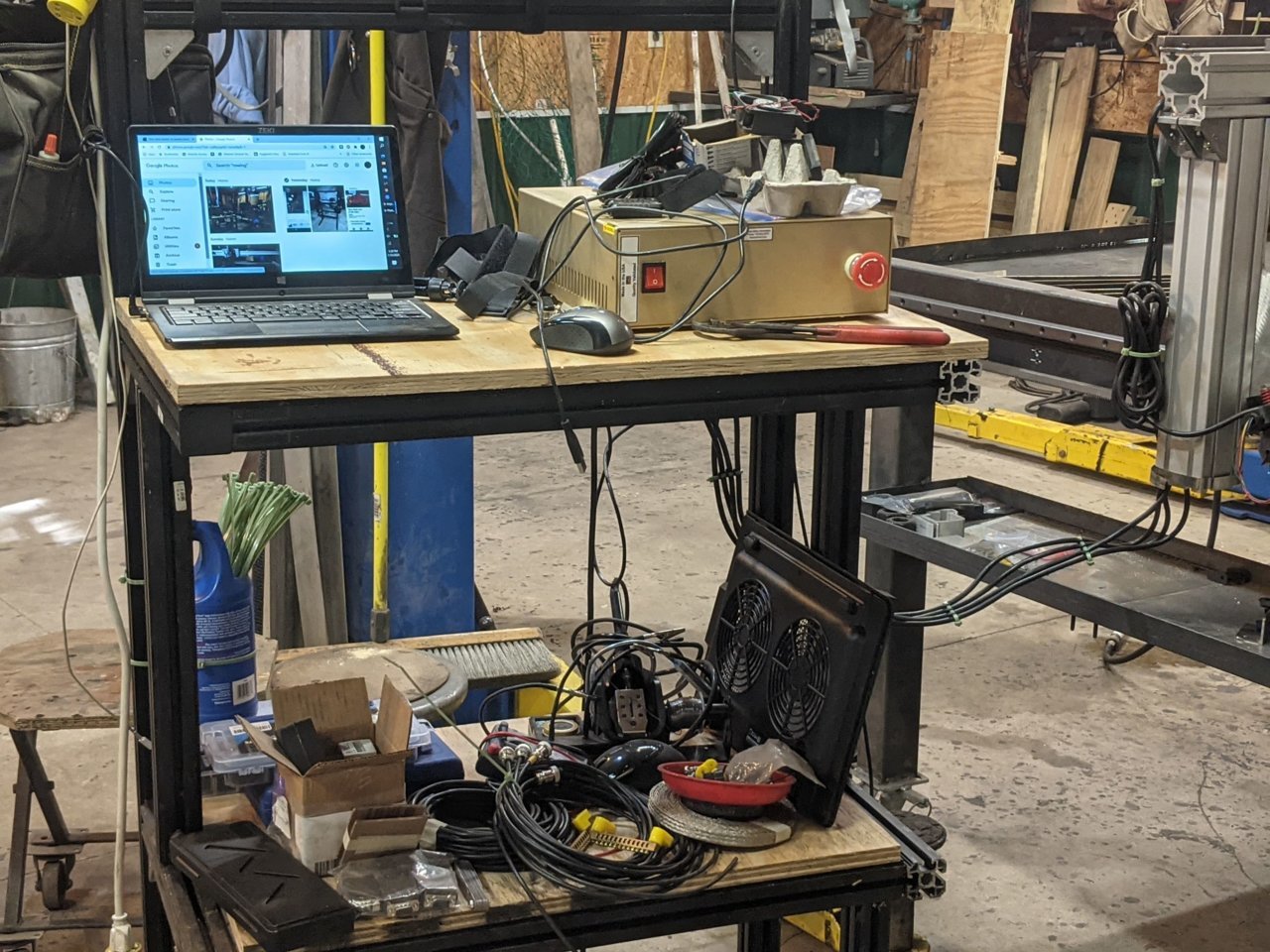

    Threw together a controller/computer stand. I got loads of this extrusion, might as well put it to use.
    I feel better keeping the controller and the computer separate from the table. When not in use the stand will nest under and above the plasma table. Will grab some nice castors tomorrow.

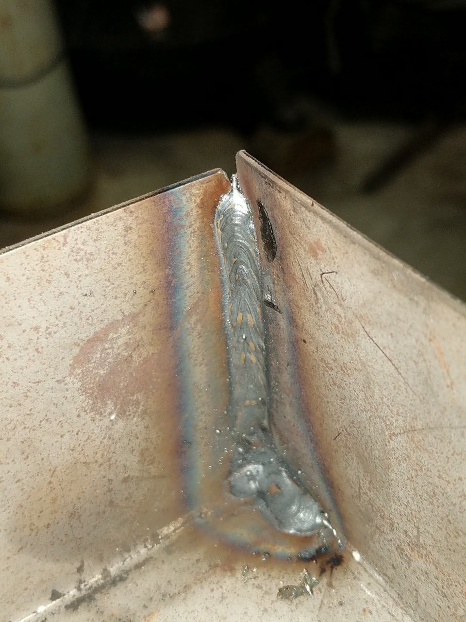

    Btw, I had 2 spots that were leaking. Welded those tight and retested. No soap bubbles.PXL_20210329_224546855.jpg

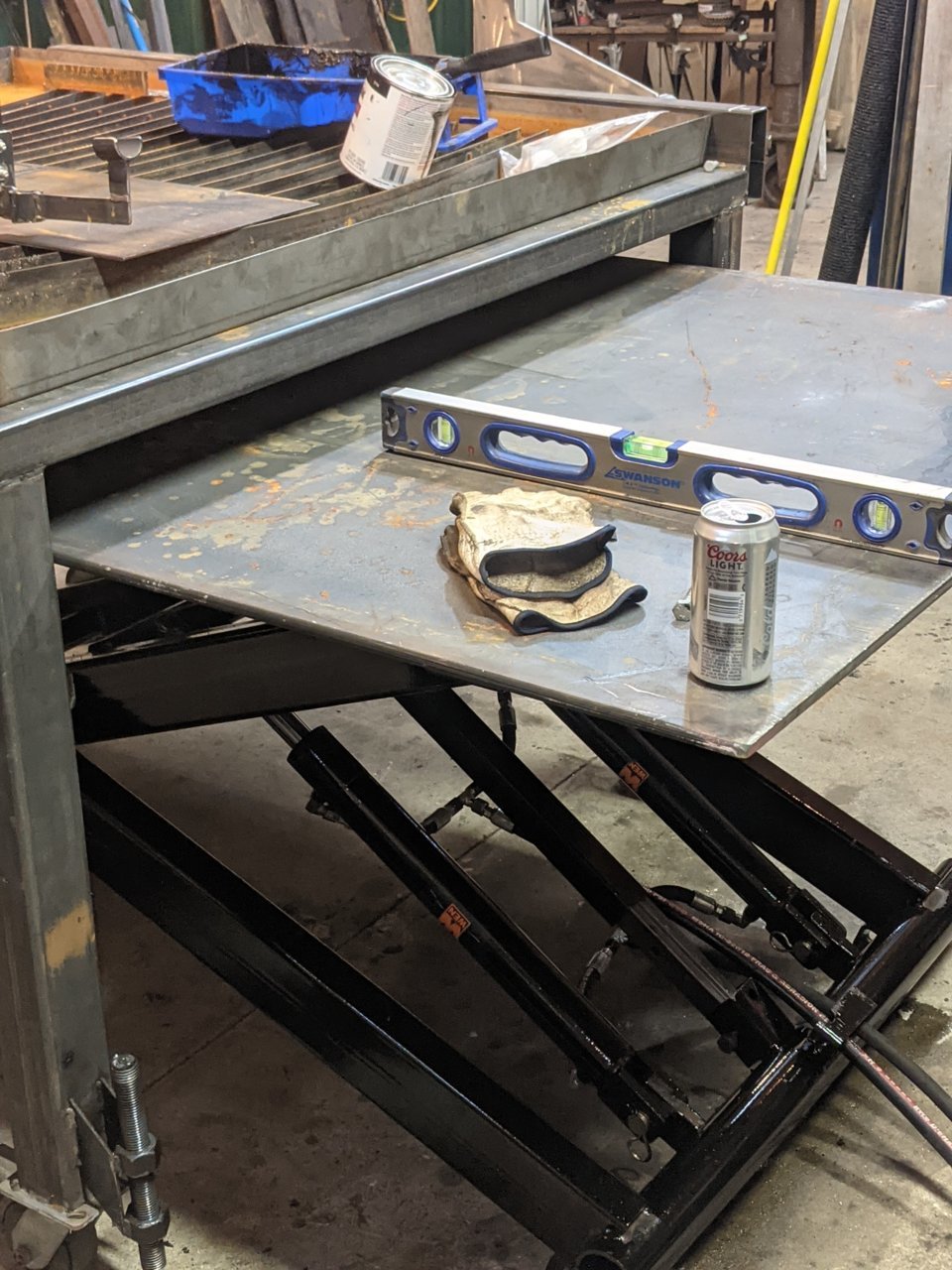

    Clicking down the punch list.
    Work station built-Check
    Water pan filled with water- Check
    Plasma table leveled-check
    Cables ran in a some what satisfactory manor-check
    after i get a bunch of testing done, I'll most likely move the spare parts back to the table storage shelves.PXL_20210330_211957077.jpg PXL_20210330_212633165.jpg PXL_20210330_212652280.jpg PXL_20210330_212710997.jpg

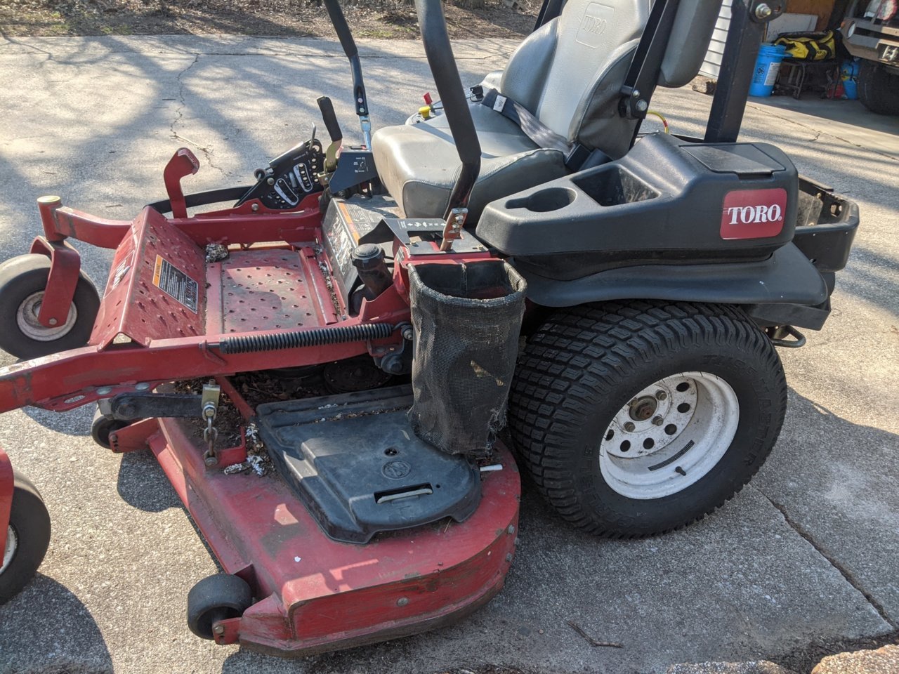

  9. Apr 3, 2021 at 5:59 PM
    #269
    koditten
    Sep 8, 2013
    #112077
    18,417
    Kirk
    Central Michigan

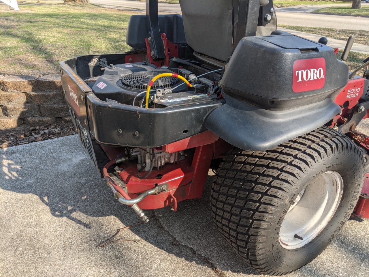

    To the road it goes.
    PXL_20210403_210511885.jpg PXL_20210403_210450760.jpg PXL_20210403_210440426.jpg
  10. Apr 3, 2021 at 6:20 PM
    #270
    six5crèéd
    six5crèéd Go fish.
    Jul 9, 2019
    #298734
    31,592
    Southern Virginia
    What did you have to do to this one, I probably saw it but don’t remember.
    RustyGreen and T-yoda like this.

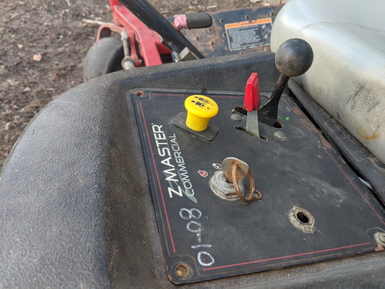

  11. Apr 3, 2021 at 6:50 PM
    #271
    koditten
    Sep 8, 2013
    #112077
    18,417
    Kirk
    Central Michigan
    It got a new Predator engine.
    Also I reworked the choke set up. For some reason Toro likes to use the pull the knob up type choke cable. These have a bend in the cable just down stream of the knob. They always break from the constant bend. I install a linear version that is not factory but works better. I'll snap some pics in the daylight so it is easier to understand .
  12. Apr 4, 2021 at 5:08 AM
    #272
    koditten
    Sep 8, 2013
    #112077
    18,417
    Kirk
    Central Michigan
    Here is a pic of the new choke lever installed. You can see the slot that needs to be cut in the face plate.
    The empty hole us where the old choke knob resided.PXL_20210404_114800292.jpg

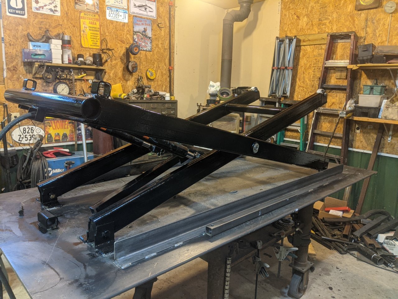

  17. Apr 9, 2021 at 8:51 AM
    #277
    koditten
    Sep 8, 2013
    #112077
    18,417
    Kirk
    Central Michigan
    A bit of progress and random babbling...wasn't even drinking yet...

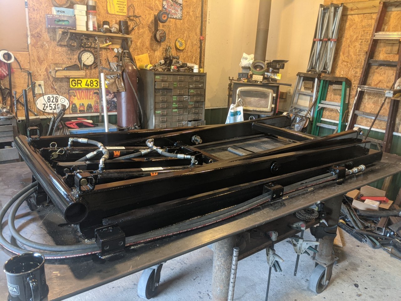

  18. Apr 10, 2021 at 7:55 AM
    #278
    koditten
    Sep 8, 2013
    #112077
    18,417
    Kirk
    Central Michigan
    Under carriage painted.PXL_20210410_133819618.jpg PXL_20210410_141616538.jpg

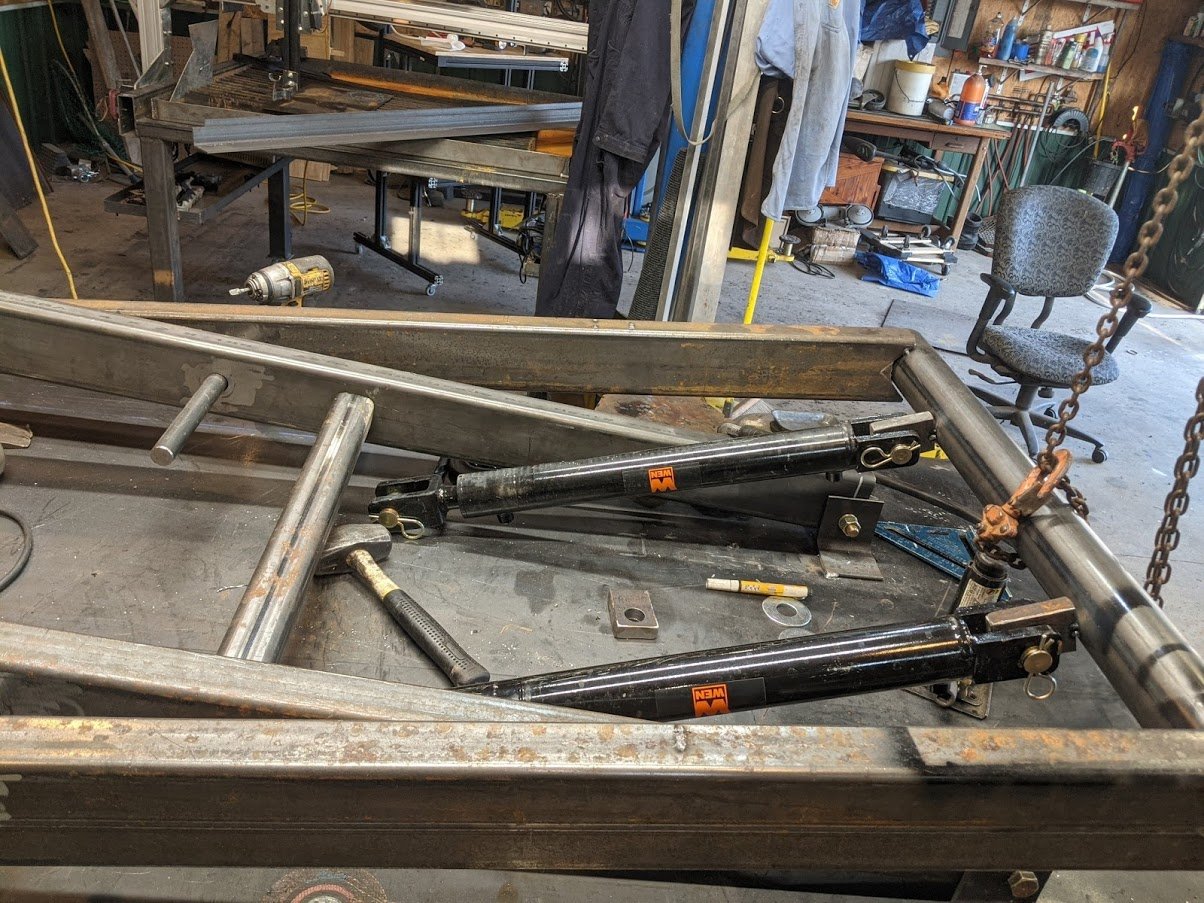

    Sometimes it better to be lucky than good.
    I had no idea that the span between the legs of the plasma table would be wider than a 4-ft wide piece of flat steel. I did not measure them when I built the plasma table.PXL_20210410_210119331.jpg

  20. Apr 10, 2021 at 2:32 PM
    #280
    koditten
    Sep 8, 2013
    #112077
    18,417
    Kirk
    Central Michigan
    Flipped over and test ran. At least I know it will lift a 12 ounces.
