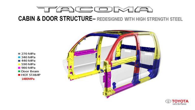

    Don't third gens have cabins made out of aluminum? That's what I read so don't need to worry about body rust, just the frame

    No, super high strength steel.

    Lol! I thought that's what Mike said about the frames. You sure?

    If you own a 3rd gen and the cab gets compromised in an accident, the truck is most likely toast.
    But the good news is you also most likely survive.
    Nothing is perfect though, just some structures are better than others in a crash.

    As you can see from @boynoyce ’s post, the door and doorframe is a highly engineered part for strength, crash worthiness, and lightness (mpg).
    Letting some schmoo-slinger go ape-shit drilling holes in your door to fill it full of said schmoo is an extremely bad idea. Where exactly can you drill a hole where you are not compromising the strength of the door assembly? I don’t know.
    Get your chosen schmoo in there by other means, or just don’t bother.

    Directly below the hole already drilled into the door skin to access your door lock mechanism. The 4 - 1/4" holes that are drilled into the doors on a 3rd gen are not compromising the strength of the assembly at all.

    Tell yourself whatever you want. Toyota engineered and crash-tested the door with the exact number of holes it has from the factory. Maybe the new schmoo hole locations have now been heated by the drilling and it has changed the temper in the surrounding steel, which will cause it to fracture? I don’t know, but I’m pretty sure you are not going to find a Toyota Engineer to sign off on drilling holes in your door structure. There just isn’t all that much metal there to begin with.
