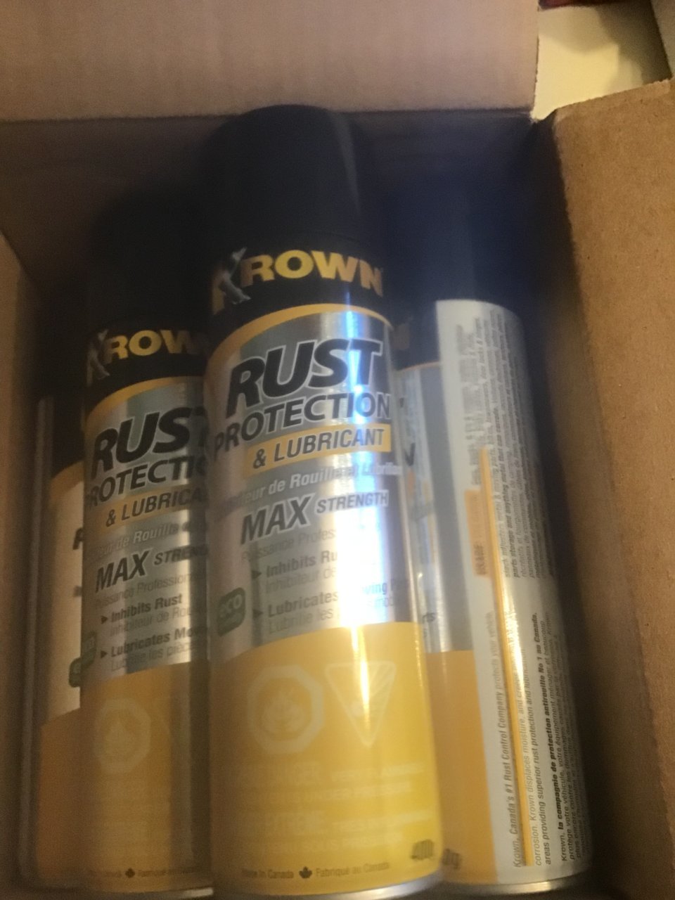

    It has arrived . Quick shipping !C24FFAF8-2A54-40B9-8809-C7A987968066.jpg C24FFAF8-2A54-40B9-8809-C7A987968066.jpg

    How much for a case??
    lynyrd3[QUOTED] likes this.
  7. Aug 24, 2018 at 3:04 PM
    #67
    lynyrd3
    Apr 9, 2008
    #5848
    35,758
    Bill
    East Central Upstate NY
    49.99 free shipping ,just ordered it Wednesday evening!

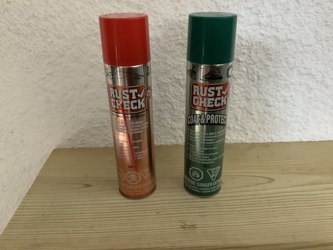

    When the truck was new I hand wire brushed the weld joints on the frame and suspension parts where the factory paint flaked off and the raw metal was beginning to corrode, then used rattle can Rustoleum. After that I sprayed the red and runny (red cap) Rust Check ‘Rust Inhibitor’ inside or on the frame, lower control arms, differentials, drivetrain supports, suspension and gas tank mounts, stamped body joints, rocker panels, engine compartment, battery tray, body mounts, hood, doors, wheel wells, taillight support structures, tailgate, etc... Every nook and cranny I could find. Once the excess fluid ran off and dried up I sprayed the waxy (green cap) Rust Check ‘Coat and Protect’ over everything. It looks new underneath. The problem with this method is it requires effort, it’s messy, and the Rust Check has to be reapplied occasionally after a good cleaning. To me it’s worth the effort.
