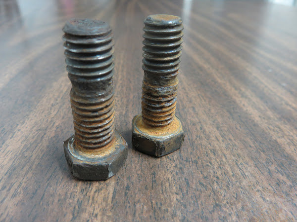

    ^That's true when the bolts are new. After a few winters, the grade 8 bolts will be weaker than stainless when they look like this:
    AJFCJaXt-sQz3WRXiG-8-wIt6_Q46R1ufM759c6N_82f3c01fc0658ec11b029a517faddb9f2a6affef.jpg
    If you find stainless bolts in A2-70 grade, that is 700 MPa or 102,000 psi, for extra margins.
