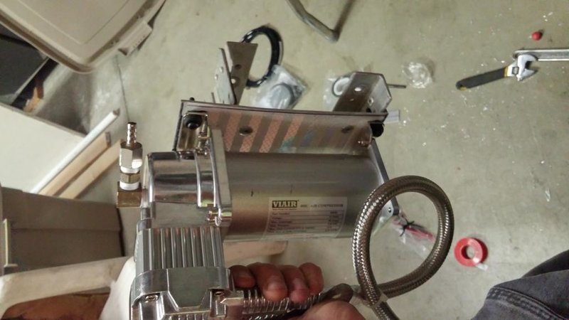

    Replaced the compressor on a much more stable bracket thanks to some scrap road sign. Great aluminum to work with if you can get your hands on some. Snagged a new air tank from a job site too so if anyone wants my old one its waiting for ya

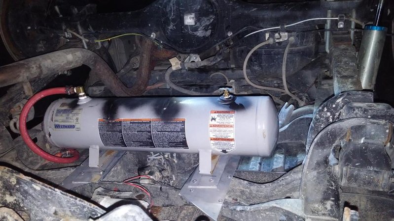

    After a long debate, I mounted my air tank and simply put it in line with a T instead of an inlet and outlet port. Anyone think it'll make any difference? In theory all the air in the system is the same fluid so direction shouldn't matter but my dad disagrees. Ideas?

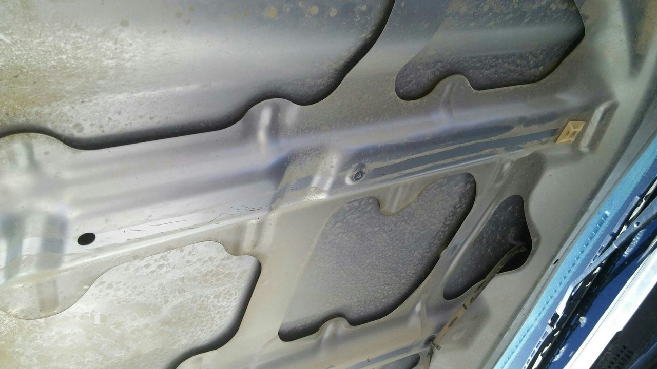

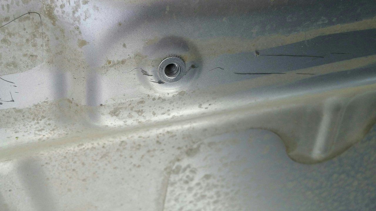

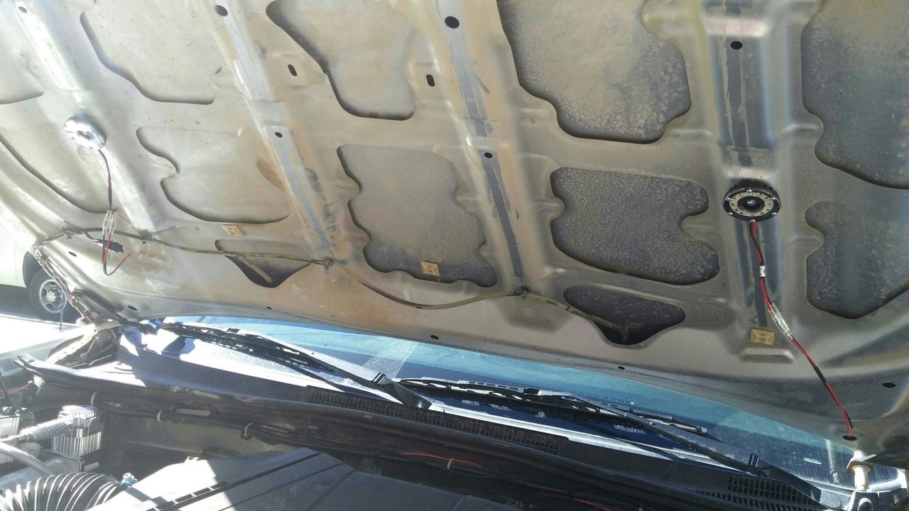

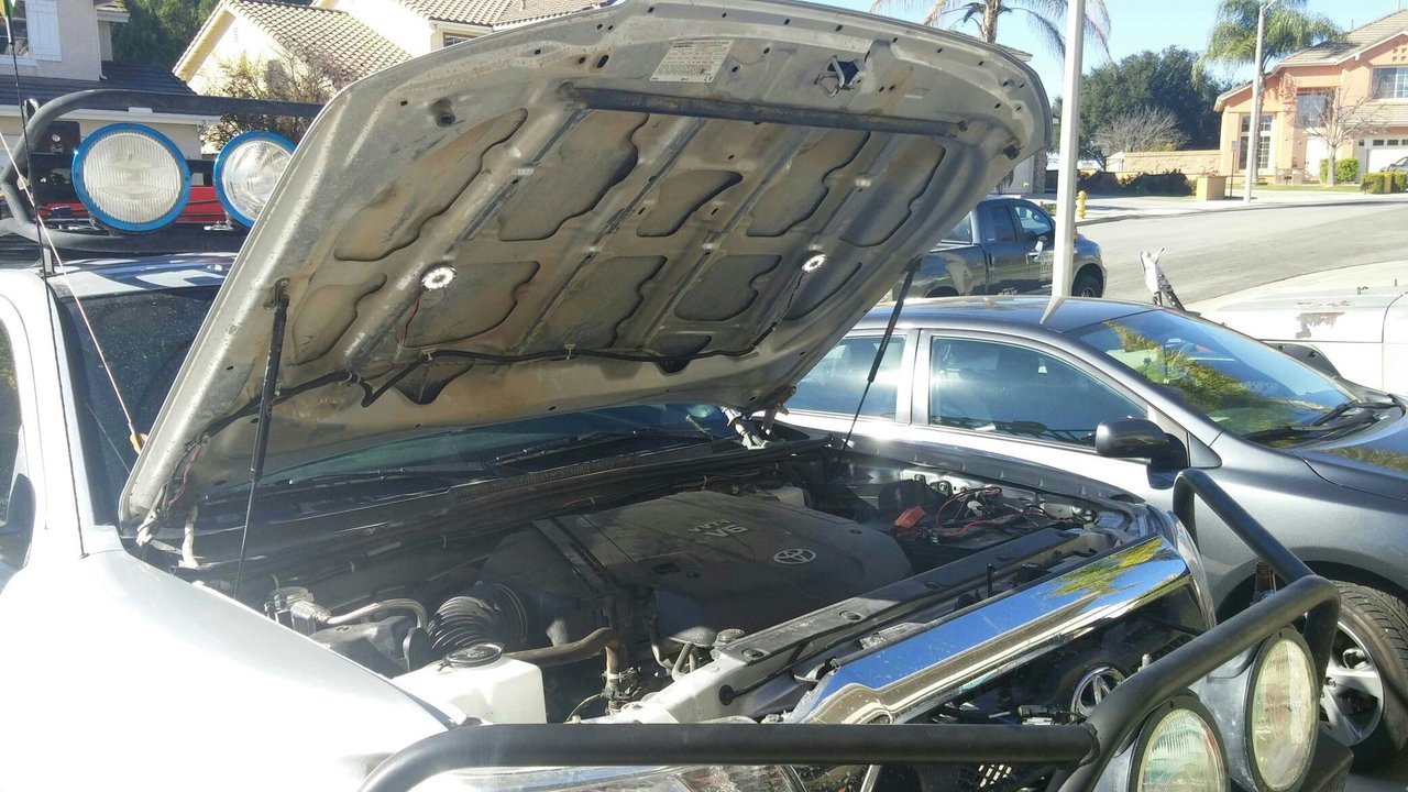

    8baf5a3e6844293e193e720c79b6ac66_1e490c033e79758fa892d78c54ee948b52b2002c.jpg071b8a9b1554654d0831d46ad1062b12_51a76af495fd17828a4bfa2e1f5388f23c07ecd1.jpga1171423d89687f8a59febde2a781b62_cf42da0005a1e34ea7e53b2126cc4d996926b781.jpg
    Easiest under hood lights in the whole world. 40 bucks in KC cyclones, a rivet nut and you're good to go. Thank you Toyota for these nifty little mounting holes already in the hood

    Finally a clean install I hated my last under hood lights since I put em in. These are clean and soldered in and mounted sturdy and bright!! Day shots do not do em justice

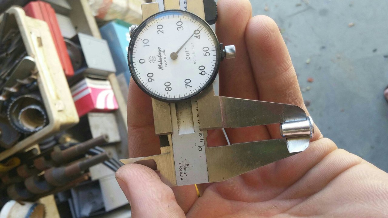

    Redline hood lift, Flyzeye cabin lights, tailgate lock, SPOD Power block, VIAR onboard air, Cobra CB radio, Firestick 4' Antenna, Hot Blonde CoPilot Mod, SIX 9" Hella 4000 HID conversion with external 55W ballasts, Six 6" LED bars, Napier Bed Tent, Mudflaps delete using rocks, Roof rack by Brute force, Rock sliders by Brute force, Bed LED lights, Underhood LED automatic lights, Constant 12V bed plug, Rugged race radio, ICON uniball UCA's, KING 2.5 700 rate coilovers, Deaver rear leaf springs, KING 2.5 resi rear shocks (Flat 0.15 stack on compression shims), Scangauge, Empty wallet Mod Bug disease, AllPro Apex front bumper, On board heat exchange shower & water pump (Heater Core intercept mod), On Board Air - Viair for now, ARB when it dies-, allpro Skids back to gas tank- Tepui RTT on the shittiest "Bed Rack" ever made.... AllPro U Bolt flip kit with timbren bumps NEXT UP- expo leafs & bed rack, hydraulic bumps in rear, Total Chaos stock LCA's w/ Bypass, Rear 12" shock hoop relocate
    Just some harbor freight thing.
    I used the smaller holes already in the hood
    I think they take 6/32 thread machine screws.
    Given a choice I would have used the bigger holes with a bigger rivet nut though. Either way, they're solid.

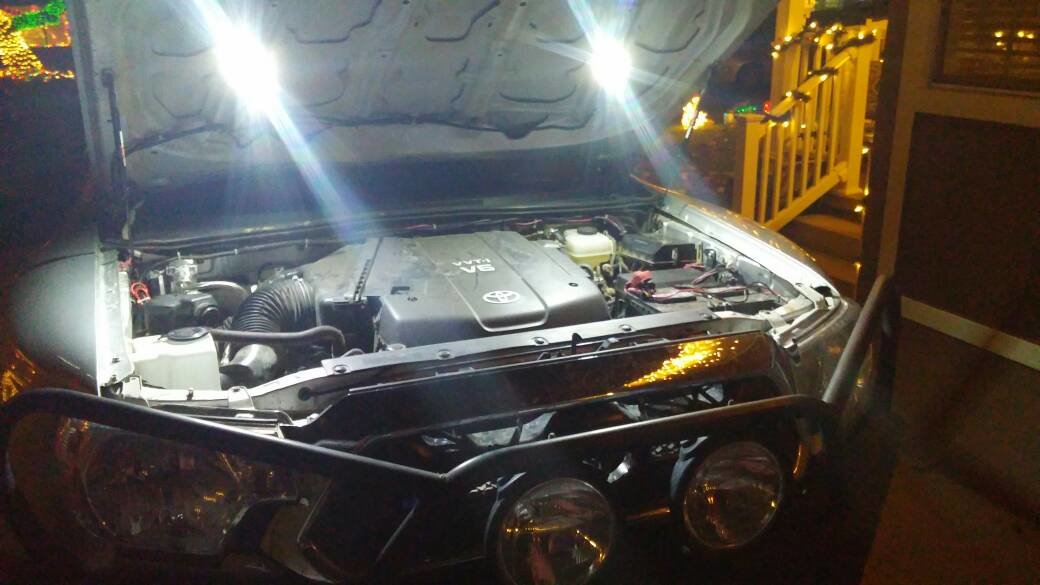

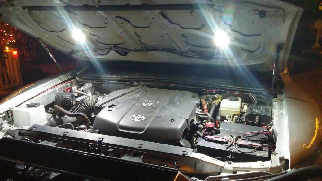

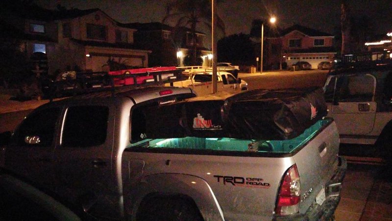

    As promised, here's a night shot
    Absolutely fucking impressed. KC for the win here!
    hinmo24t likes this.

    Lots of light. Next step is to ditch the Spod and sell it. :spy: :duel:
