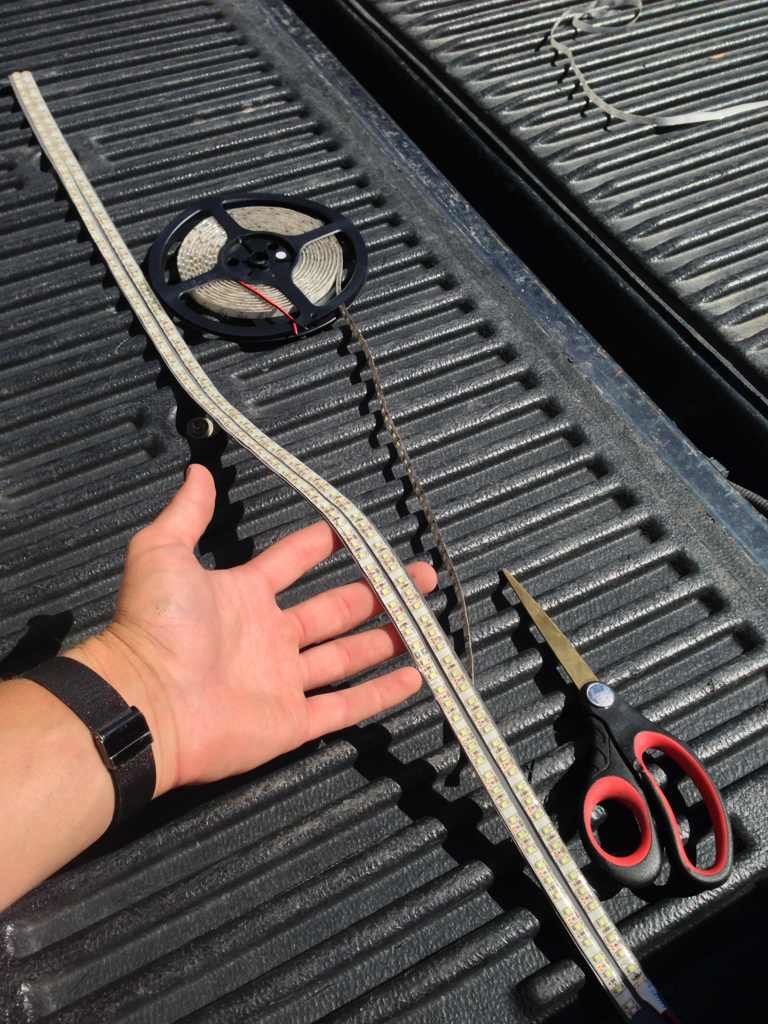

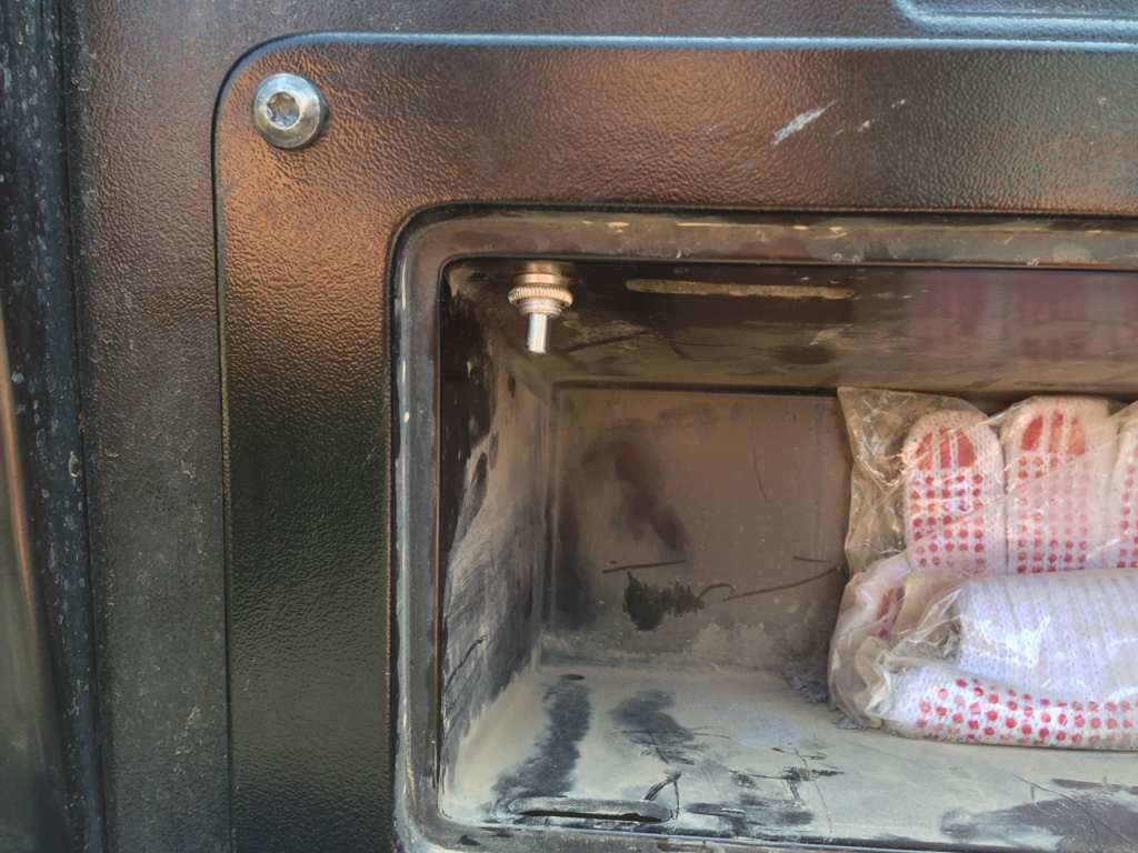

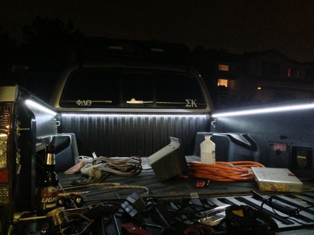

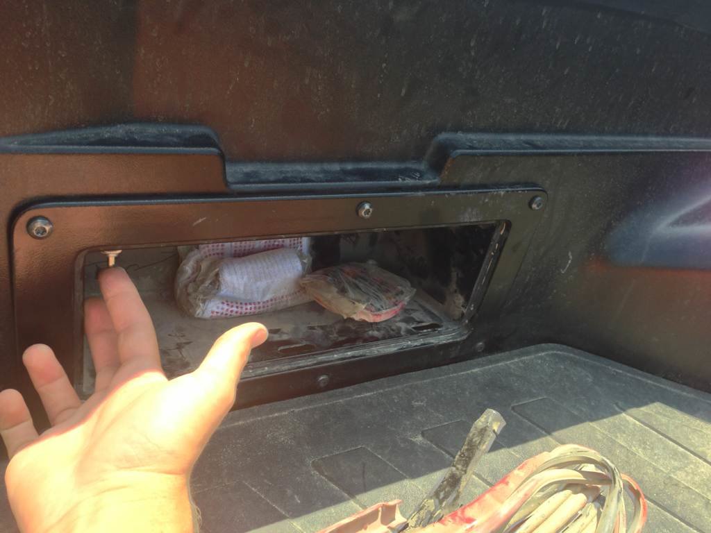

    Hidden constant 12v plug & bed led's

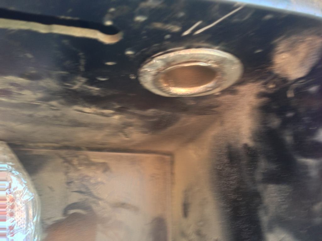

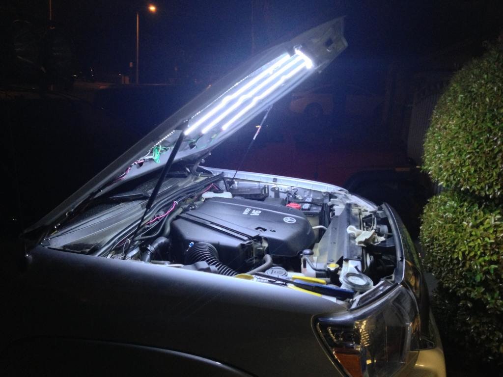

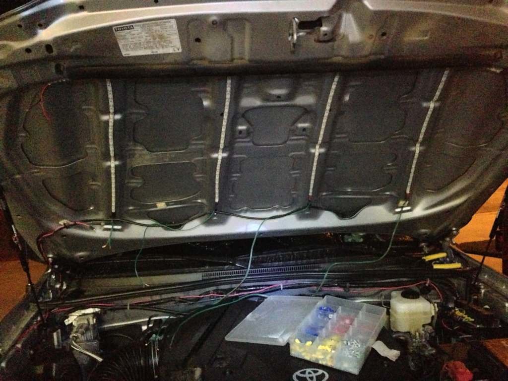

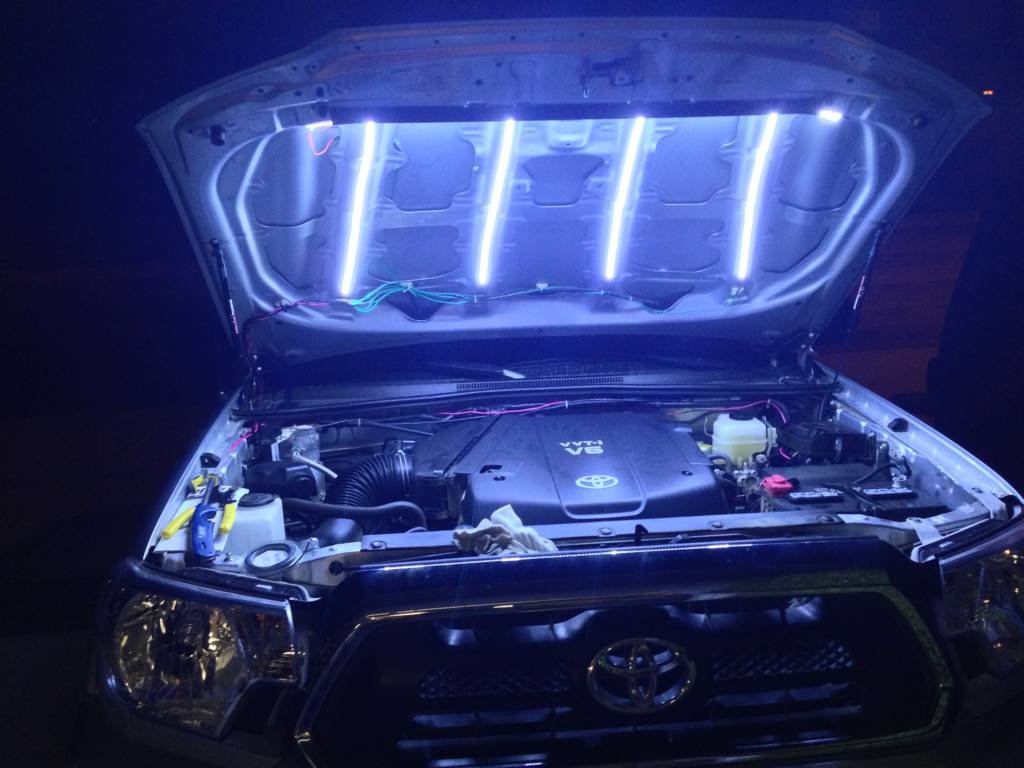

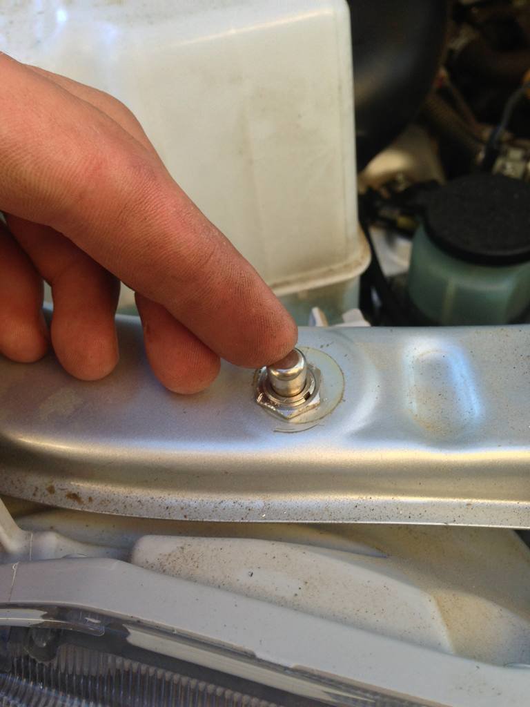

    And tonight's mod:
    Under hood lights with pressure switch
    Put this right in the shiny dot sticker & it lines up perfectly with the rubber bumper above, making it extremely easy to adjust later.

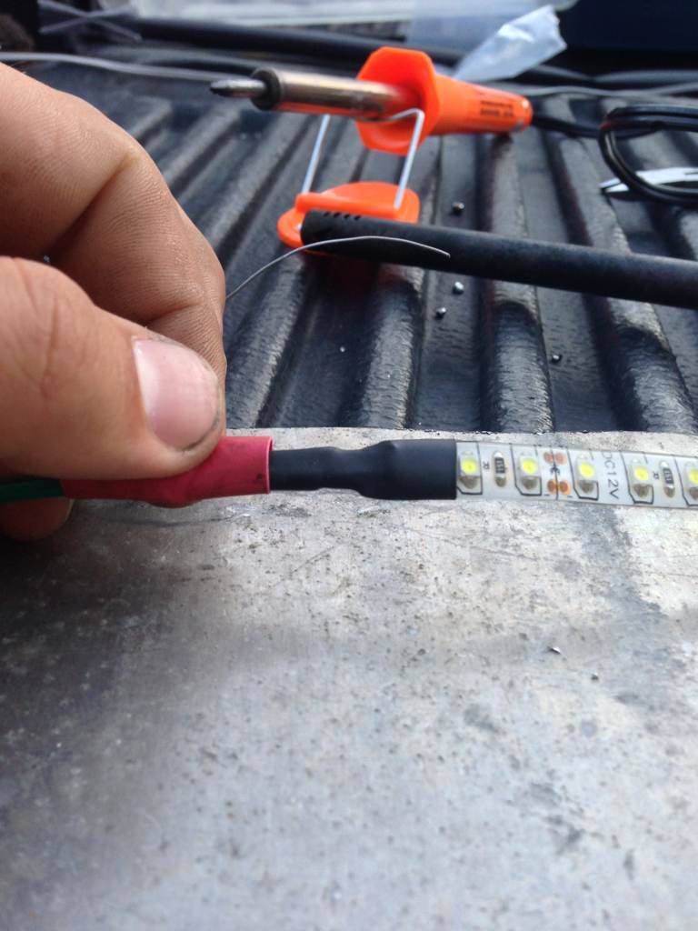

    These bastards are nearly impossible to solder.
    So, grab an old dc converter plug from that printer/ fax machine/ phone charger etc you have Lying around, cut the ends off and wrap them around the wire you're trying to solder, so that when you do make good contact, the strip turns on (and off as soon as you break the contact and have to re solder it eleven times)!
    Also,
    Put two or three layers of shrink wrap to make the solder point stiffer. One layer makes it too easy to break the delicate solder points.
    Use the heavy duty 3M mounting tape- the adhesive that comes on them won't last under the hood.
    Also, find a better layout than I did here. The wiring is far below my usual standards
    But oh damn.
    I worry what I'll do with my time if I keep up this pace and run out of mods...
