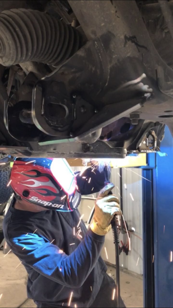

  6. Jun 23, 2020 at 11:30 PM
    #86
    m00seNUckLEz
    m00seNUckLEz [OP] tAc0 aFiCi0nAd0
    Dec 20, 2015
    #172698
    821
    Fresno, CA
    Under Construction

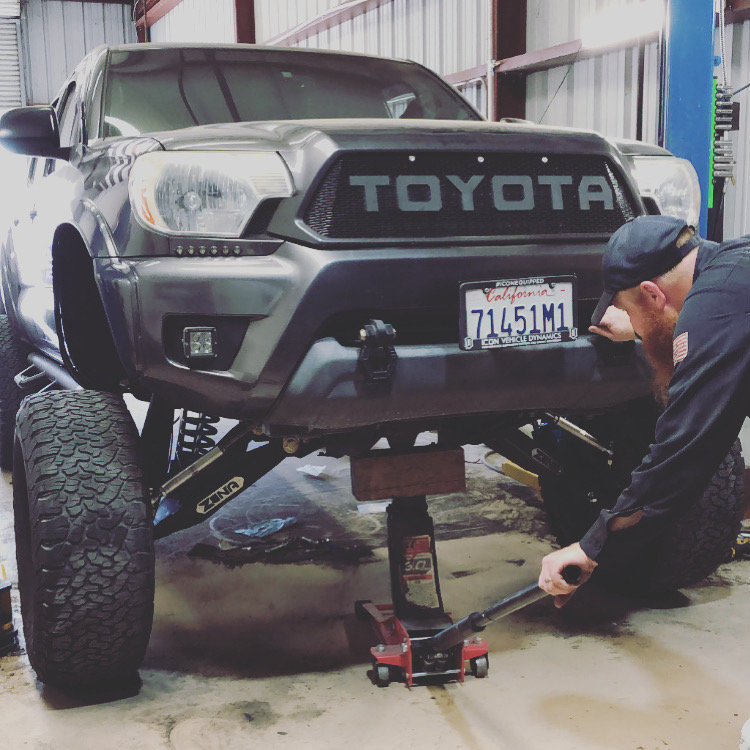

  7. Jun 24, 2020 at 4:17 PM
    #87
    m00seNUckLEz
    Dec 20, 2015
    #172698
    821
    Fresno, CA
    Under Construction

    Turn the block pointed up :p :fistbump:
    looks nice!

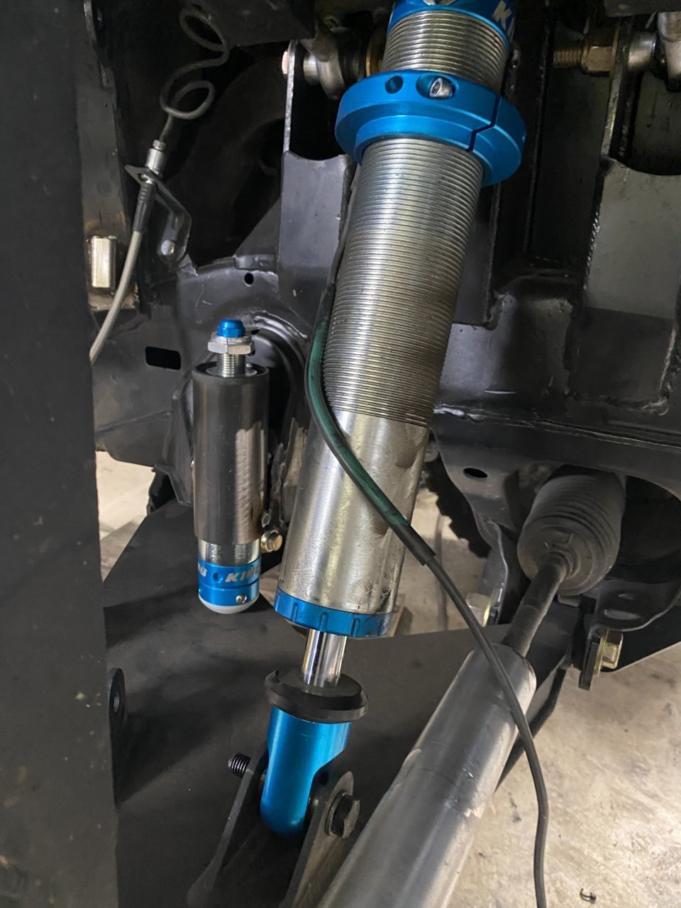

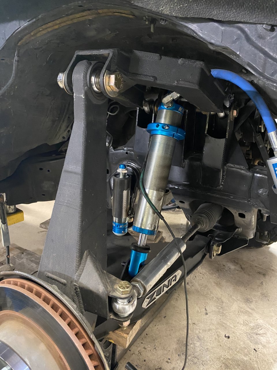

    Getting the bump stops set. 1.5" of shaft will be showing on the coilovers/bypasses at full bump.

    looks like you are giving up some uptravel, any reason why you set the bumps up to bottom out so early?

    That may be angle of the pic. The bump is fully compressed but might not be touching the control arm.

    There's shock shaft showing meaning there's more up travel available - I assume they're limiting it to keep the spindle away from inner fender - even then there's some space. Might change it when the truck gets fully caged etc.
