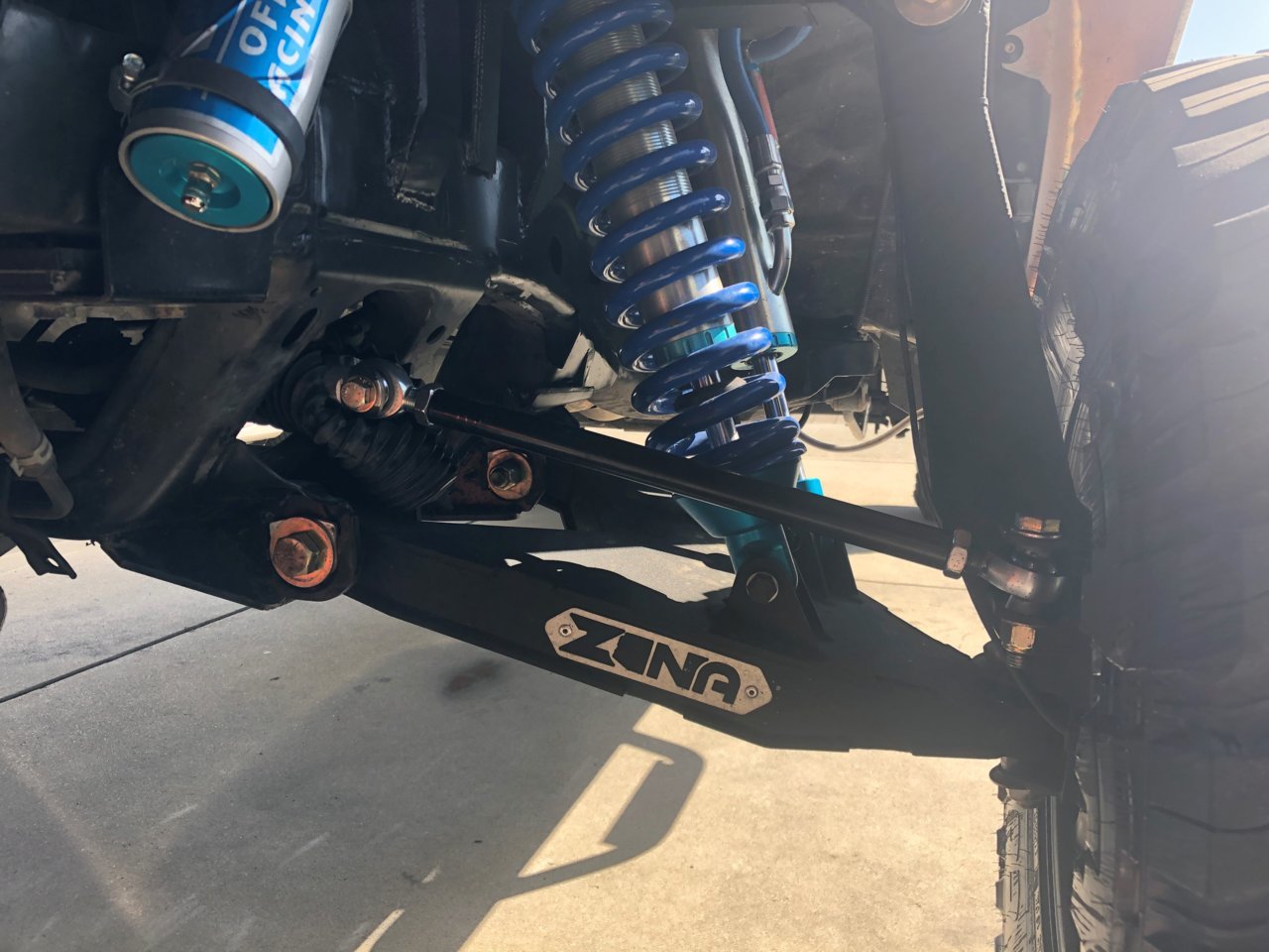

    It's kind of hard to see, but my UCAs at full bump are pretty close to the fender well. I know it doesn't look like it in the picture. I have a trip to Oceano dunes in October. I want to see how it does at this current setup. I may very well adjust them upwards later.

    All of the long travel kits i know of will punch through the fender when properly bumped, so your's would be no exception. Because up travel is so precious and key to making trucks go fast I would encourage you to take full advantage of all the available up travel you can while you have it apart. With it all apart it is way less work than tearing it back down later..... Now I'm going to contradict myself and say, if you are extremely close to having it in the dirt and are itching to get done, then run it and have fun till you want to upgrade/change later.

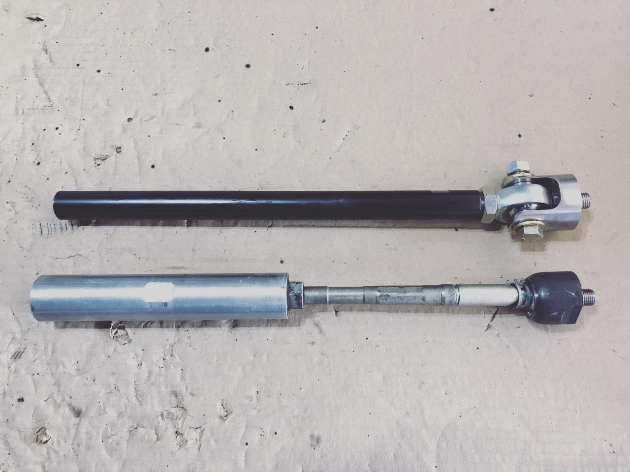

    Removed my factory inner tie rod and aluminum spacer and replaced it with a Camburg Steering Heim Clevis Kit and a solid piece 4130 chromoly tie rod from Kartek.
