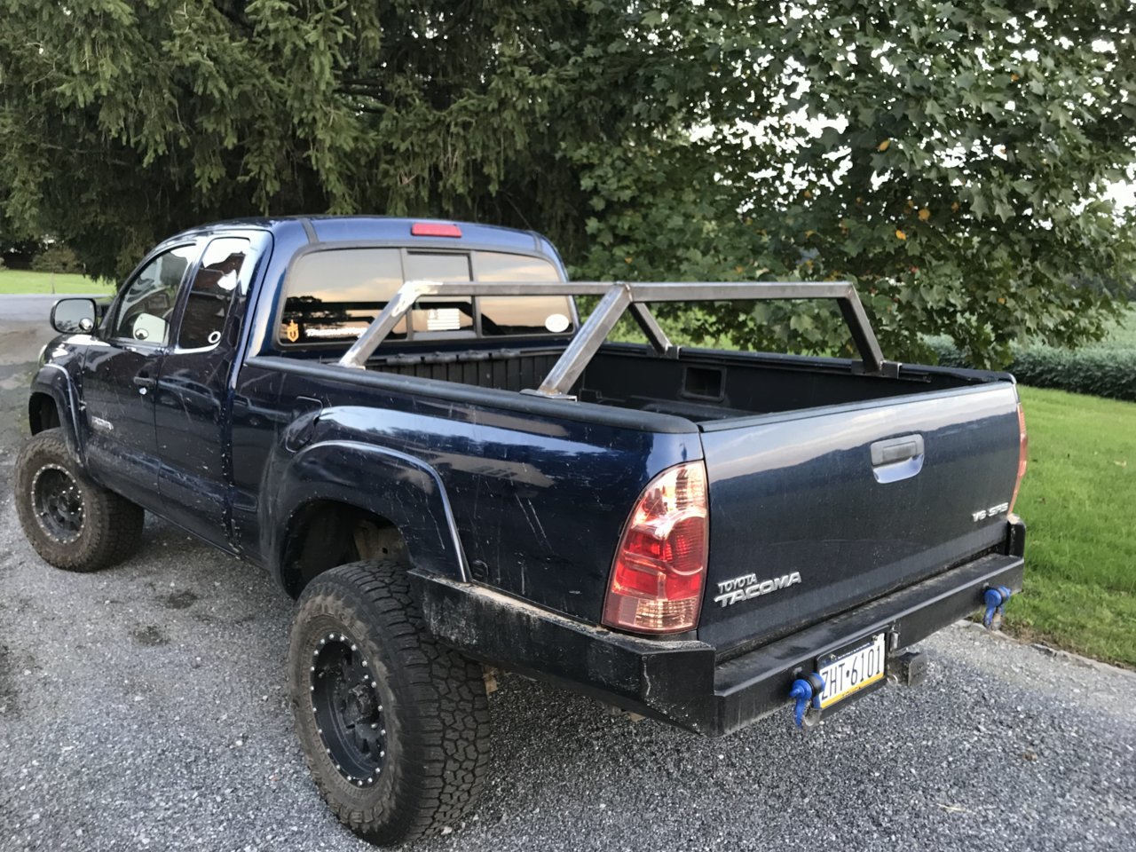

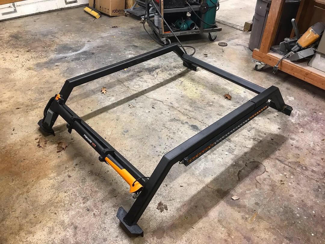

    Just built a bed rack for my ‘06 access cab. I am hopping to get an RTT at some point and I wanted a rack. It’s made with 2x2 square tube 3/16” wall..... (yes I know 3/16 is way over kill, but I didn’t realized that until after I started building it haha) It’s 3’ long and a 10” rise. I couldn’t find a company that makes a rack that had everything I wanted, and the size I wanted too. I made the length 3’ long so if i ever get a short bed Tacoma, I can put the rack on a short bed. After the winter I’m going to build a set of sliders and when I do, I’ll sand blast the rack with the sliders and cover them in rustolium bed liner, until then it’s jusy painted flat black. I Hope this encourages others to build they’re own stuff, I find it very rewarding :thumbsup:

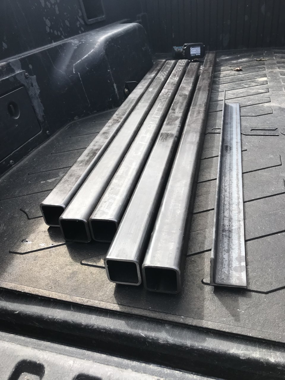

    Where did you buy your steel? I'm finding that most local places near me are $10 /ft for 4x2" tube. Seams expensive

    I paid $4.96 for the 2x2. Ended up being $103.17 for all the tube. I get my steal at a Local machine shop called White horse Machine, when I bought the steel for this project it seemed a little pricey. To put it into perspective, the price of the steal for my high clearance bumper (pre steel Teriffs) was nearly the same price for the steel to make the bed rack after the terrifs.

    Looks real good, the added thickness of your steel will not flex as much and will not be as prone to pushing out against you bed side walls as bad. :thumbsup:

    Don't usually say this to a guy, but nice rack ...
    I have a question or two ... and not intending to be critical ... why not make the rack supports more vertical to prevent adding stiffeners? Is it mostly looks? At 10-inch height, are you able to see traffic below the rack if you have stuff on top? I'm shopping for a rack, not for RTT, to carry my spare tires up there and keep the bed mostly clear for my dogs and make more room for travel gear when off-roading. I like the RCI and Voodoo Taco Max rack but can't justify forking out $700+; and shipping to that ... may end up setting for the Tuff Stuff sold through Amazon for $450.

    Thanks for the feedback. I lost some visibility with the 10 inch rise, but it’s not bad. I lost another 1.5” of visibility too with the light bar. I wanted it lower to the bed to keep the top of the tent level with the cab to reduce wind resistance. And as for the angle, I’m really not a fan of the really vertical racks that’s some companies make. I like the look of the lower profile and it’s easier to access tools imo if there is an angle. I’m sure there will be some changes I’ll make on it after I use it for a while so we’ll see.

    hey man, would you mind sharing the angle measurements? I'm looking for something similar and your work is extra clean, congratulations! ***
