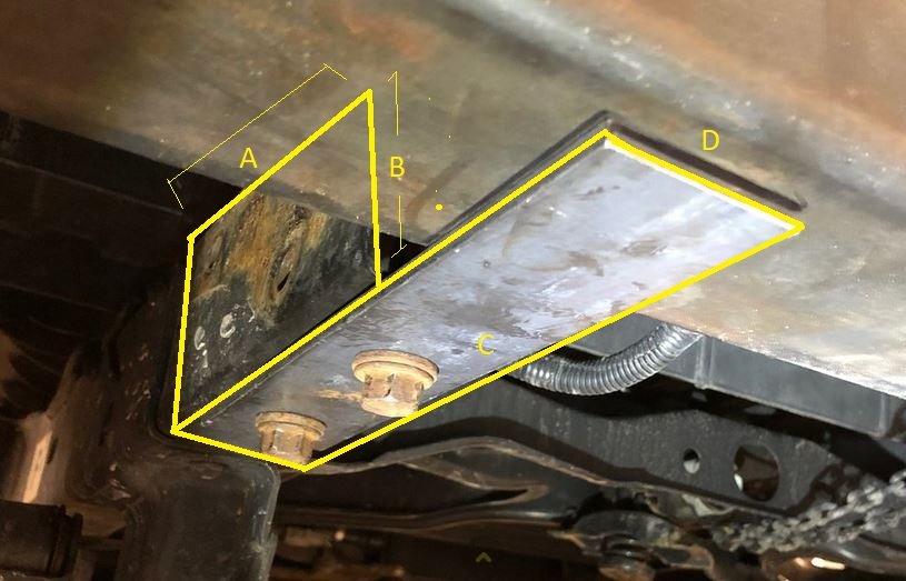

    I just need to know A,B,C and D and I can design my angle iron mounting arms. Then I will weld the 4x4 to it. I cannot wait to cut my bedsides...o_O2.jpg

    Do you see the pic with the dimensions I need OP?

    Yes. I'm currently not with the truck rn but when I get home this evening Ill make sure you get them

    Heres some numbers for ya:
    A- 8.75"
    B- 3.75"
    C- 11.0"
    D- 2.00"

    That's awesome! Now to plan the angled steel brackets. :beavisd:
