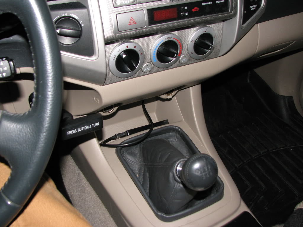

    I have the Soundgate adapter in my truck. Works great and it does charge it while you have it hooked up.
    I just notched my center console by the little pocket up front (manual transmission), you can't even see it when it's all together.
    I'll get you a pic here in a minute....

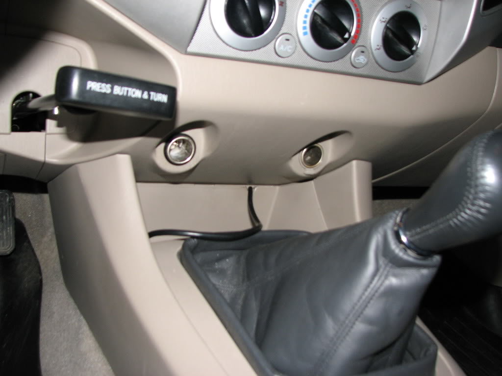

    View from the drivers seat....
    And if you get down and look you can see where I notched it for the cable...
    (sorry the flash makes it a little hard to see)
    hope this helps!
