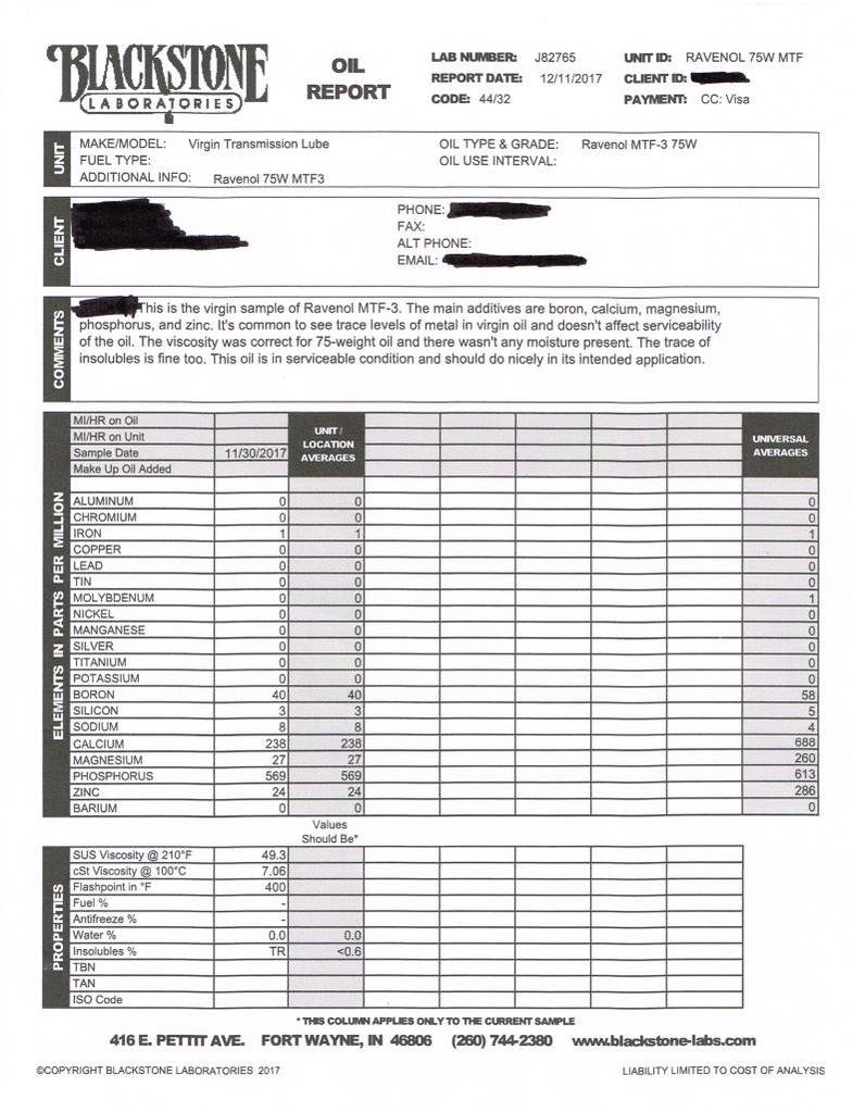

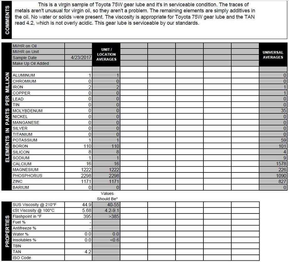

    This has been posted before on several other forums.
    There are additive (or naturally occurring?) differences between the Ravenol and Toyota 75W. Check out the magnesium, phosphorus, boron and zinc totals in particular.

    FWIW, I'll spend the extra $45 every few years and buy the OEM.
