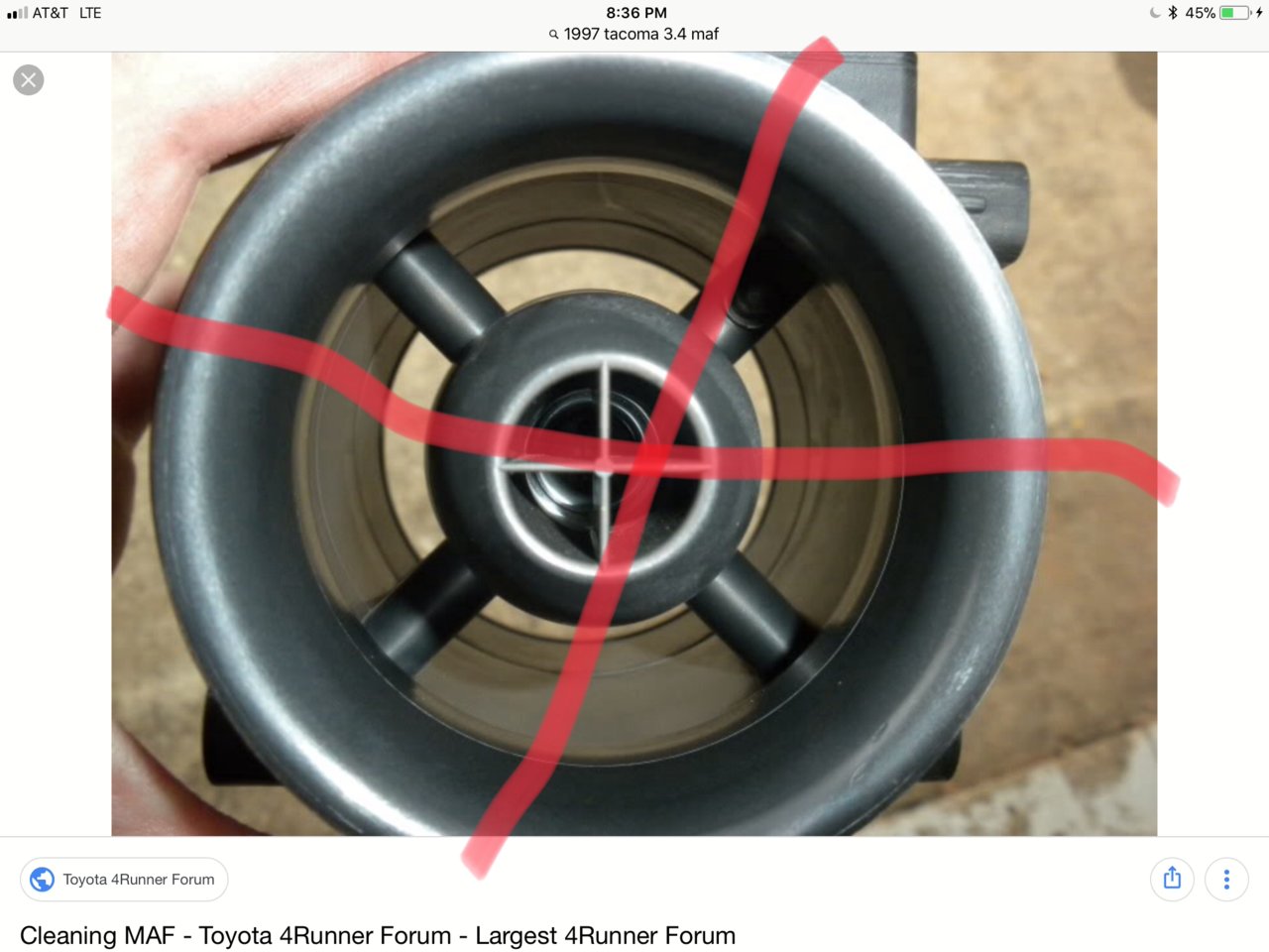

    The 1996-1999 use a MAF tube with a MAF sensor that is part of tube and can not be removed.
    The MAF tube section was changed in late 1998 so there are some 1999 tacomas with the MAF tube but most 1999 have the new style replaceable MAF sensor.
    MOST 1999 models have the newer removable MAF, but there were some made with the bullet type MAF.

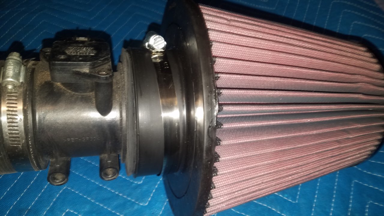

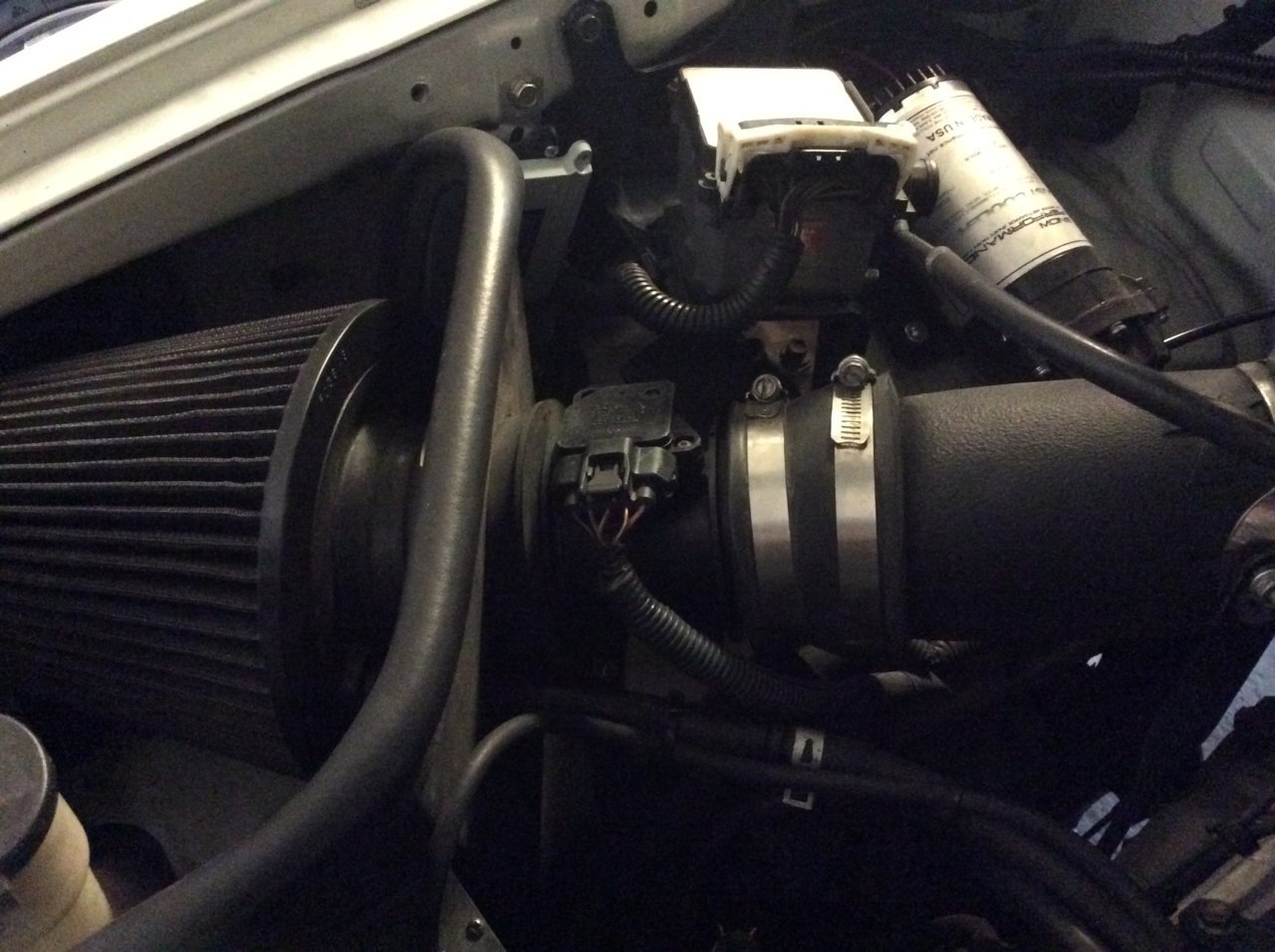

    So for my setup I have a KN cold air intake and it will be a bit different than the stock setup.

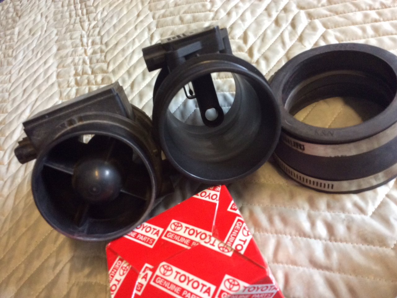

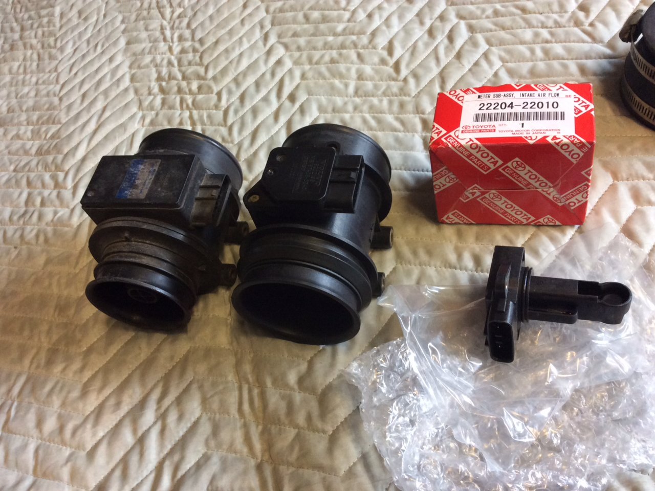

    I ordered a 2001 Volvo S60 MAF tube section off eBay for 30.00 shipped and bought
    a new DESNO MAF sensor for a 2001 v6 for 20.00 OEM off eBay.
    I received both items today and was excited to inspect the items.

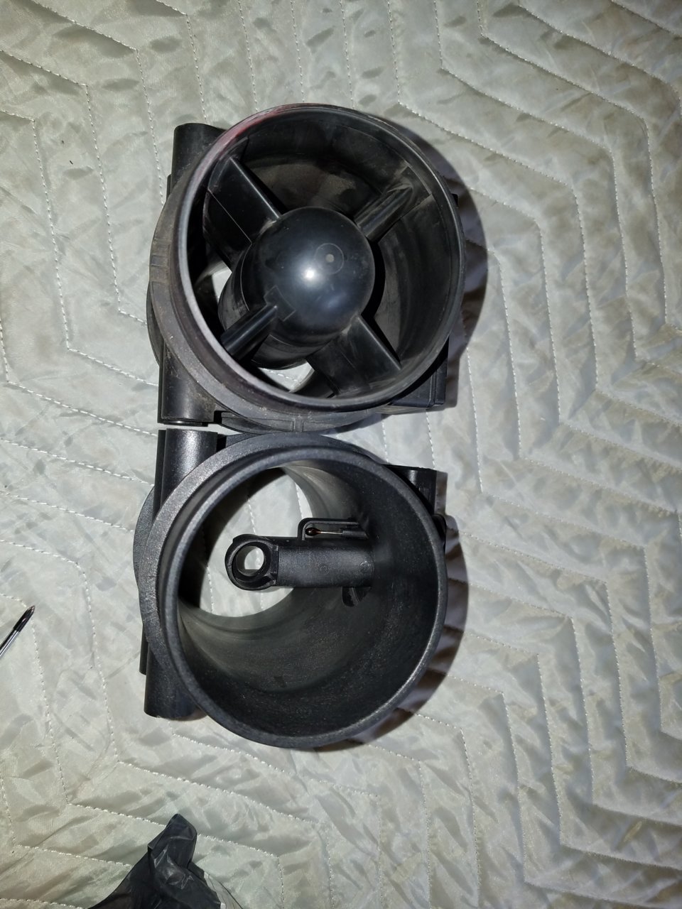

    After inspecting the new Volvo MAF and the original 1997 MAF this is what I found.
    The Volvo MAF is almost identical. Same length, same width same everything.
    EXCEPT one end, the air filter end is a little larger across then the original and of course now you have two screws and you can replace the DESNO sensor is a few minutes.

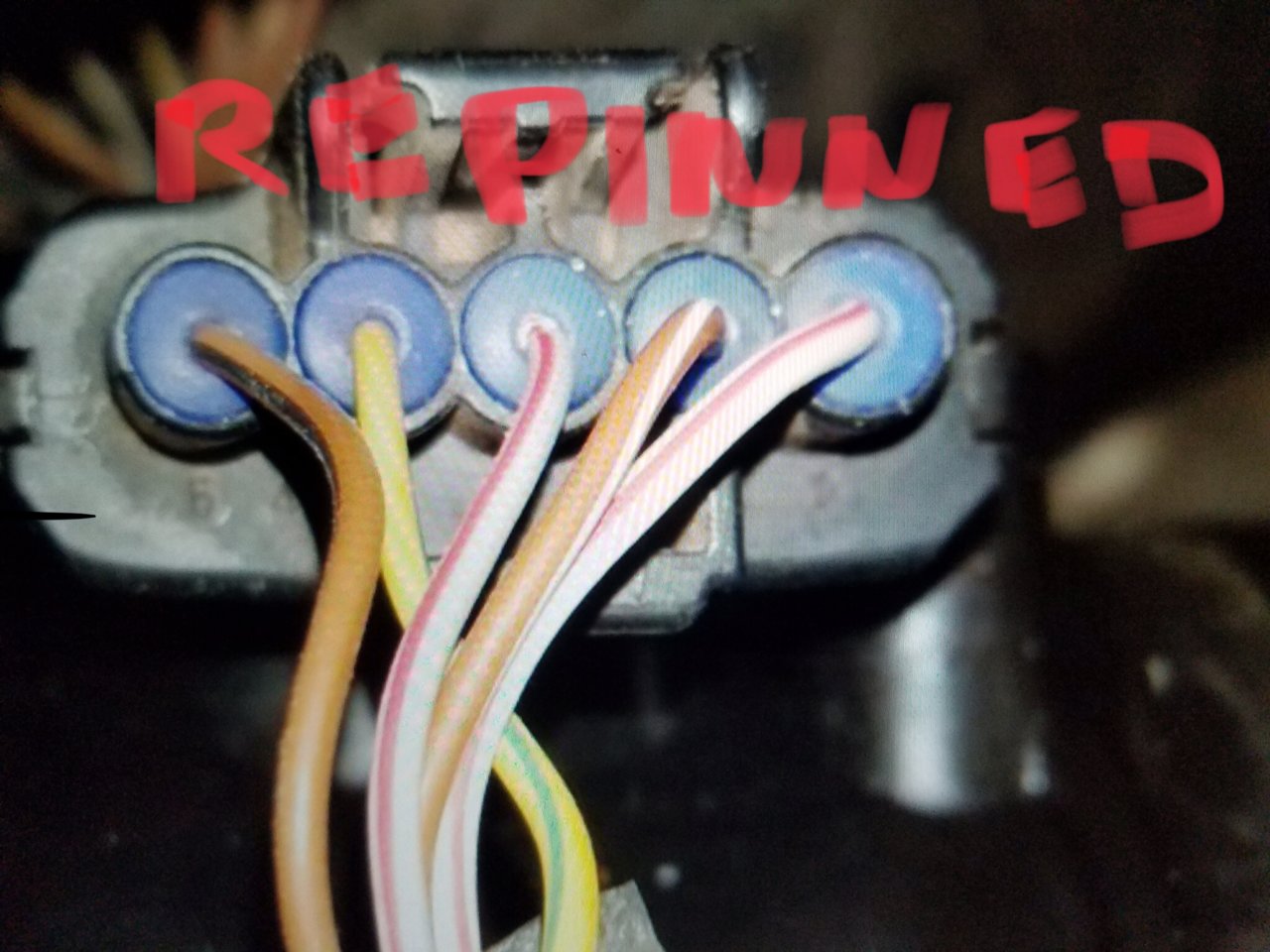

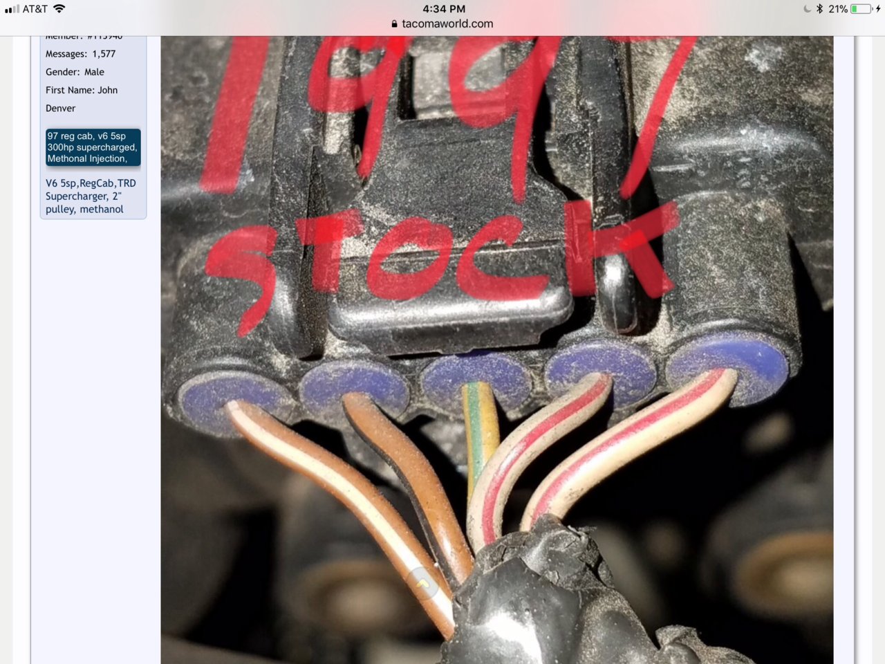

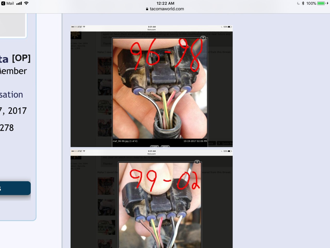

    YOU have to repin the original 1997 wires to the 2001 configuration for the new DESNO sensor. From what I have found
    there are at least two different color combinations that came from the factory between 1996-1999. I have posted both color combinations and the 2001 correct pin for both of these.

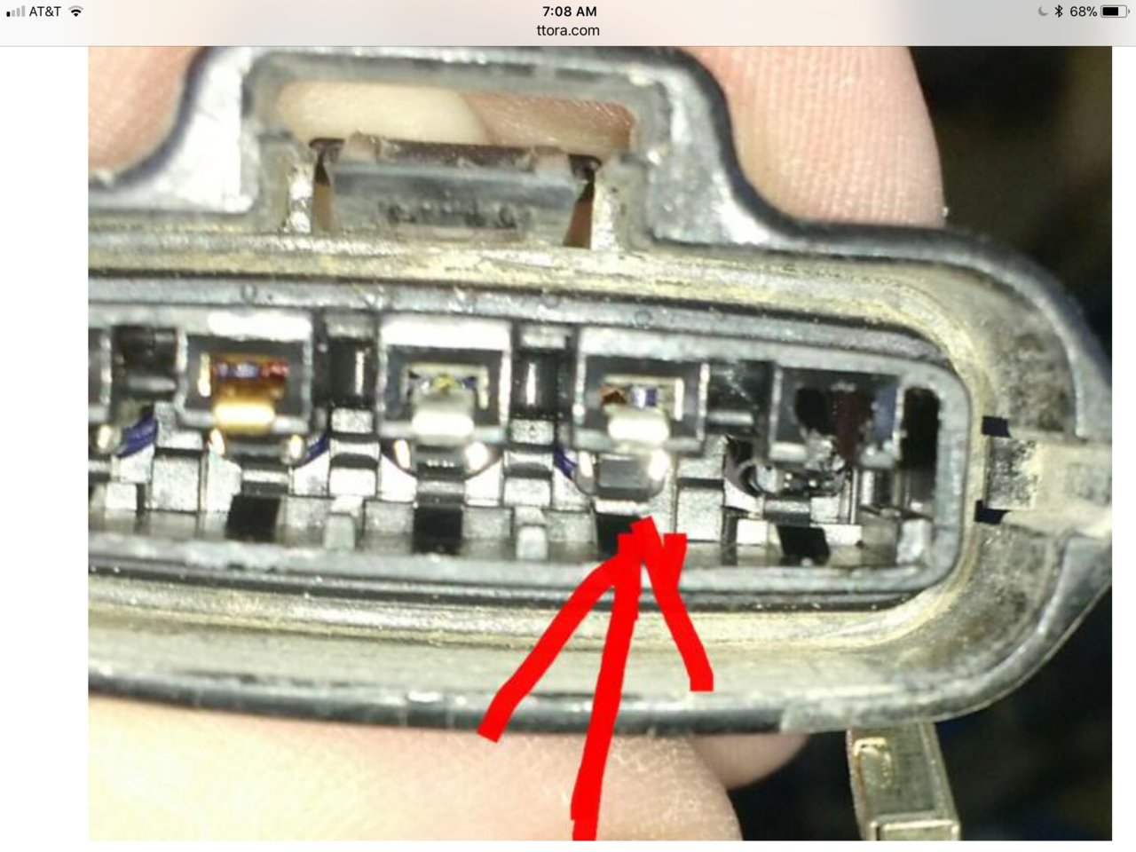

    So the hiccups I had with this setup was trying to figure where the tab was to press down to release the pin wires.
    There is a tiny tiny single plastic tab directly under each of the tiny 5 metal clips inside the connector. You get an eye glass screw driver or a little larger one and push each pin down and then just pull the
    wire out from the back.
    There is a white plastic clip that you pry off starting on one side.
    When you repin the wires each wire has to go in the exact same way it came out. The tiny prongs point down when you reinstall the wires. When you push the wires back in there you will hear a click sound and it locks in. If these are not put in correctly the white plastic clip from the front will not fit back in after all the wires are repined.

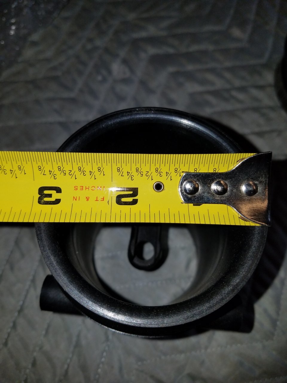

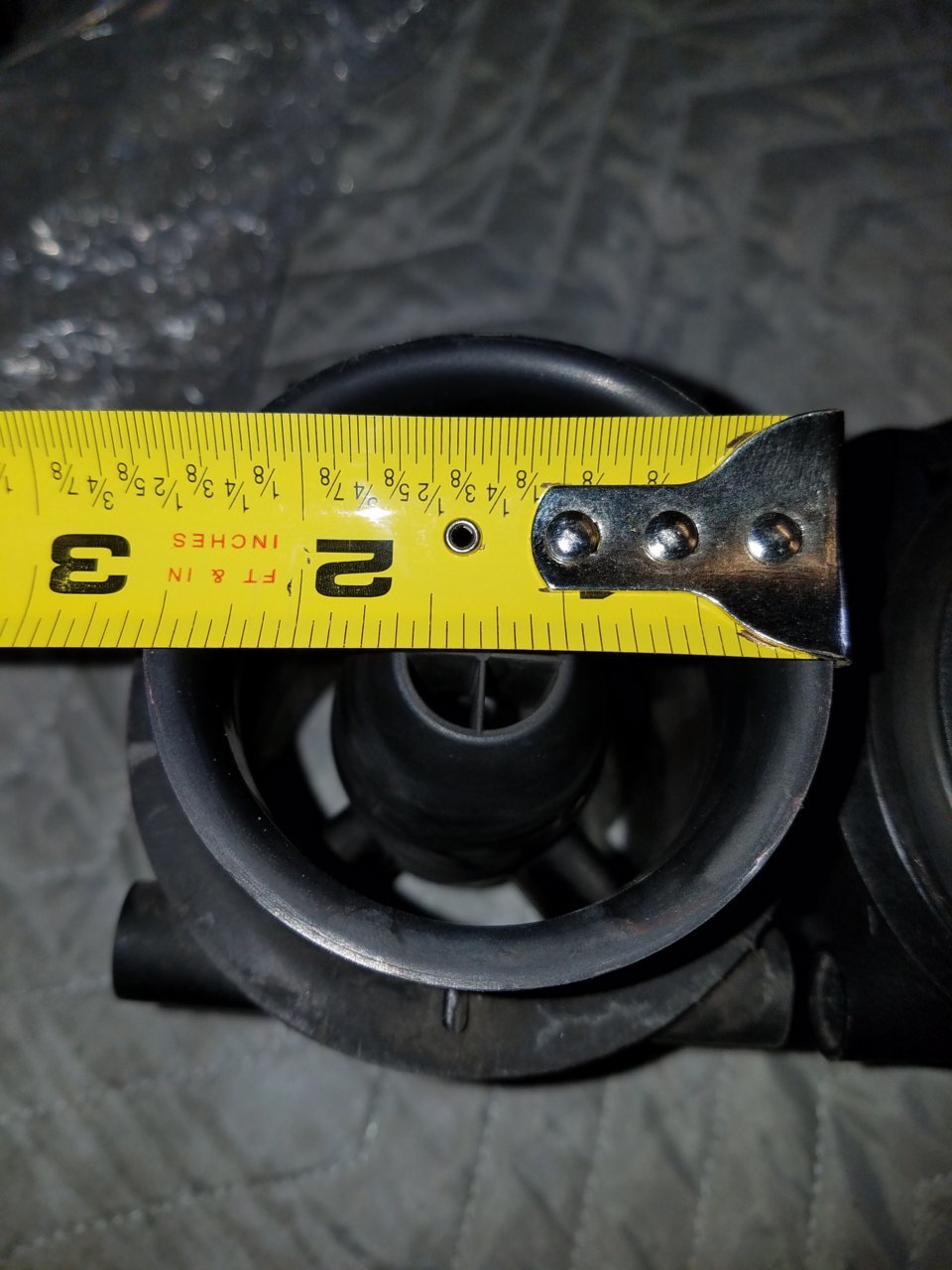

    Both the Volvo and the Tacoma intake ends are both the same 3”.
    The air cleaner side the Tacoma is 2.50 and the Volvo is 3” across.
    The center section is about 3” on both MAF units.
    If you go with this swap just make sure the air filter side will fit as it’s 3” now and not 2.5” or that it can be adapted.

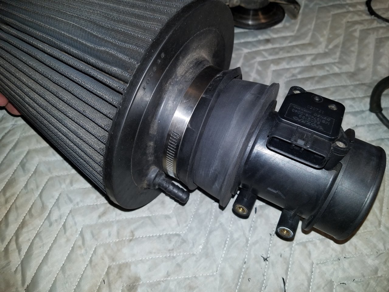

    I needed to get a different rubber boot that was an inch longer that connected
    the MAF tube section to the intake long plastic tube.

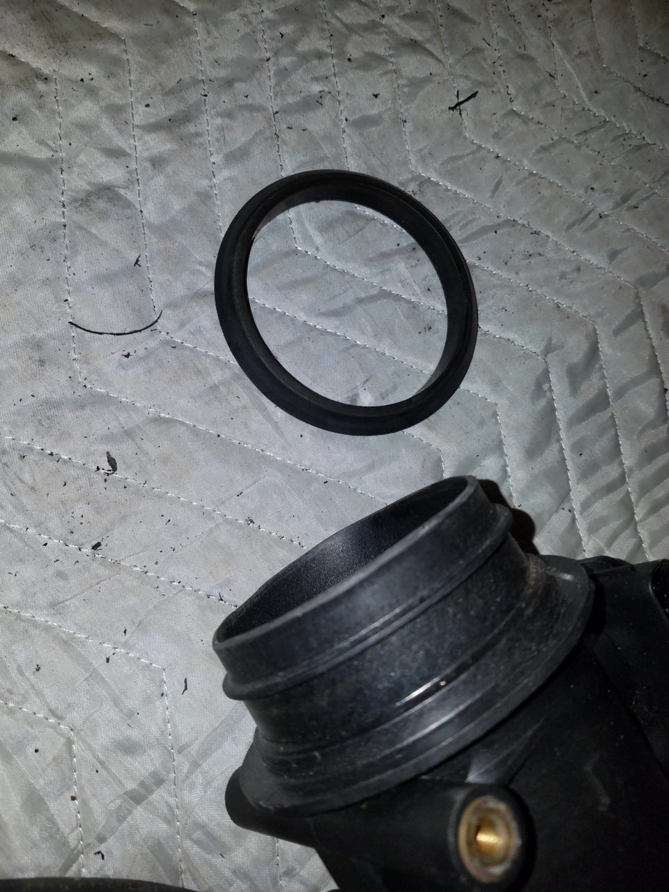

    Because the Volvo tube section is a bit large .5” on the air filter side, I had to cut the lip off, the end that went into the air cleaner so the donut spacer would fit on. The KN DONUT SPACER is to small to fit on the original Volvo end that goes to the air filter.
    I got the donut spacer to fit after cutting the end lip off of the MAF. It does seal but I will have to figure how to shave the rubber donut down 1/4” all the way around to get a better fit in the KN housing.
    I found a very coarse sandpaper type grinder wheel that did the trick for my portable grinder.
    So I did a test run.
    Started right up, no issues
    I did not discount the battery when I did this job, I don’t think I need to reset the computer but maybe you should.
    Took it for a test drive for 20 miles.
    The good:
    I’m running a supercharger so with the dam bullet gone I have an additional 1/2 pound of boost. Typically my boost is 9-10 pounds, now it’s steady at 10 pounds all the time
    Seems to respond better
    Seems a bit more Pep
    Can replace the MAF in 2 minutes if needed with a DESNO MAF If needed for 20.00
    No lean issues yet
    I used a 40 grit sandpaper disk on my grinder to shave down the outside rubber donut.
    If you have a supercharger definitely have to do this swap.

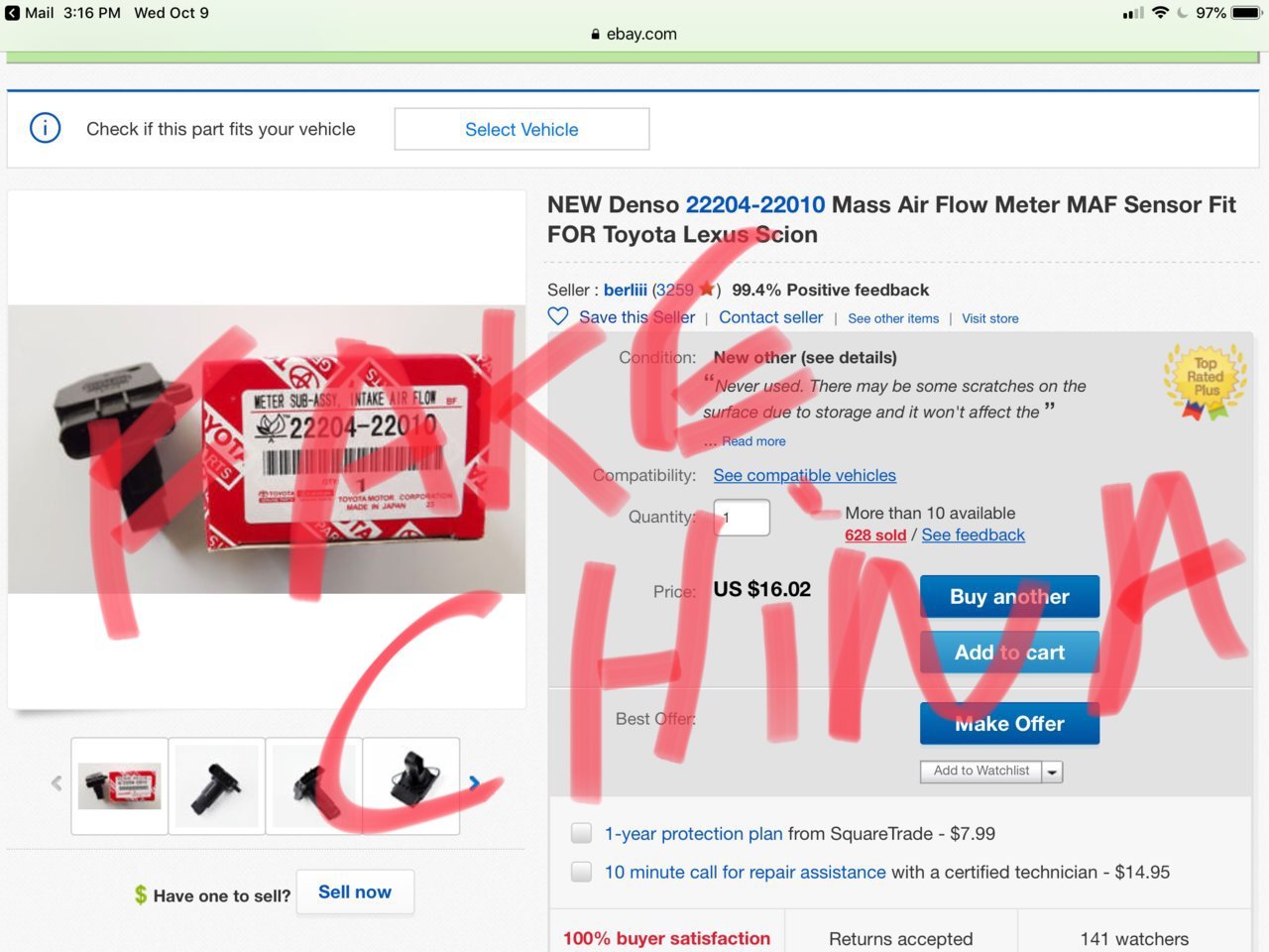

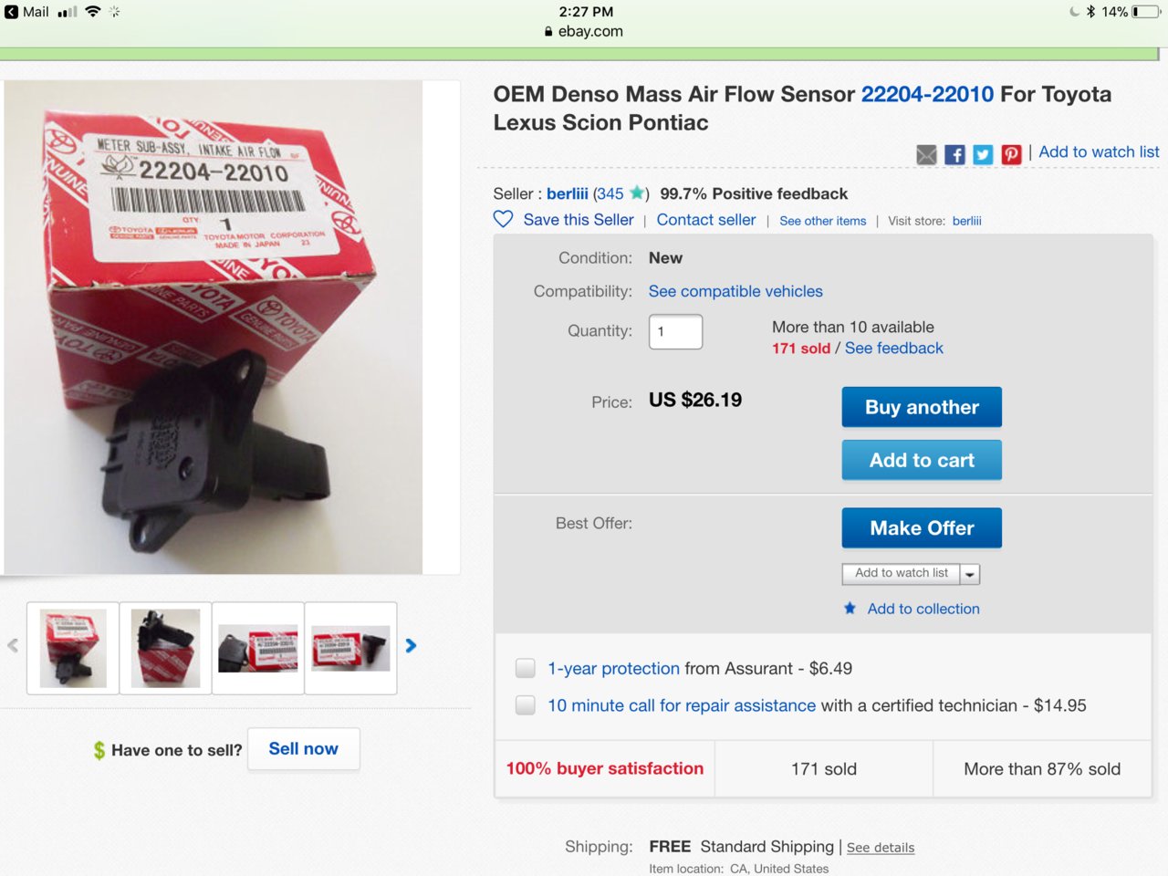

    PLEASE NOTE IF YOU PUT IN A FAKE MAF THAT IS NOT AN ORIGINAL OEM ITEM MAF SENSOR
    YOUR FUEL TRIMS WILL BE MESSED UP AND GOOD CHANCE THE TRUCK WILL RUN TERRIBLE.
    THE INTERNET IS FULL OF FAKE DENSO MAF SENSORS.

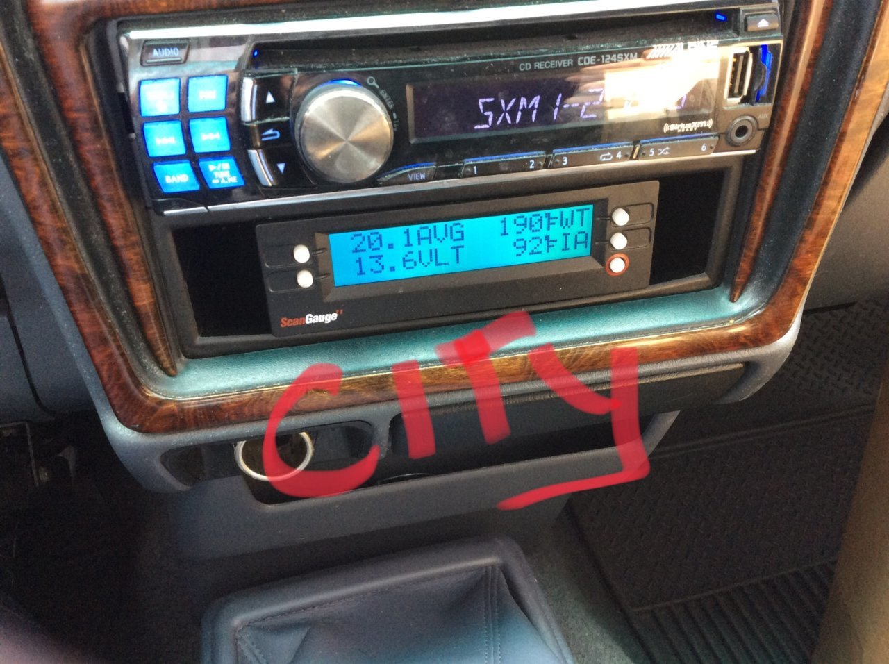

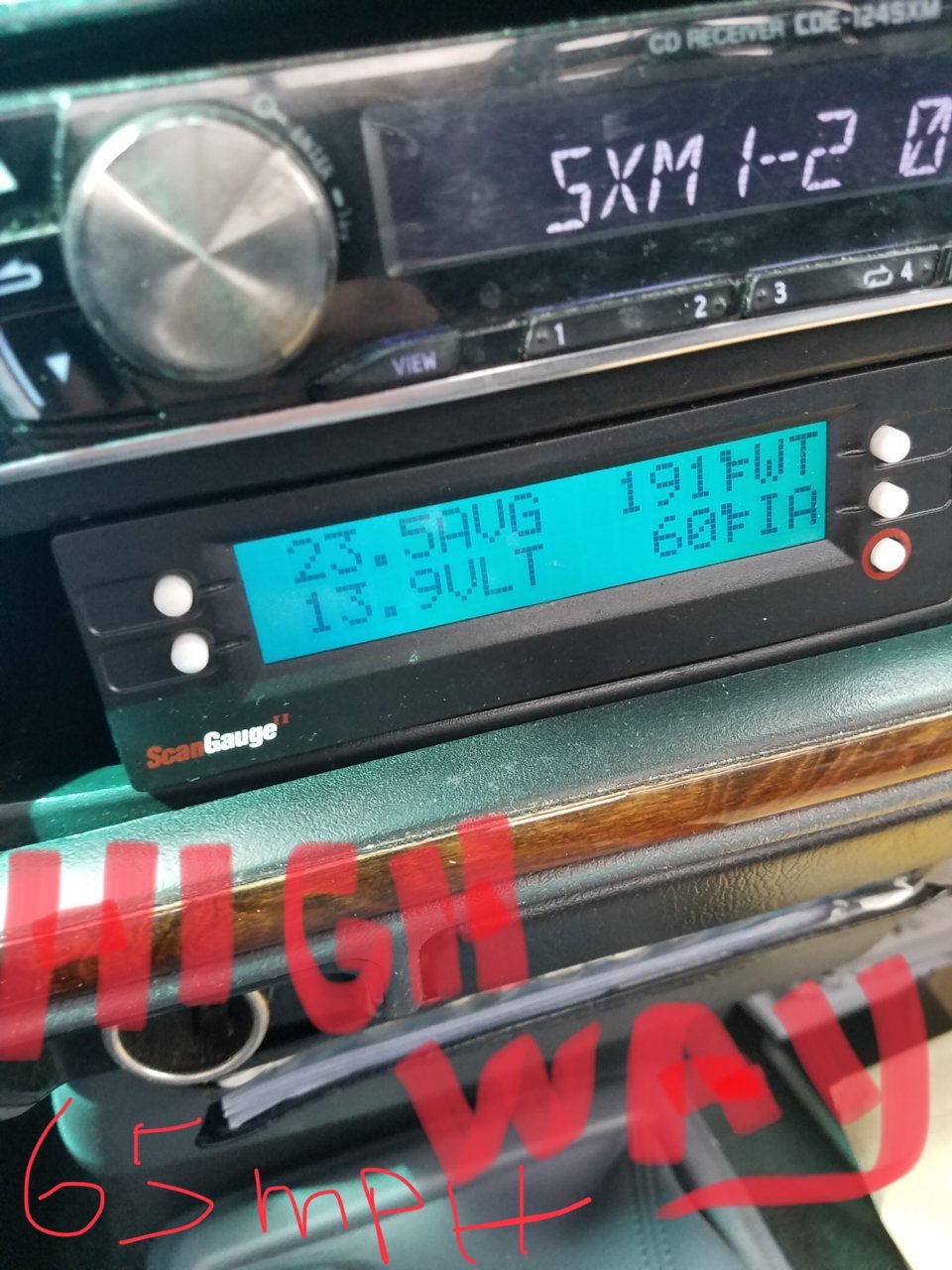

    Well color me surprised today. My gas mileage has gone way up with the new setup.
    I don’t know if maybe my old sensor was just not working correctly or that the new 2001 sensor and
    MAF tube has made it a perfect combination.
    My normal gas mileage forever has been 19-20mpg highway.
    So I had work appointment that was 50 miles one direction this morning. I wasn’t really Paying attention to the scan gauge that posts gas mileage while driving. I took a look at my temp on the guage next to the mpg and took a double take. The guage for average mpg said 23.8 mpg. I’m driving at the posted 65mph also with ac on and I’m like this has to be wrong. So not sure if this was reading correctly I reset the scanguage for the drive back
    and dam if it was in the same area for mpg while driving at 65mph. I monitor the average mpg in the city and it was in the 19-20 mpg area.
    Even had some mpg as high as 25mpg at 65mph
    This was definitely not something I was even expecting or looking at or thinking about. This swap is the perfect fit for my truck with some added power. Win-Win

    Also when you repin the plug it doesn’t matter about the wire colors as they change year to year and from Tacoma to 4Runner. Just move the wires according to the pin placement in the write up just posted.

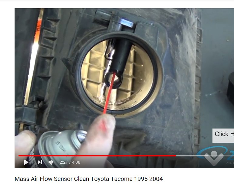

    The air box that is in the picture and video is the 99 and later version and does not need the older air box upgrade. Ur already set. Just clean the maf occasionally.
    BlackPearl likes this.

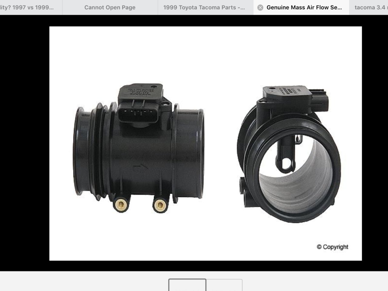

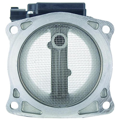

    This thread is for the v6 MAF, not the 4 banger, The 3.4 v6 had the bullet in the MAF.
    I don’t think the 4bangers had a bullet and the MAF in this photo I believe is for the 4 banger ??
    If your superchargered or have a Supercharger with a KN AIR FILTER this is definitely a win win

    No worries, got it all figured out, could not be happier right now with results.

    I’m not sure how you could go wrong, if there was a chance of getting 2 or 3 more miles per gallon and being able to have
    a new replaceable DESNO sensor I would think 50.00 or less would be a great deal with some added pep
    There’s a reason toyota updated this section back in 1999 and now I know why,
    Better mpg and performance
