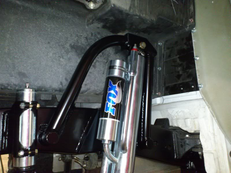

CLEAN!! I'll be doing a similar setup next week, using shock hoops from Defined Engineering. Have you ever fully cycled your pack to measure exact wheel travel? How often are you riding bump with that setup? Any additional pics would be awsome. Do you have a build thread?
I didn't know Defined makes a shock hoop for our truck that's awesome.
I am getting 14inch travel with this setup. I do have a built thread.

Ya the sell them a couple different ways, bolt-in, weld-in, bolt-in crossmember, weld in etc.
Mine should be here the beginning of next week. Here's a pic
I opted for the weld in hoops, and bolt in crossmember, to still have a somewhat functioning bed.
This should pull the full 15" the their pack is good for, with 14" shocks. Got a link for your build?

I wanted to run 14" shock but Tim recommended 12" so I will have up travel and not just all down travel. What shocks are you planning to run?
Build thread
http://www.tacomaworld.com/forum/2nd...trd-build.html
Ya I can see that reasoning with how low your hoops are, the 14 would really have much benefit.
The Defined ones come up into the bed a little, having to cut the fenderwell a little. Pretty much just allowing for the top of the shock to show and the crossmember to connect. Like this
I've got a pair of 14" RR F-O-A's for right now. But I'd like to get bypasses of course.

So the hoops you have right now requires you to cut your bed like the picture you attached? If so you might as well do a bed cage since it's already being cut.
