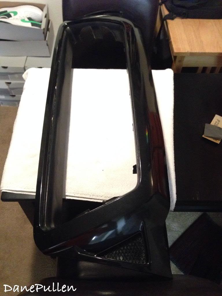

    Well I love DIY. So I finally got in on a raptor grill batch before they sold out. After missing out on the last 3-4 lol. Luckily found a BSP grill locally for cheap as well. So all I needed next was a real dremel and some sandpaper etc...
    Hoping to really get some good progress this week. I have a lot of experience with fiberglass/bondo/sanding/painting/plastic bonding so why not DIY? Plus it's fun

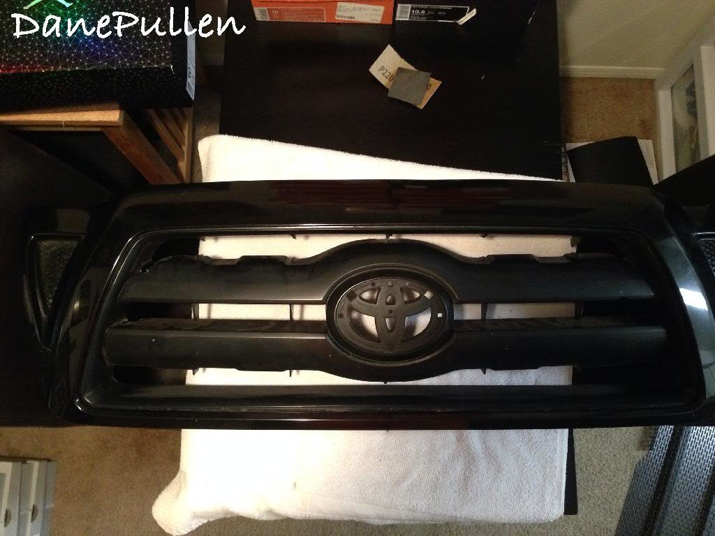

    So here was the grill

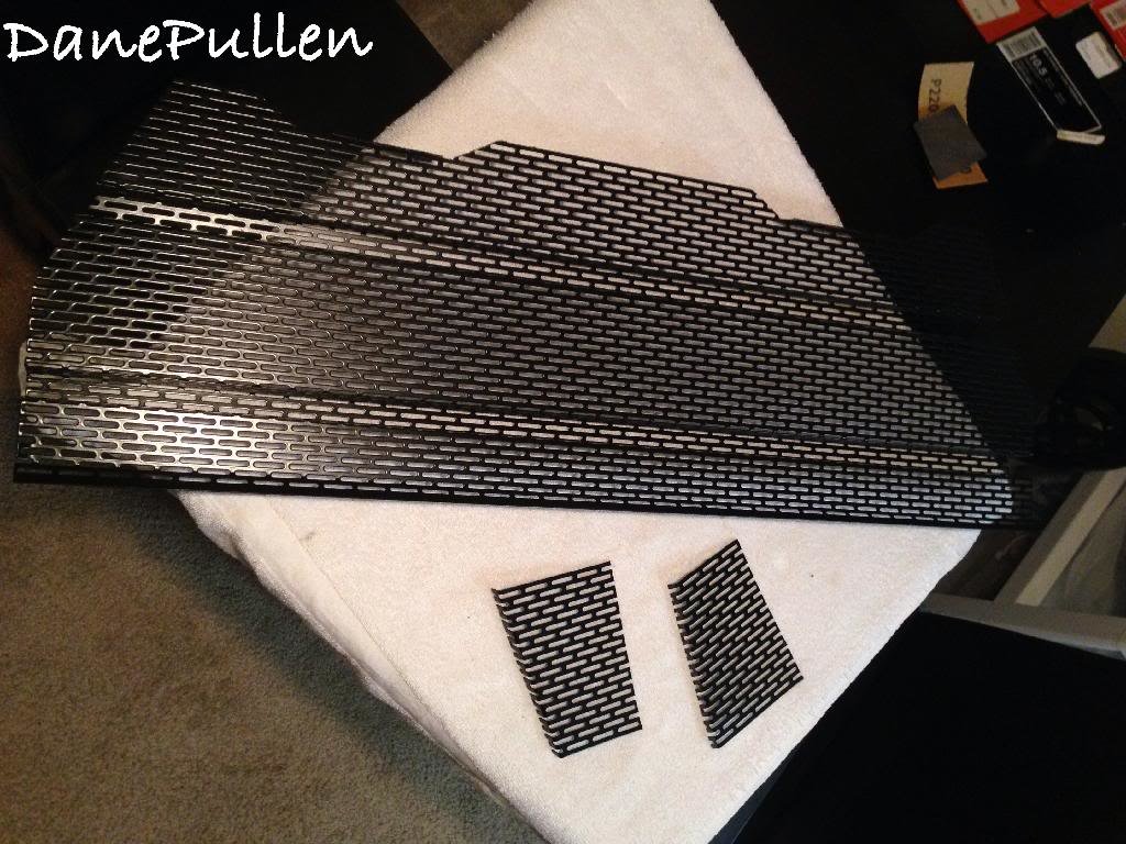

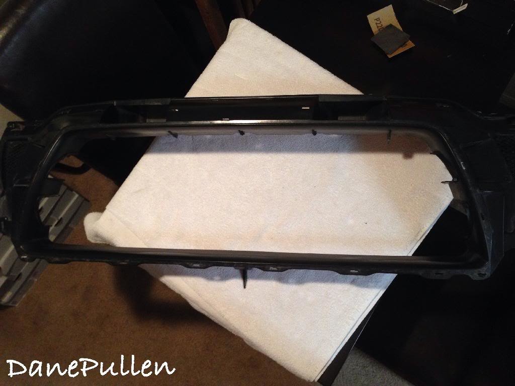

    Cutout the center
    031C4EEB-D236-4BE5-9030-487976A307DA_zps_de3b7aacf268c36a9608794fb84140ffc2230601.jpg
    I chose to separate the parts to make it easier when I polish up the shell and bodywork and paint the main part.

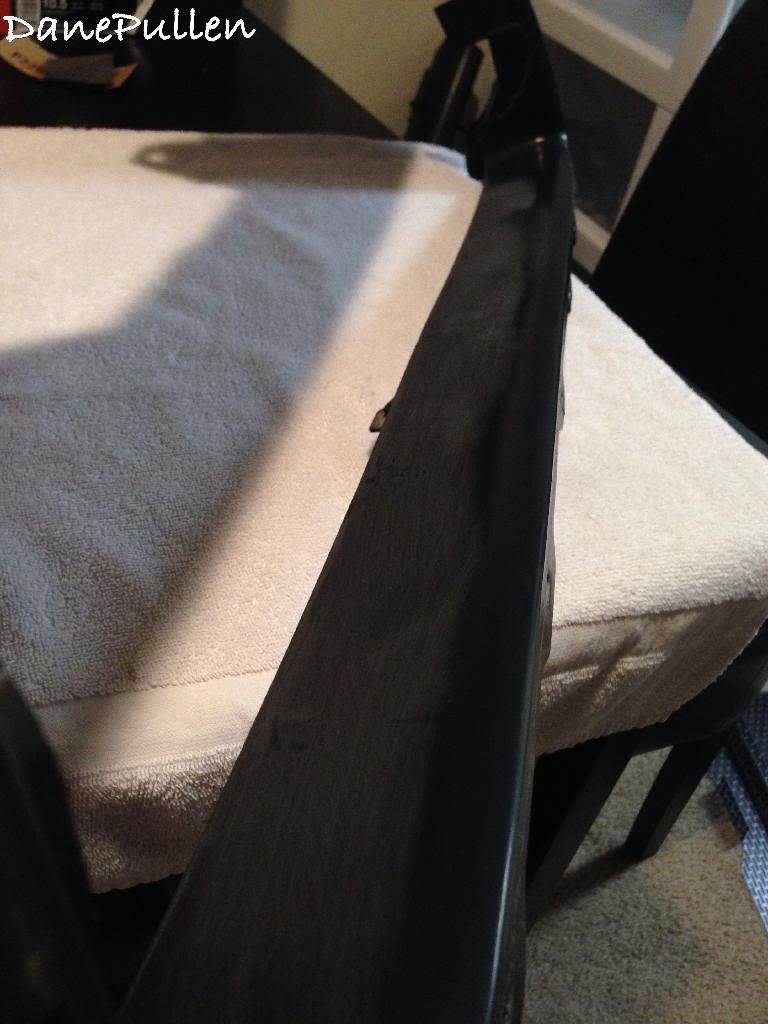

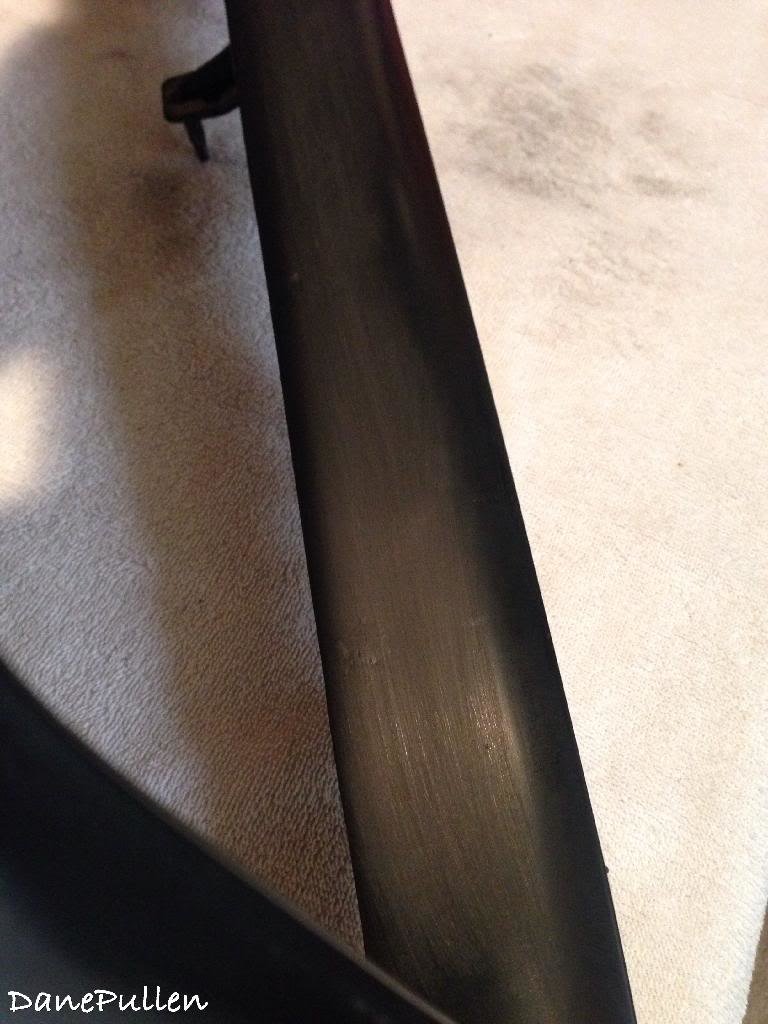

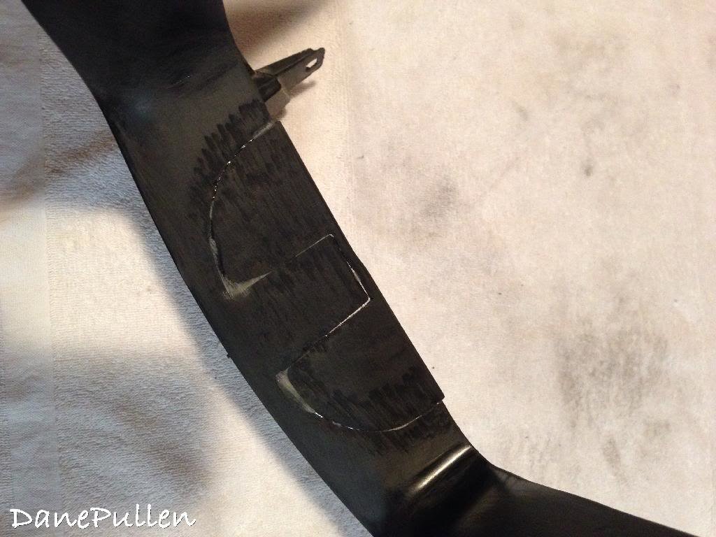

    I did do some small work already on the bottom. Almost got it flat with no filler, but it will need just a tad

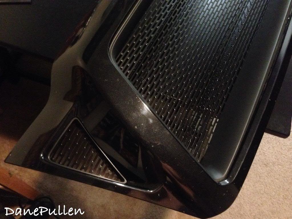

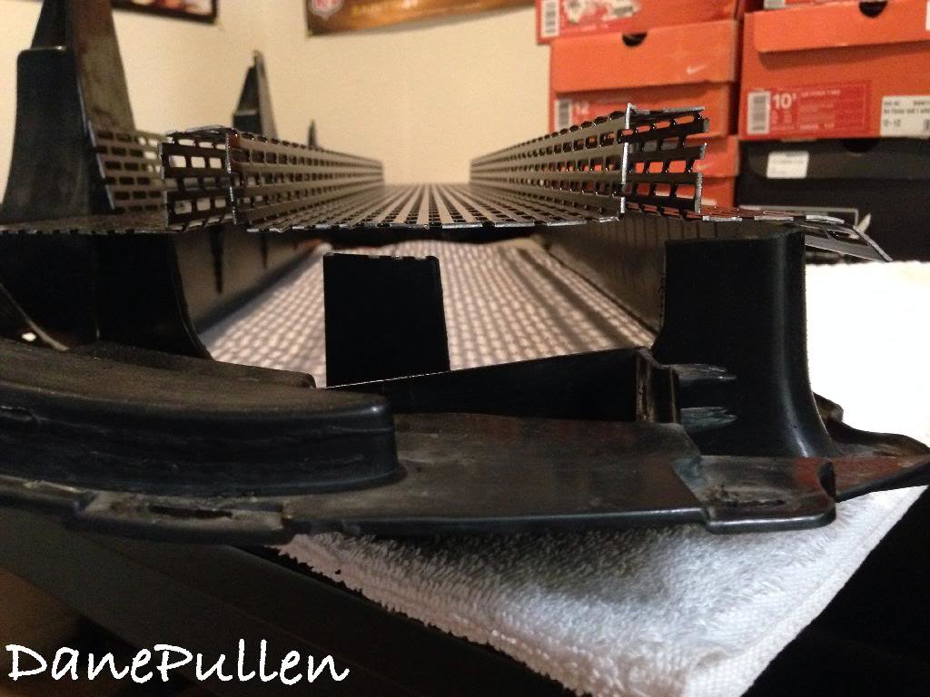

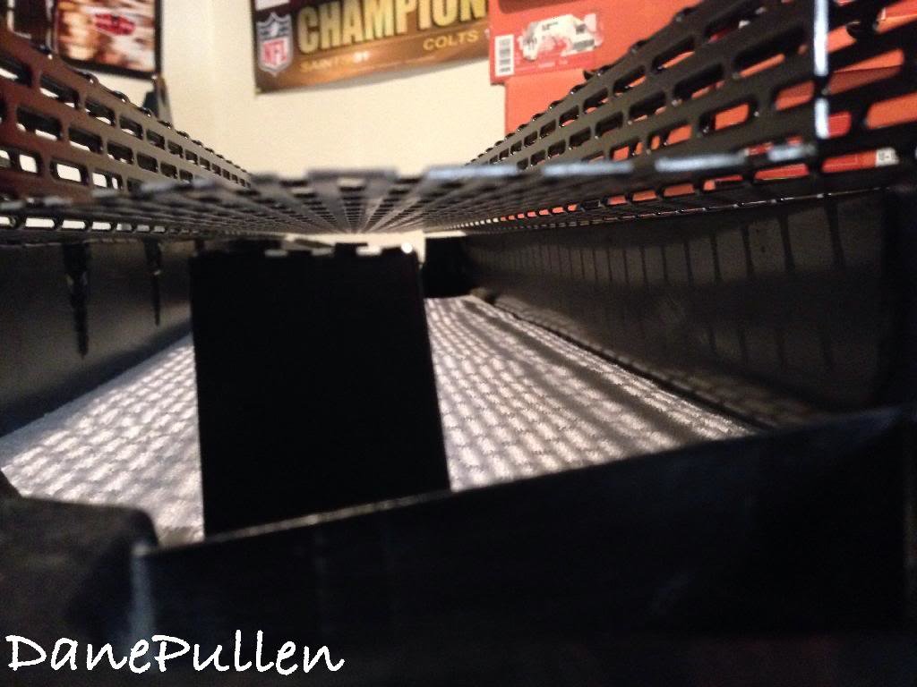

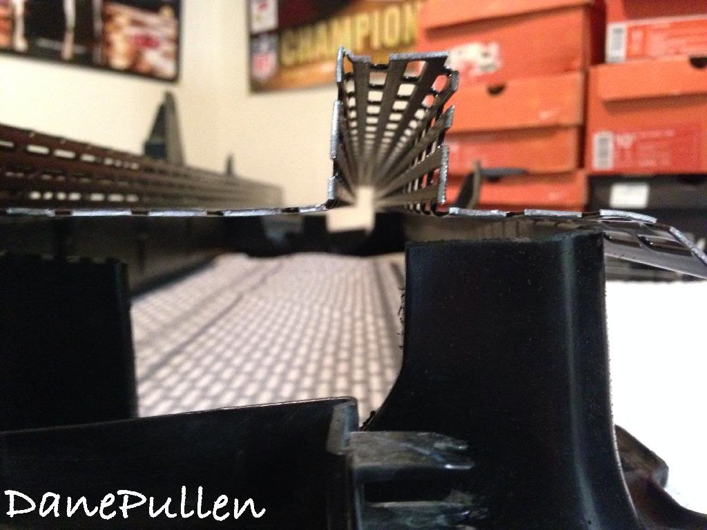

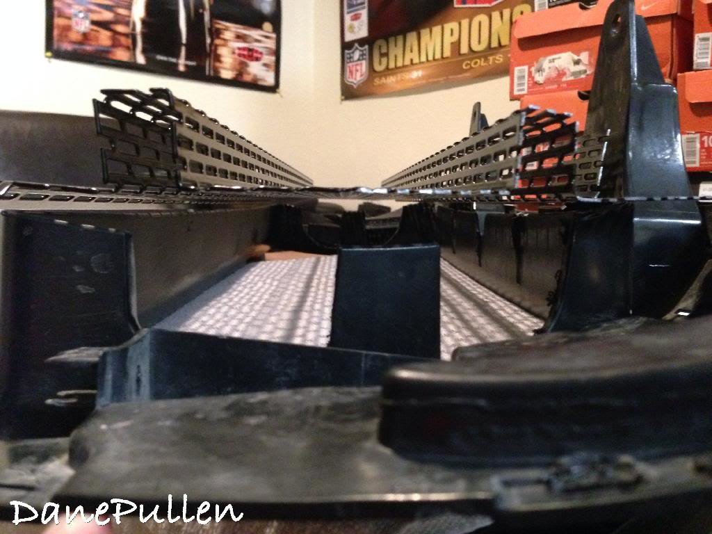

    Well been working on getting the mesh to sit flat. For the most part it does. A little sanding here and there and it'll be great.
    Here's the gaps I'm left with on the sides.
    9F77F9DC-B33B-4EED-8616-BA82244008F6_zps_61ac33c8fc291843cccded278f445361590a1bd1.jpg
    90240F85-D62C-4532-BF39-D39B382A7AC1_zps_5cc1897e3fb4ea67802497a64b44d01ada0fa2c8.jpg
    Grill sitting flush
    4A1C2EC2-6694-47D4-875A-B2FC7C40F176_zps_b4d4924349cbc24ad015093675c84256c4151e8f.jpg
    I know I could trim around the entire grill to get the side gaps a lot better. I may, I may trim 1/2" off the entire grill all the way around maybe we will see after I start sanding down the old braces that help the stock center piece

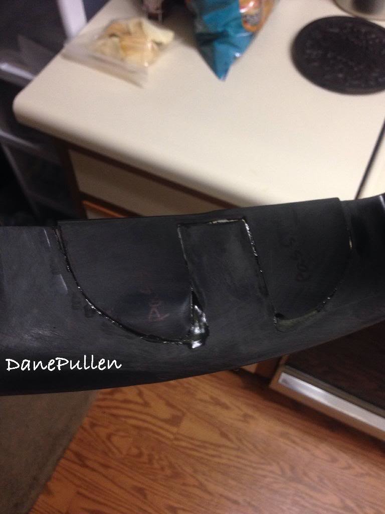

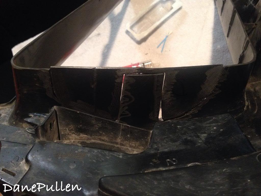

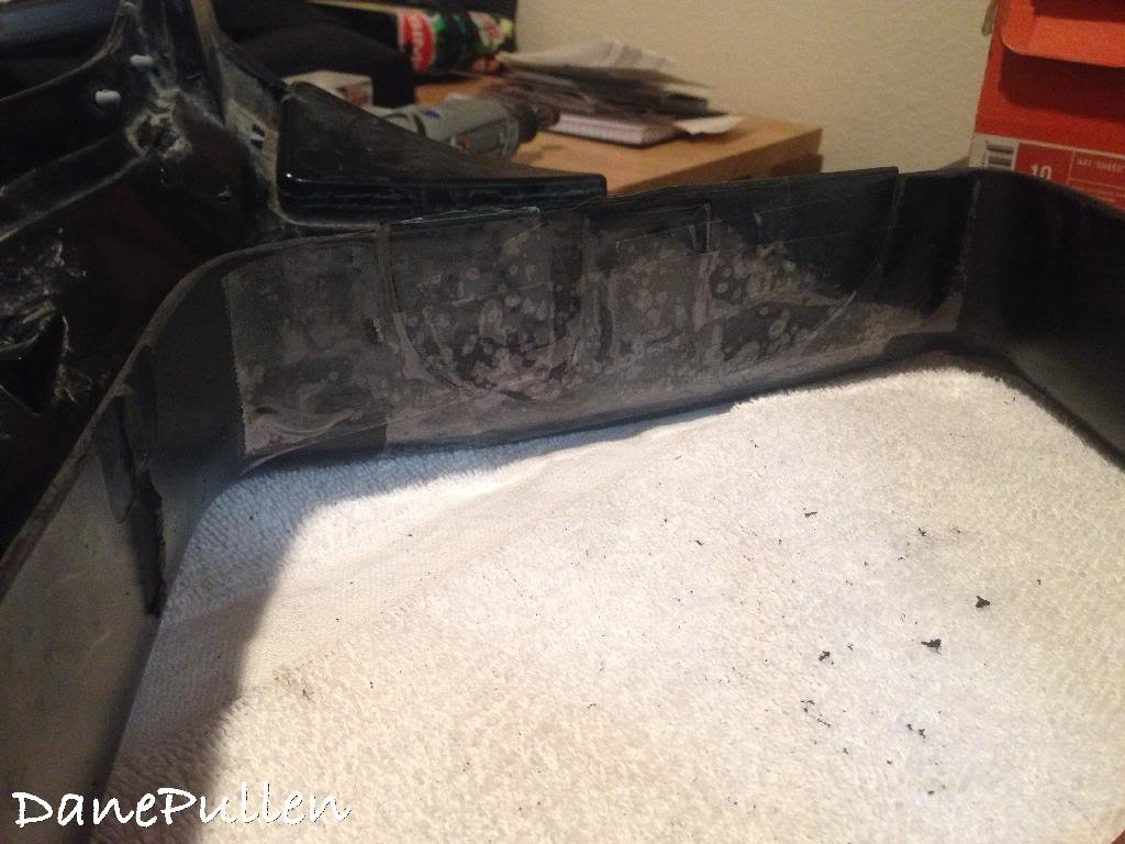

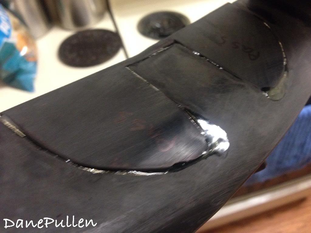

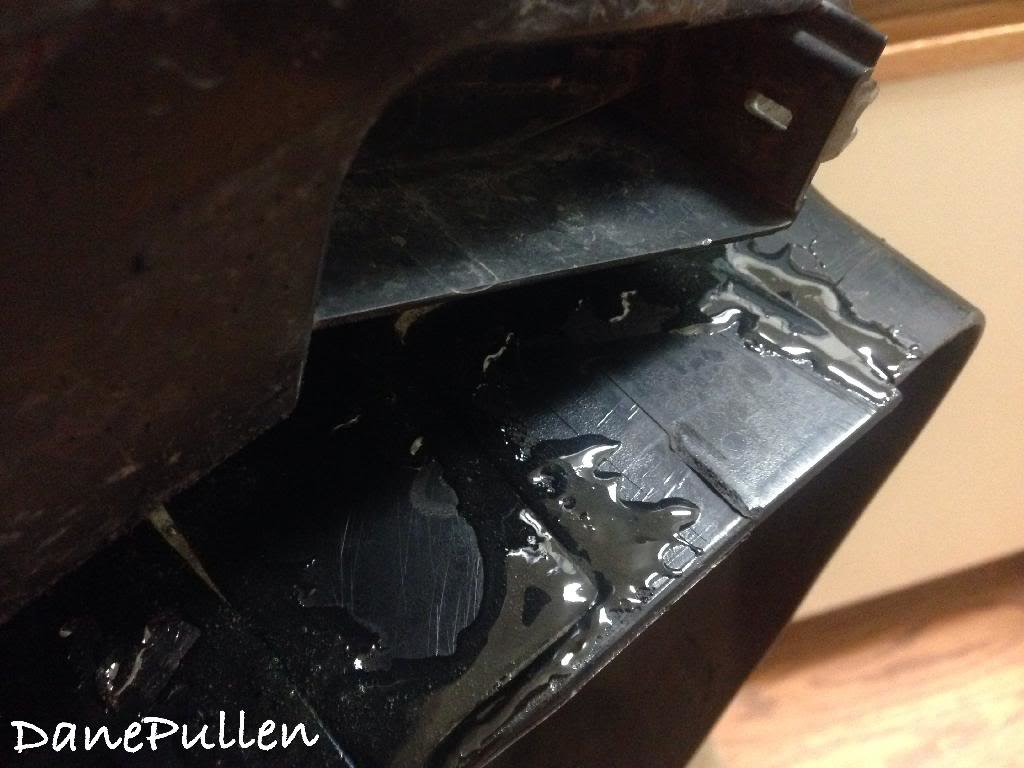

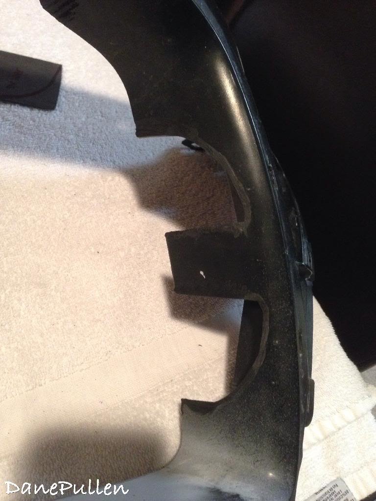

    Well I worked on the passenger side tonight.
    Cut out a scrap piece of plastic, trimmed it fit, I even heated the piece up and tried to shape it the best I could. A straight plastic piece would of left big uneven parts.
    So I taped the piece in and epoxied from the back side. Let it tack up then pulled the tape off before the epoxy had a chance to melt the tape to the part
    DB243B2B-A11B-464D-9C30-1695DC58552F_zps_af6e72f14838c30ebdbfa4428d0b3dfd56b10c5c.jpg
    F515BDB6-8F76-4958-AFA1-89C1D5E72E8D_zps_f3526d1254c3330dd520c9fa5303123357f9780f.jpg
    520F1CC6-D19B-4598-9E41-7488B36D446C_zps_2d84583ad756e27df2c3207b287477d6748267fa.jpg
    8B5C189A-8884-42F3-89E0-A4AA78C8A5AD_zps_1a5057fea4836ebb9ff89d3076f6950ebdd79bda.jpg
    87C07D54-1D76-4D3D-A519-BBF9ABF8381B_zps_8581d28129a901d5e888aa782f31cf041fc9b40b.jpg
    I tried to bend the end of this piece some to make it easier. You can see that taping the front side also kept the epoxy level and smooth on the outside of the grill. This will help with shaping as well
    6394DF59-D513-480D-B17F-8C2D4C29B7DB_zps_36d2f80c1b6f49a6fbaba4bba6fc23f950affbf0.jpg

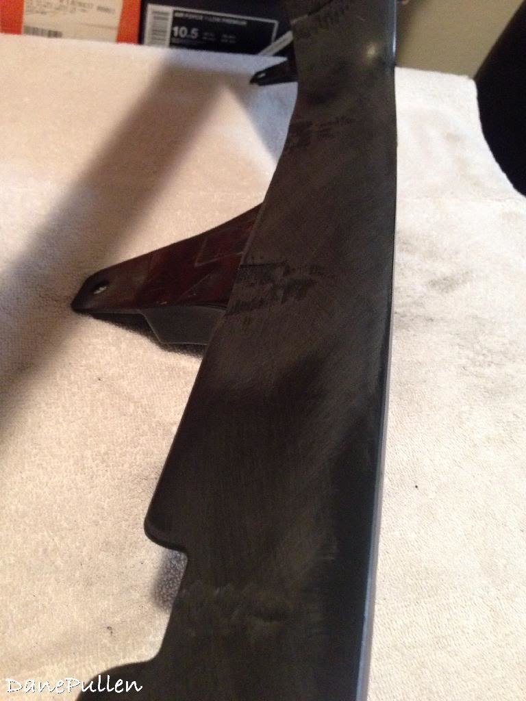

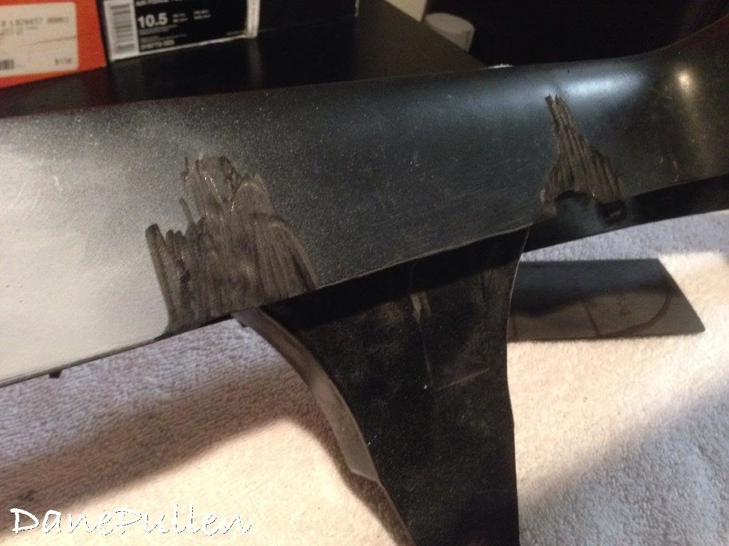

    I ground down the seams and epoxy that came through, also roughed up where the OEM braces were, hoping that will help the filler bite better. None of it is thick at all
    7F71A6DF-C186-4428-ADE5-CC8C3D76D615_zps_a29aeaf857f69bf9421f54a12f0e76d185fbd645.jpg
    4CF39E77-C012-478F-BA62-625E07A71D21_zps_bdf6cf50f8cab9264cb3495ee47c6a656737c0a1.jpg
    705244F4-F00E-4F36-9307-CC2DF3F45664_zps_4b5e1143d75f41e54170ced6b05bf29cb3fd6821.jpg
    I need to add a thin thin layer to get the shape just right on the side right there. Yes it being matte or semi gloss black will hide any slight shape imperfections. But I'll know about it

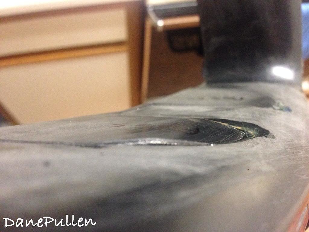

    @HomerTaco you can see to the left of my name where's the shape is just off a hair. See where the color grey changes from light to darker? I'm not worried about that little pinhole, glaze will fix that
    91D91584-8352-4180-964B-6435E09D0F98_zps_ce39907ab1368d66bee79f0ac16631a5dbc97c05.jpg
    That type of stuff will be taken care of after I rough in the other side and do the triangles.

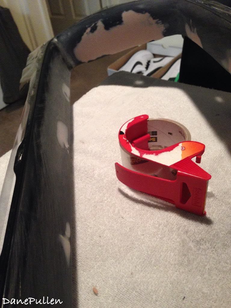

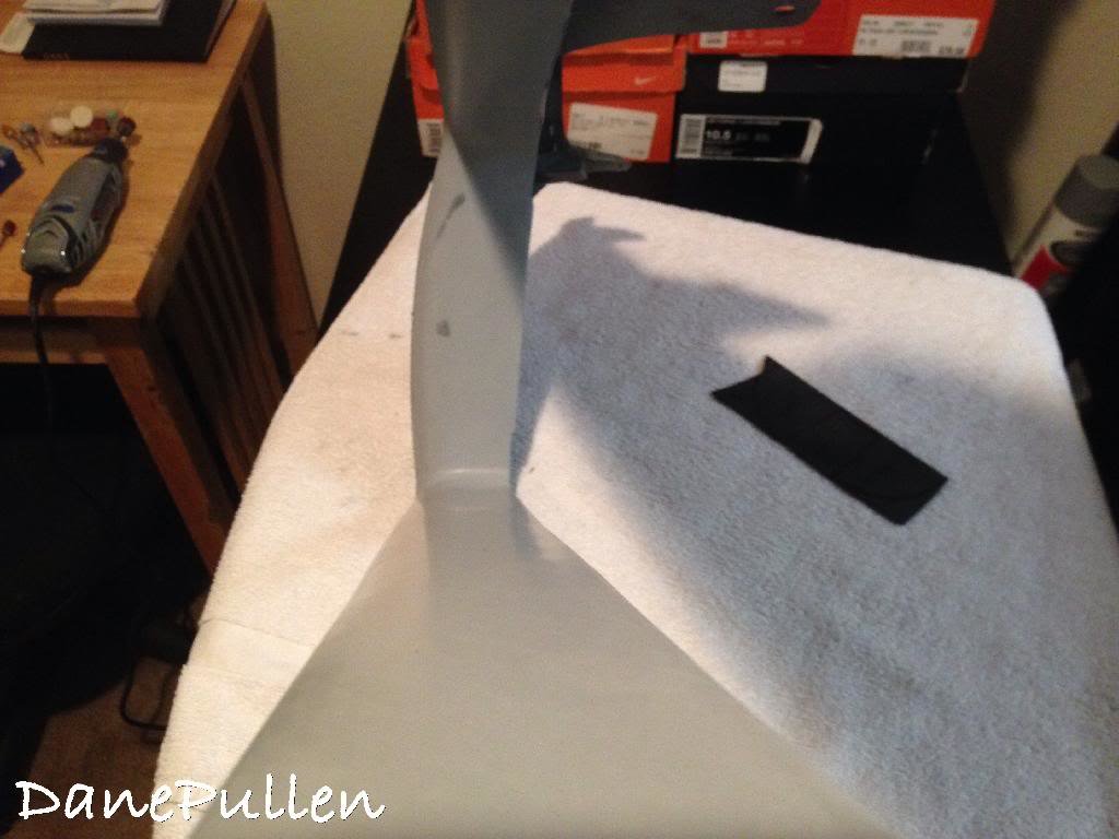

    Primed and blocked the bottom. Very slick now
    3E62E3E7-4518-4220-A8D2-050B503202F3_zps_bbb6f1d76156436bebfdd2c7ebf58e089247414c.jpg
    Also ground down the other side and the last two supports. Had to fix a small part that broke off by a support when I was cutting out the center
    52089EFA-9D7A-4A6E-A864-30DDFB1F3D66_zps_e4757bbcbc4292dfcf33a5fc55179d4128f89d69.jpg
    See the part on the right? It's replaced now, all epoxied, filled over, and ready to be sanded
    9F965D5B-6D96-4C98-A5E0-09AEEFF36E29_zps_c471759ebe724d66e6de2265c4d3b780a0fea9e0.jpg
    I also got the other side piece fit in, bent, shaped in perfectly. It's epoxied in and filled over as well. I will be gone TDY till the 25th. So the few watchers, no more progress till around then. But it's coming along. After this I'll add the "fingers"

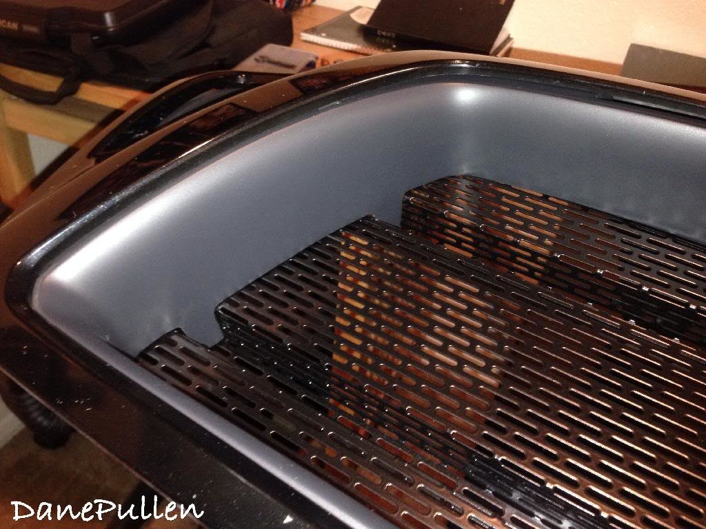

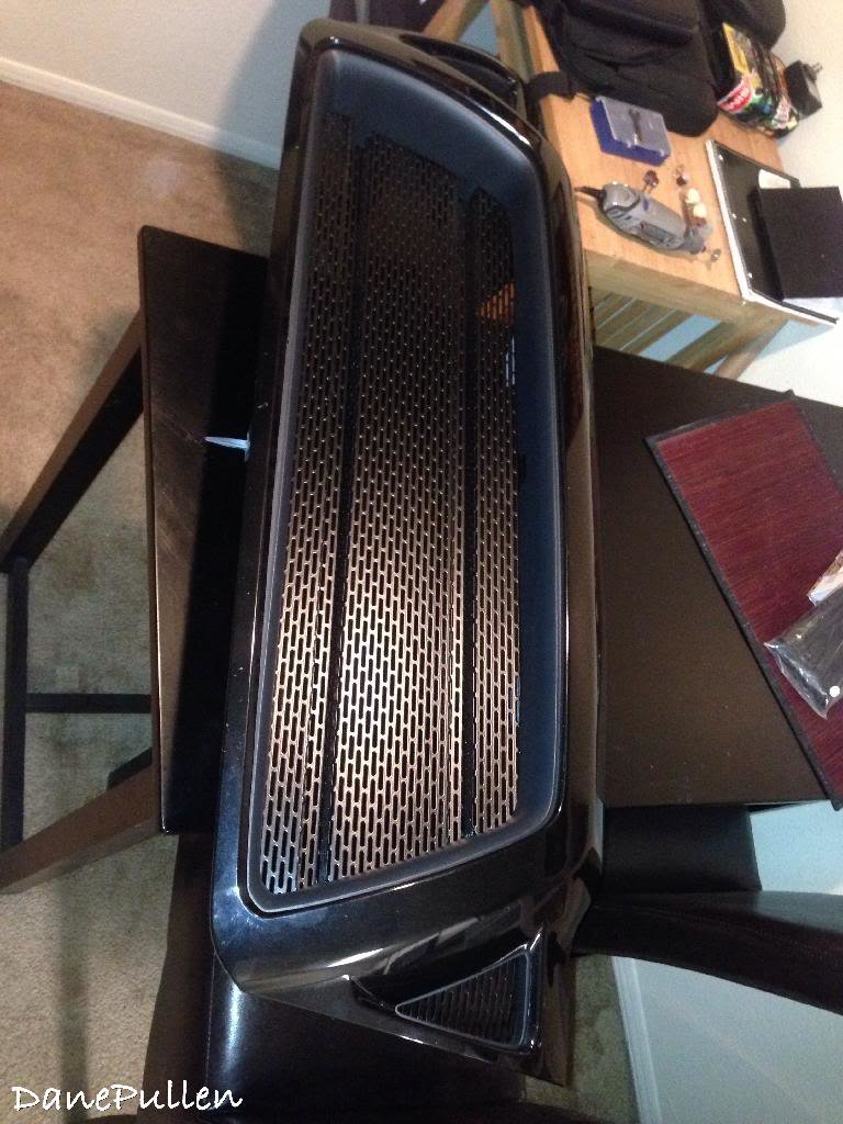

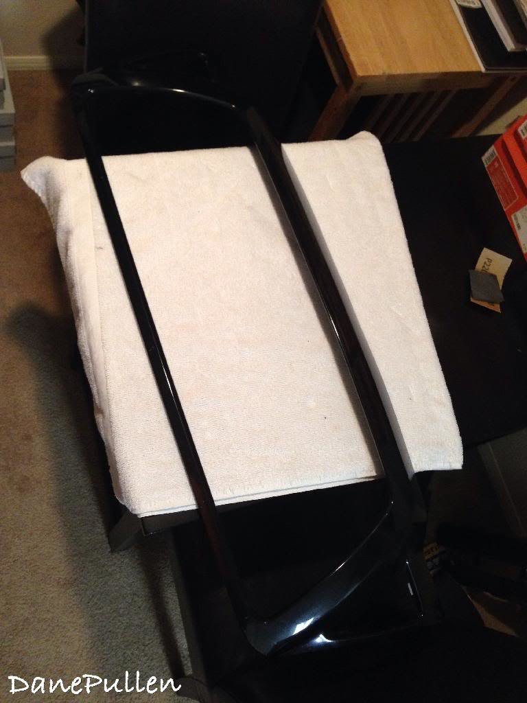

    Ok guys. Got it pretty much finished. Just have to reattach the shell. No it's not grey, it's flat or a satin black with a BSP shell. I may repaint the shell BSP, it was bought used and has a few chips and such
    Anyway, I know that you just want pics
